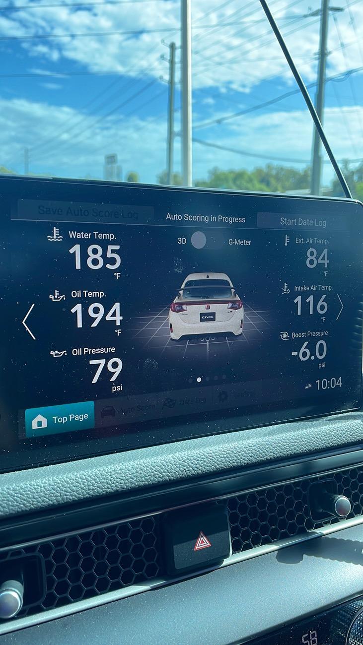

Hello, as many of you know, I blew my MHI stage 2 turbo a month ago. The car is back on the road with the oem turbo. The MHI stage 2 turbo blew oil everywhere and needed a deep cleaning. I noticed the car smoking after driving yesterday and today. I drove calmly yesterday and aggressively this morning. There's no burning smell or unusual sounds. The car feels great. Could this be from condensation in the AC lines? I'm assuming most of the residual oil is burned off. I replaced the turbo gasket due to a slight leak, but there are no oil leaks now.

I haven't seen AC condensation manifest like this outside of the car. Pressures and temps look like they're in normal ranges.
