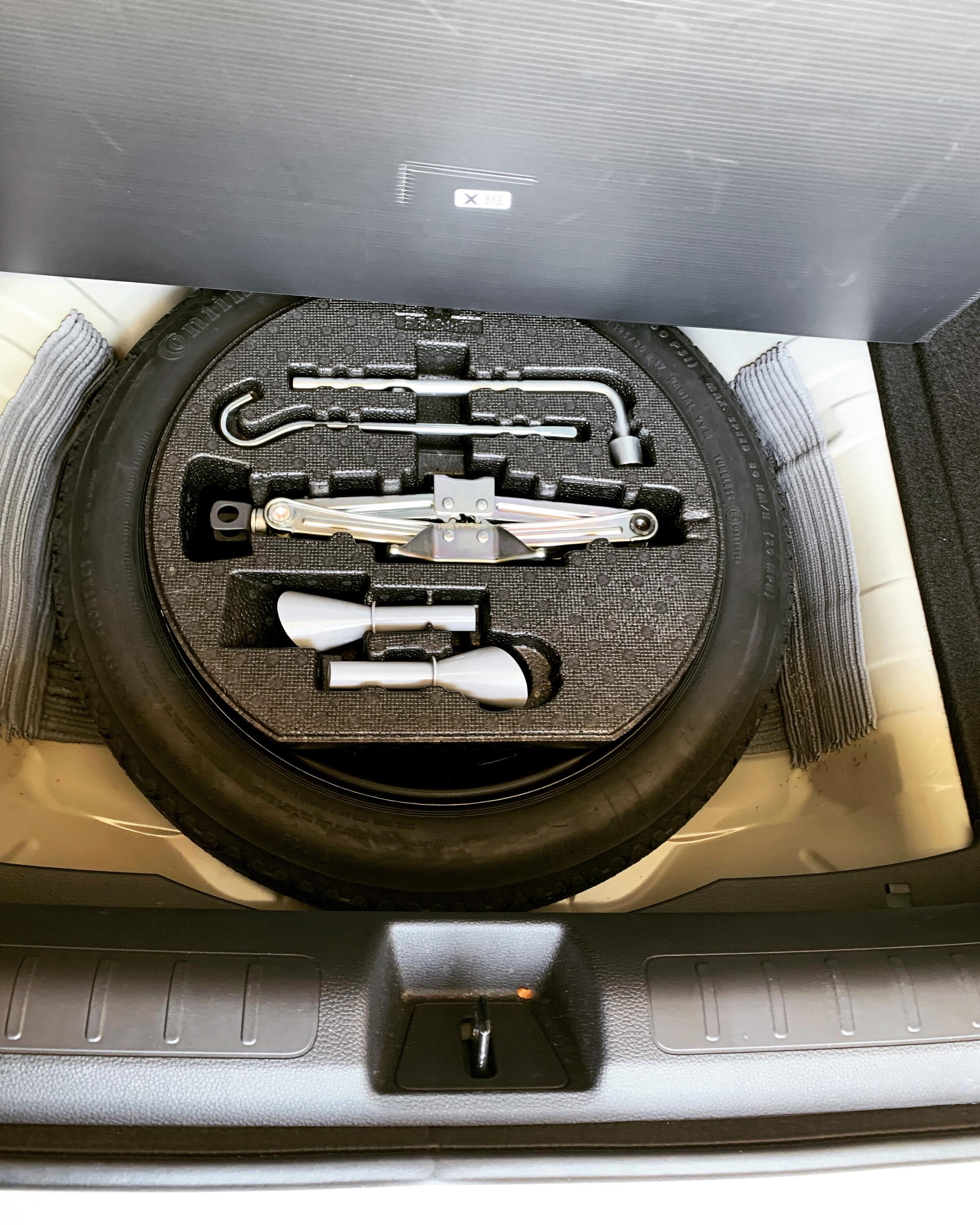

Is the SI cargo area the same size as the FL5? I would love to buy this if there is no hump in the cargo area, wondering if anyone has tried this setup in a fl5 yet

I looked before. There is absolutely zero way you get a spare without a hump.

thats unfortunate, I guess that's why Honda has yet to release a spare tire kit for the fl5. What are people doing for road trips? Just putting a spare trunk and dealing with the reduced cargo space? Or is the tire inflator kit that it comes with good enough? My cars have always come with a spare and ive never had to use the inflation thing

I would rather have a spare than an inflation kit for sure but I'm not too worried about.
However, I will be most comfortable with 18s on the car and a little more sidewall.

Is the Type-R's spare different than other 11th gen Civic's spare? From what I've heard, nothing is a 100% direct fit for the Type-R, it creates a little "hump".
I can’t say for sure with the 11th Gen Type R, but the spare tire kit raised the floorboard and never really sat flush in my 10th Gen Type R. Not to mention the Type R cargo tray was also a bit off.

Yeah, I think the Type R spare compartment is shallower due to the exhaust pipe going right underneath there (vs normal Civics). Some convenience is sacrificed for performance, which makes sense.

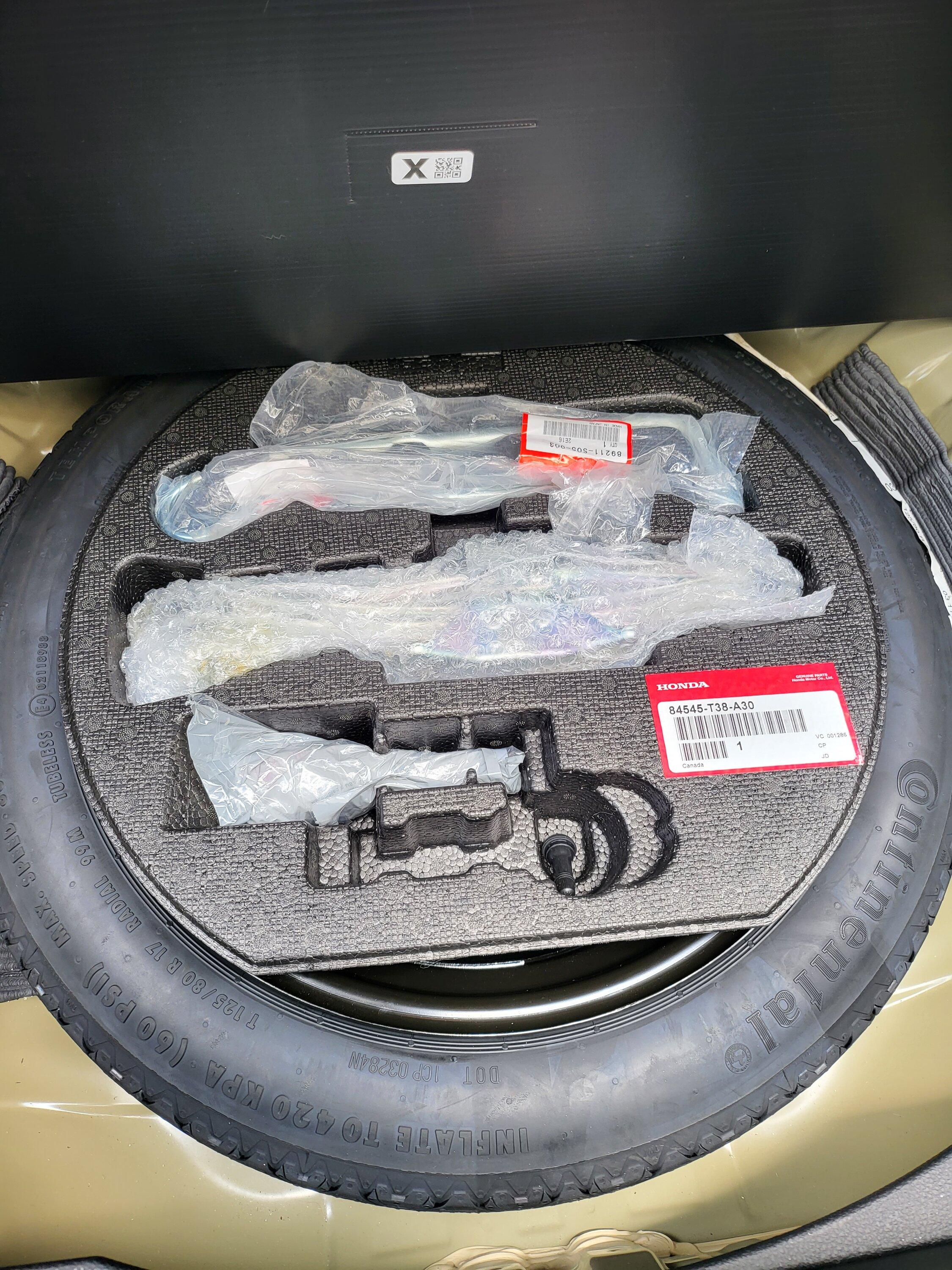

Just put my spare tire with kit in today.
Spare kit from HondaPartsNow: $177
Spare tire from Tire Rack: $131
Local tire install: $40 (forgot to give them my tire stem so paid for that).
Tire is 125/80-17.
Thanks to OP for answering questions I had!
