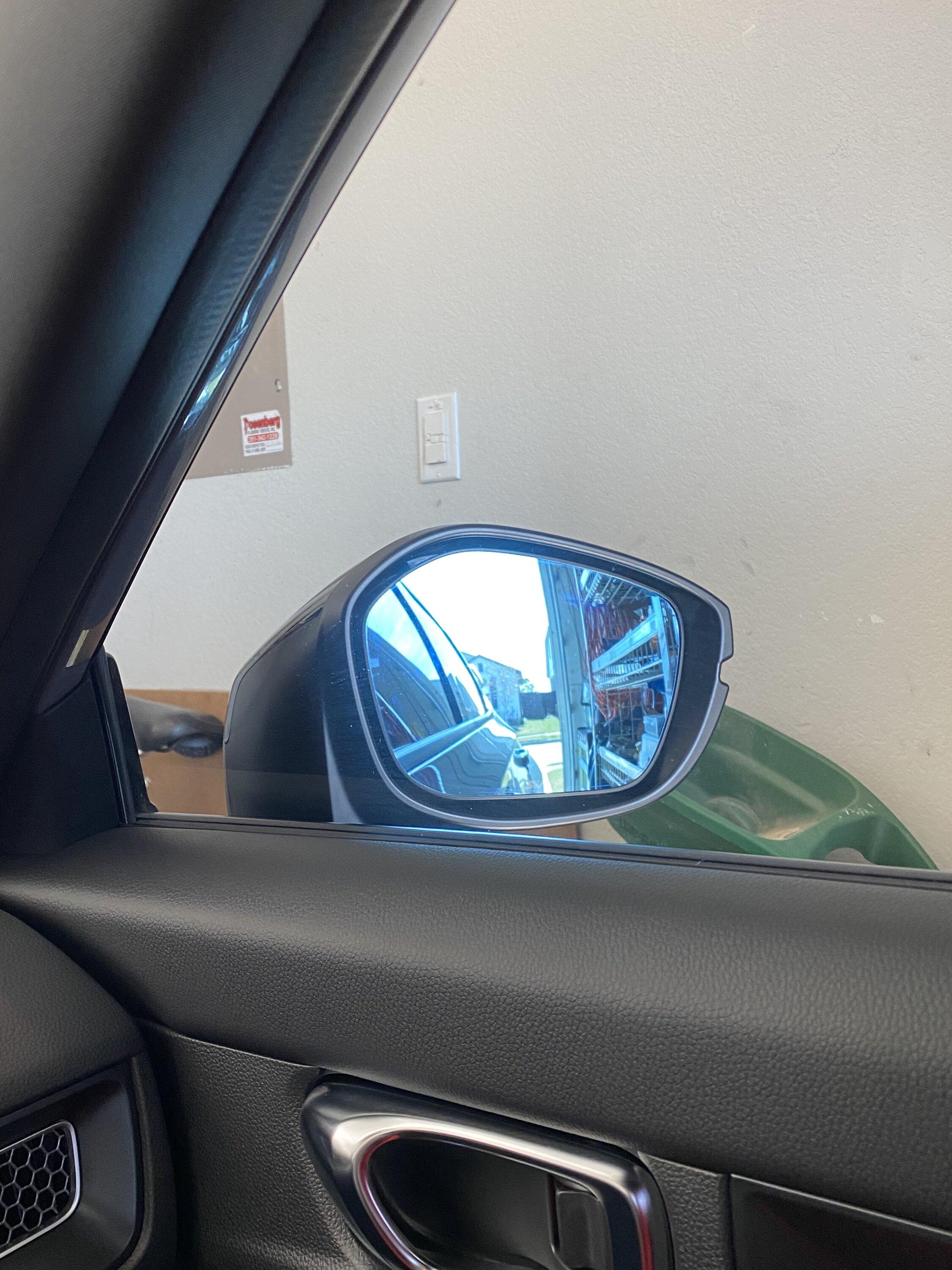

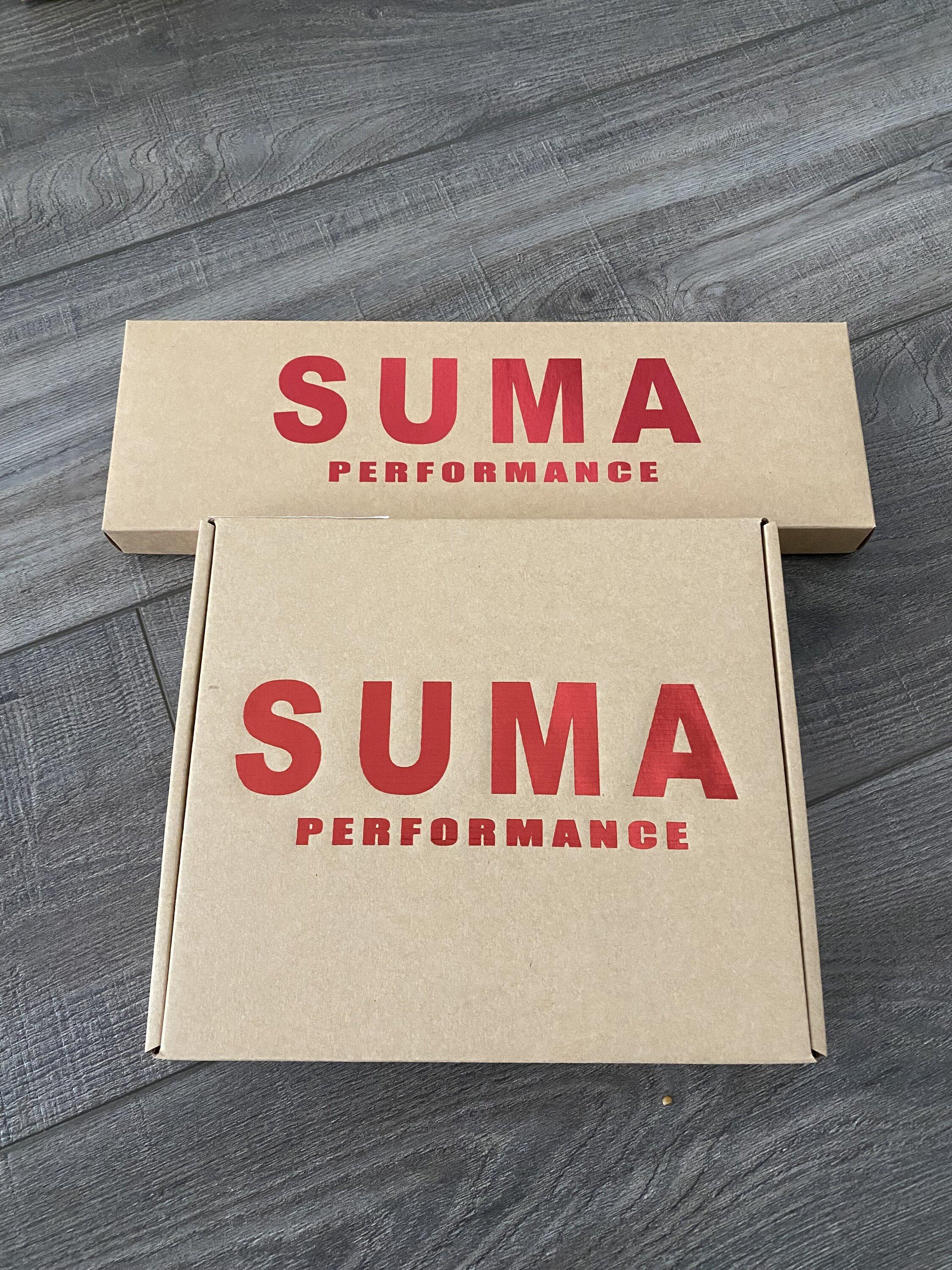

these are Suma?? I see no logo
It is there, just blends in at that angle but if you zoom in you can see it slightly

This one is a little easier to see but still slight.
Ohh, I see now. I was about to very upset that a version without the logo now existed.

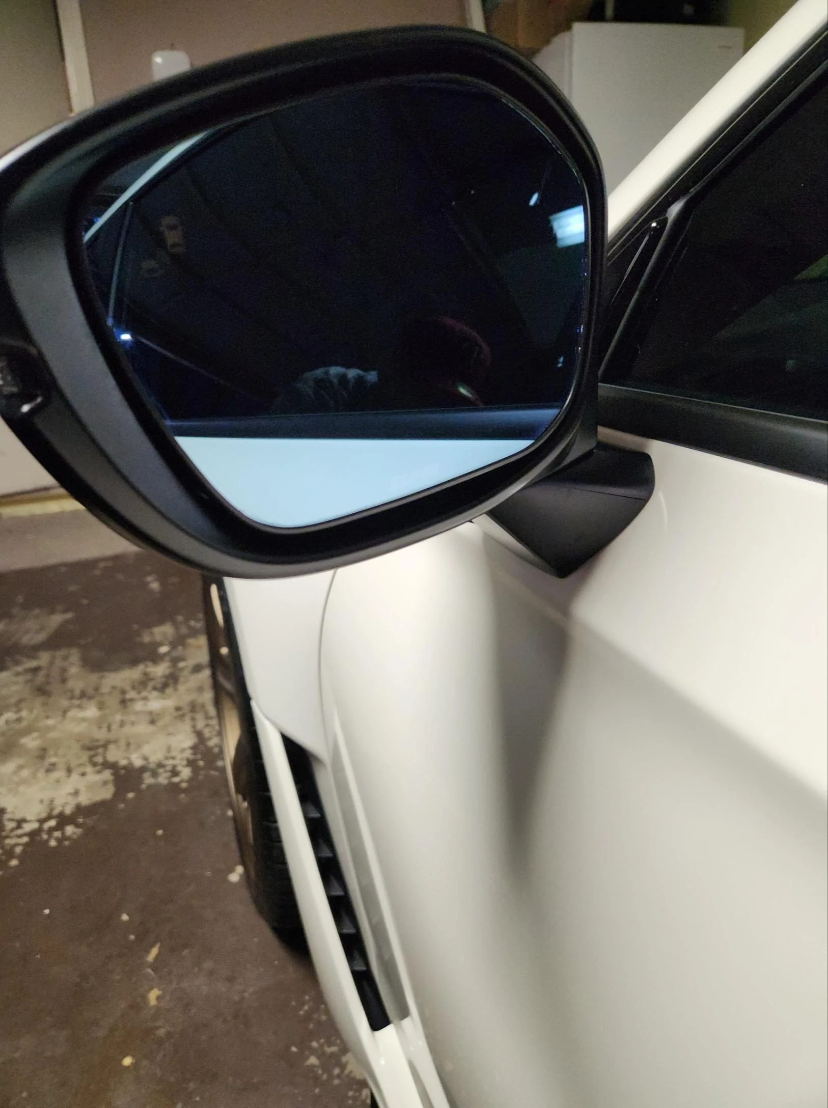

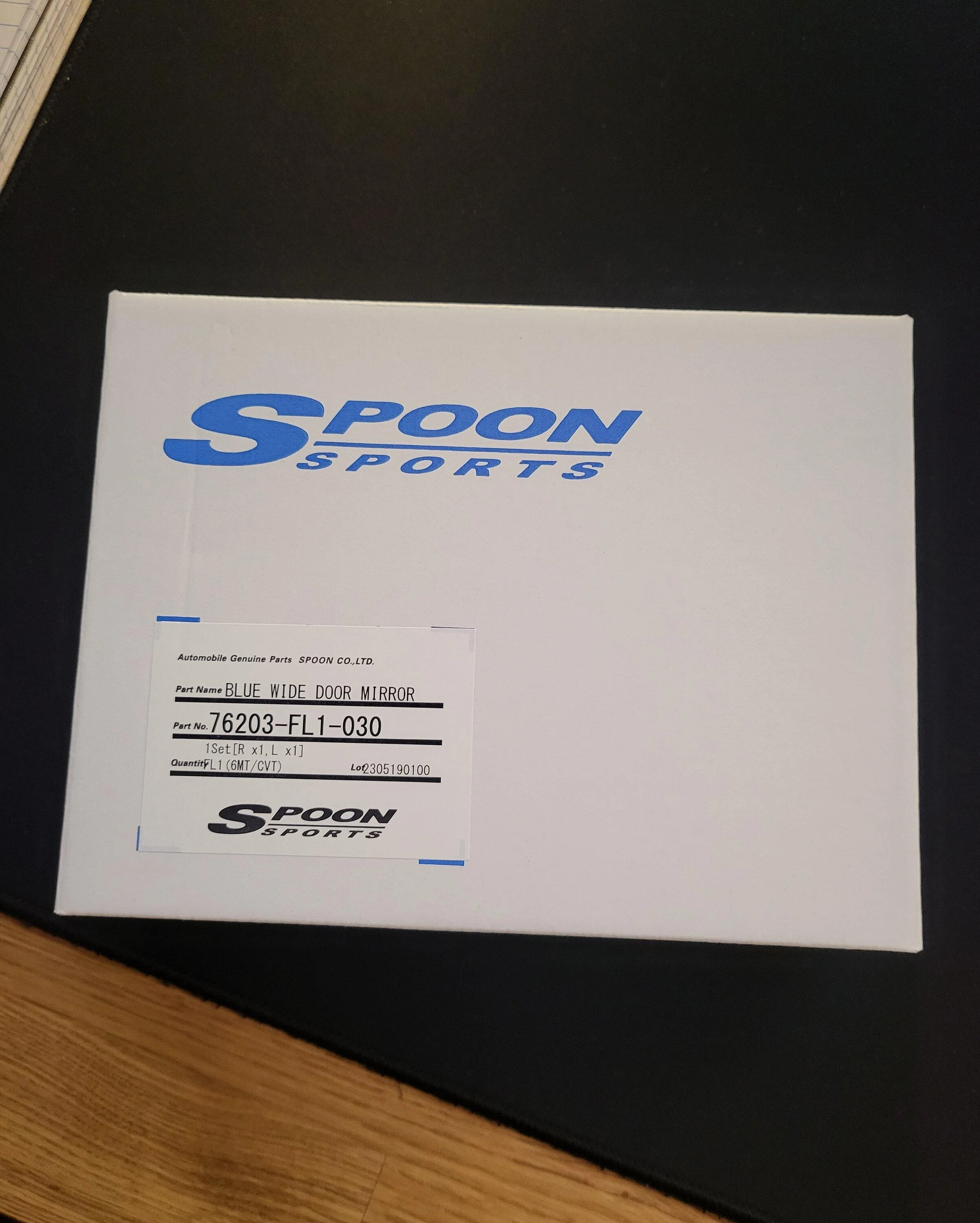

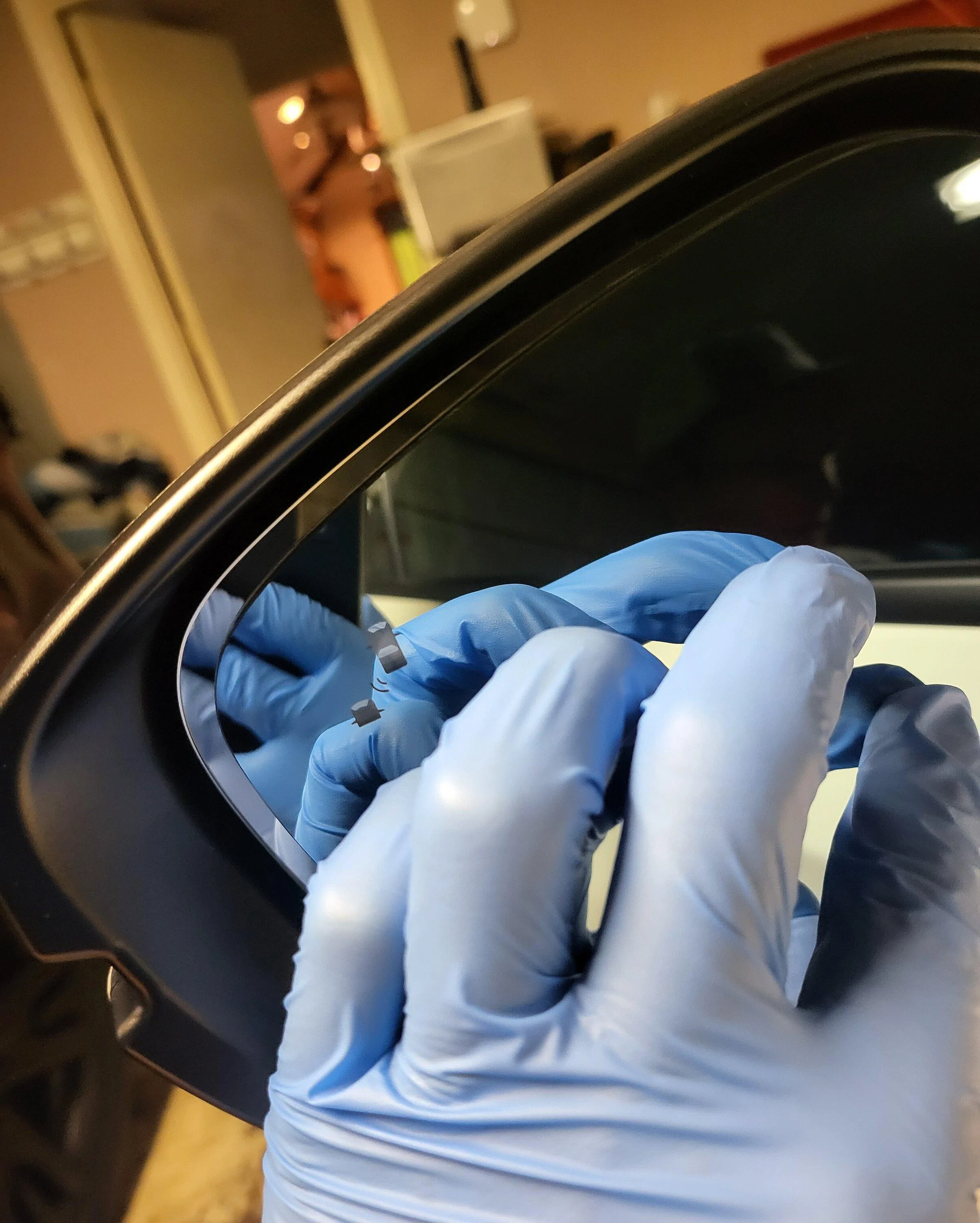

Not sure what the difference is between the JDM and USDM side mirrors, but the FL1 Spoon side mirrors did not work out for the USDM FL5. I have seen elsewhere that they worked on a JDM spec, and did not seem to have any issues with fitment.
Will they fit USDM? Yes, to a degree. Will they line up with the blind spot monitoring? Not even close. I am not the biggest fan of side mirror overlays, but Spoon has the rear view mirror which I like and I wanted to try and stay consistent with the rear view and side view mirrors.
When I first installed, I centered the mirrors on top of the OEM side mirrors and there was a slight gap all the way around. Something that I was not thrilled about, but may have been able to live with until Spoon comes out with their full side mirror assembly. However, I quickly noticed that the BSI was not even close to being aligned. When aligning the BSI, there was a significant overhang on the right side of the driver mirror and a large gap on the left side. Didn't even open the package for the passenger side to see how it compared after this.
I will be looking into Suma and/or Mugen side mirrors next. Both of those options are a full mirror glass replacement so hopefully will not have the same issues.

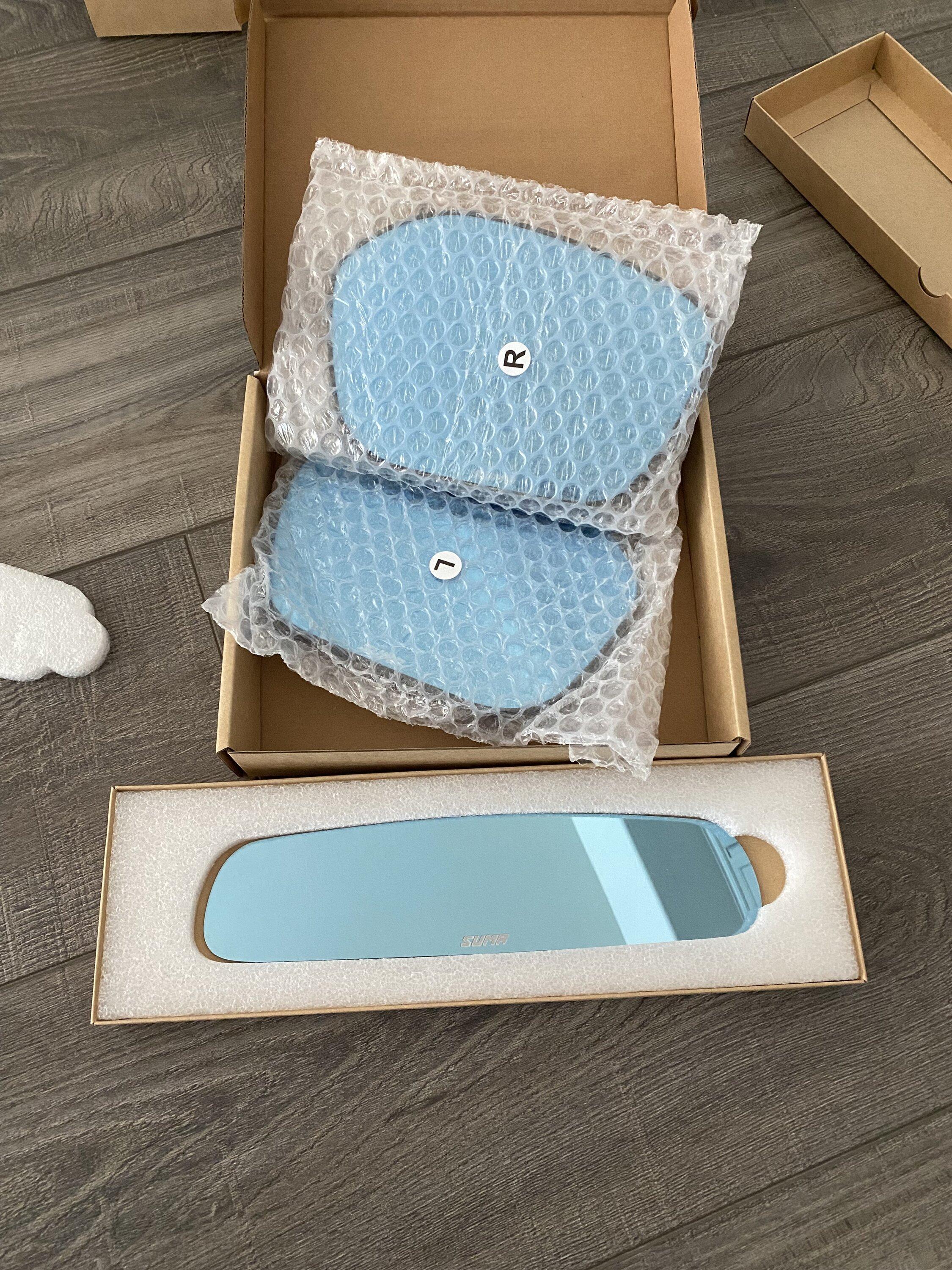

ordered the full set and the 10th gen rear view mirror fits for those that are wondering. great upgrade for those that drive a lot at night or just want extra visibility

I haven’t decided if this is something I need but, I did look at spoon mirrors too and noticed the serial number from the OP, 76203-FL1-030, is different than spoon usa offer, 76203-FE1-A30 for the FL5. One search hit I got for the first number specified it was a JDM fitment or RHD. Nothing to offer other than that.
