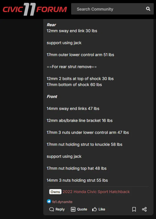

Some people remove the 3 ball joint bolts. If you do, don't make this guy's mistake (see 9:35 mark).
This video shows removing the axle nut.
I didn't remove the 3 ball joint nuts, nor the axle nut. I just removed the 17mm strut knuckle bolt and loosened the 3 top strut bolts, then I used this guy's kick method (see 9:33 mark) and tilted the strut and knuckle toward the front of the car. I did all 3 times I switched springs.
Here are suspension torque specs. This website prevents links to competing forums 🙄, so here's a screenshot.
@HKSpeed Thanks again for the help! I watched all these videos multiple times and referenced these torque specs many times during the install. I posted a separate thread with the videos I have started posting.

Loosen all the bolts on rear knuckles and rear control arms and sway bar, then retighten under load. You will need alignment.
