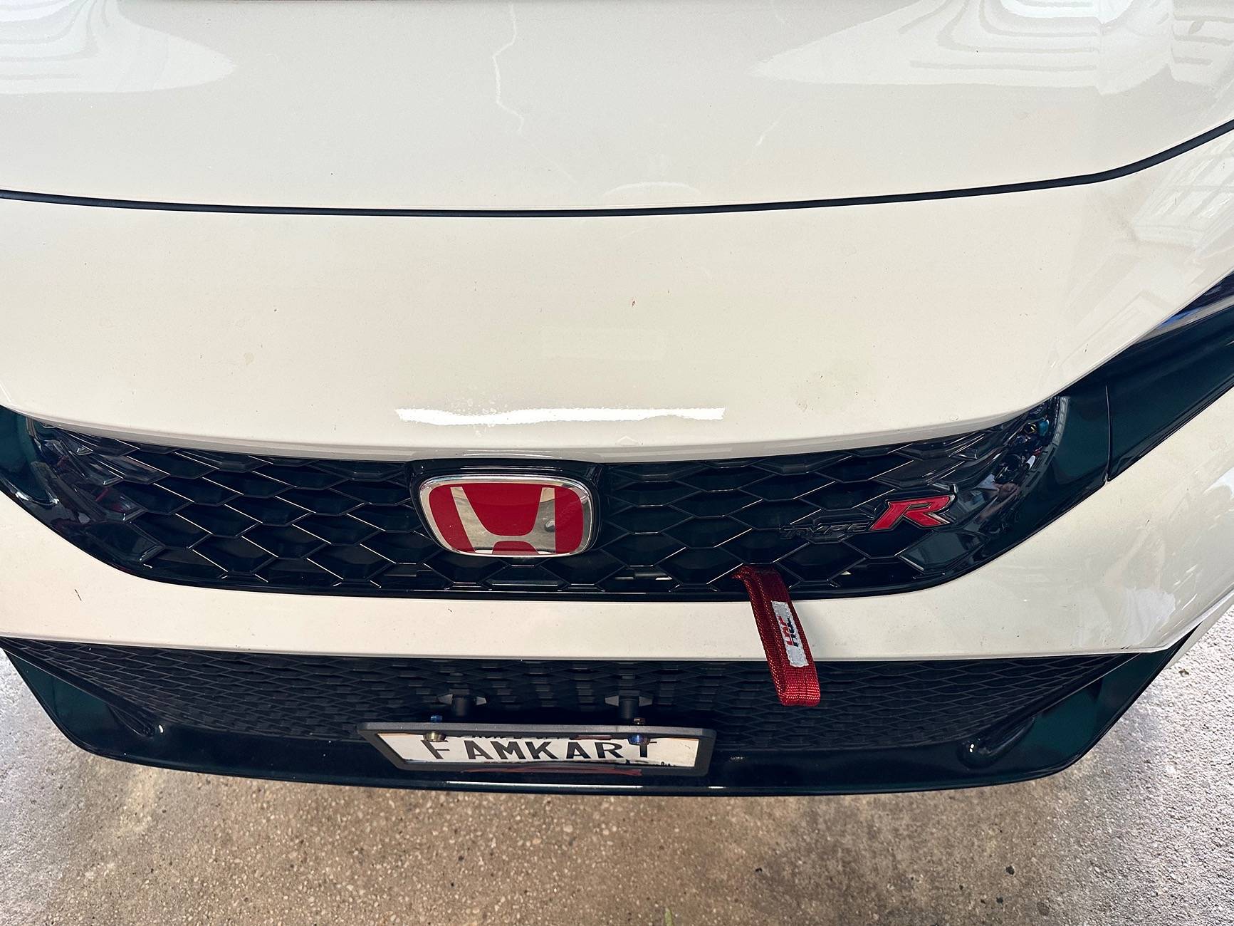

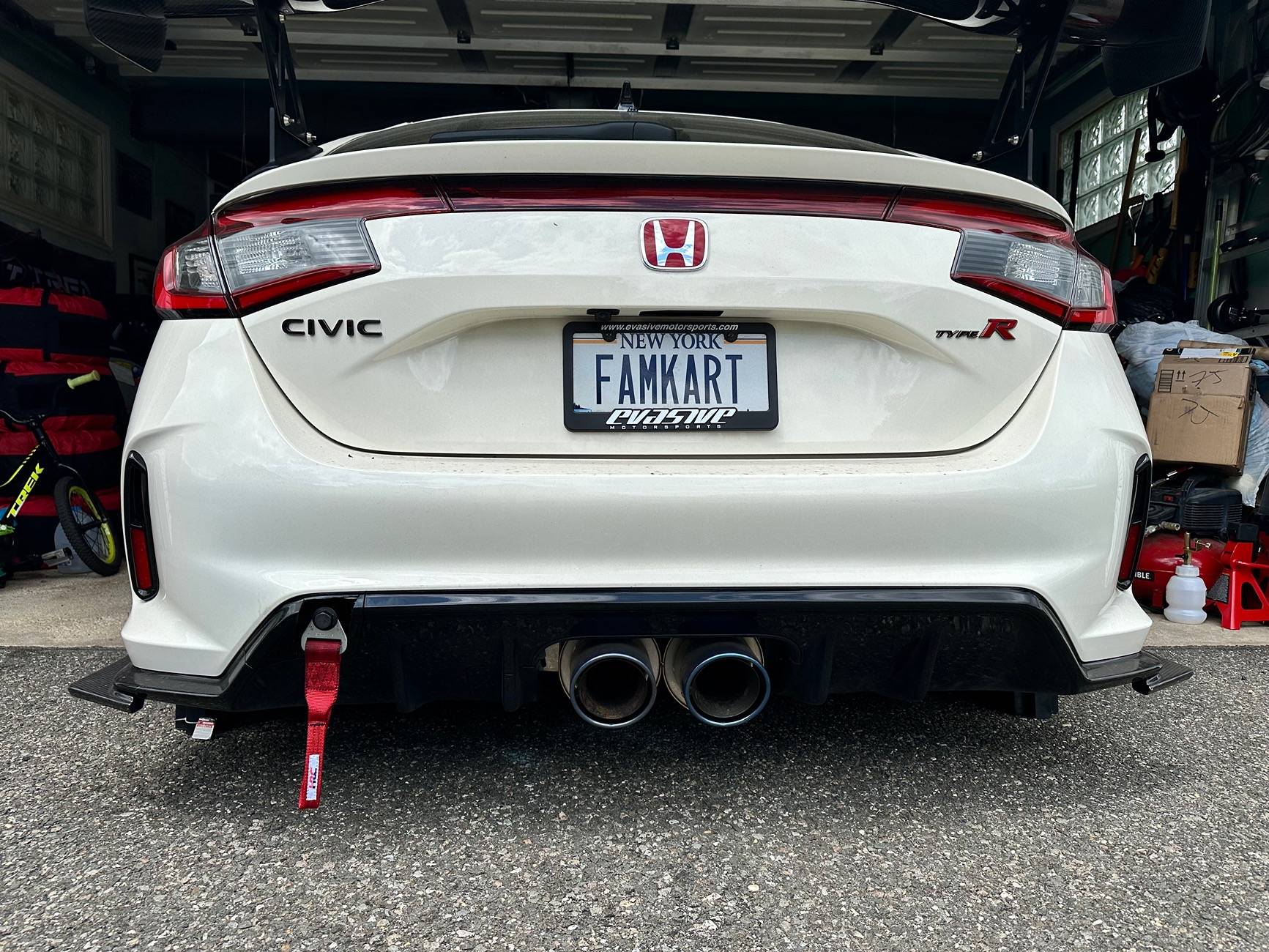

I got mine installed a few weeks ago and it came out nicely I thought. The front tucks in nicely when not in use. The rear requires the Evasive tow hook shaft and boring out the hole a bit to allow the bolt to pass through and thread into the EVS tow shaft.

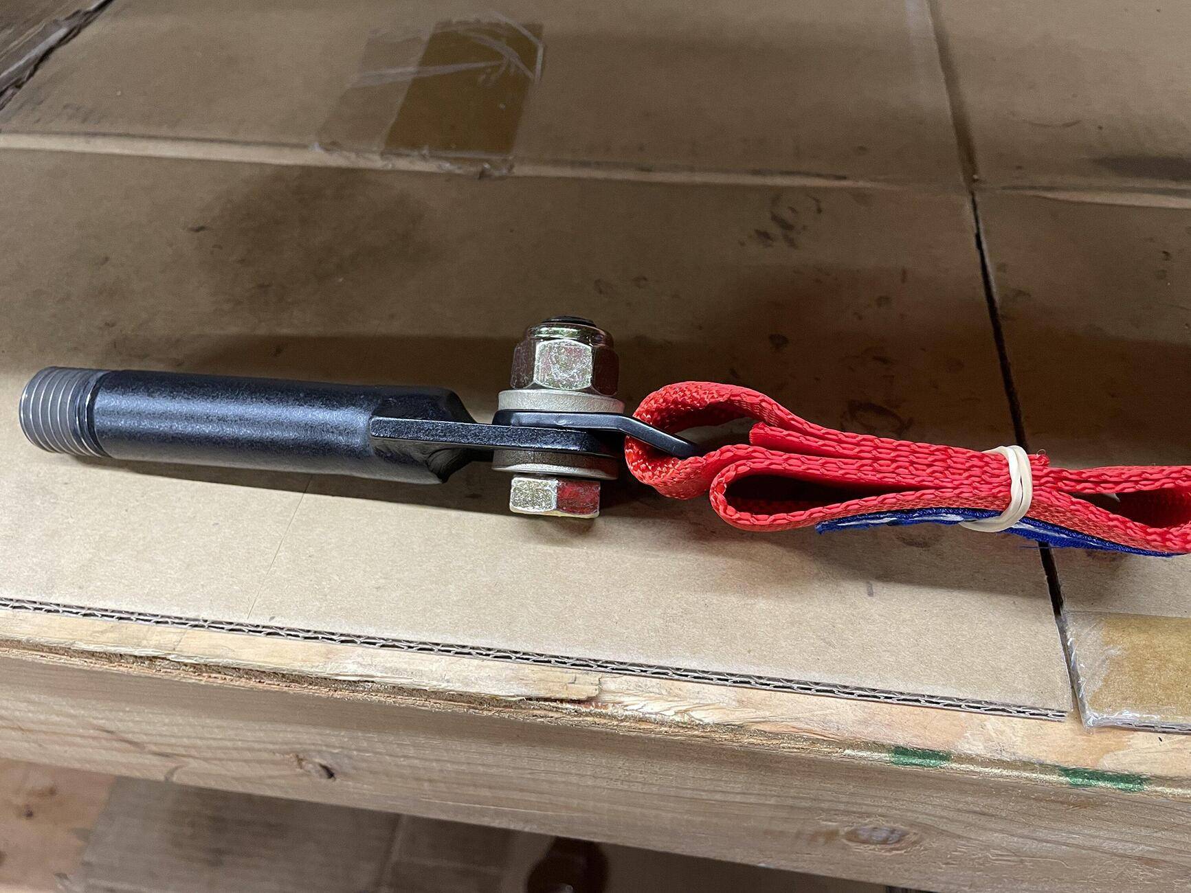

I got the new HRC tow strap kit since I was really curious what's included...
It did not come with instructions - it comes with a bolt, a washer, a nut, and a sleeve for the bolt - which is the "bumper beam spacer".
No instructions included.
