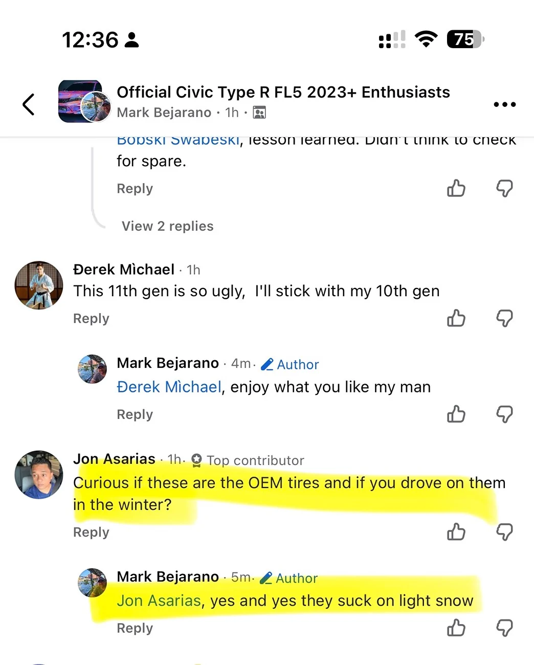

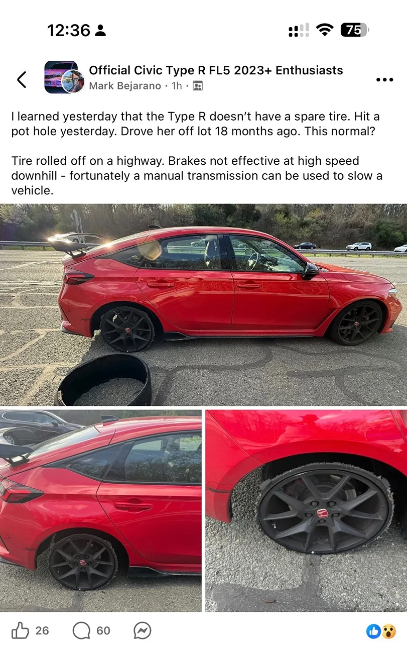

Asking the driver if he drove in 30* and below temps.
Kinda crazy to see the tire separate from just a pothole. Unless he kept driving on it for miles.
I’ve hit potholes and the worst I ever got was a flat tire, haven’t had a tire separate like that.
