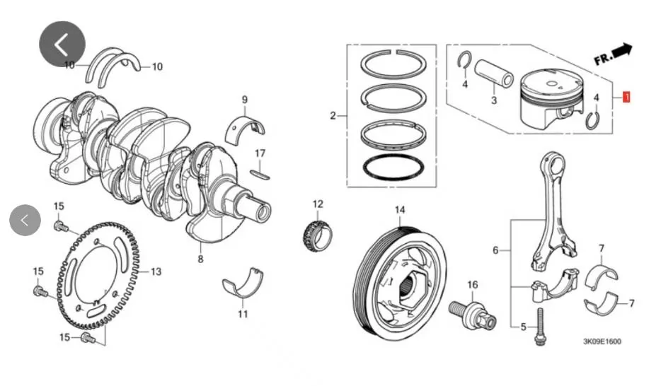

I’m planning to try using the crankshaft from the 10th-generation Civic to complete the engine rebuild for the 11th-generation Civic. I’ve noticed that the parts I need to replace are mainly focused around the mid-block, such as the oil spray nozzles and bolts, etc. I intend to perform the replacement after assembling the mid-block. I’ve also found that the timing gear (part12)and pulley(part14) are different. I’m unable to compare the differences between these two parts across the two generations of Civic. I just want to ensure that when using the parts from the 10th generation, I’ll be able to assemble the mid-block back into the 11th generation engine bay.

There are aftermarket options now for rods and pistons. Just reuse your crank unless it's screwed as it is larger on the CA. Block is the same and you can buy sleeved blocks already.

Thank you for your response. I’ve noticed that TSP is already selling aftermarket rods, but they are H-beam type. My engine rebuild experience is very limited, so I want to simplify the process as much as possible. I don’t want to modify the mid-block to accommodate H-beam rods, and I’m inclined to follow solutions from experienced 10th-generation Civic owners, as these solutions have been proven to achieve high horsepower while keeping the parts cost lower. I consulted with other enthusiasts who have used the 10th-generation Civic crankshaft for rebuilding the L15C, and they recommended that I purchase the crankshaft, corresponding timing gear and pulley, as well as the aftermarket pistons with dual-injector oil spray nozzles. I think I’ll go with this solution.

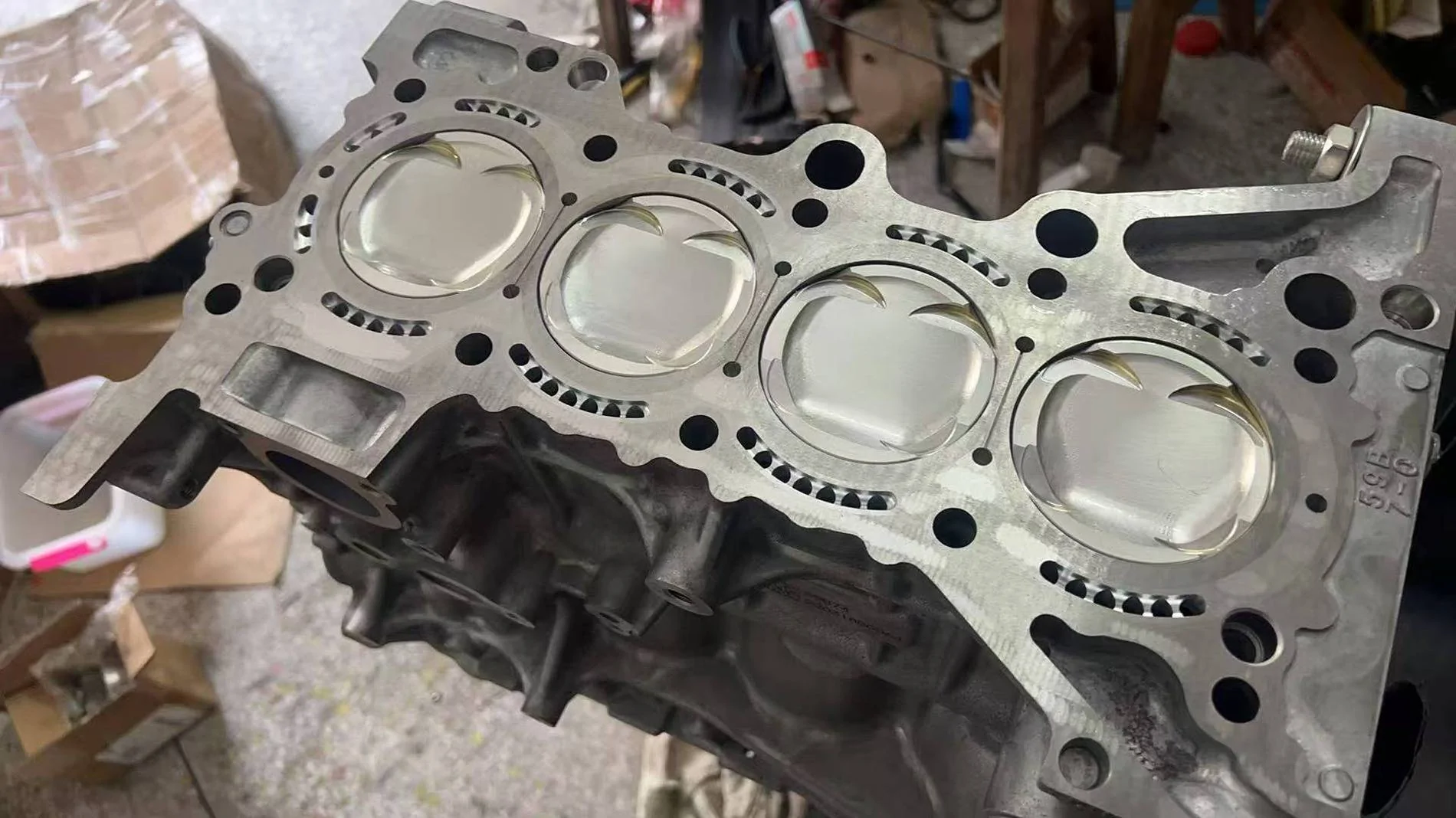

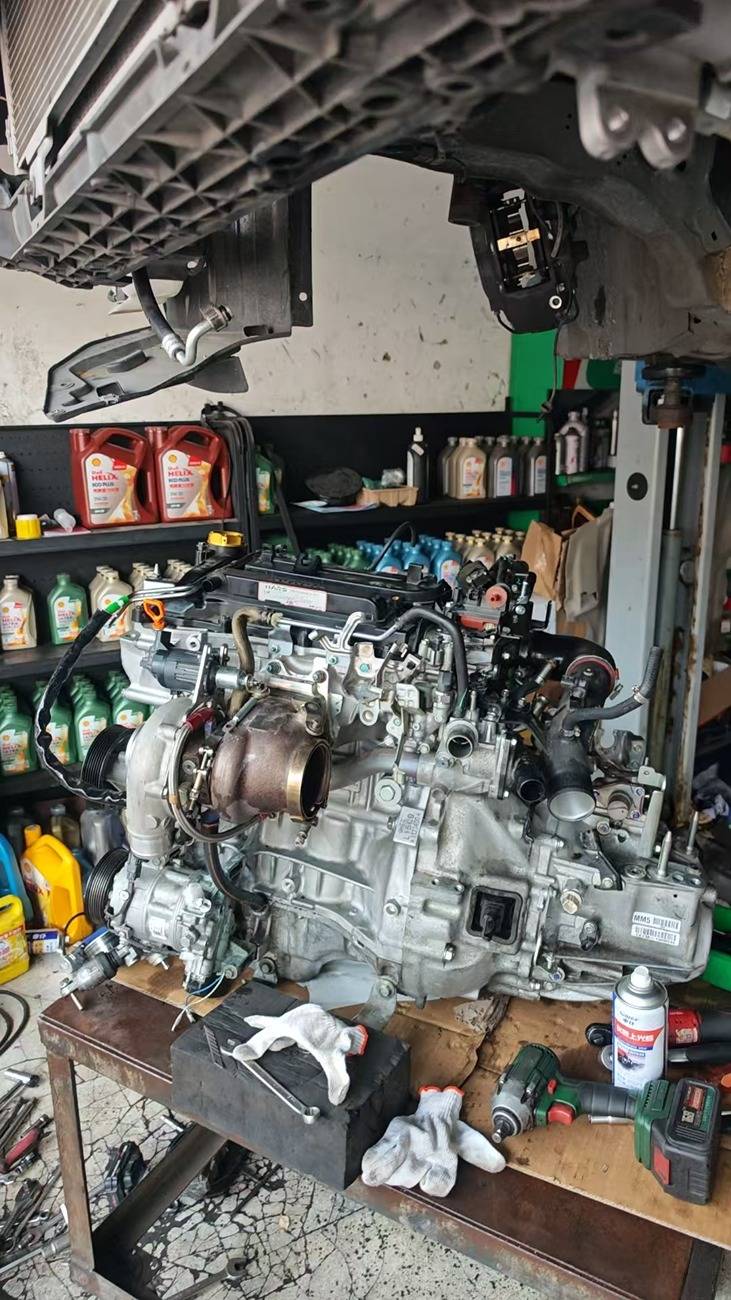

Let me give you a progress update. In the end, I used a brand-new 59B engine block, which includes additional water jacket support. Inside the block, I used a 10th-gen Civic crankshaft, forged connecting rods, forged pistons, and oil squirters. You will need to continue using the 11th-gen timing gear and crank pulley.
For the cylinder head, I replaced the intake camshaft with the Chinese-market CR-V version. It should have a 39mm high-pressure fuel pump lobe stroke, similar to the Si model. I also replaced the high-pressure fuel pump and injectors with the 2.0T 6B2 versions.
So far, everything is running fine. However, the coolant temperature behaves a bit differently—it tends to run hotter. I suspect this is due to the combination of the water jacket support system and the 11th-gen water flow guide plate, which may be reducing the coolant flow. Perhaps using the 10th-gen flow guide plate would result in better coolant temperature performance.
