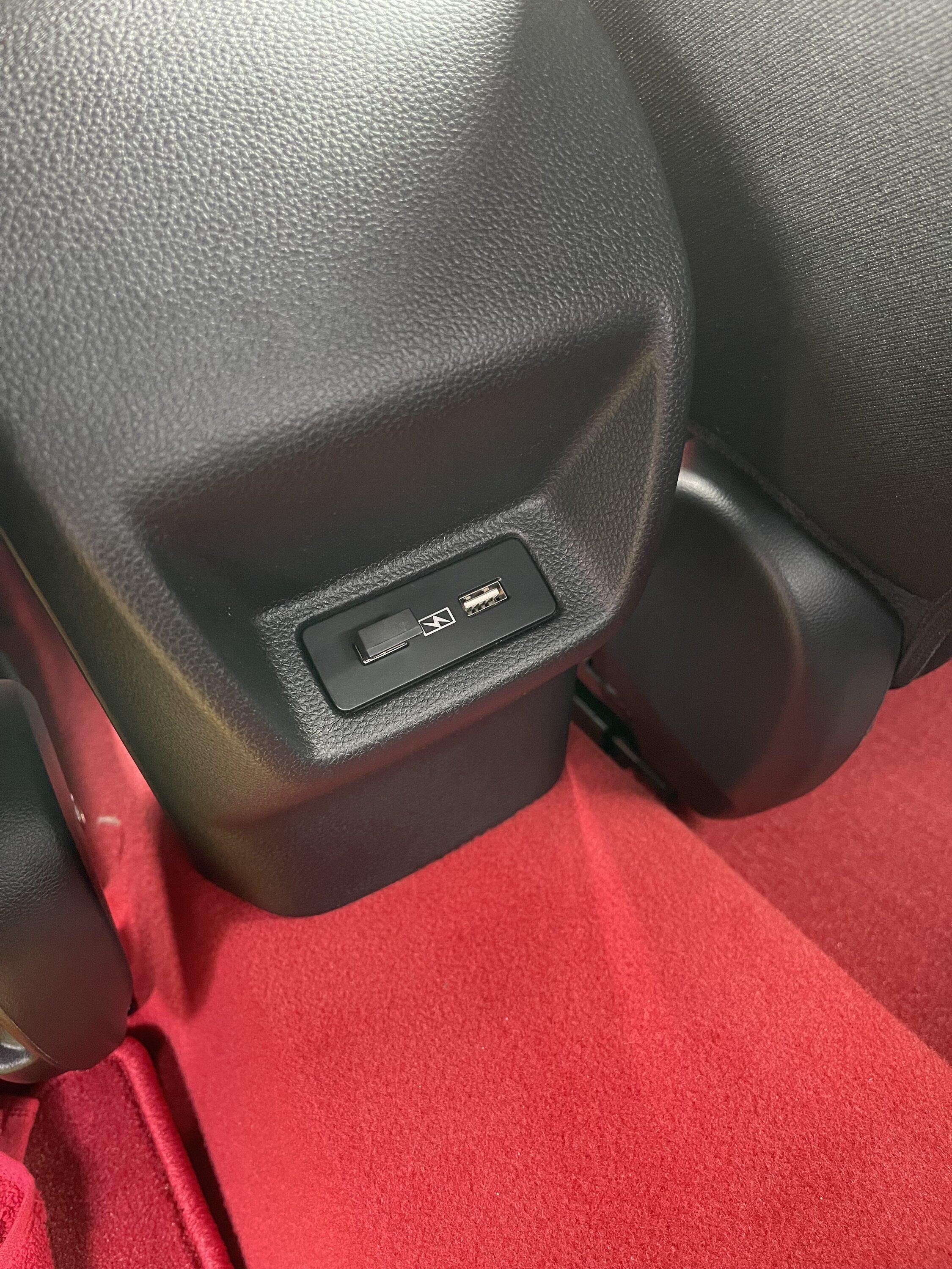

Decided to add a few USB ports to the rear seating area..:wave:
Very nice. I may change my front ones to USB c. Not sure wtf Honda was thinking with USB A. Then I'll use that one for the rear if its all the same

Did you grab this part from a regular civic?

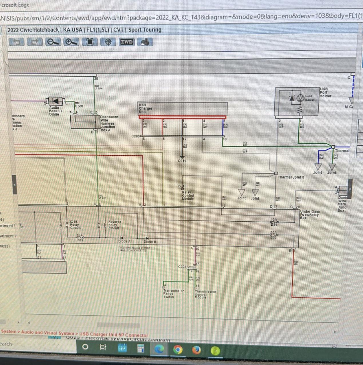

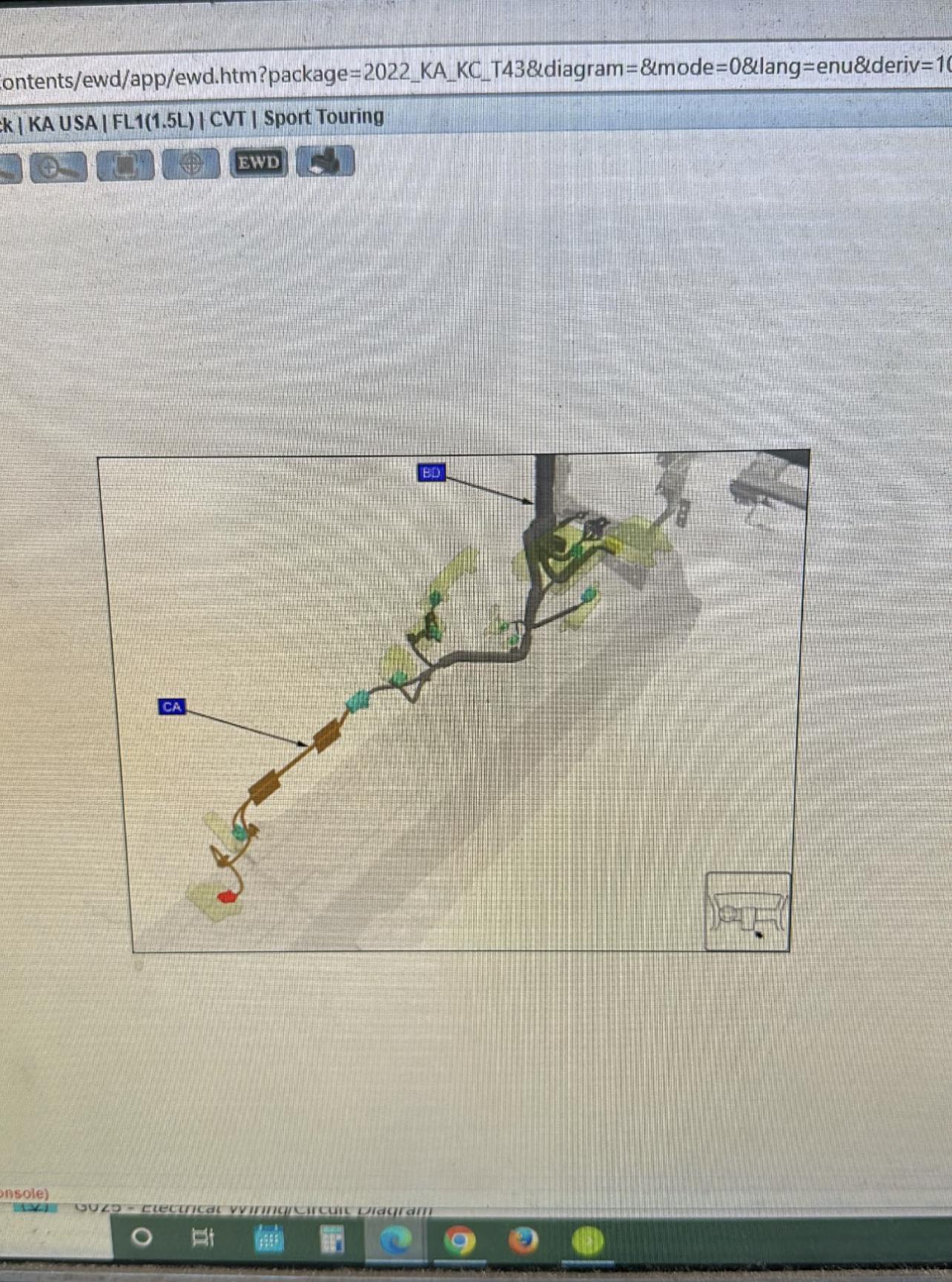

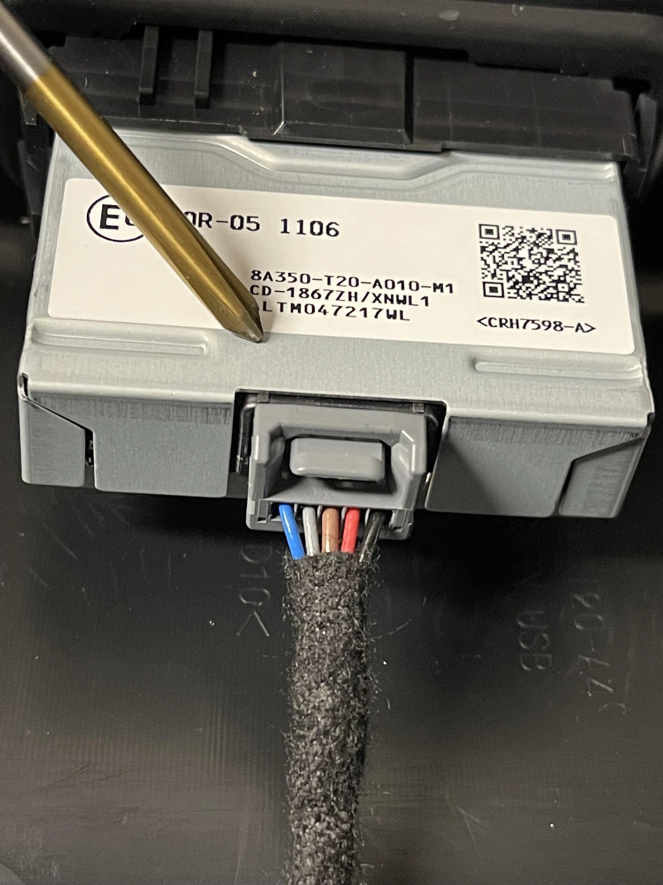

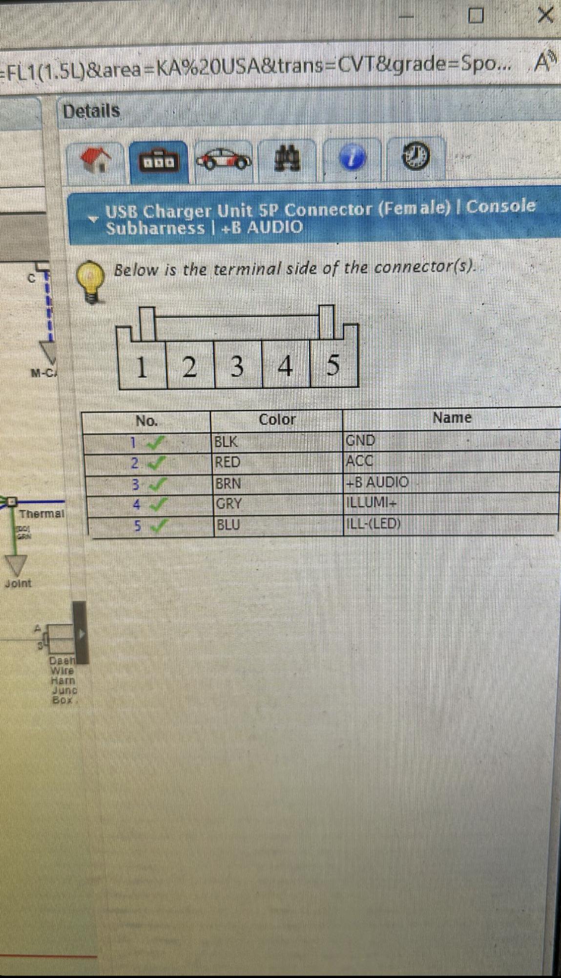

I used the Touring Civic 6spd part but I had to make a custom harness for it since the FL5 doesn’t have the plug in location like the Touring version does…
You have to find basically the following.
USB-
USB+
Ground
Positive
Illumination+
was a PITA and I have been making the harness to allow this to work for 2 weeks.
