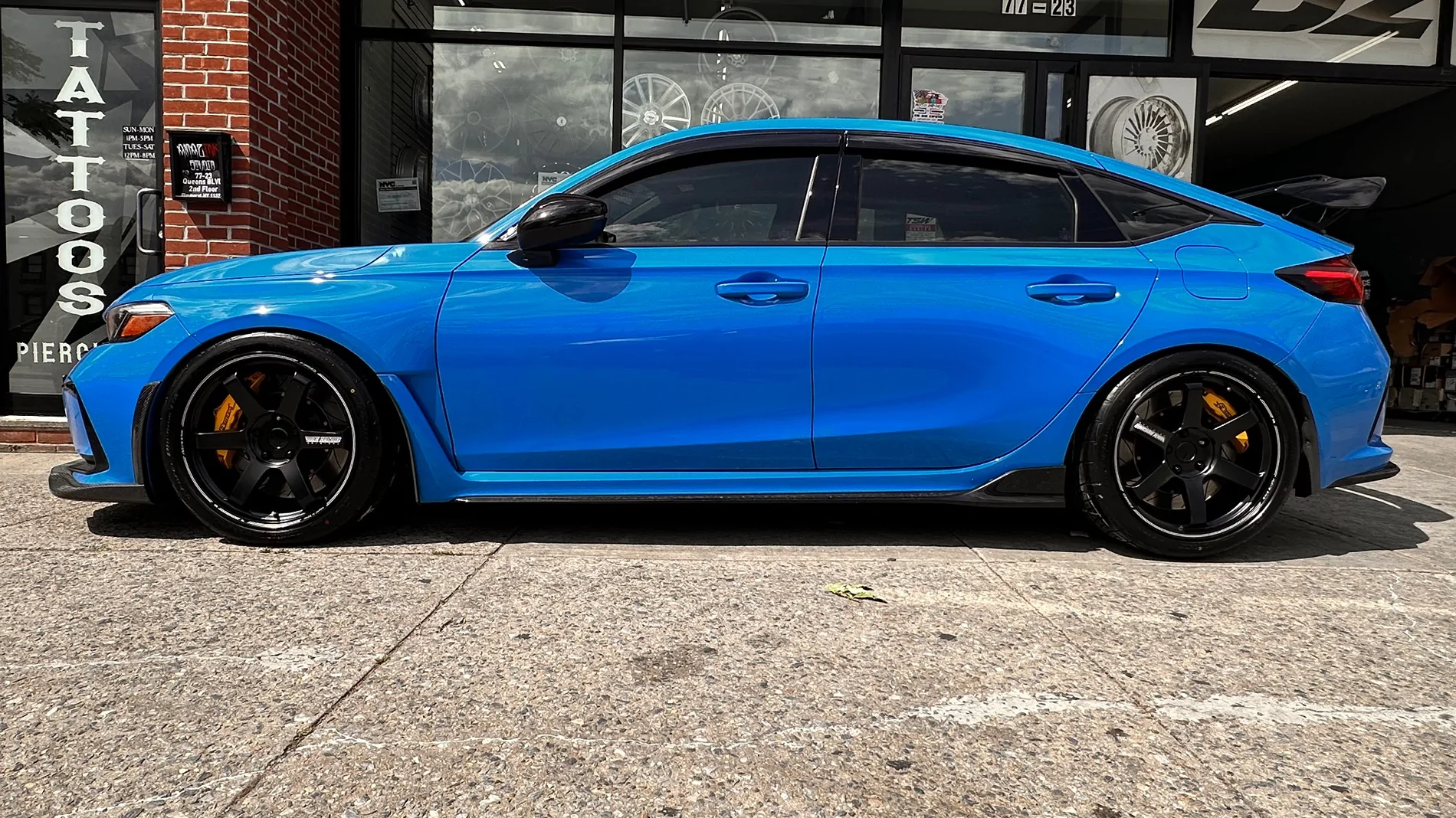

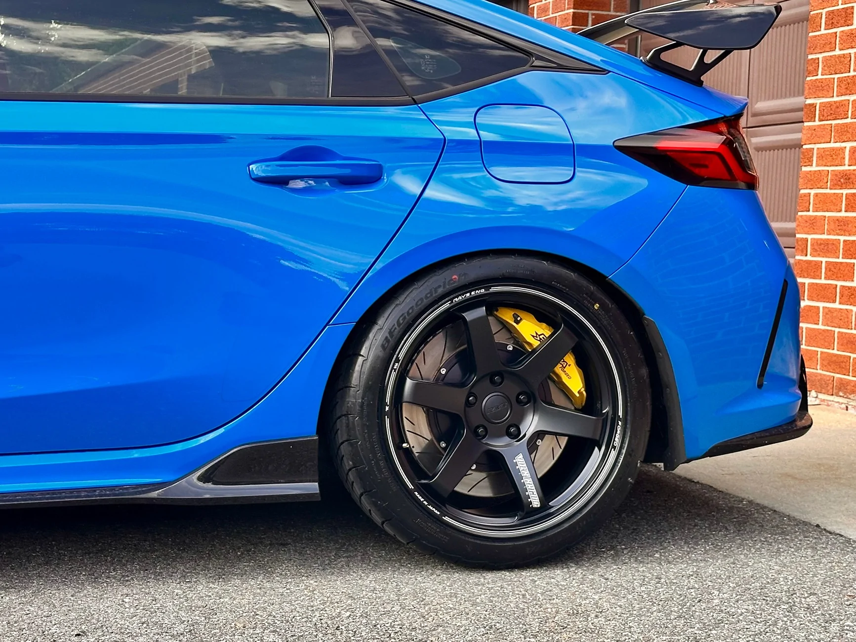

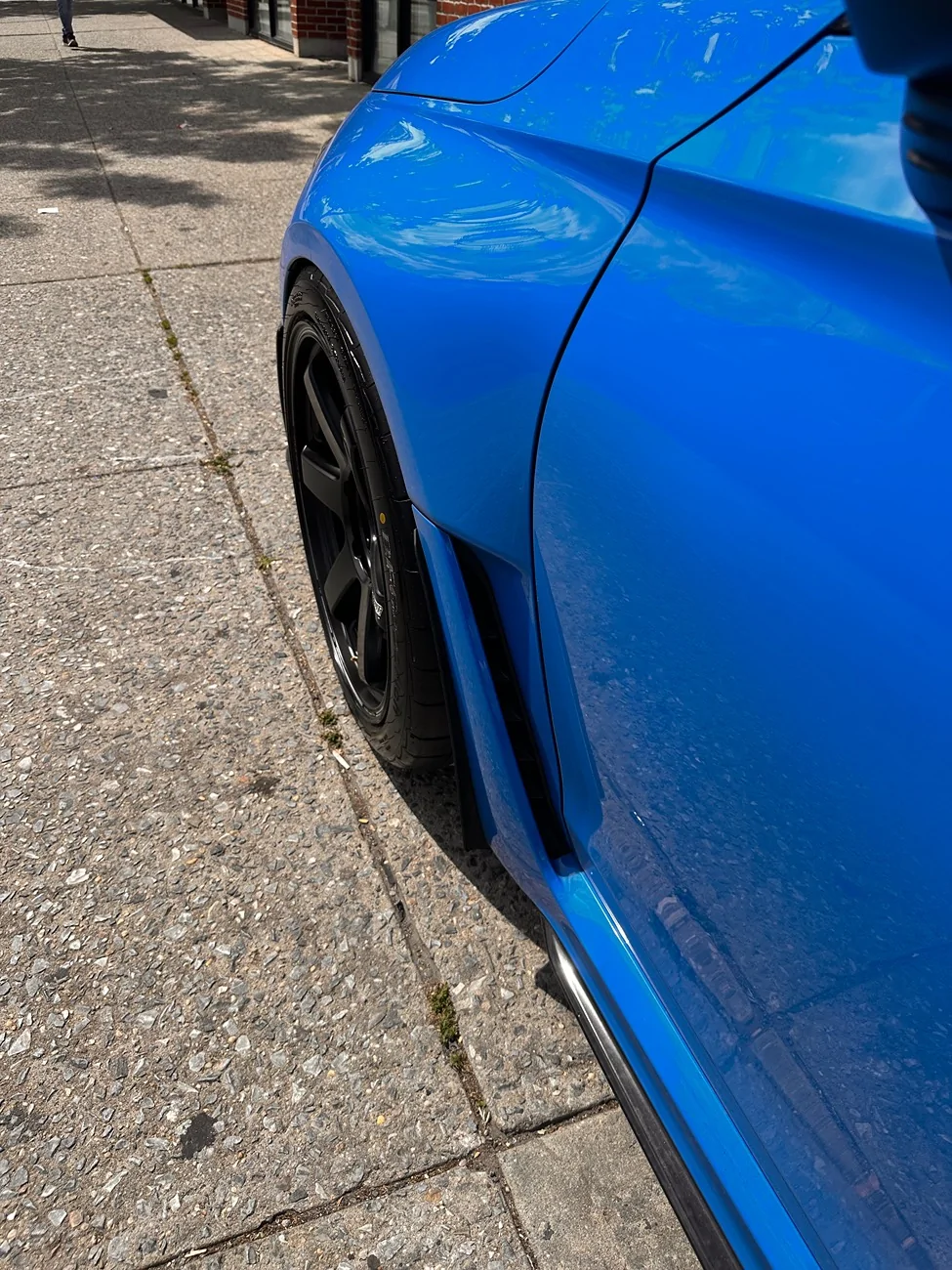

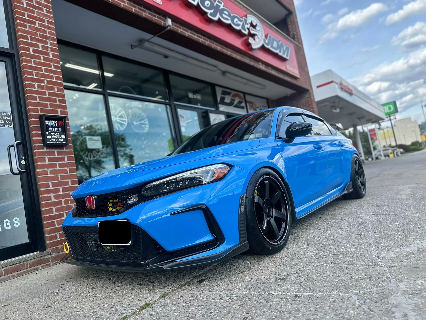

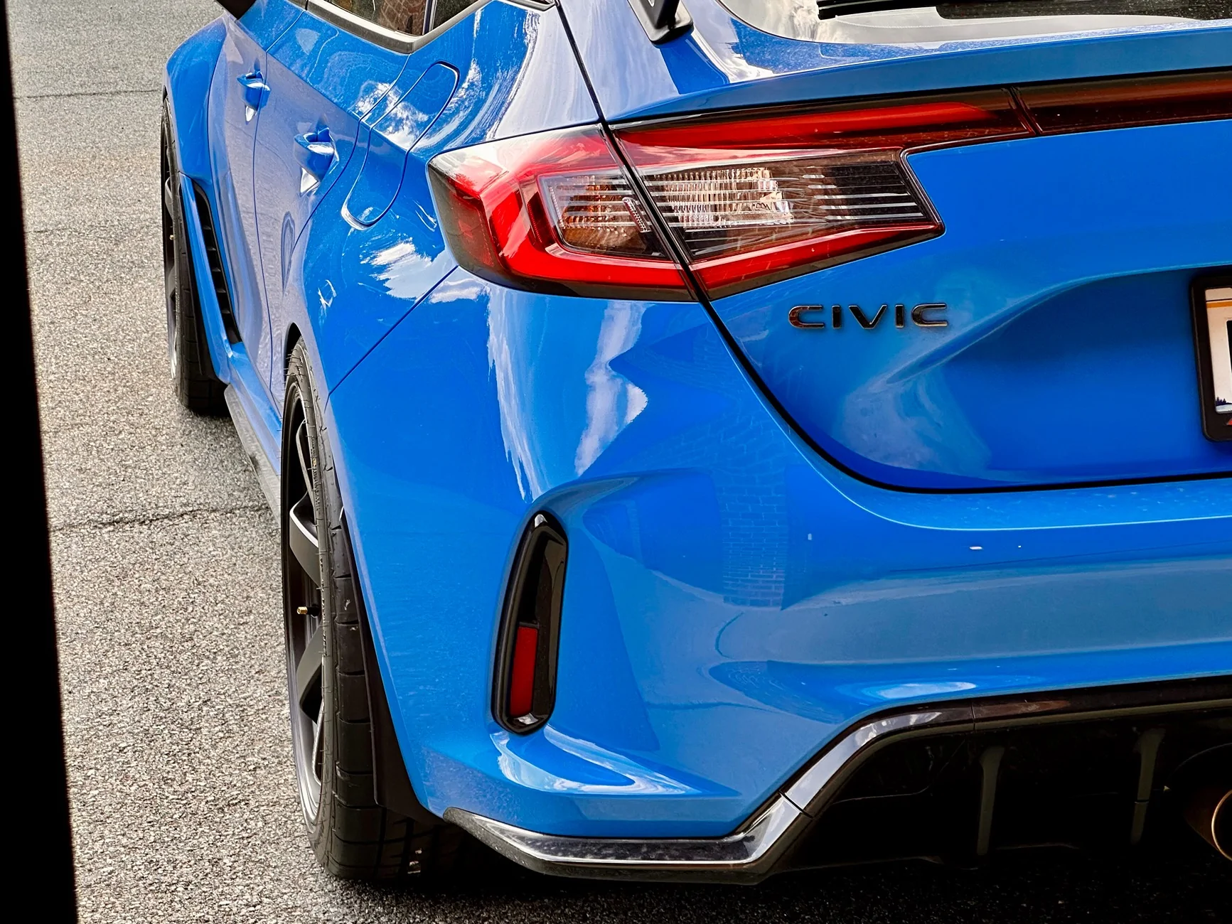

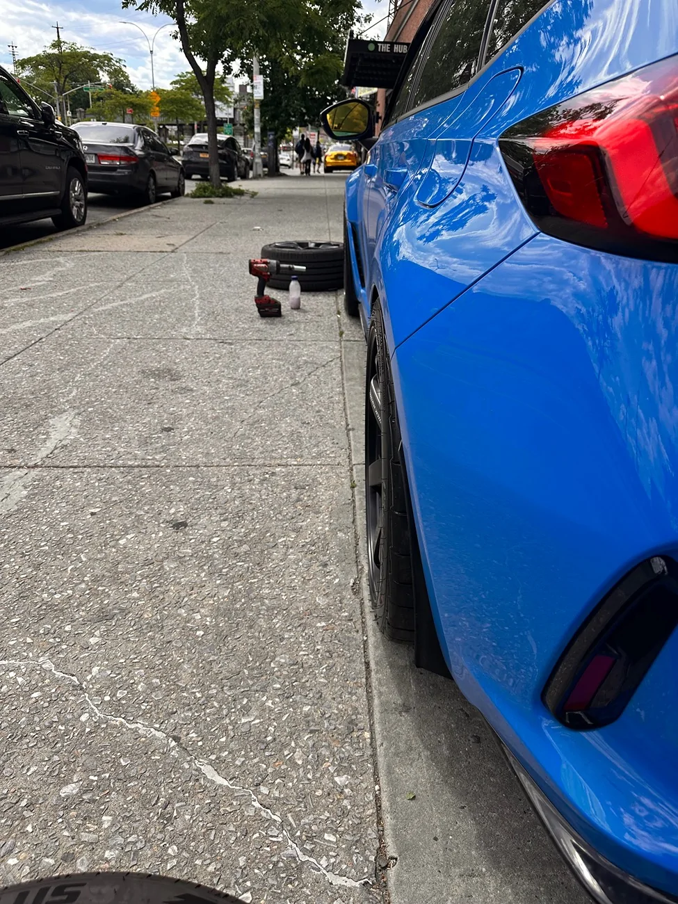

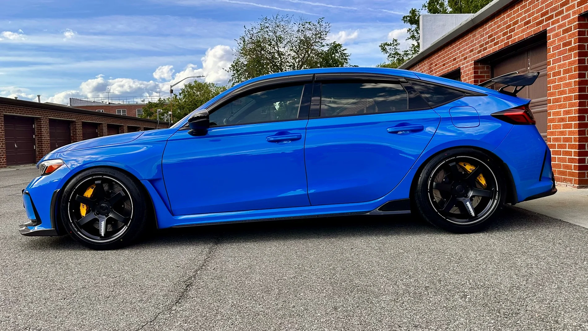

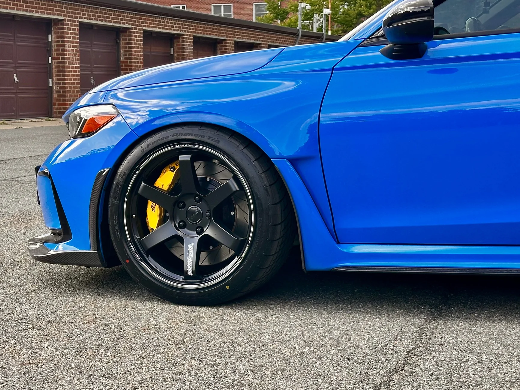

As promised, wheels are mounted. I’ll let the suspension settle in then make final adjustments. Here’s how she sits for now.
Looks awesome! 🤩 Those are 19x10 +40? Any rubbing? How low did you go with your coilovers? I’ve been eyeing some in 19x10 +37 but I’m pretty sure I’d have to add a bit more camber to not rub my 265/35 R19 AD09s. Im lowered ~20mm vs stock and already rub occasionally with stock wheels at +40 with spacers. Man TE37s look incredible on this car.

Yeah these are 19x10 Et40, center Hub 64.1mm. Tires are “BF Goodrich G-Force 265/35r19 Summer tires. No rubbing at all. I had the RSR coilovers first on my FK8 for almost 1-1/2, and now i have them on my FL5 for about 2-3 month now give or take. I’m maybe .7” drop front and rear, so roughly (17mm)

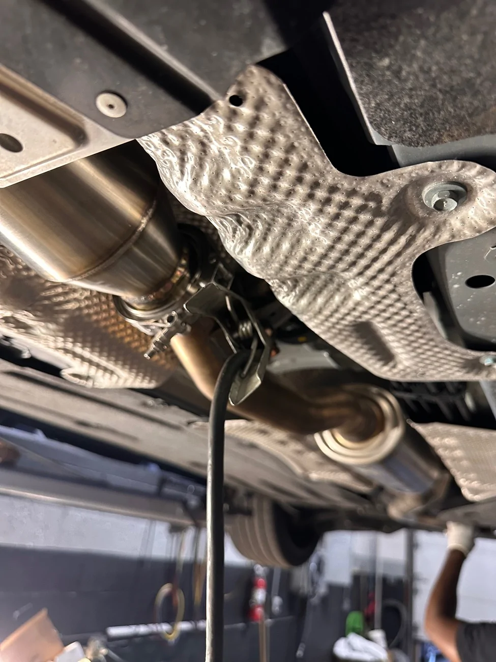

I did the exhaust valve fuse mod today. A very mild difference, makes me want to take out the front resonator too...

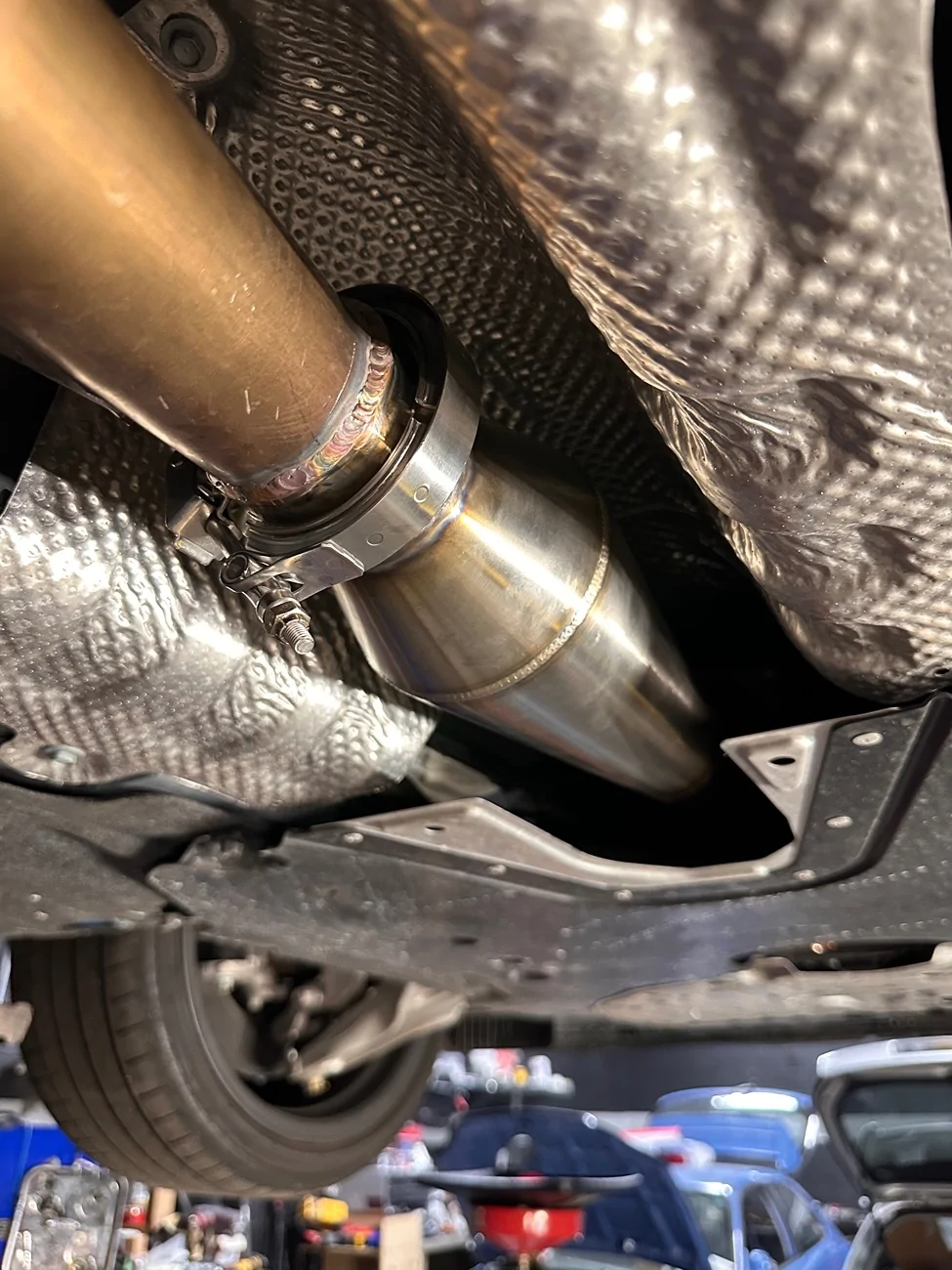

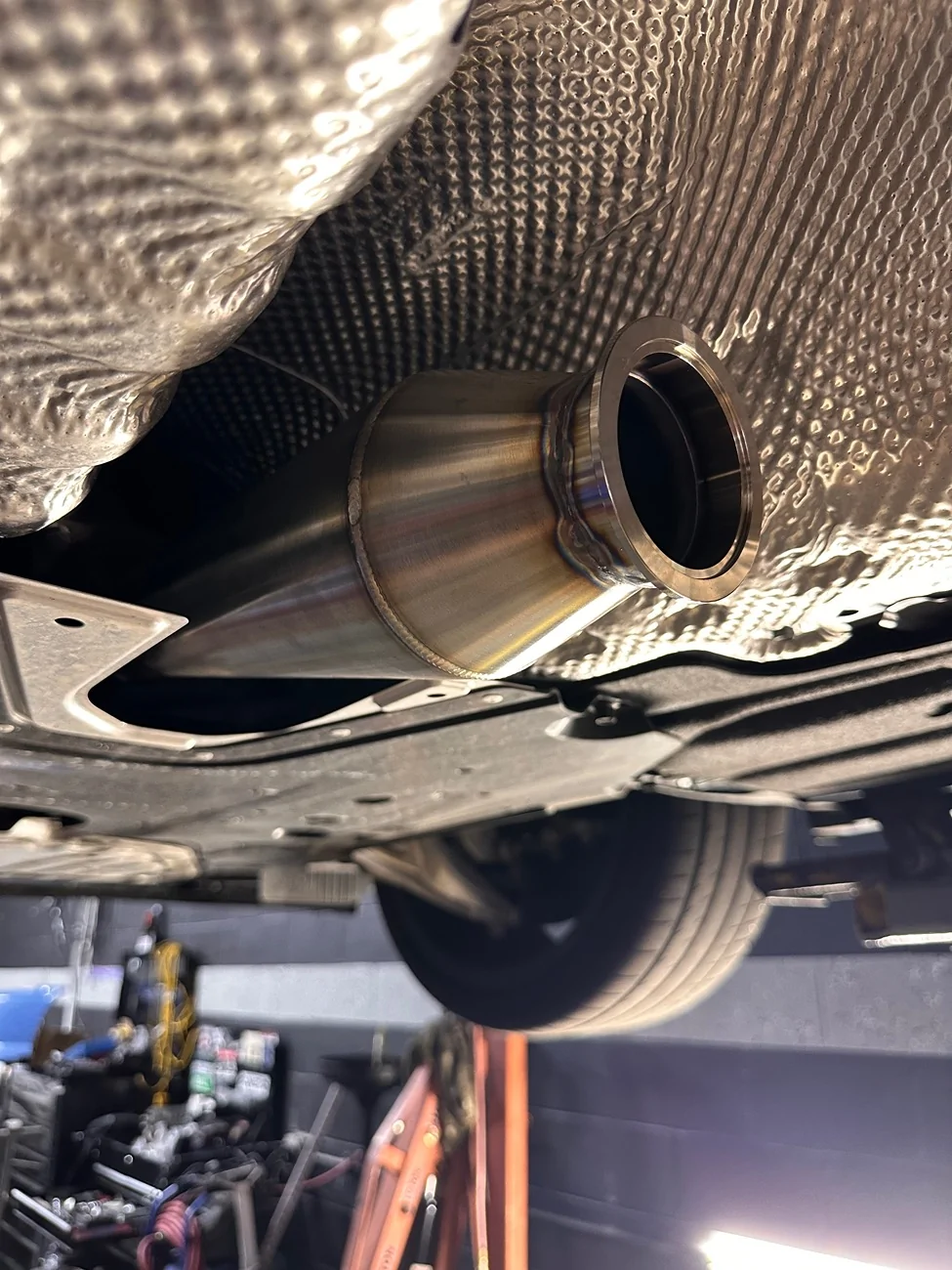

I took a different approach with my OEM exhaust, removed the front resonator and installed a Megaphone in place of it. Then took a full 3” front pipe and tapered it down to 2.5” where it meets the exhaust. left the 3” as is where it meets the DP. Sound is definitely much more noticeable with the valve open.
11th Gen Honda Civic What did you do to your FL5 today? IMG_3959
11th Gen Honda Civic What did you do to your FL5 today? IMG_3957
11th Gen Honda Civic What did you do to your FL5 today? IMG_3949
