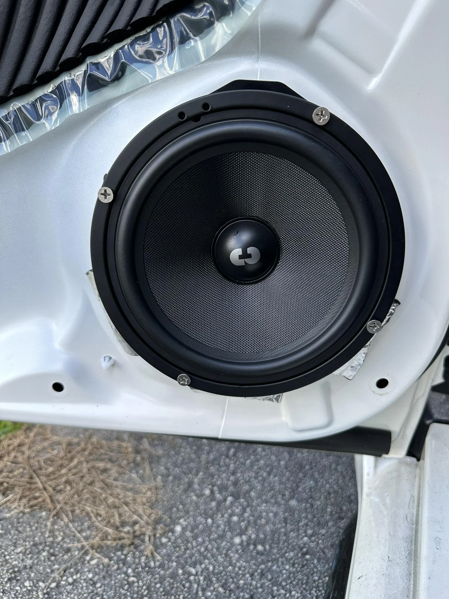

Washed the car and took off the rear door panel to check the ohm measurements of the drivers and see how they are mounted.
I've measured all of the drivers excepting the 3" pair in the hatch, based on what I've seen they are 99% 4ohm. ALL drivers EXCEPT the front door 6.5" drivers are 4ohm. The front door 6.5" drivers are 2ohm. Would be nice if this factoid could be put in a FAQ but it doesn't look like anything has been built yet.

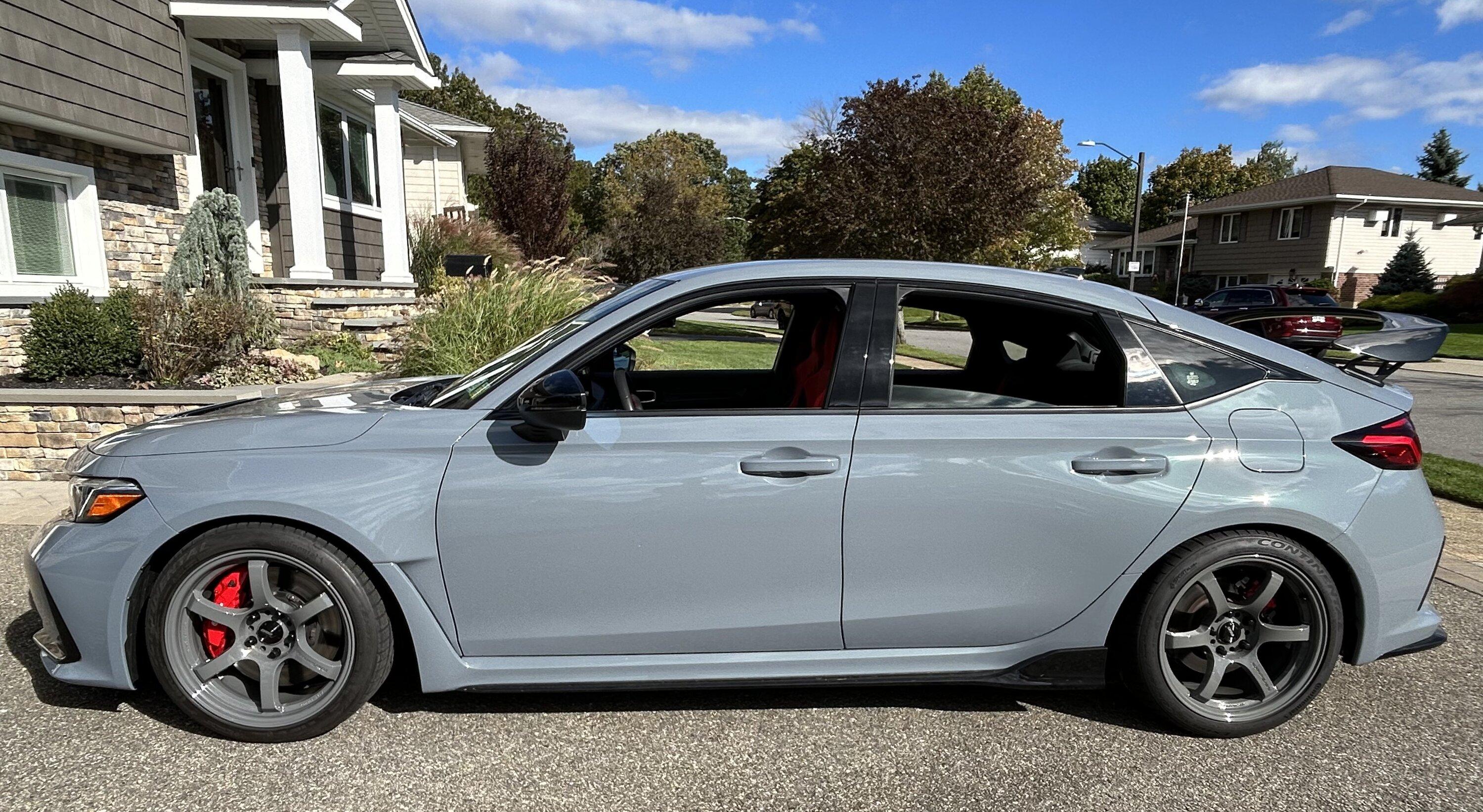

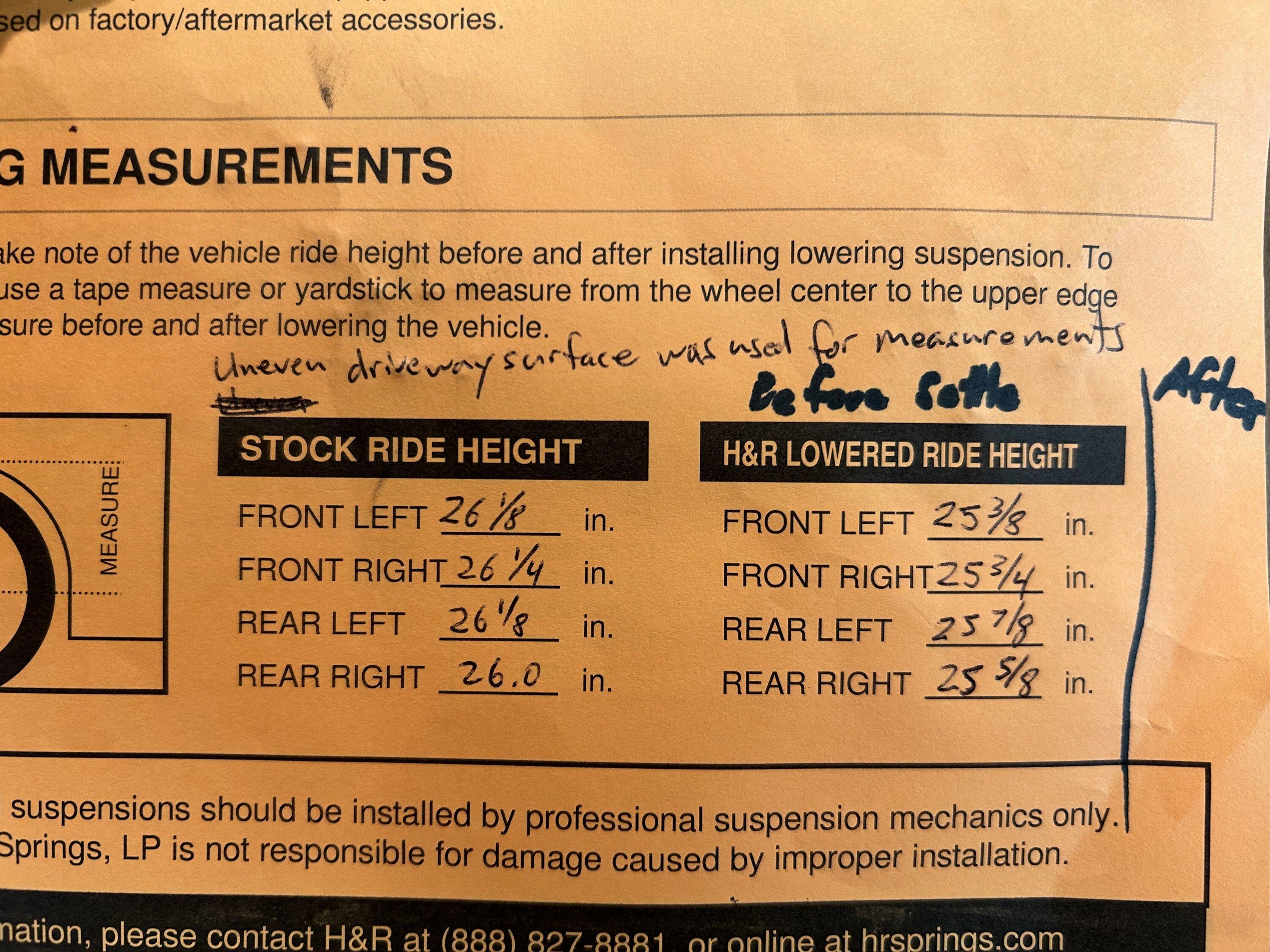

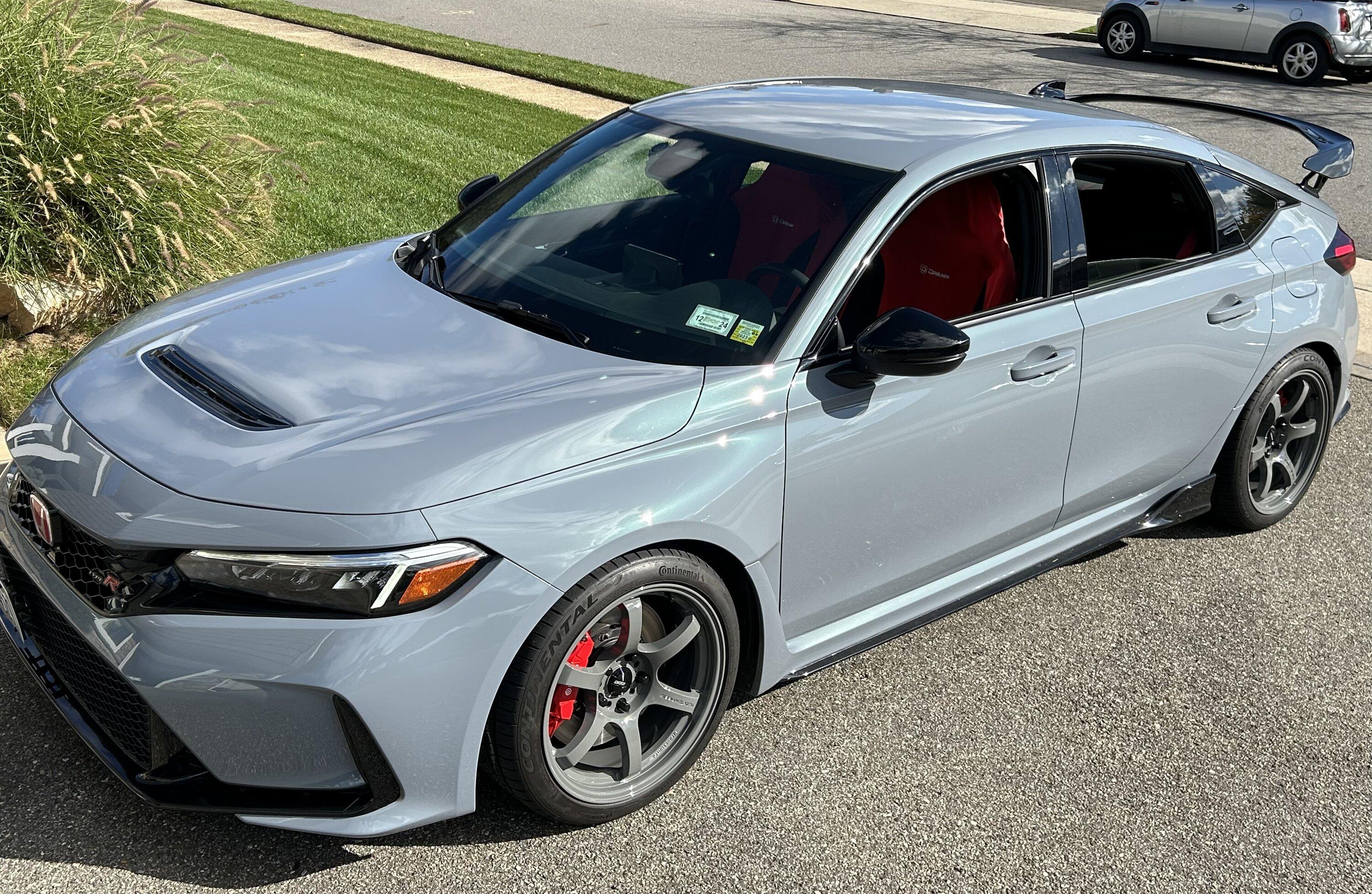

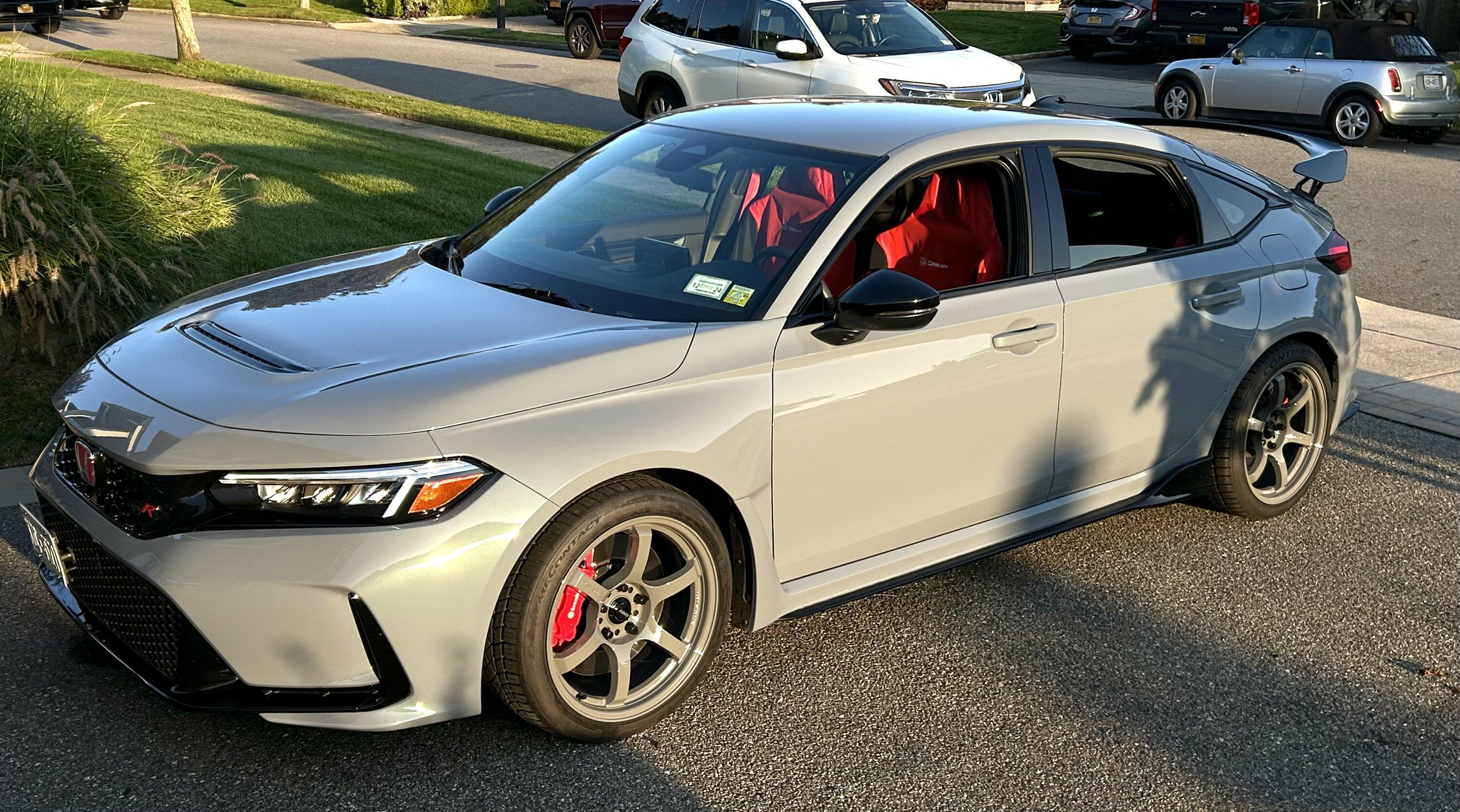

Installed the H&R Sport Lowering Springs for the FL5. Goal was not to be too low since I daily it and to ensure I don’t f-up the amazing suspension from the factory. Bought them from Unity Performance. It rides much the same as before. No strange noises, crashing or bobbling front to back. Love it so far.
While I had it apart I also added a protectant again for all those aluminum suspension bits ?
BEFORE

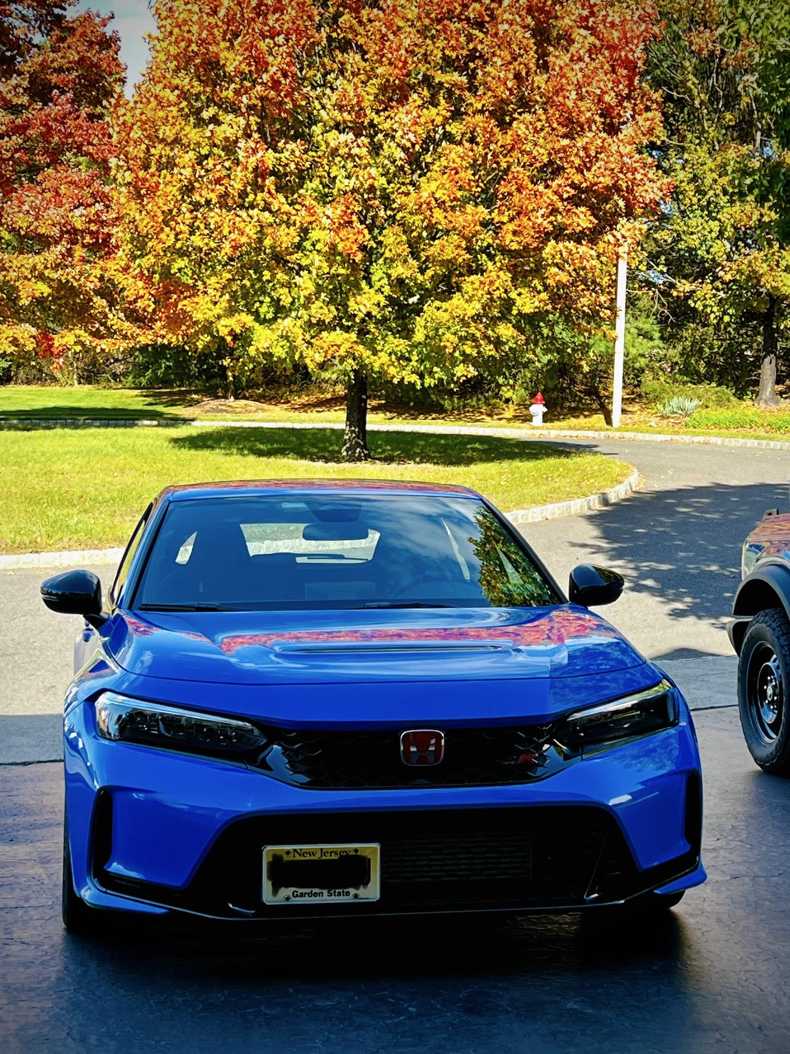

Quick simple mod - Sly Brackets front license plate holder. Simple install, really pleased with the results. high quality and all install parts included. Highly recommend.

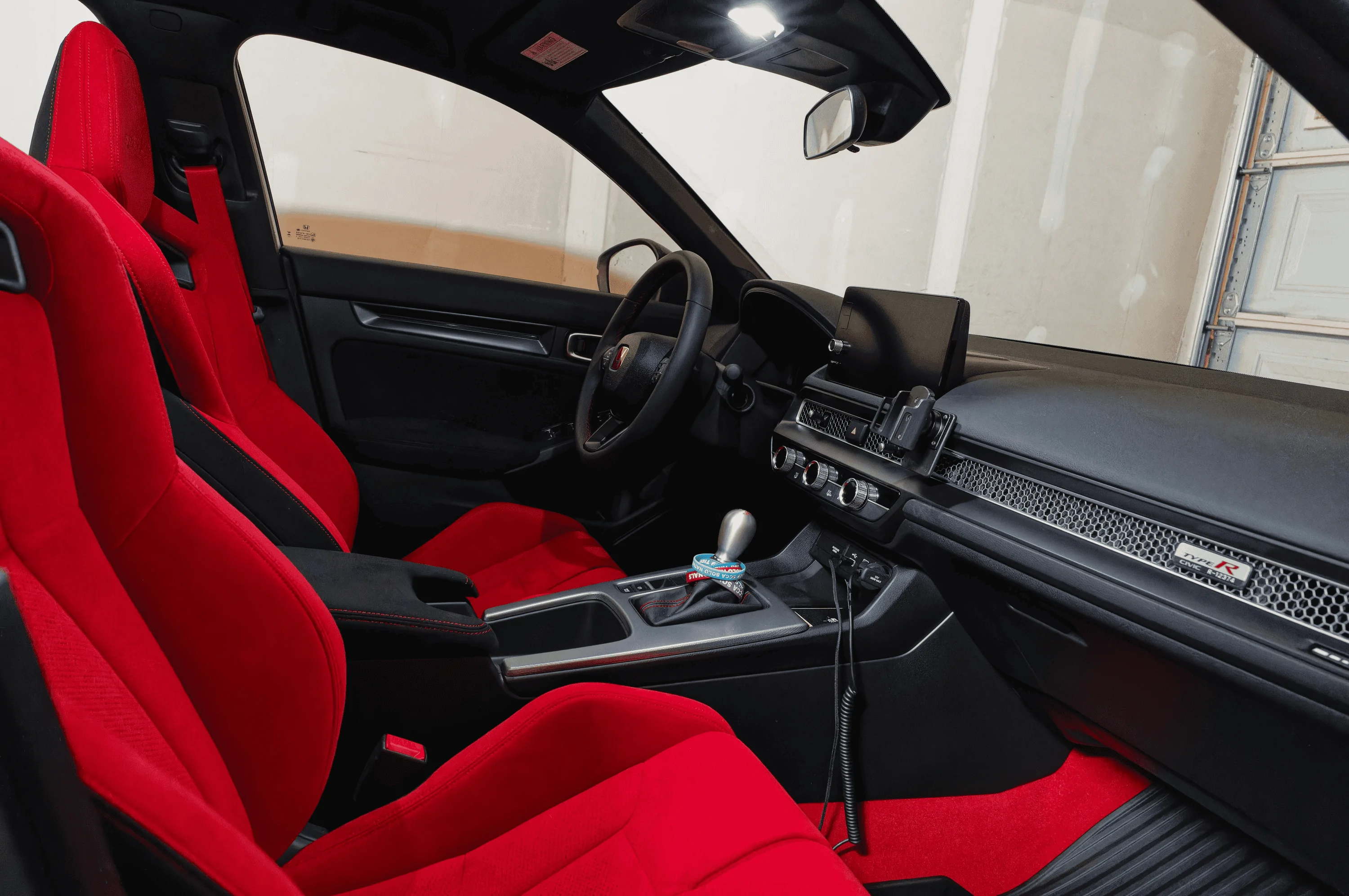

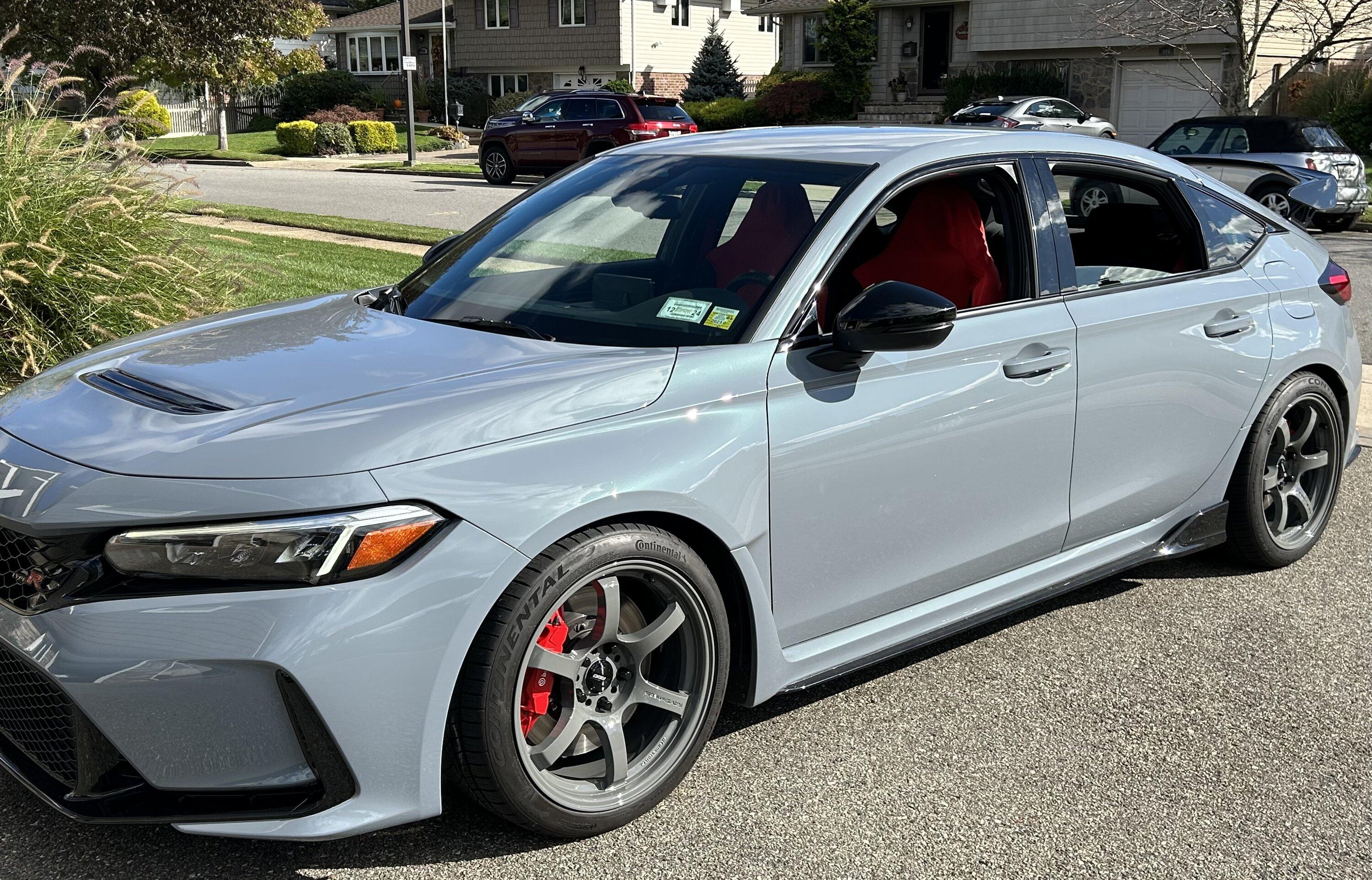

Swapped rear bulbs for LEDs last week, installed Proclip phone mount

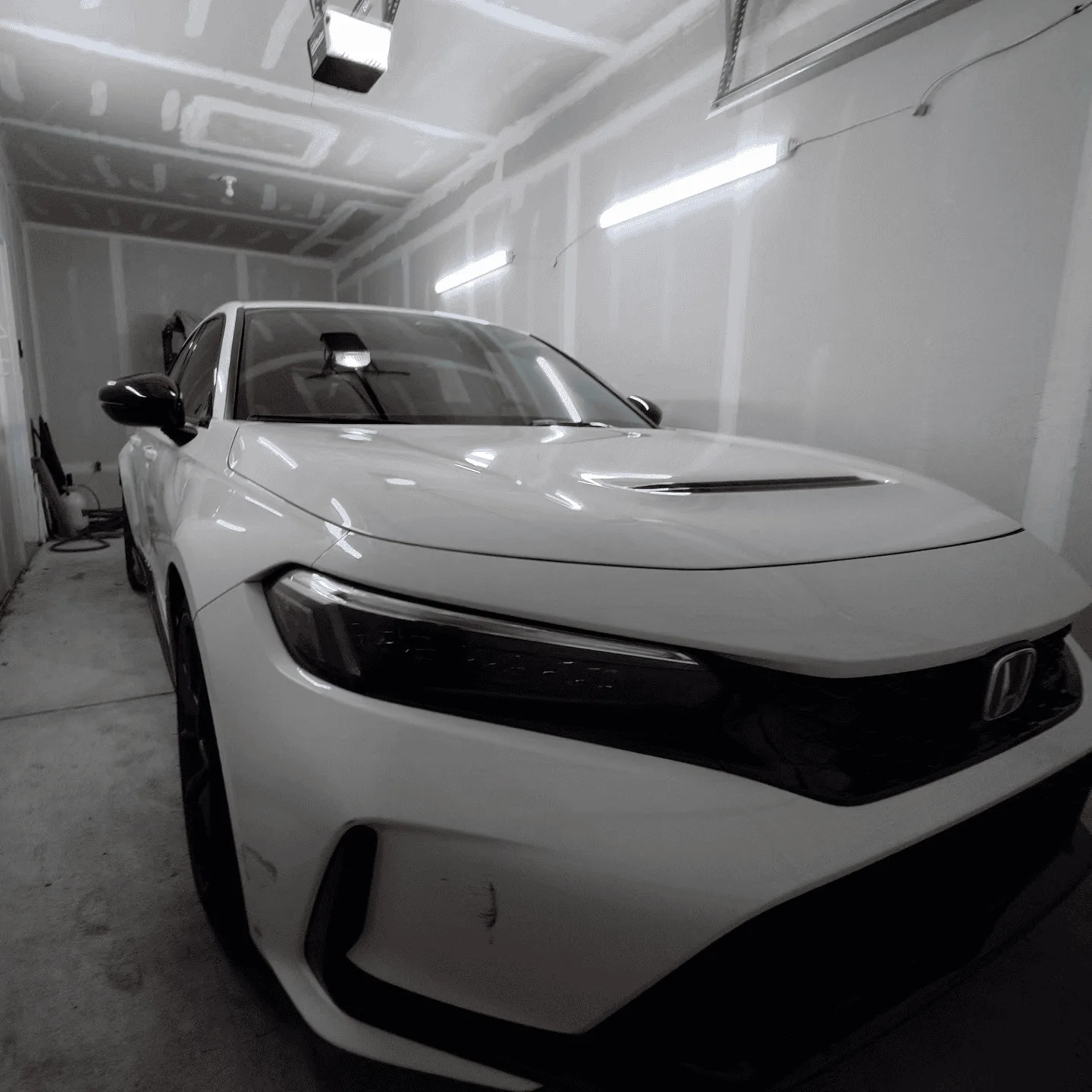

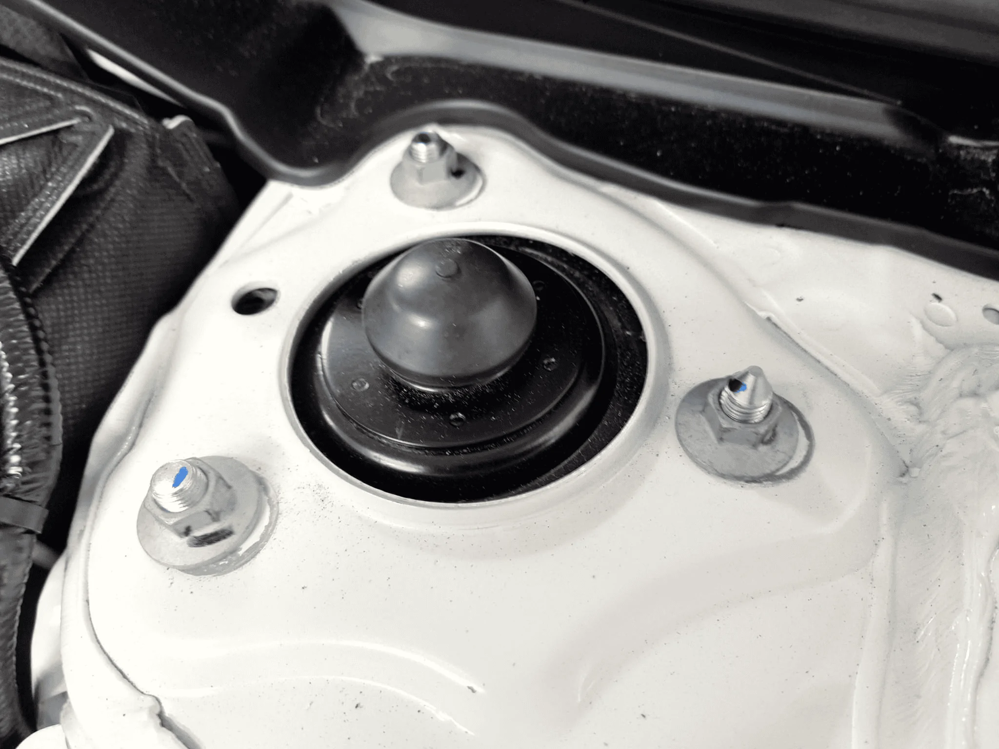

Over the weekend, did some antiseize application on some rear suspension bolts to prepare for winter, pulled front strut pins and maxed out the front camber:

For the strut pins, what did you use to pull and once you pull it, does it require alignment?

Lasfit was the LED I used, all the bulbs fit fine no issue.
The instruction for pulling the pin is to use a nut with a bunch of washer under the threaded part(washer stack has to be higher than the unthreaded portion of the pin) and just tighten the nut until the pin is pulled up. The nut I used was just the strut nut itself.
I used longacre toe-plates to check the before toe and once pulled and maxed out the camber I checked it again and I needed to basically shorten both sides by about 1 full turn of the adjusters on the tie-rods(6 faces). About to 1-2mm of the accuracy I can hold with the tools I got. I erred on the side of slightly toe-out. The stock alignment as per my measurement was close to 0 toe. Not sure what the spec from factory was. Afterward on the road the steering seems straight.
