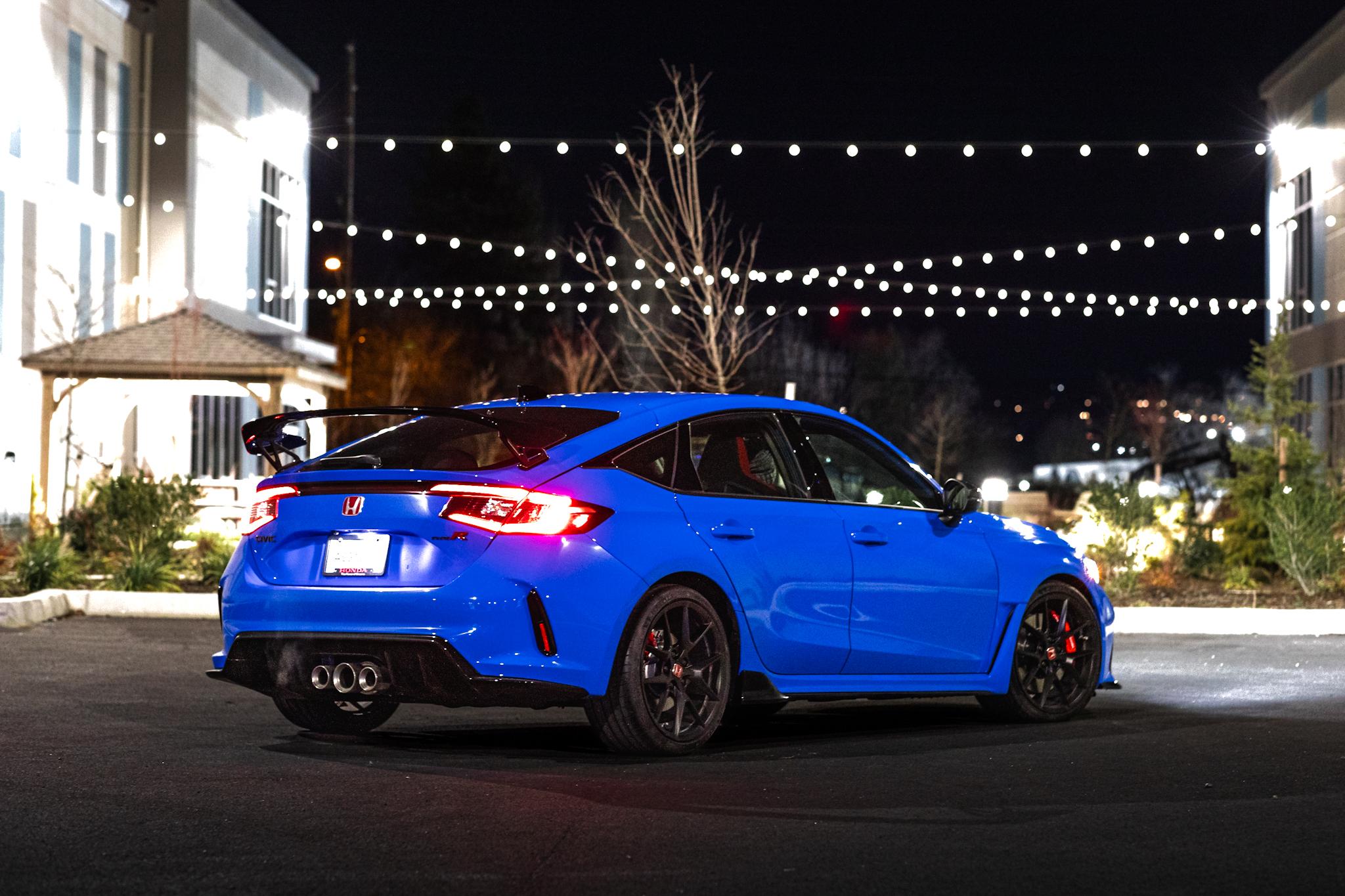

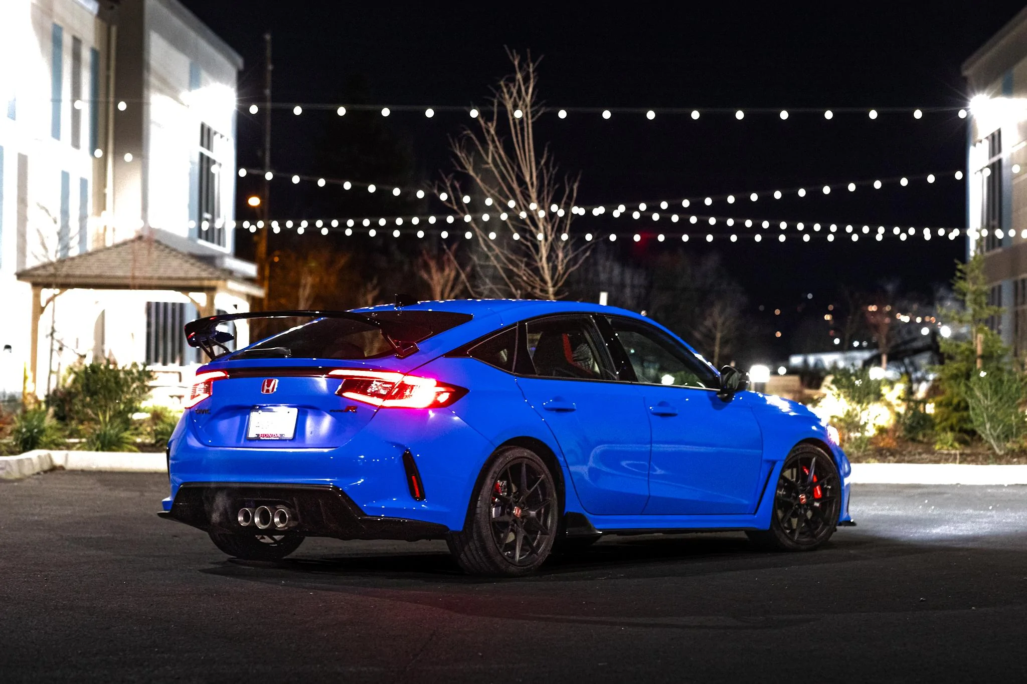

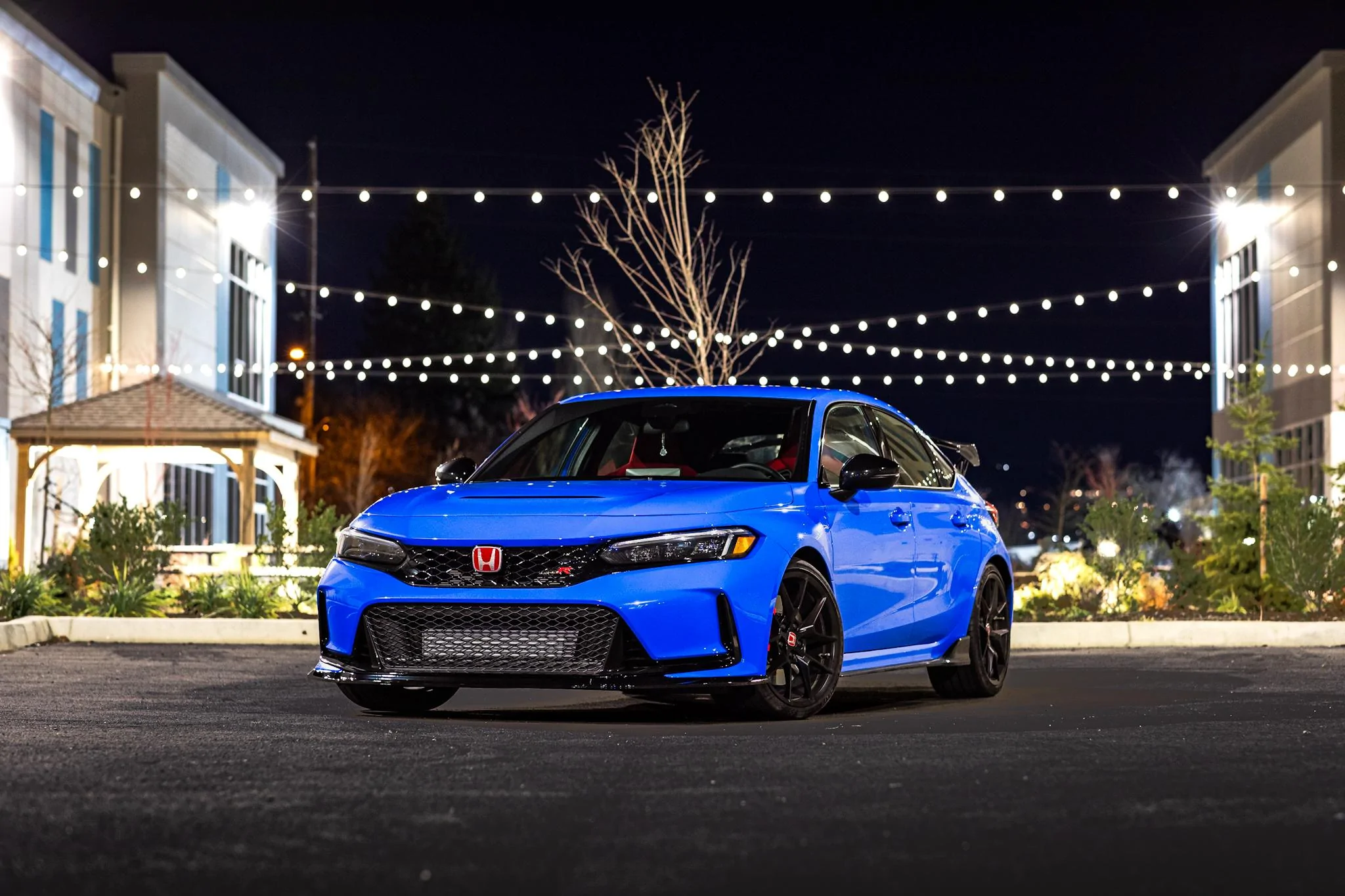

Installed Aeroflow front lip and PRL rear engine mount. Then took a couple photos in 16°F weather ?
Just fyi, Michelin suggests not using those tires below 20°F.
" Note: Tires exposed to temperatures of 20 degrees F (-7 degrees C) or lower must be permitted to gradually return to temperatures of at least 40 degrees F (5 degrees C) for at least 24 hours before they are flexed in any manner, such as by adjusting inflation pressures, mounting them on wheels or using them to support, roll or drive a vehicle. "

Nice pics! What do you think of the PRL RMM? You daily drive your car?
Thanks! Overall, I really like it and it's a noticeable improvement during gear shifts. A little more vibration during startup but it doesn't bother me. I try to daily it but usually avoid taking it out in severe weather.
Good to know. Thank you for the info. Didn't stay out for long < 20 mins. I just wanted to go for a quick spin to test the new mount and promptly went back into the garage right after this.

Still on summer tires? If so, be careful with that. Michelin says you can crack the sidewalls of these tires when exposed to too much cold and rolling on them or even inflating them. They recommended not driving on them below 20 degrees (I thought I read 32 degrees somewhere ?). I’m sure there’s a safety factor built into that statement…but, we don’t know the conditions that will cause these tires to fail, so it’s best not to risk it if you don’t need to. Hope this helps.
