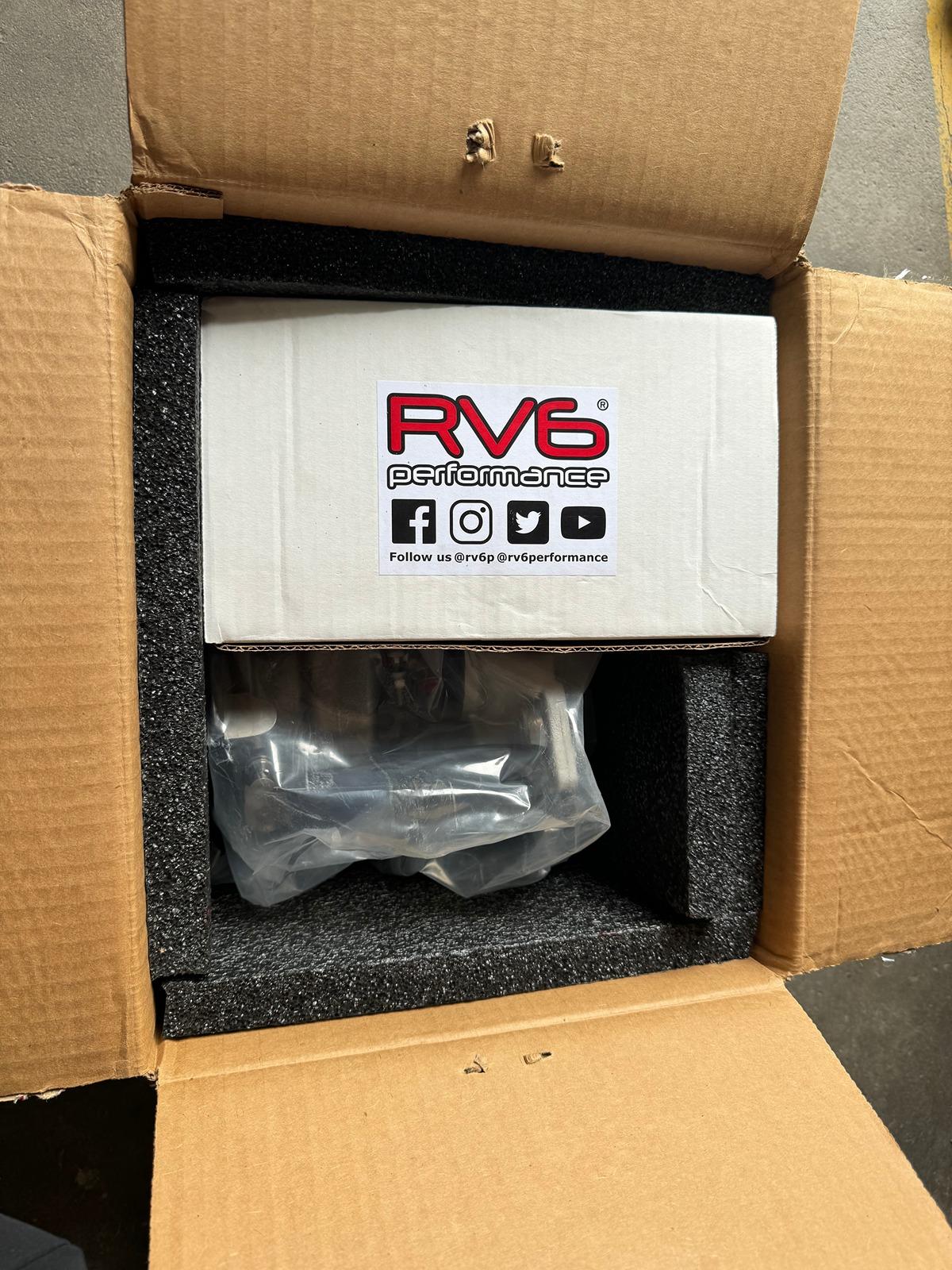

My r660 just arrived,I'm in China and want to use 98 gasoline, similar to 93. hjsdown pipe, milltek exhaust, prl intercooling, radium breathable pot are Already installed on my fl5.I want to reach about 450 horsepower. The quality of gasoline in China is not good. What fuel system do I need to upgrade?Hondata fuel system is too expensive.

Not a whole lot of options, it is either Hondata or XDI the only upgrade path for fuel system.

I plan to just buy an xdi without the injector.
It won’t be enough, the injector pulse width will go through the roof if you push too hard.
You will never see the potential of the turbo without injectors.
