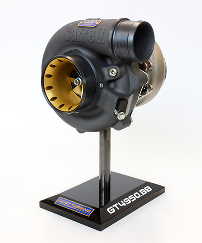

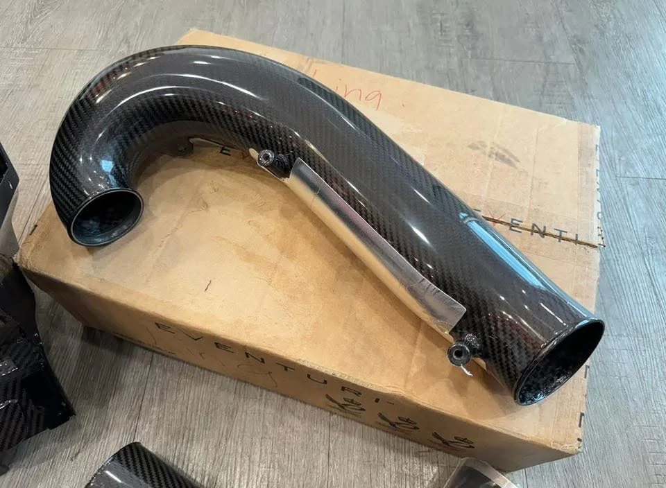

if you want flex and a world first get the HKS GT 4950 Ball Bearing turbo based off the G25-660 with a 0.72 a/r rear exhaust housing on a Rampage Fab G series install kit, The Eventuri intake over turbo pipe into the Eventuri airbox will fit the G series 3” compressor cover inlet, just use a silicon reducer 2.5” to 3” silicon straight adaptor thus retaining the Eventuri airbox. This turbo has arguably better transient boost response than a RV660 with the 0.81 a/r rear exhaust housing because of the smaller 0.72a/r rear.
You align with me haha
How about the GT5065?
I personally think for a 'street car' a 58mm inducer is to big and a mismatch on the k20c1 with either the 0.61 or 0.83 a/r turbine housing, might as well stick to a MHI upgrade or RV6-660 as recommended by most. The sweet spot for a stock K20c1 is 54mm with a set of cams and ported head.
I was looking up the hks turbo yesterday and it seems to be only offered in external waste gated. I'm just waiting for a response from an hks rep.
Either ask them to exclude the exhaust housing or just swap out their v-band external watergate exhaust housing for an internally gated housing later on as they might sell it as a take it or leave it package.
