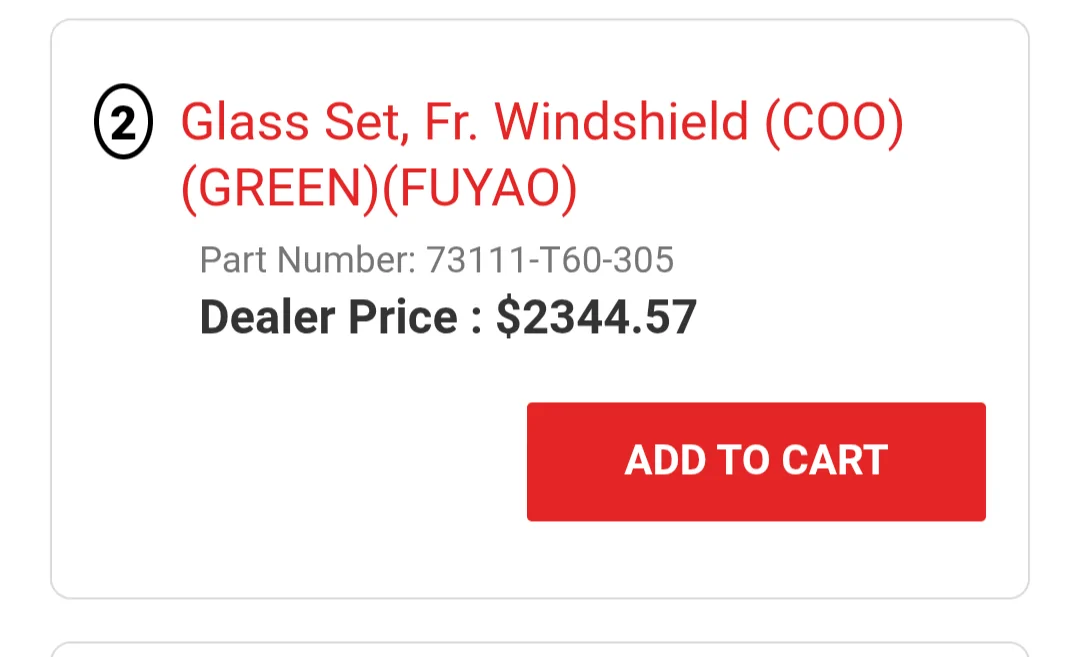

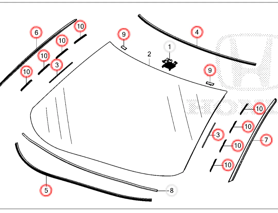

First mistake was asking a dealership for a part number, you should go to Honda's official site "Honda dreamshop" plug in your VIN, and check there.
According to dreamshop the correct part number is 73111-T60-305.
