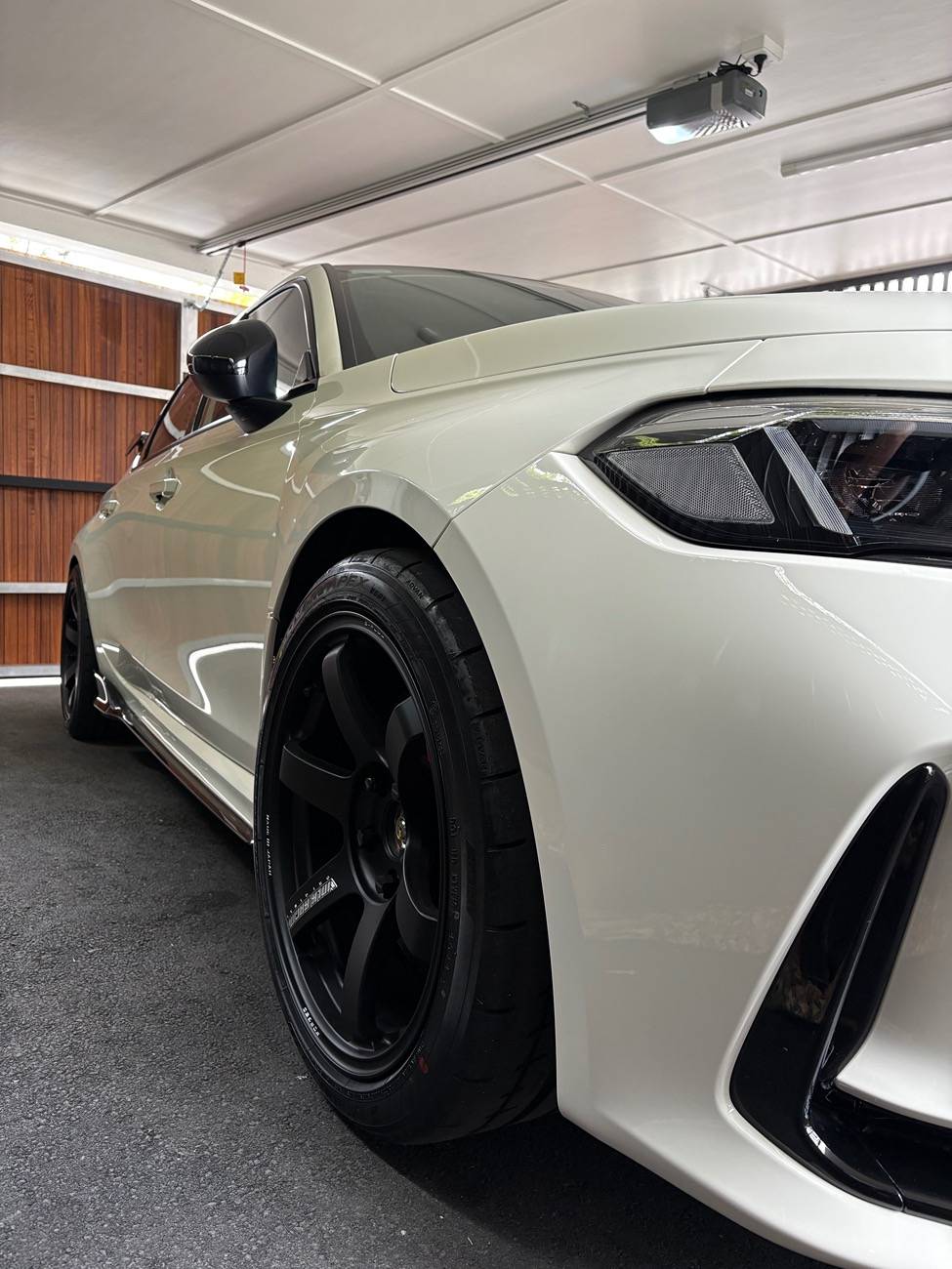

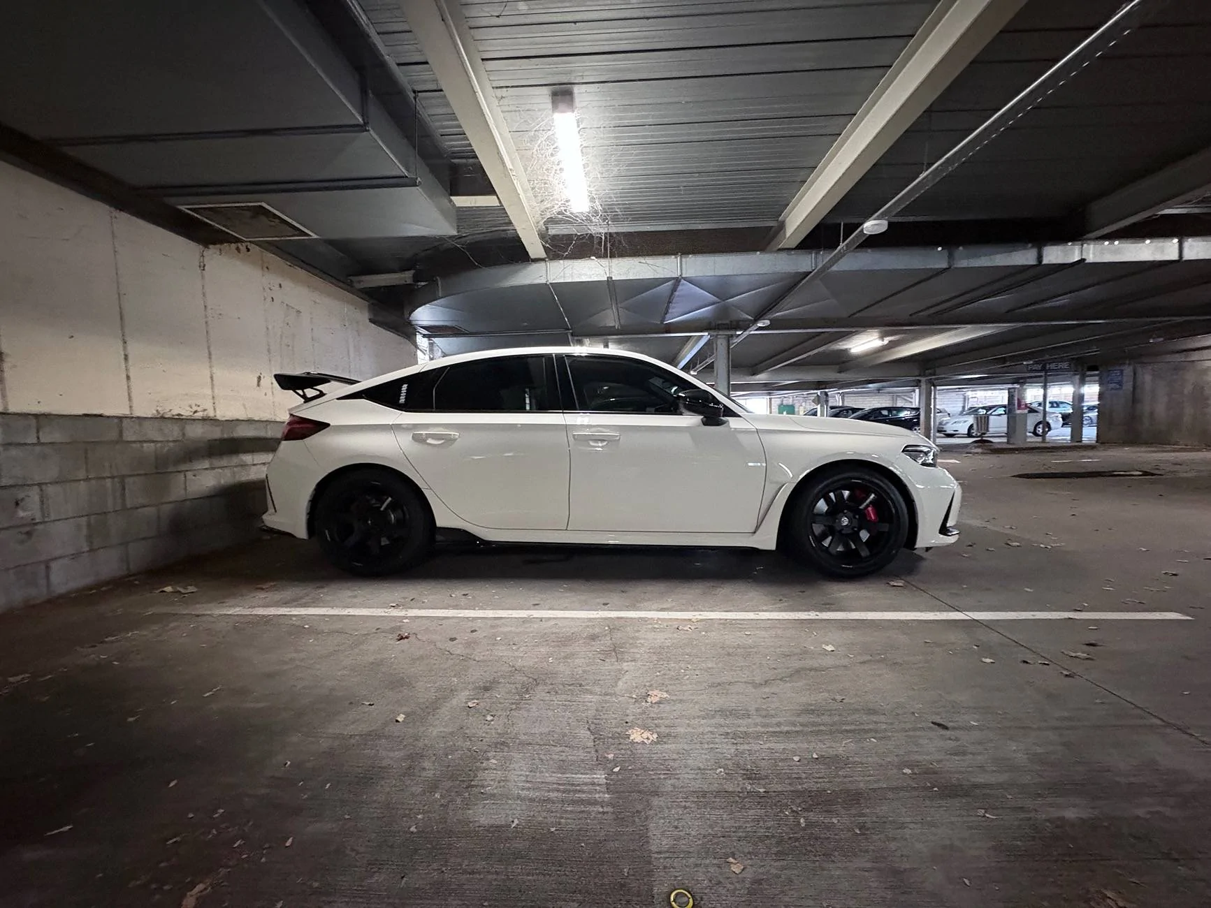

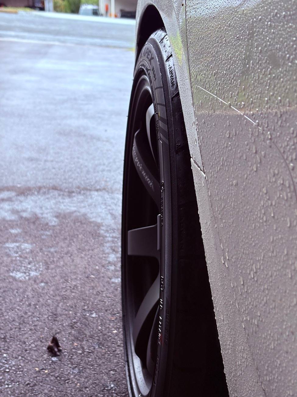

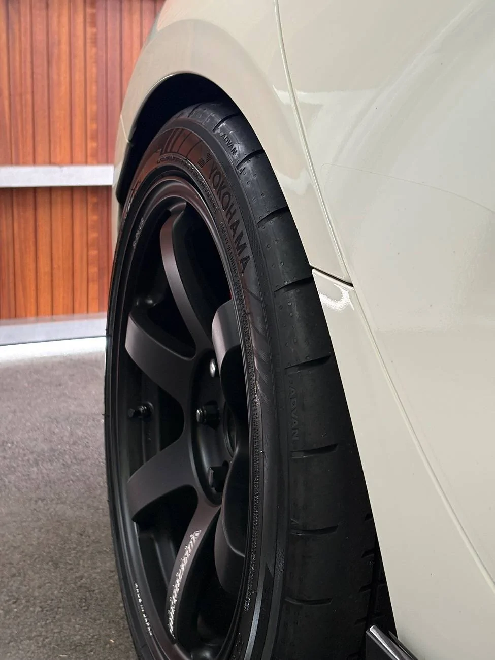

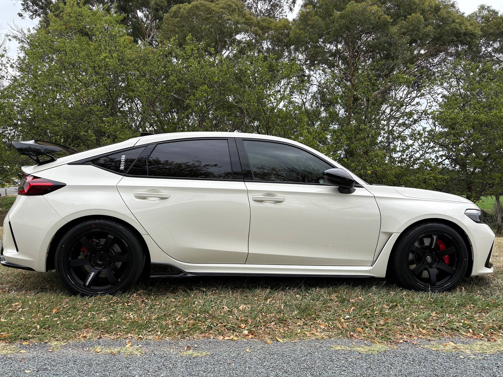

Just sharing photos of the final fitment. Thanks to all for the advice.
Tiny bit of poke at the front from the beefy sidewall of the 601s. A slightly narrower 275 would probably be perfect. Doesn’t seem to bad to me but let me know if I should be worried as it’s my first step into aftermarket wheels.
