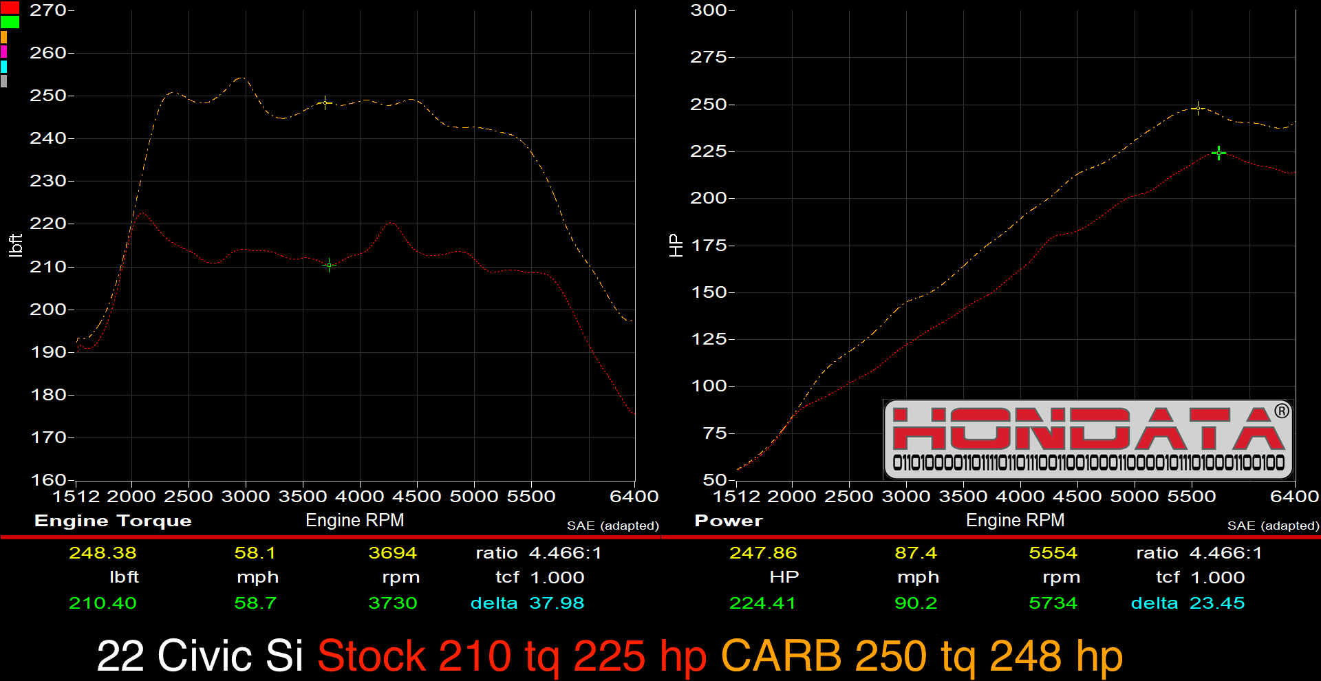

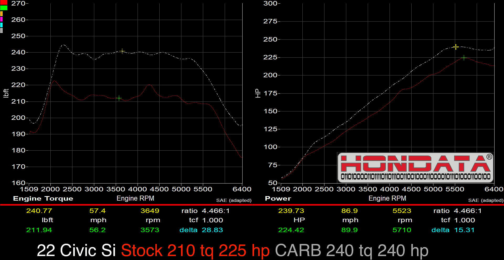

We have been working hard testing and developing the CARB tunes for the 2022 Civic Si. The performance gains are huge with a simple upload from our Plug-N-Play FlashPro system. Our Si now has over 1,000 miles and the development was done with California 91 octane.

Anticipated questions. "Why is this less than the preliminary tune?" " What's with the names?"
Clutch slip is related to peak torque, not power. Our calibration has a little more power than the preliminary tune but less torque. Hondata chose to engineer flat drivable torque curves to reduce the possibility of clutch slip. The name CARB 250 relates to torque level of 250 lb-ft. We will come out with a CARB 260 or 270 when a stronger clutch is available.
