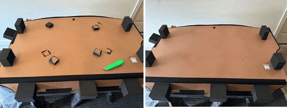

See hhkb for images related to removing the stock trunk floor. As indicated by hhkb, 4 short rubber pieces need to be removed in order for the new floor to lie flat.

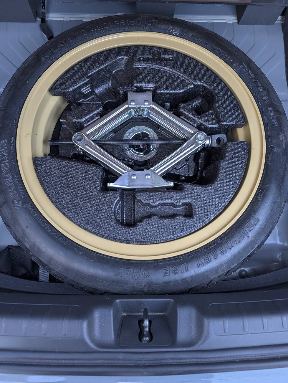

The spare fits in the trunk fairly well. I saw one video on YT where the guy may have had the mounting clamp facing the wrong way (the molded tool tray is recessed on the bottom to account for the screw height (more on the tool tray below).

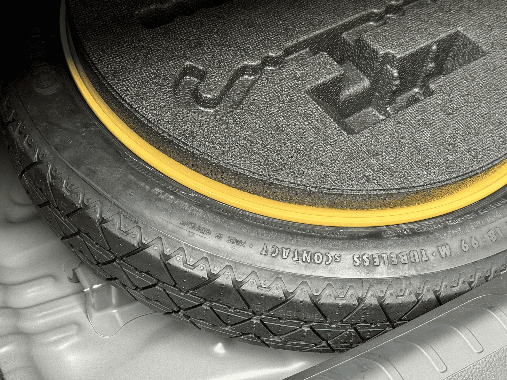

11th Gen Honda Civic Installing FK8 Spare Tire Kit in FL5 1725217703015-5t
The molded tool tray is very nice and fits the spare wheel fine but has two problems for the FL5. First, the tray sits well above the rim thereby preventing the floor from lying flat over the spare. Second, the FK8 molded tray tool does not include a space for the jack. I assume this is because the FK8 has a storage compartment that the FL5 (in the US) does not have?

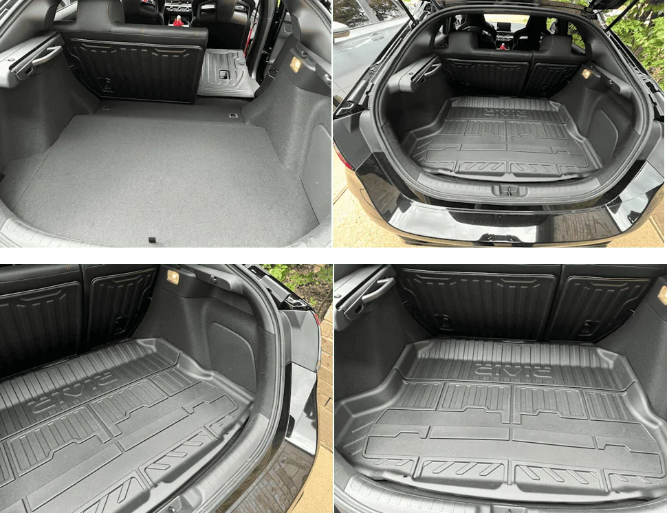

Here is the floor without and with a cargo tray. The floor seems to fit well. I am keeping the original floor in case future solutions utilize the original floor, which has a much thicker underside. The Civic cargo tray still fits but not as well as before (no I did not get the mat with the TR logo).

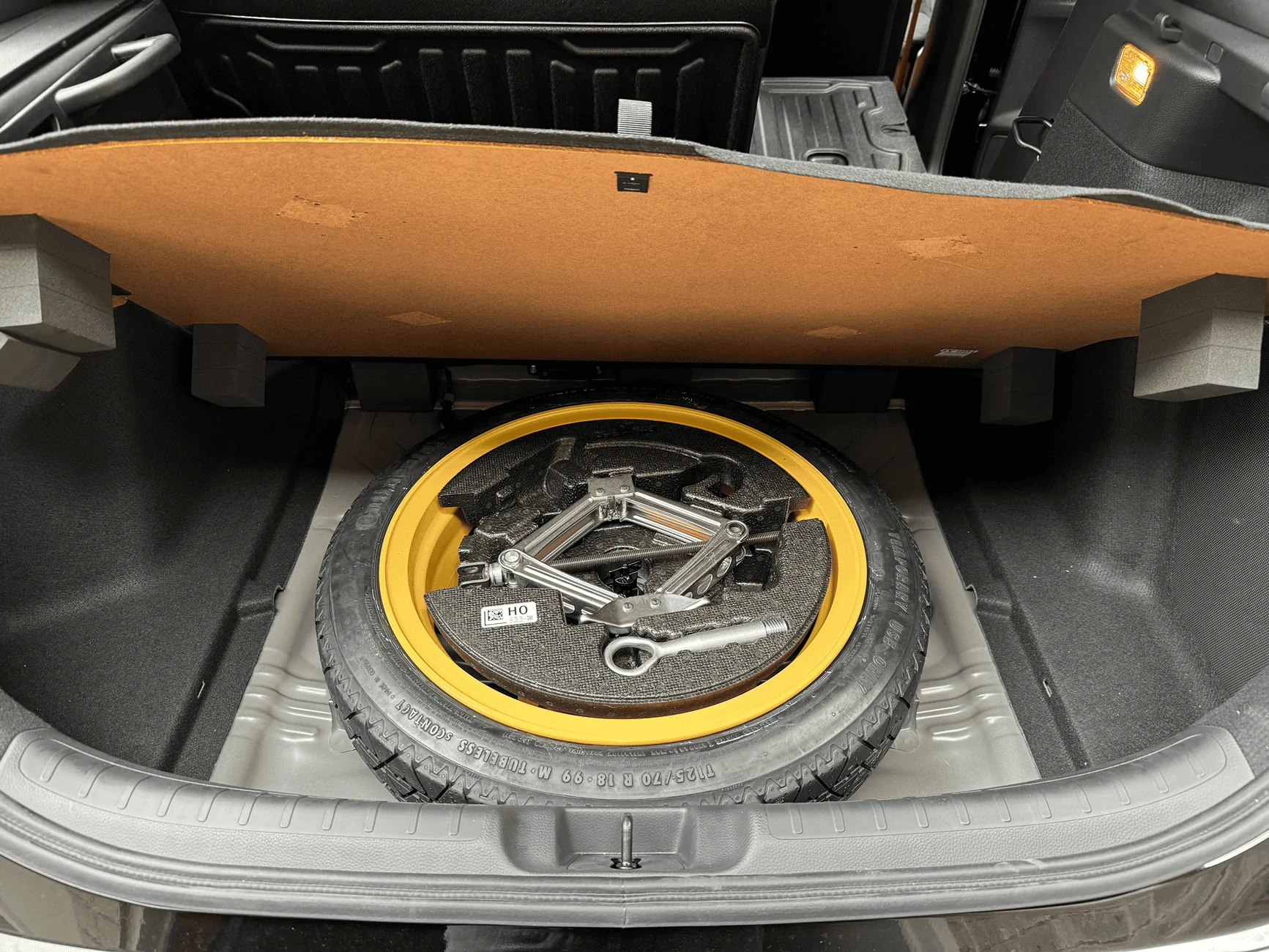

The 135/70 has a closer diameter to our stock size than the 125/70, so just wondering if you think a wider tire would still fit flat?
BigBird
May 29, 2023
1,078
838
So I did the 135/70-18 which almost the same exact size as OEM diameter. Not sure if it made it too wide to sit flush, but it's a bit lumpy on the sides. So probably 125/70 is the way to go. I did lose a bit of height as well, but would rather have the spare in there.
Note: Type R Trunk cover does not fit nicely any longer either. as the trunk is now elevated vs going down.
