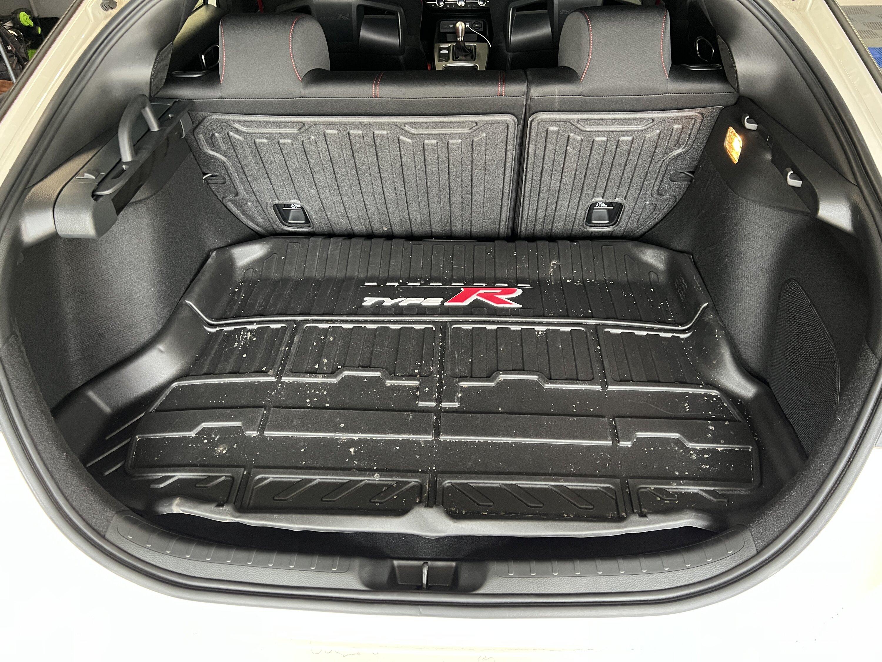

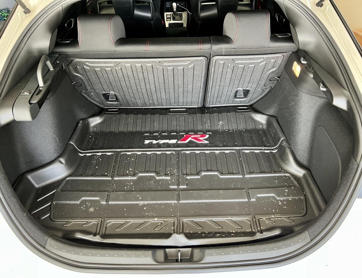

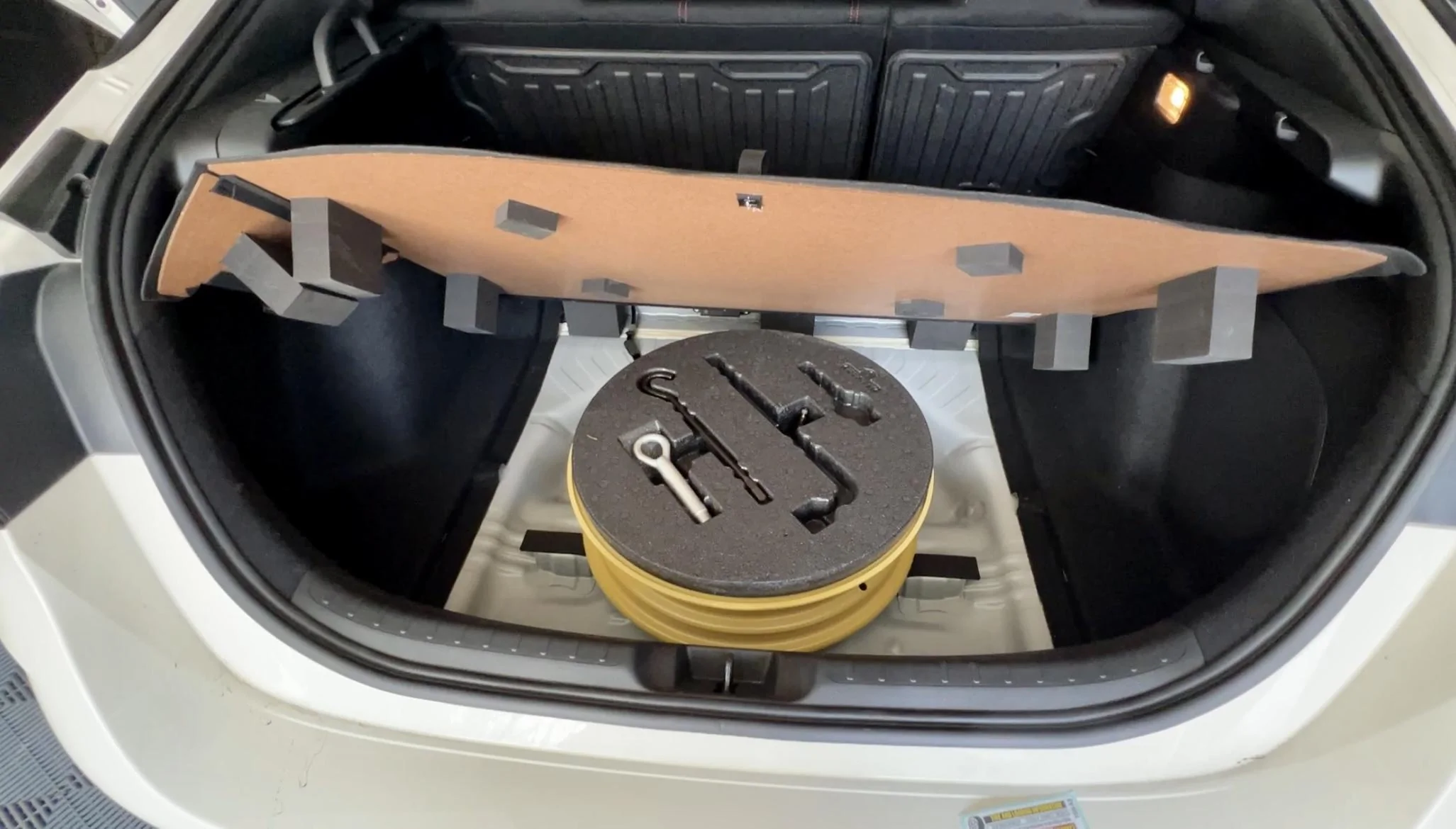

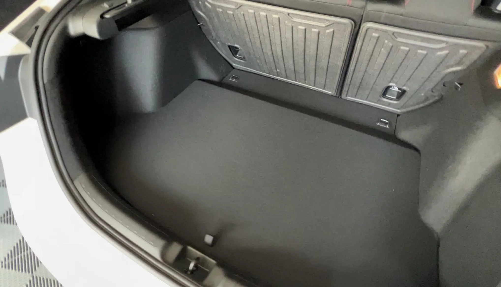

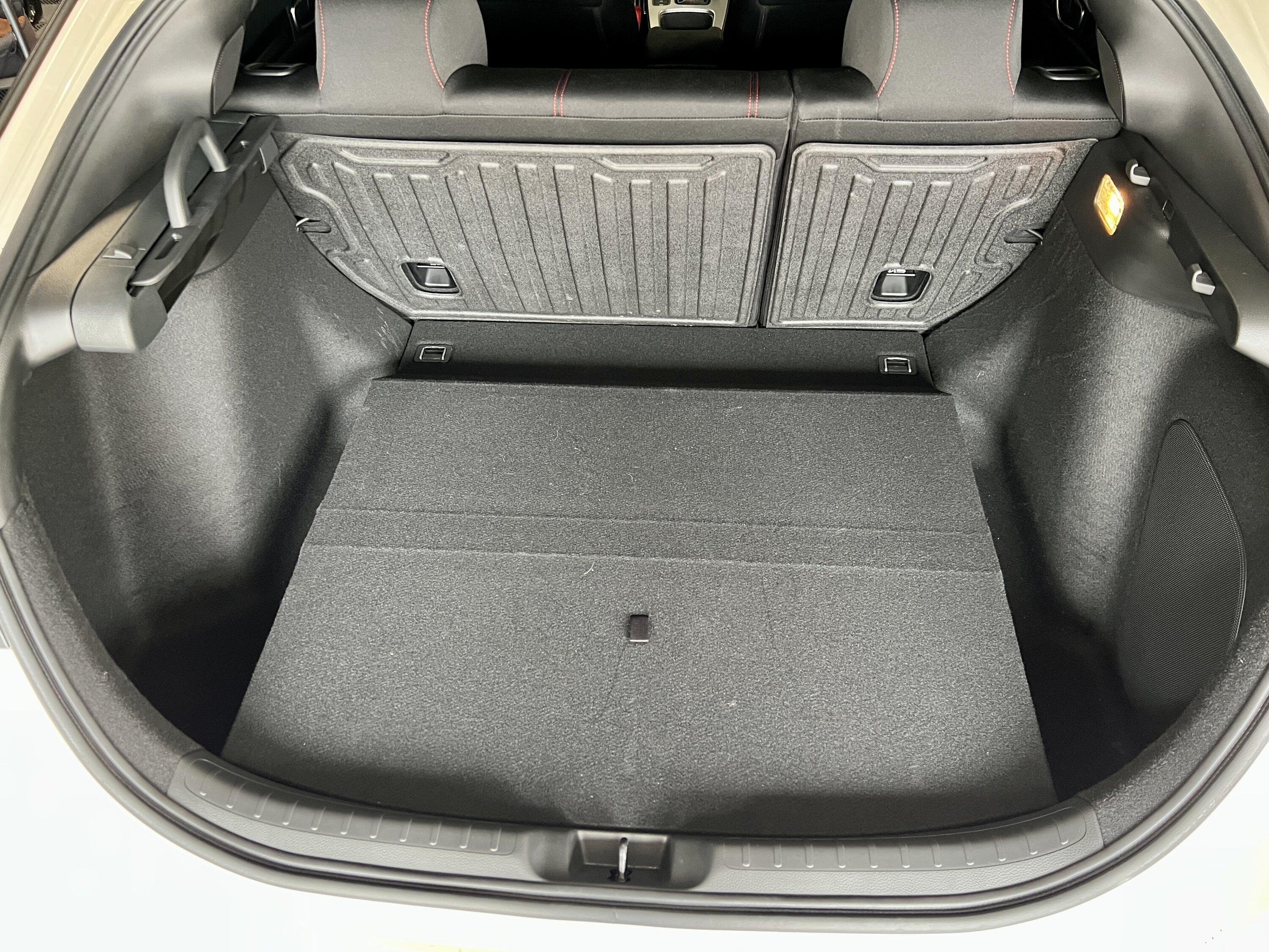

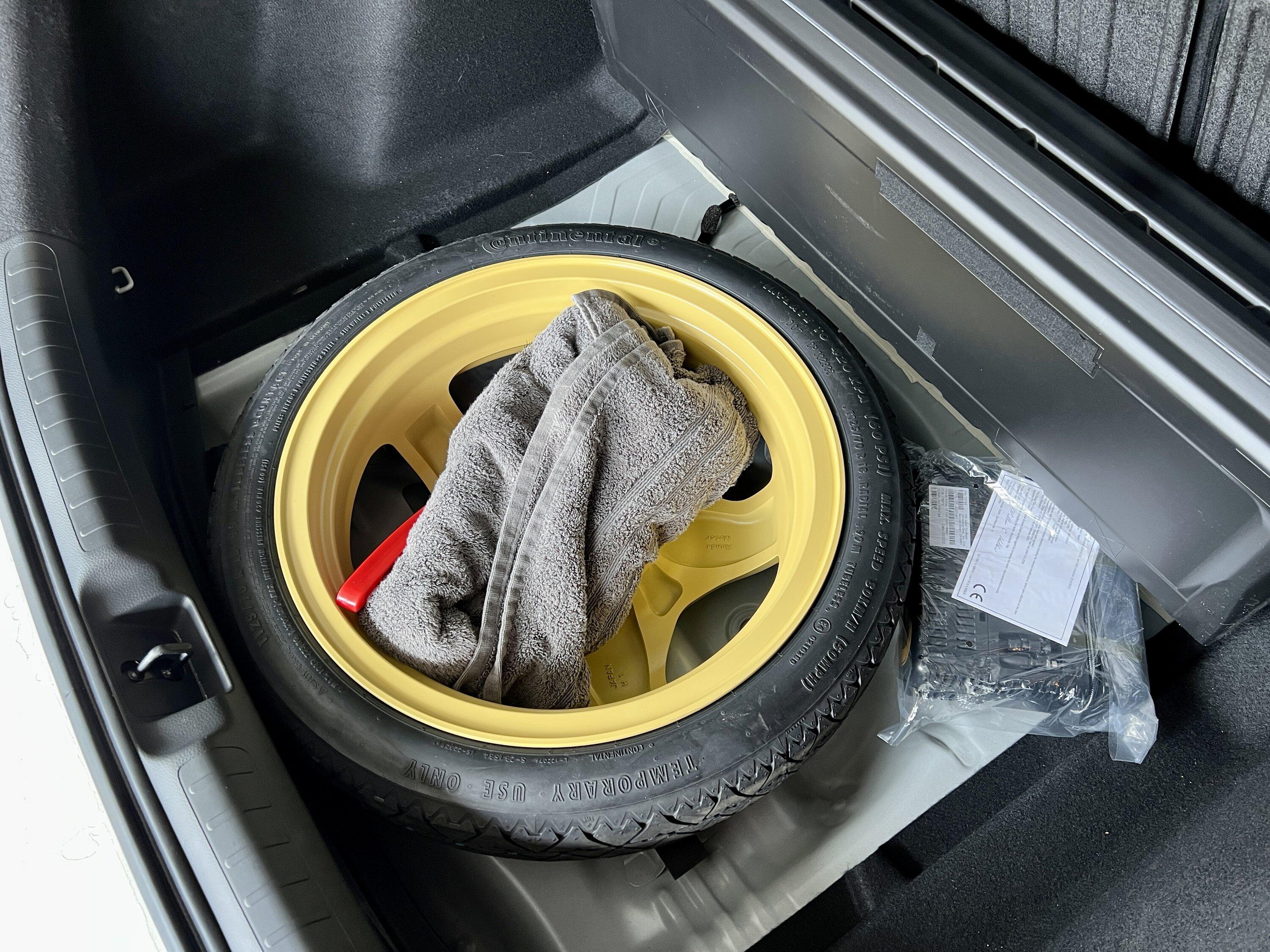

The FK8 spare tire kit almost fits perfectly. Part 06421-TGH-A33ZA wheel kit NH900L- I ordered one for a 2021 Civic Type R for $220 at my local dealer for the wheel, jack & tools, foam insert, stickers, valve stem, tow hook, and cover. The box is huge. Paid more than what I've seen online, but wanted to be sure it was for a Type R. Tire is sold separately, T125/70R18 99M Continental I got it for ~$150 installed at discount tire.
The wheel/tire clears both front and rear calipers no problem. The cover bolts perfectly into the stock location and fits pretty well in the trunk area. It's a cheaper thin piece of particle board, not as thick and solid as the stock cover. The foam risers also aren't quite tall enough to support weight on the far right and left sides. The center is well supported by the spare underneath, however.
There also isn't a designated space for the jack like there was in the FK8, so I wrapped mine up in a towel and put it in the wheel. The foam insert adds about an inch of height to everything so I decided to run without that.
I eventually ended up removing the kit's cheaper cover since it just isn't solid enough to support any weight and reinstalled the stock cover. I may add more foam height/support to the edges of the FK8 cover at some point and see if that's better.
FK8 Cover installed over spare.
11th Gen Honda Civic Good spare tire kit? IMG_0862
FK8 cover + FL5 rubber trunk mat
11th Gen Honda Civic Good spare tire kit? IMG_0863
Foam insert. Some of these foam blocks aren't long enough to support the cover.
11th Gen Honda Civic Good spare tire kit? IMG_0867
Installed FL5 cover. FK8 spare without foam insert. Jack & tools, ice scraper, and tire inflator all fit! Never travel without a towel, for practical and psychological reasons.
11th Gen Honda Civic Good spare tire kit? IMG_0866
FK8 spare + FL5 cover
11th Gen Honda Civic Good spare tire kit? IMG_0865
FK8 spare+Fl5 cover+FL5 rubber trunk mat. Slightly higher due to thicker cover.
Here's to hoping Honda comes out with a dedicated FL5 spare kit for the US, until then the FK8 kit works well enough imo. It's pothole season here in Michigan and I'm about to go on a road trip so needed a solution asap.
Installed FL5 cover. FK8 spare without foam insert. Jack & tools, ice scraper, and tire inflator all fit! Never travel without a towel, practical and psychological reasons.
An alternative solution is a spare from an '05-'12 Acura RL at your local junkyard or on ebay:
