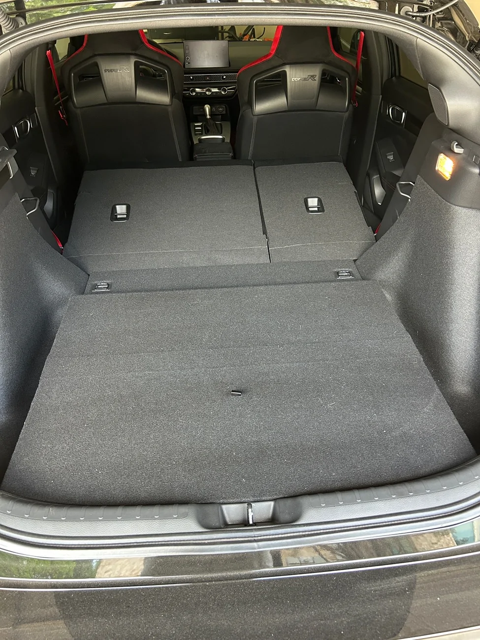

The foam posts you removed do serve a purpose if one wants to use the factory foam tray: they contact the spare around the tray and add support to the floor. Doing this does make the whole thing another inch or so higher, and will need a solution to support the back lateral edges of the floor by the same amount. It DOES add a broad support base to the center of the floor for ppl who carry heavy stuff (I do.)

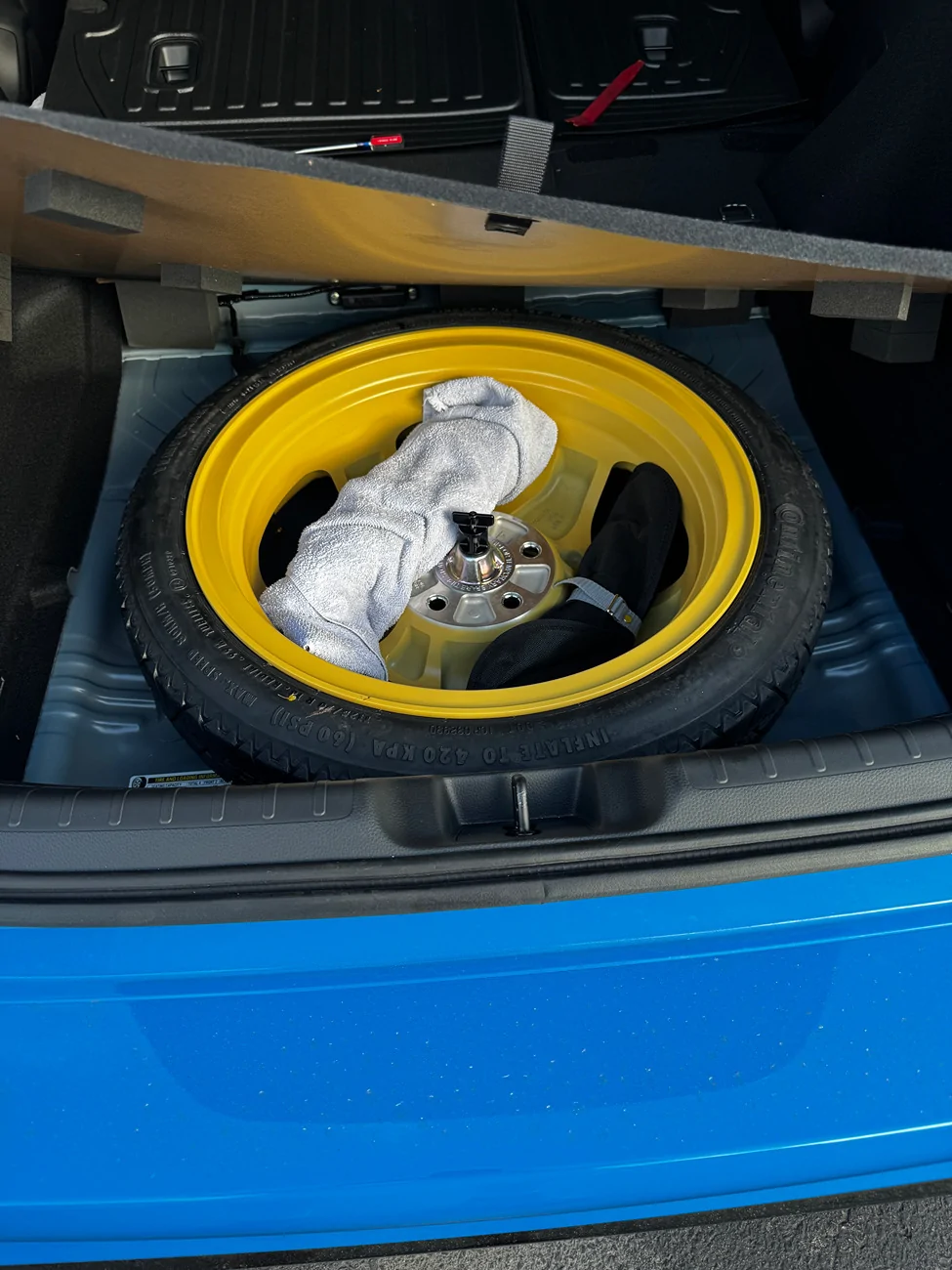

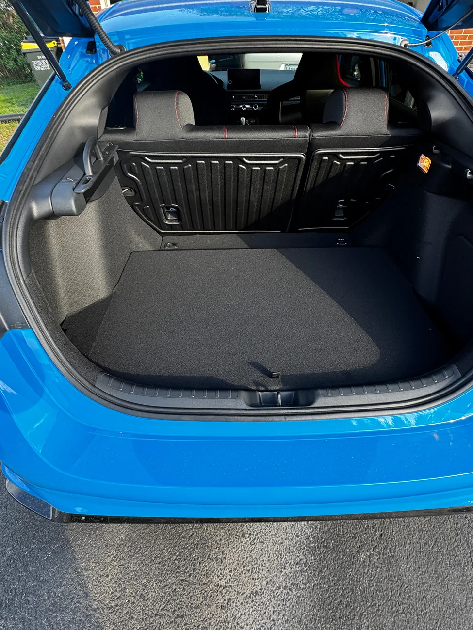

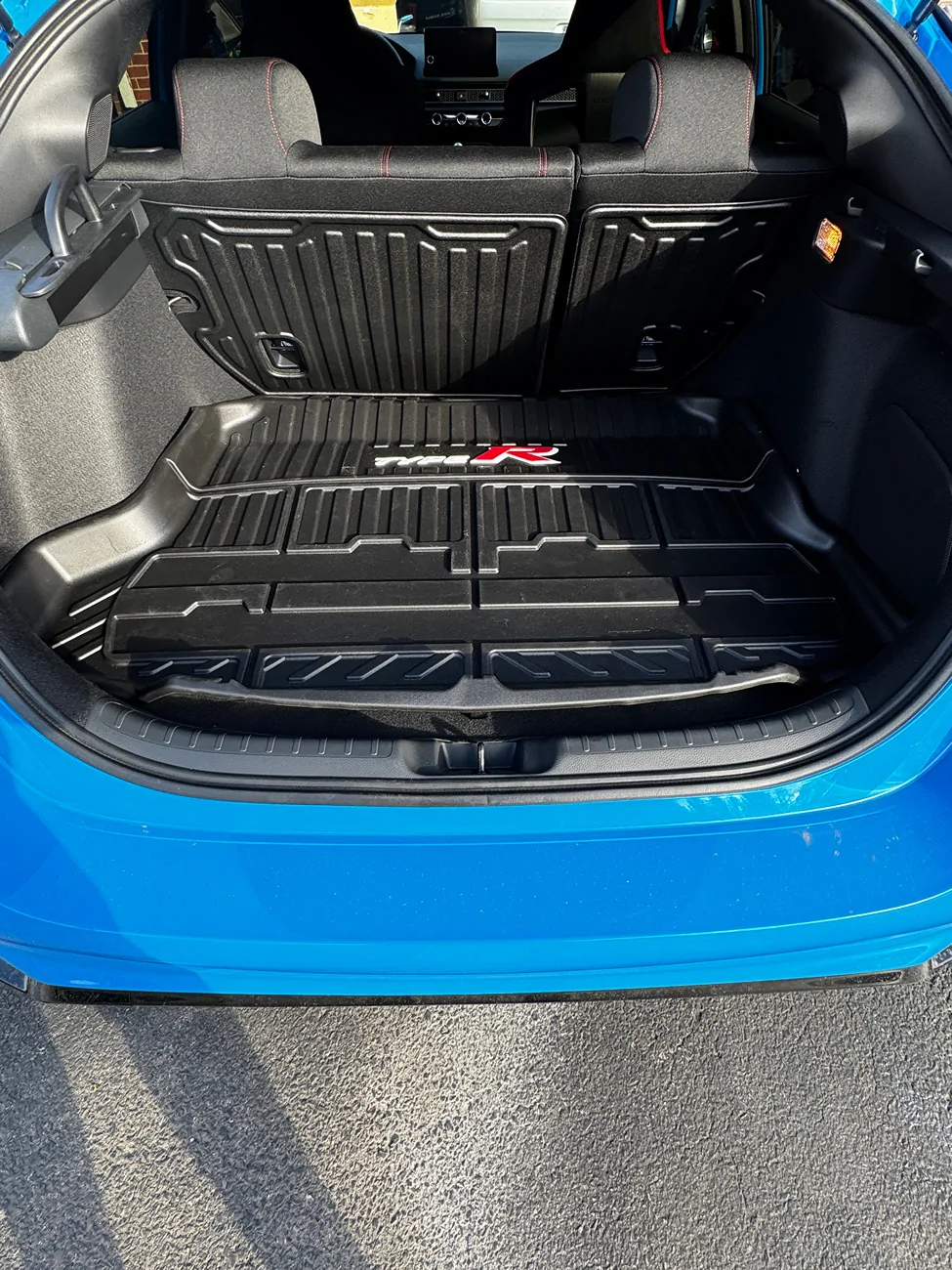

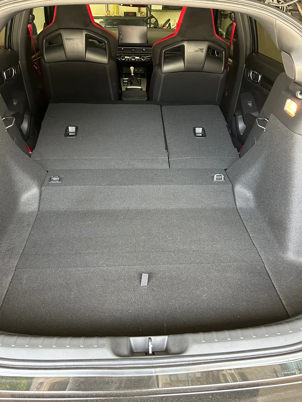

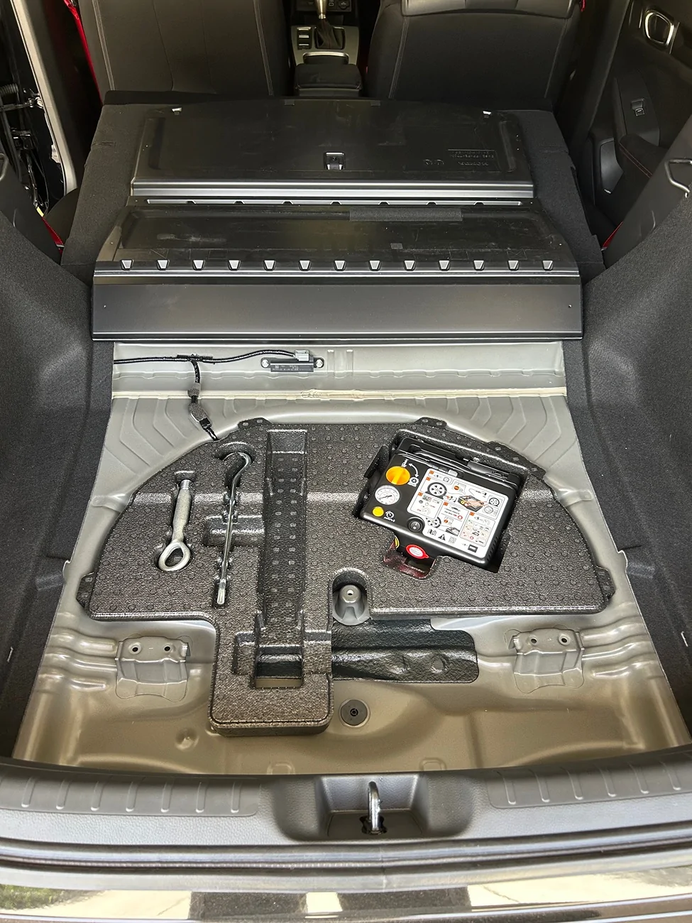

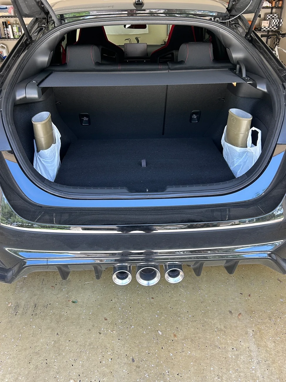

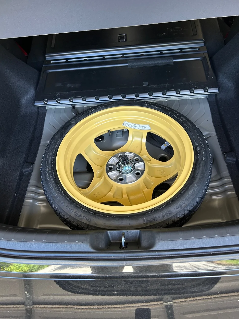

Just wanted to add my own experience. Purchased the FK8 spare wheel kit (part #06421-TGH-A33ZA) and tire (part #42751-CTL-039) and picked it up at a local dealership after having the service dept. mount the tire to the wheel rim. Kit, $214; tire, $150; mounting fee, $27; shipping, none; total = $391 + tax. It is also worth calling around to more than one dealership, I'm not saying I got the best price, but the second dealership I called quoted a price of nearly $200 more.
Install: I am actually super happy with simply removing the FL5 foam insert kit from the wheel well, replacing with the FK8 spare wheel and tire, securing it to the pre-existing central bolt rececpticle with the included fastening bolt, and re-laying the original FL5 over the top for a flat and stable surface, which is slightly lower than the hatch latch level, provides side storage cubbies, and also does not interfere with the subwoofer! Also, there is ample space inside the spare wheel to store the jack and associated tools, along with peripherals such as tire inflater and battery jumper units.
So, I am not planning on using the included FK8 trunk cover, FK8 foam wheel insert with tool slots, nor the original FL5 foam insert kit. I guess these are on sale for cheap if anyone is interested!
Finally, I've gone down a bit of a rabbit hole on this whole topic. I know for many improvised spare tire setups, only the rears can be replaced with a spare due to brake caliper clearance issues in the front and then a second tire movement would be needed if the flat is on a front tire. Anyway, I can't remember, can my OEM FK8 spare be used on the back and front or only back?
Cheers everyone

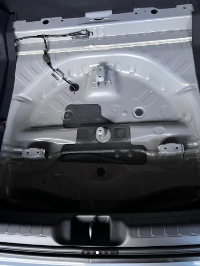

update a day later.
- hhkb, I followed your advice for adding the spare tire info over the existing tire spec sticker. So easy, yet I don't think I would have come up with that, instead I was thinking along the lines of adding the sticker to the passenger side, which would have been very confusing!
- The spare tire kit also comes with three rectangular rubber adhesive patches that I was at a loss as to how to utilize. Kudos to reddit user DamnedlflDO for clarifying. Essentially, there are three raised metal areas, one forward and two to the sides...I was going to put a link, but it seems to be beyond my tech knowledge; instead, google 'civic type r spare tire' and go the reddit thread, if interested (but, I am also enclosing a pic showing the three contact areas)

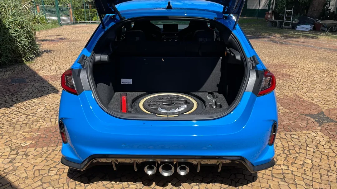

I saw this picture posted on reddit. Anyone know the part number for the foam surround? Thanks.
