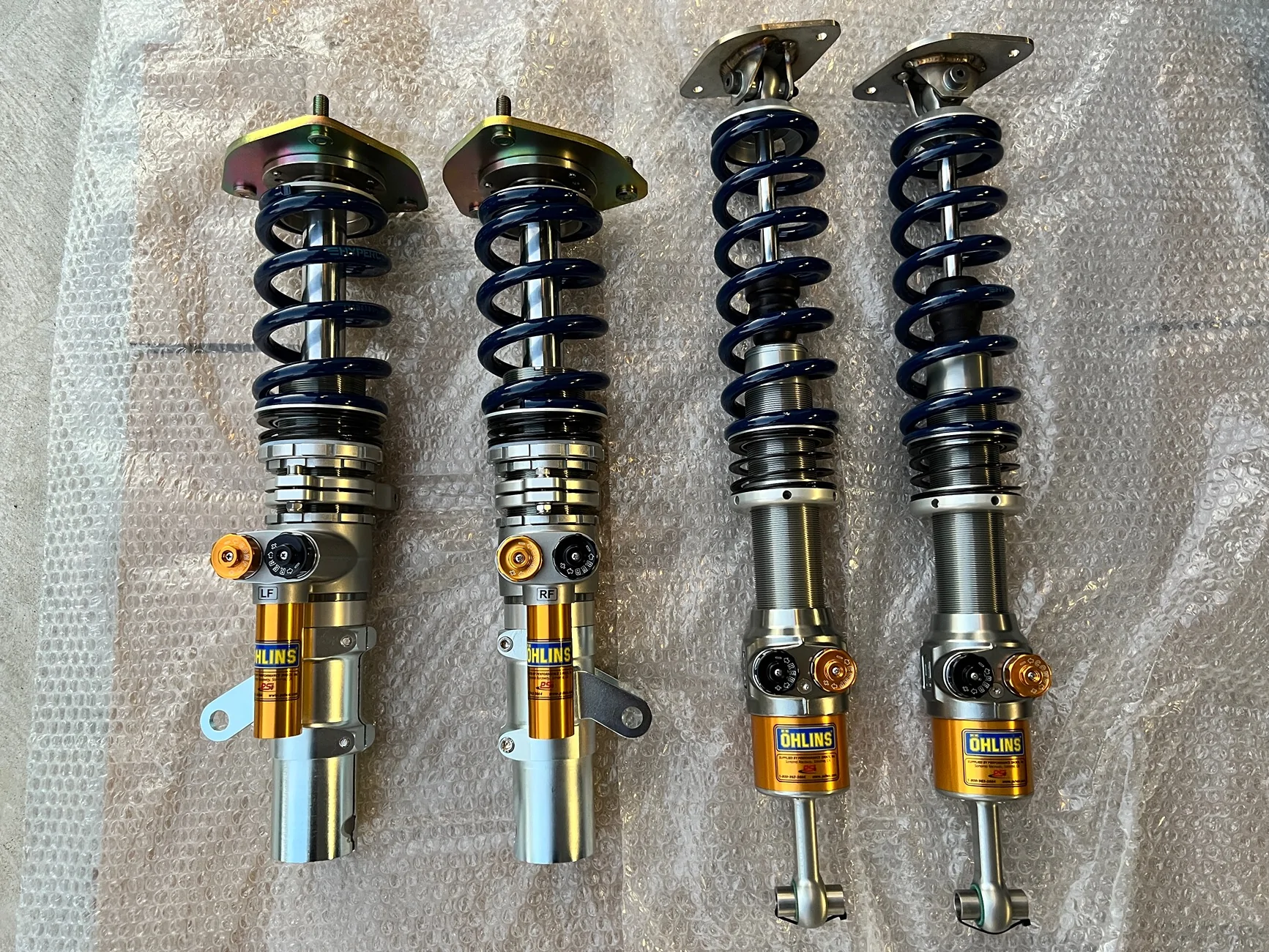

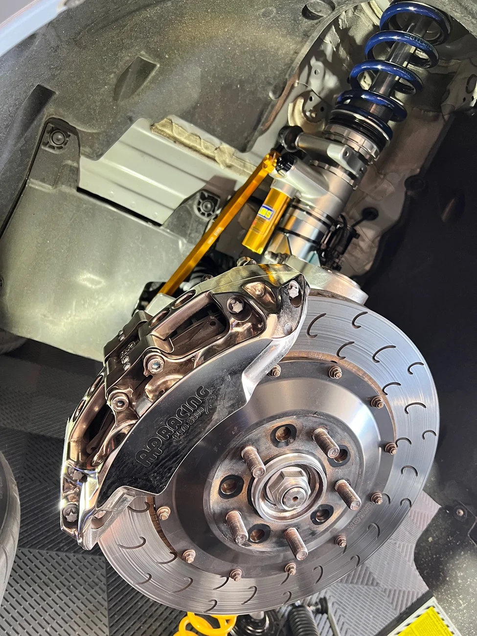

Hello all,
For the past few months, I have been working with the great group of people at Performance Shock, Inc. in developing a custom set of Ohlins TTX coilovers for my FL5.
Today I finally picked them up!
Attached is a quick picture before they go in.
These are the TTX46 in front and the TTX36 ILX in the rear.
We also opted to go with a true coilover in the rear.
Springs are from Hyperco and the rates are 500lbs/in front and 300lbs/in in the back.
If you are interested in a set of these, please hit up the guys at Performance Shock, Inc.
Thanks again Bruce, Cristian and Jayme for making this possible!
Now time to install them and get them dialed at the track.
If you have any questions please feel free to ask.
-Jun
11th Gen Honda Civic Custom Ohlins TTX coilovers custom prototype for my FL5 IMG_0315

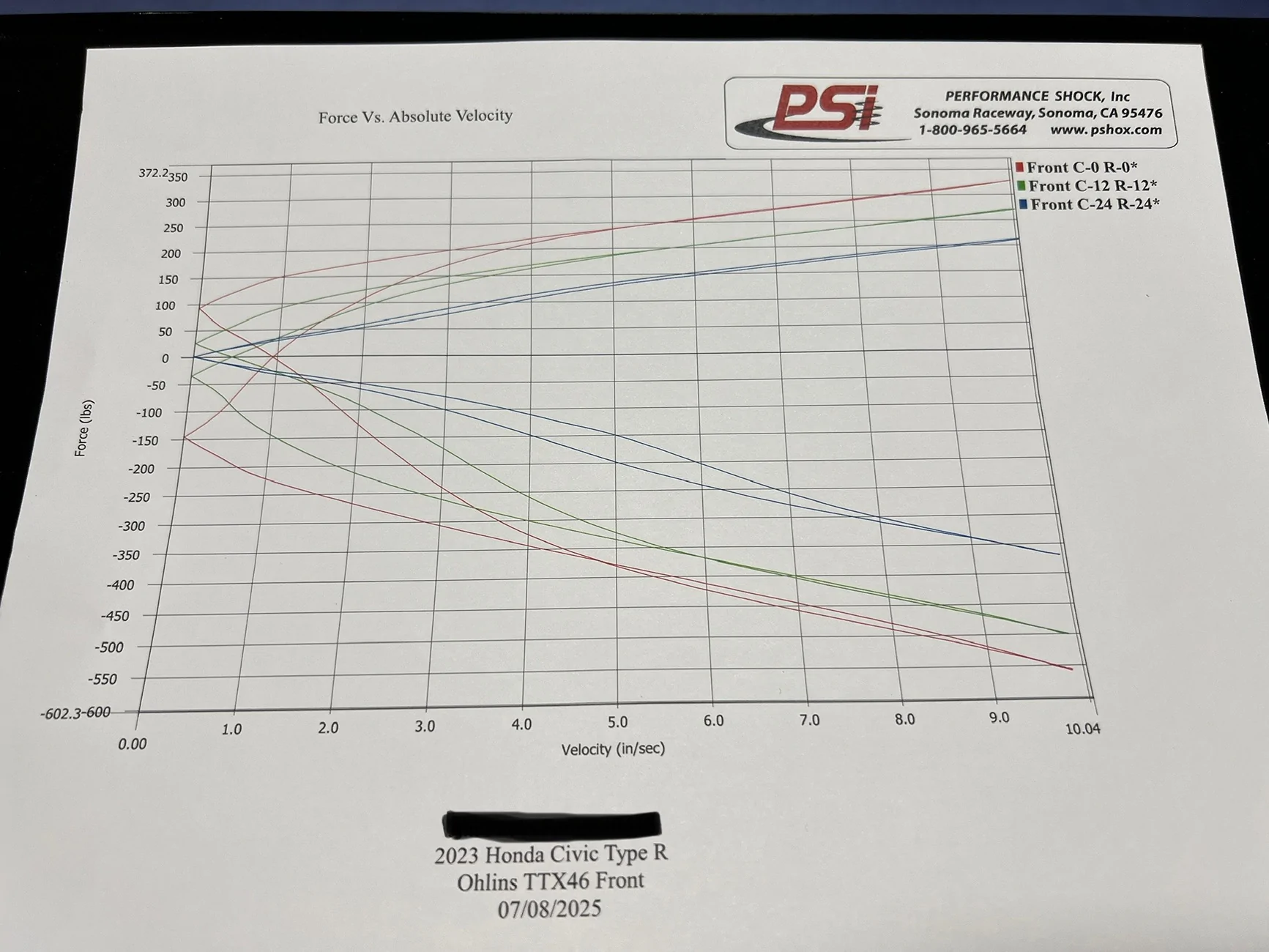

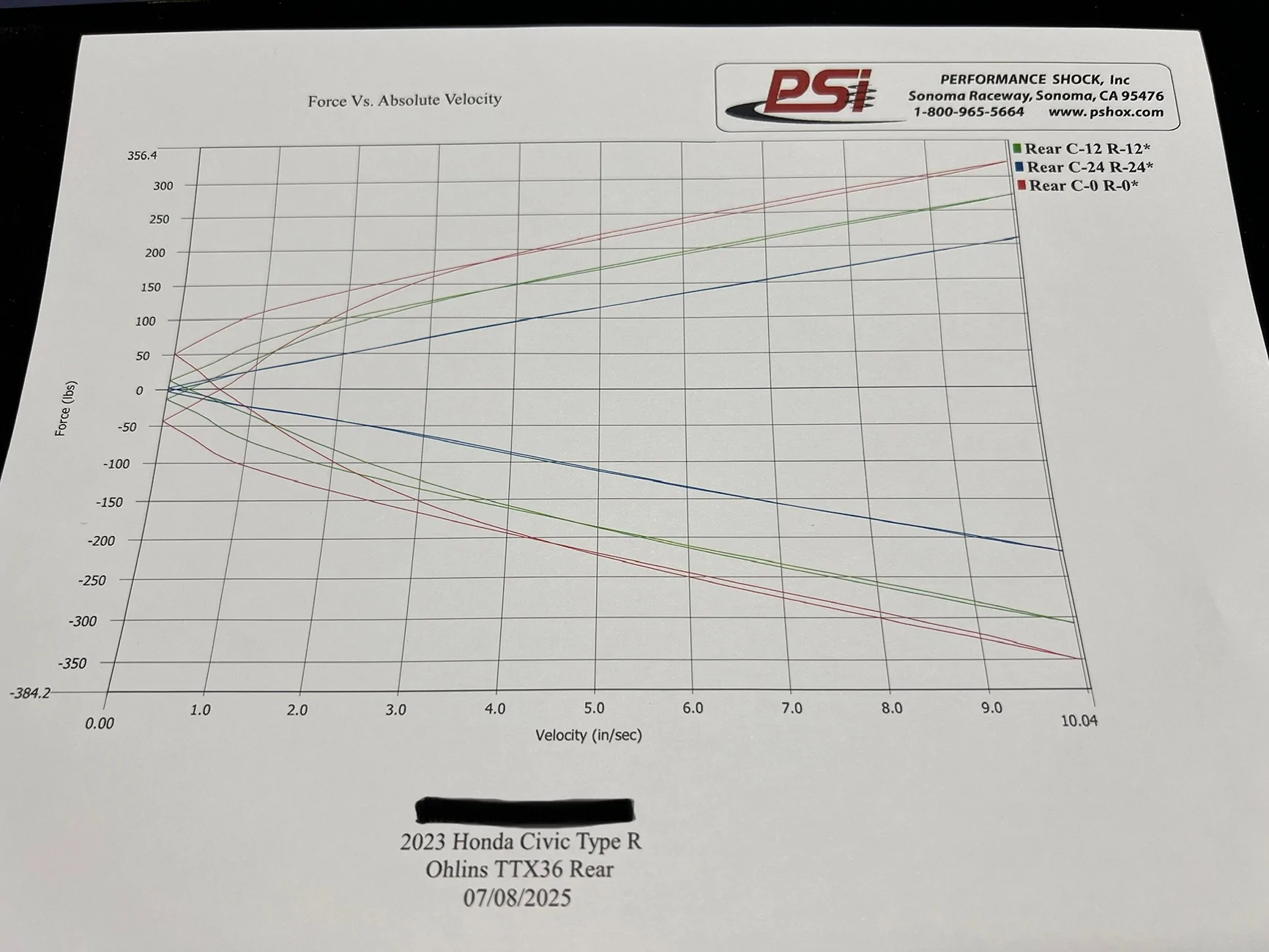

Here are the shock dyno plots:
11th Gen Honda Civic Custom Ohlins TTX coilovers custom prototype for my FL5 IMG_0355
11th Gen Honda Civic Custom Ohlins TTX coilovers custom prototype for my FL5 IMG_0354

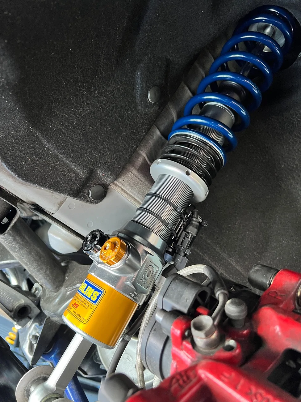

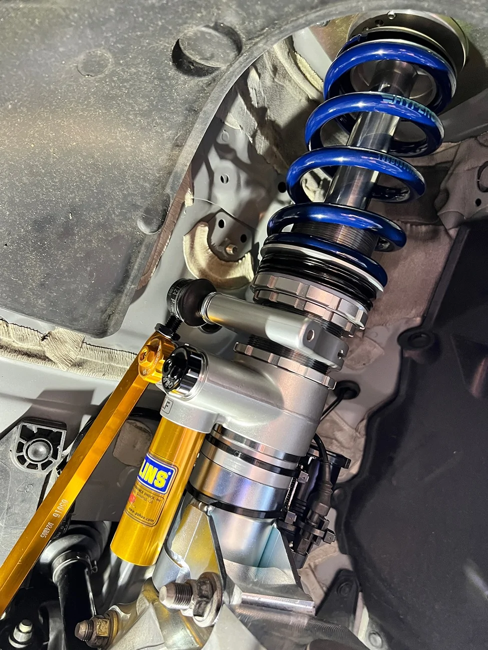

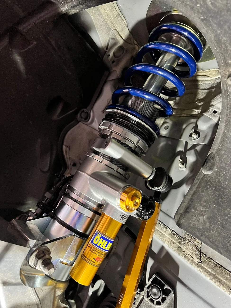

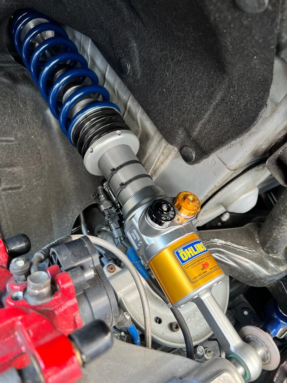

Here are the dampers installed:
11th Gen Honda Civic Custom Ohlins TTX coilovers custom prototype for my FL5 IMG_0319
11th Gen Honda Civic Custom Ohlins TTX coilovers custom prototype for my FL5 IMG_0321
11th Gen Honda Civic Custom Ohlins TTX coilovers custom prototype for my FL5 IMG_0322
11th Gen Honda Civic Custom Ohlins TTX coilovers custom prototype for my FL5 IMG_0323
First test drive complete.
I took the car to a road nearby that has many small undulations due to uneven asphalt.
With the oem suspension, it would result in a pogo effect even in comfort mode. Something with the logic of the ads automatically stiffens up the stock dampers and leads to upsetting the chassis.
With the Ohlins r&t, the undulations were dampened but felt harsh with each successive hit, especially in the rear.
Now with the Ohlins TTX coilovers, the undulations feel like they aren’t even there!
The small bump sensitivity and response of these dampers are on a level I have never experienced before in vehicle.
Next is an alignment recheck and corner weighting and then time to shake down at the track.

Here is some more eye candy:
11th Gen Honda Civic Custom Ohlins TTX coilovers custom prototype for my FL5 IMG_0318
11th Gen Honda Civic Custom Ohlins TTX coilovers custom prototype for my FL5 IMG_0320
