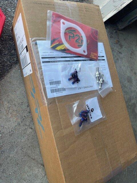

When PRL release their titanium inlet kit; I jumped on it right away and also ordered P2R thermal gasket and more titanium hardware.

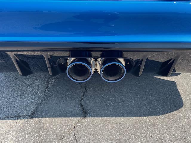

To make the car more alive I opt in for the Apexi N1 catback; I want to retain the OEM exhaust valve since I hate drone; This catback hits all the right notes; quiet when daily driving and gets loud when your on the throttle.

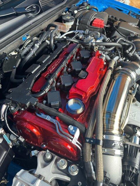

I finish dressing up the hoses on the intake side just to clean up the look today 9/23/23.

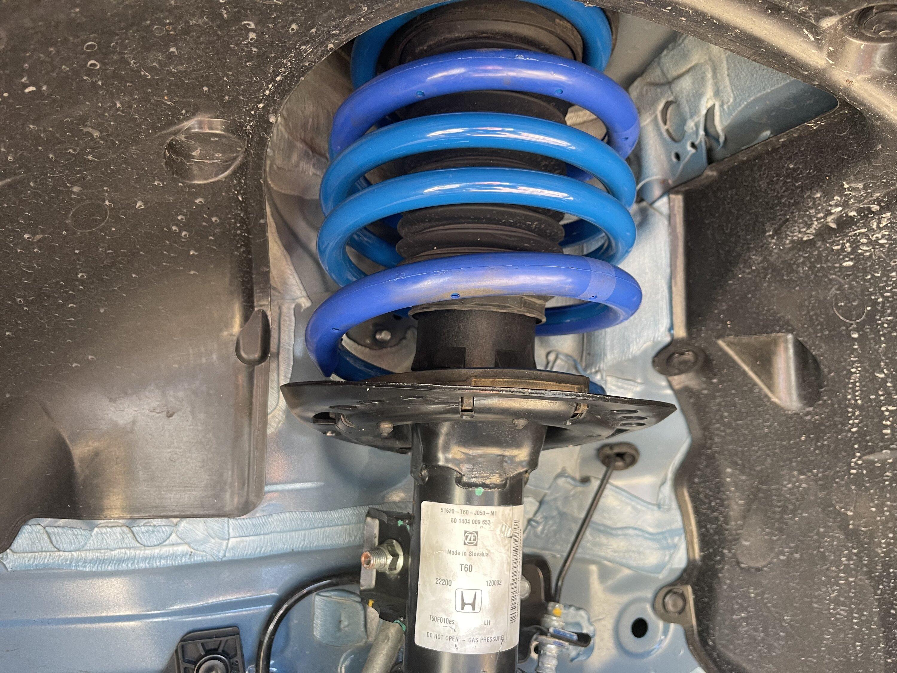

I’ve put off installing lowering springs since it’s such a pain in the ass; but I ended up finishing it up today. Spoon springs installed; it was easier than the Fk8 but still wasn’t entirely easy lol. 10/01/23
11th Gen Honda Civic 90's Kid Dream Build IMG_0964
11th Gen Honda Civic 90's Kid Dream Build IMG_0962
10-08-23
Alignment is done; with the spoon springs; ride is so much nicer, the drop is perfect and not overly aggressive.

Can you tell us about those DEI braided hoses you used for "dress up". I really like the look.

I use the DEI kit design for their spark plugs; 010475 is the part#; they do make them in like different length kits_Anyhow it says the ID is .5 inch but it can be expanded to beyond 1 inch if you need to or go even smaller than .5inch as the stuff expands and opens like a chinese finger trap(Best way I know how to describe it lol)
I only did the front section of the hoses because I intend to do fuel upgrades later and will do the rest of the rear hoses when the time comes; will look sweet.

Does indeed look nice and clean. So you just cut to length of each rubber hose, slipped it through and used OEM clamps?
