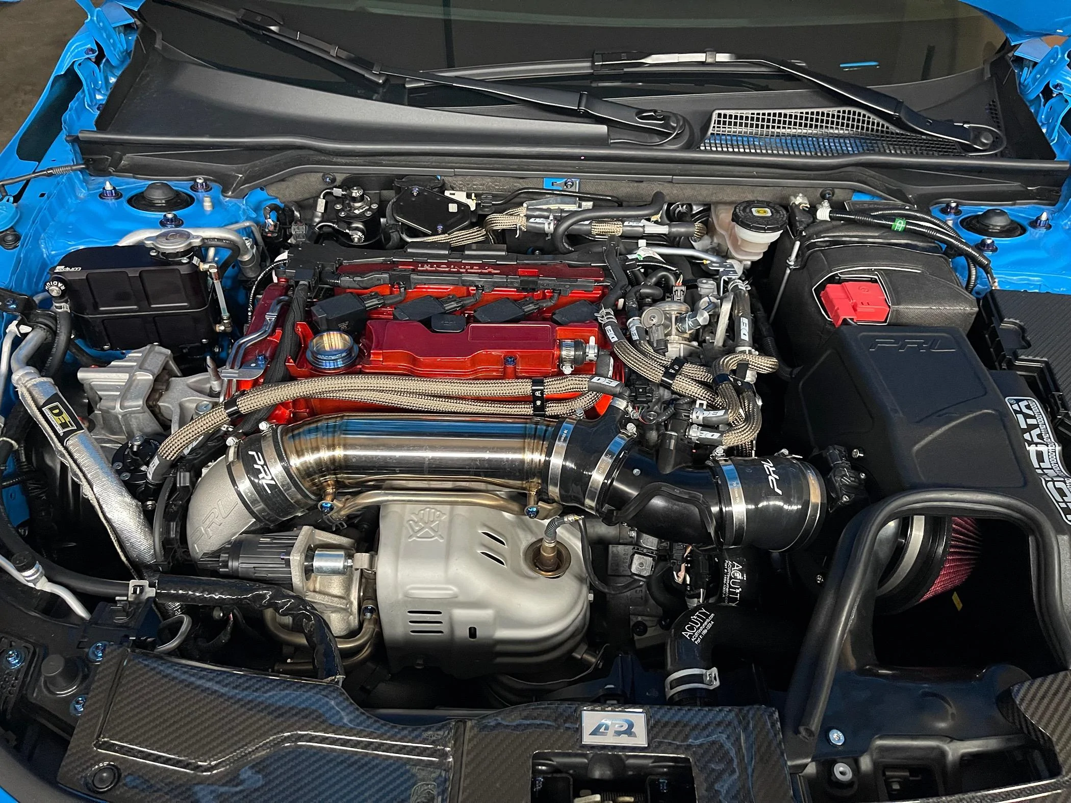

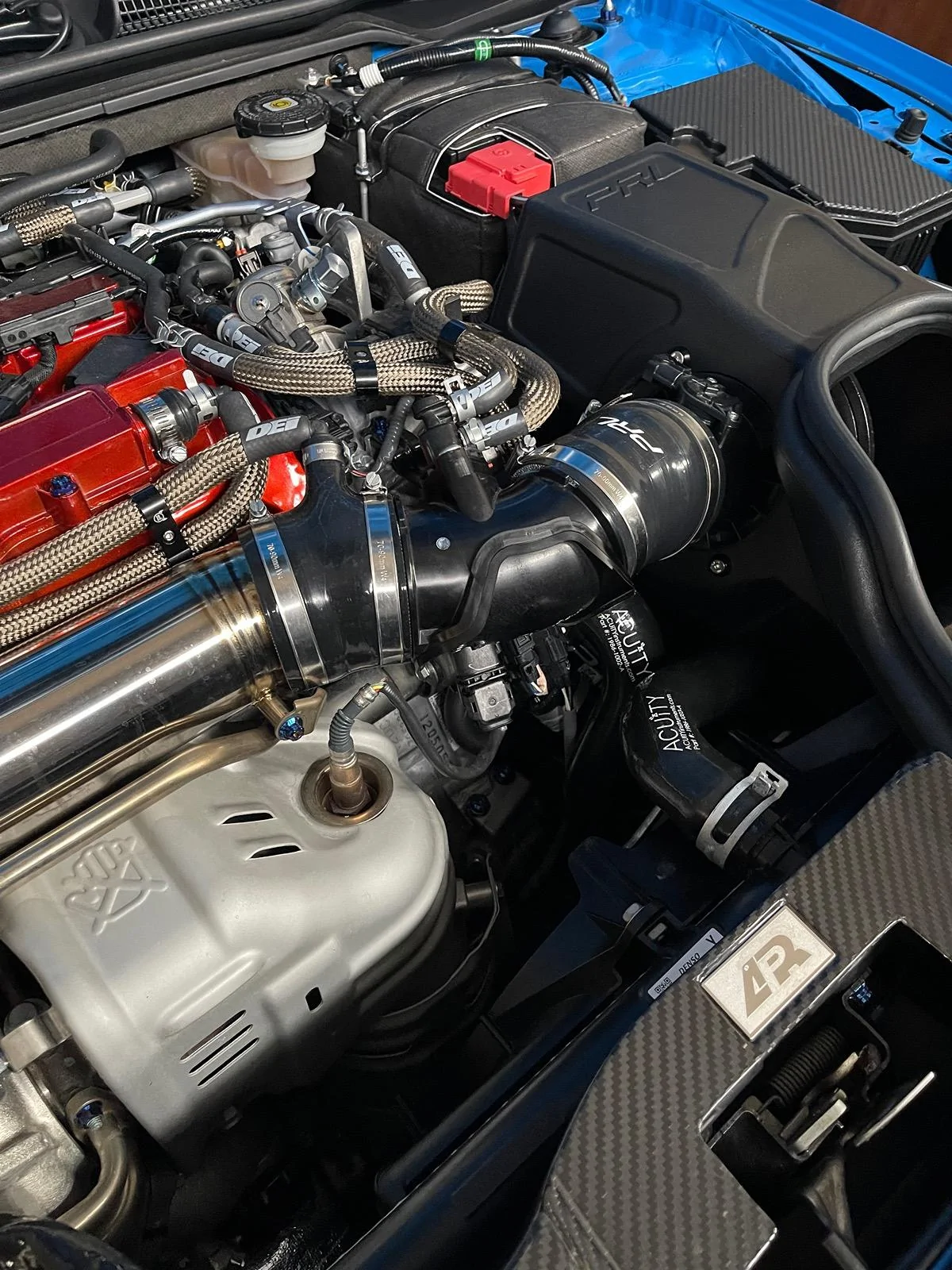

Does indeed look nice and clean. So you just cut to length of each rubber hose, slipped it through and used OEM clamps?
Yup; they come with these heatshrink too that you need to use at the end to help hold the sleeve in place; You don't sleeve the hose all the way to the end; you leave about 1/2 inch or so short so the heatshrink can shrink to the end of the hose (Helps reduce the diameter of the hoses so the OEM Clamps can slide over)
I had intentions of using Gates Power Grip heatshrink clamps (But those are like 4-6 dollars a piece and one time use only) figure I'd stick to the oem clamps which don't look as nice but I can re-use over and over; plus this was very time consuming and after a while you just want it done lol.
Thank you. Gonna order it and do the same. Hopefully this will help next track season.

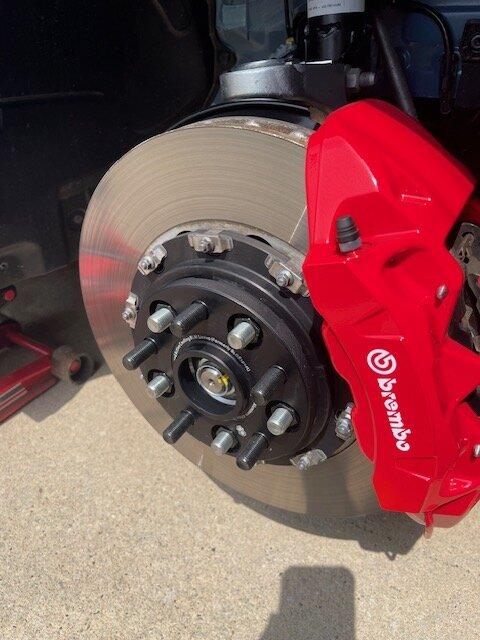

Were you required to trim the factory wheel studs in order to avoid contact with the OEM wheel?
Also, how has the BONOSS been treating you?
no trimming; OEM wheels fit on perfect. BONOSS has been doing well; I got the 7075 aluminum version. It’s super strong. I would track these and trust them. I was concern at first but the quality is super high and so far no issues. Torque them to 94-95ft lbs along with the wheels.

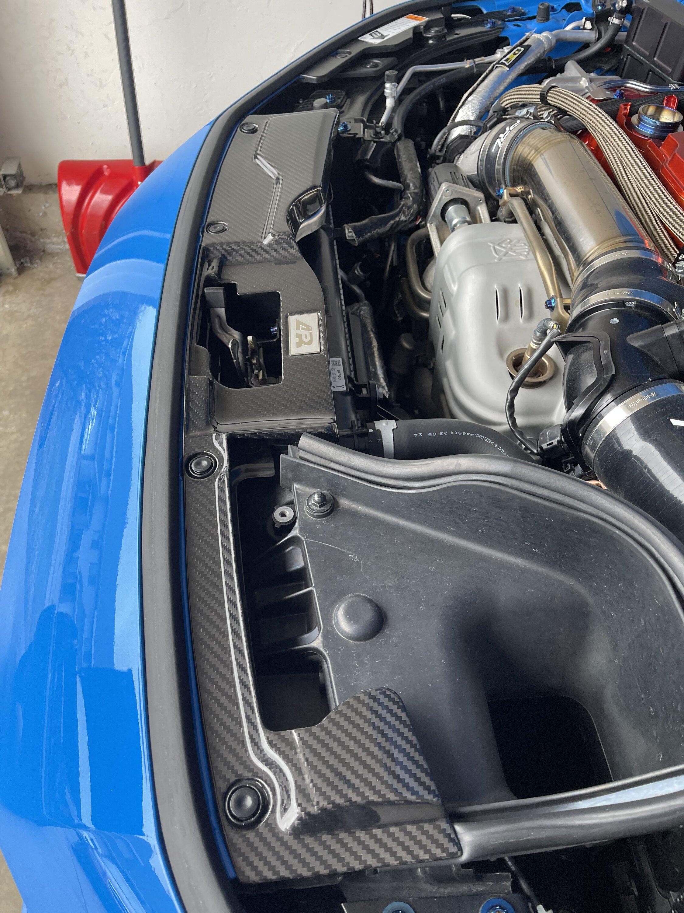

Newest mod; APR front cooling plate; a few things to note; it seems you’d require longer retainer plastic thingy; the OEM ones work but it’s tight. I plan to throw some custom titanium hardware on it when the time comes. For now it’ll work.
I’m not a big fan of the cover sitting on top of the intake rubber on the right hand side; it may interfere with aftermarket air intakes. I intend to pick up the GruppeM intake in the future and may end up cutting the Apr plate if required. For now it looks nice.

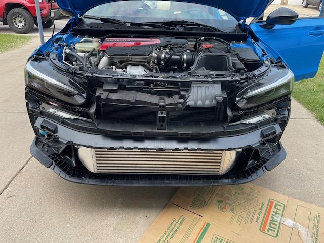

PRL Intercooler was the first hard-mod; the bumper on the FL5 was not hard to remove which is nice since I've worked on a FK8 and that was just horrid to remove; The intercooler upgrade is just massive and screams race car lol; I'm still waiting for PRL to release their charge pipe kit.

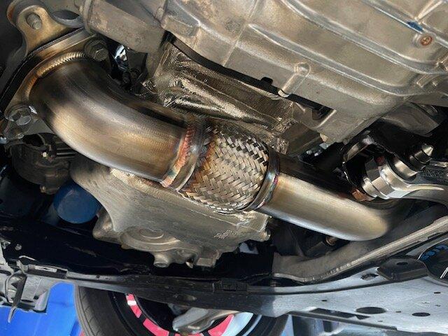

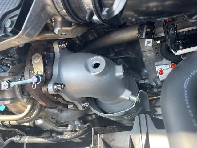

TSP High flow catted downpipe was the next mod I did; along with the PRL drop in air filter. The down-pipe was the most noticeable in power gains on the butt dyno; I always recommend getting rid of the OEM studs and bolts and go with RAMPAGE titanium replacement kit (At least have it handy in the event you break a stud/bolt during removal)
I love the look of the FL5 OEM wheel but hated the tuck it had; +15mm Bonoss 7075 Forge spacers were the next thing to bolt on; I have yet to find a wheel I like so for now the OEM wheels will do.

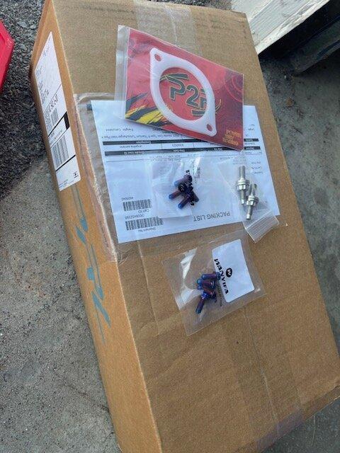

When PRL release their titanium inlet kit; I jumped on it right away and also ordered P2R thermal gasket and more titanium hardware.

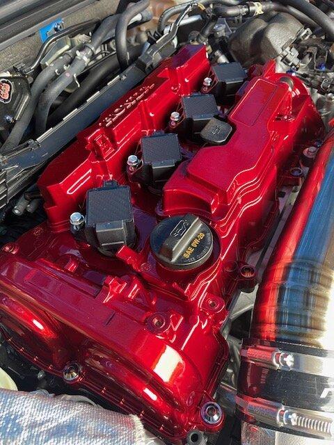

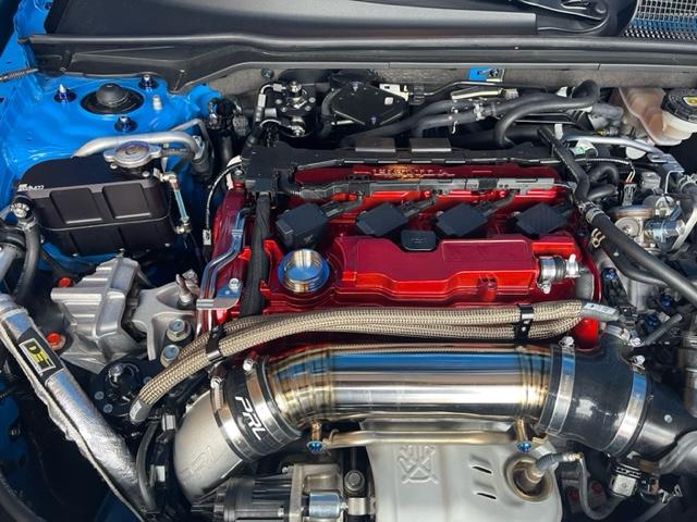

Ended up painting the valve cover; I wanted the Spoon yellow but could not justify the price for paint and the Spoon yellow was just trending too much; everyone was doing it and it didn't feel unique to me so I opt for a nice candy red look. Installed with new OEM gasket because the old one stretch and leaked when I removed it. Opt in for some Chasing JS valve cover bolts; these bolts just look beautiful.

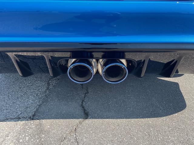

To make the car more alive I opt in for the Apexi N1 catback; I want to retain the OEM exhaust valve since I hate drone; This catback hits all the right notes; quiet when daily driving and gets loud when your on the throttle.

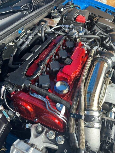

-- Lately I've been focusing on dressing up the engine bay and; did the radium full setup; Coolant tank & catch cans; Chasing JS caps .. ect.

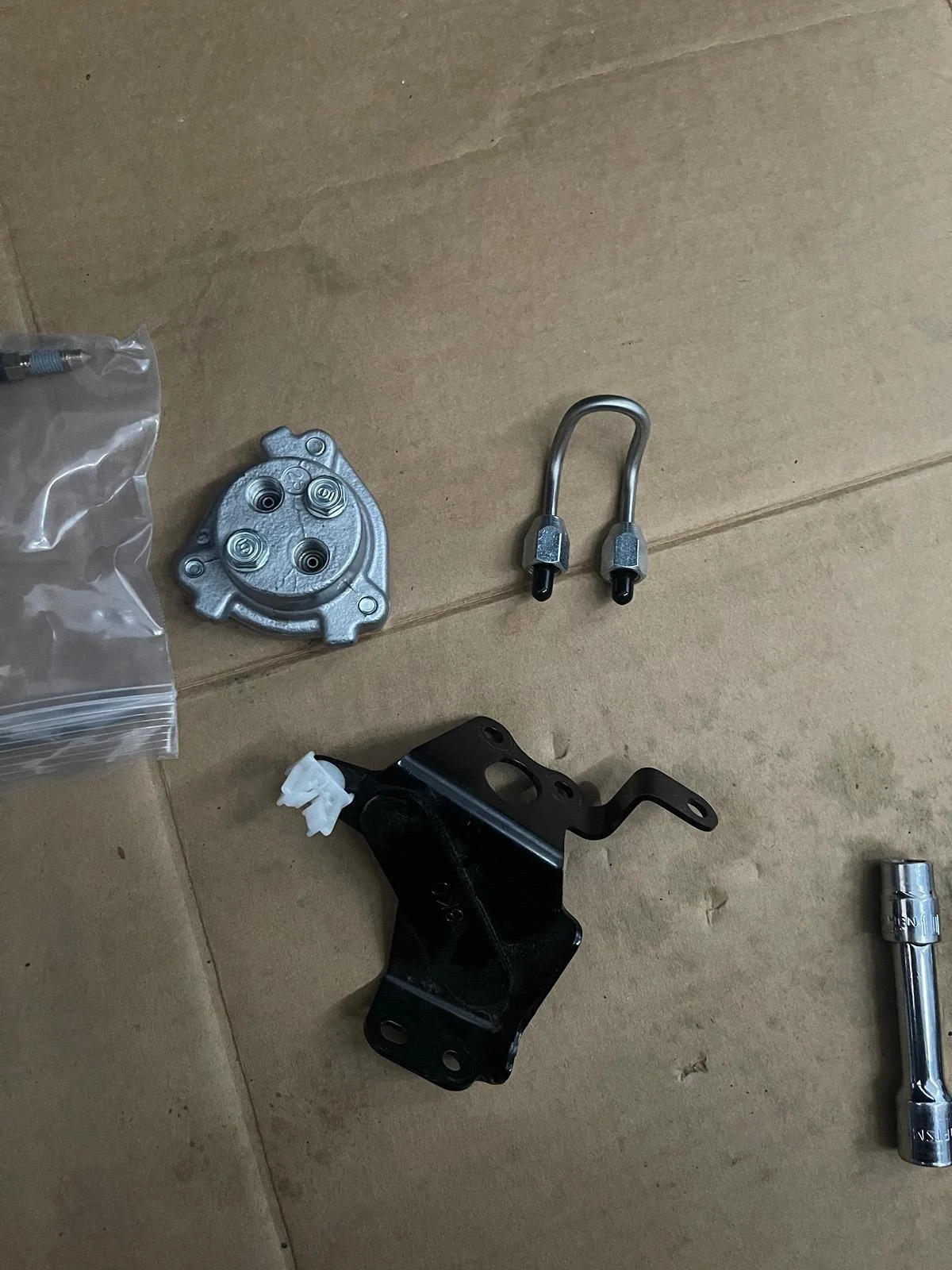

Deleted the clutch damper; clutch pedal got harder just a bit and now clutch releases and engage feels more controlled like how I’m used to.
