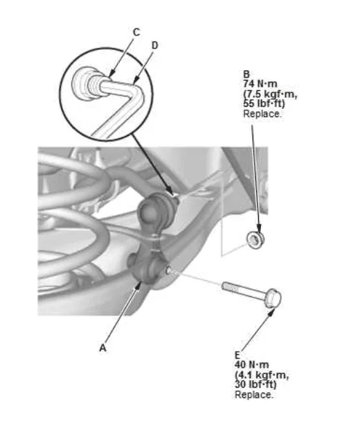

What torque specs did you use for the 10th gen type r sway bar and accord endlinks?
These are the torque specs I used, they're from the 10th Gen Civic manual, but should be about the same for the 11th Gen.

curious where anyone who has torqued that nut on the end link got their open ended torque wrench
