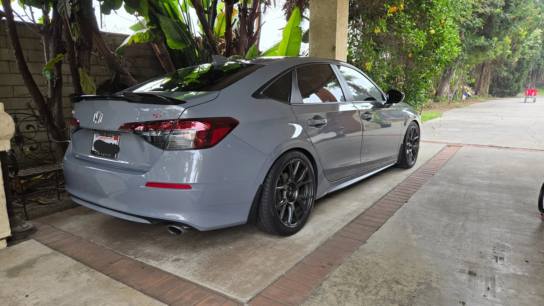

I've had Eibach pro kit on 2 different 11th gen Civics. I can give some feedback here.
On my 2024 hatch EX I felt they were slightly too soft. Would bottom out too easily. I was super happy with the drop height, though.
On the 2025 Si, the first day I thought they were too stiff. After a couple of days I was hooked. The drop is PERFECT, the handling is amazing. Only downside, on both cars, is the squeaking/creaking noises over slow articulation like a speed bump. I heard adding grease between the rubber isolators and the spring helps. I'm used it now. Still highly recommend the Eibach springs all day.
