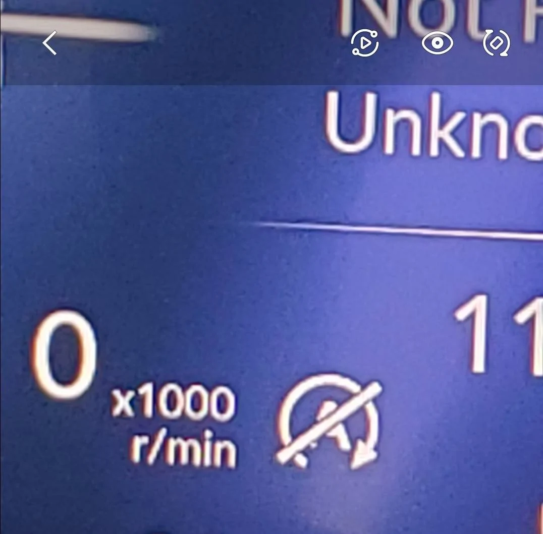

Its been like this for a week. Every time I start it .. Its off ??
11th Gen Honda Civic Auto off engine... what did I do ? Screenshot_20220108-111358_Gallery

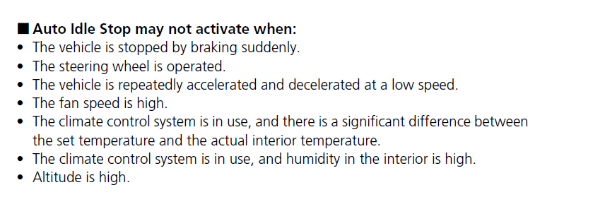

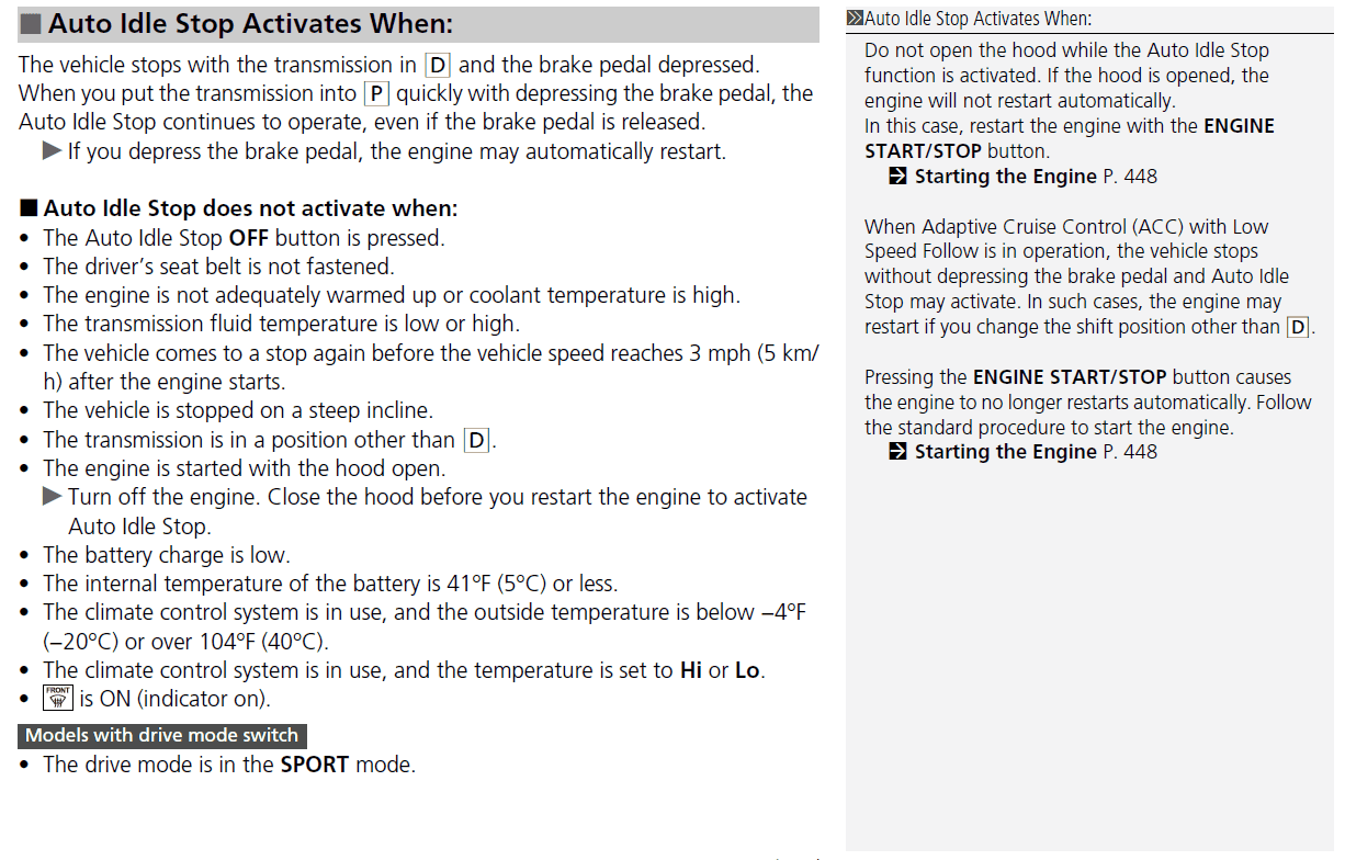

Pick any that apply.
11th Gen Honda Civic Auto off engine... what did I do ? 1641658842933
11th Gen Honda Civic Auto off engine... what did I do ? 1641658865497

I had to turn it off every time. I was pushing and holding for 10sec and over and over trying to find a permanent way to turn it off. Then it just stopped turning on. Idk what I did. I'm like okay ?

Has it been very cold in your area? It's been -20C here, I noticed the same thing, have to drive my SI around for 20 minutes before the car gets warm enough to re-enable start/stop. The start/stop programming is minimally intrusive IMO, I haven't disabled it for the 3K km I've driven so far. It prioritizes cabin temperature over fuel efficiency
