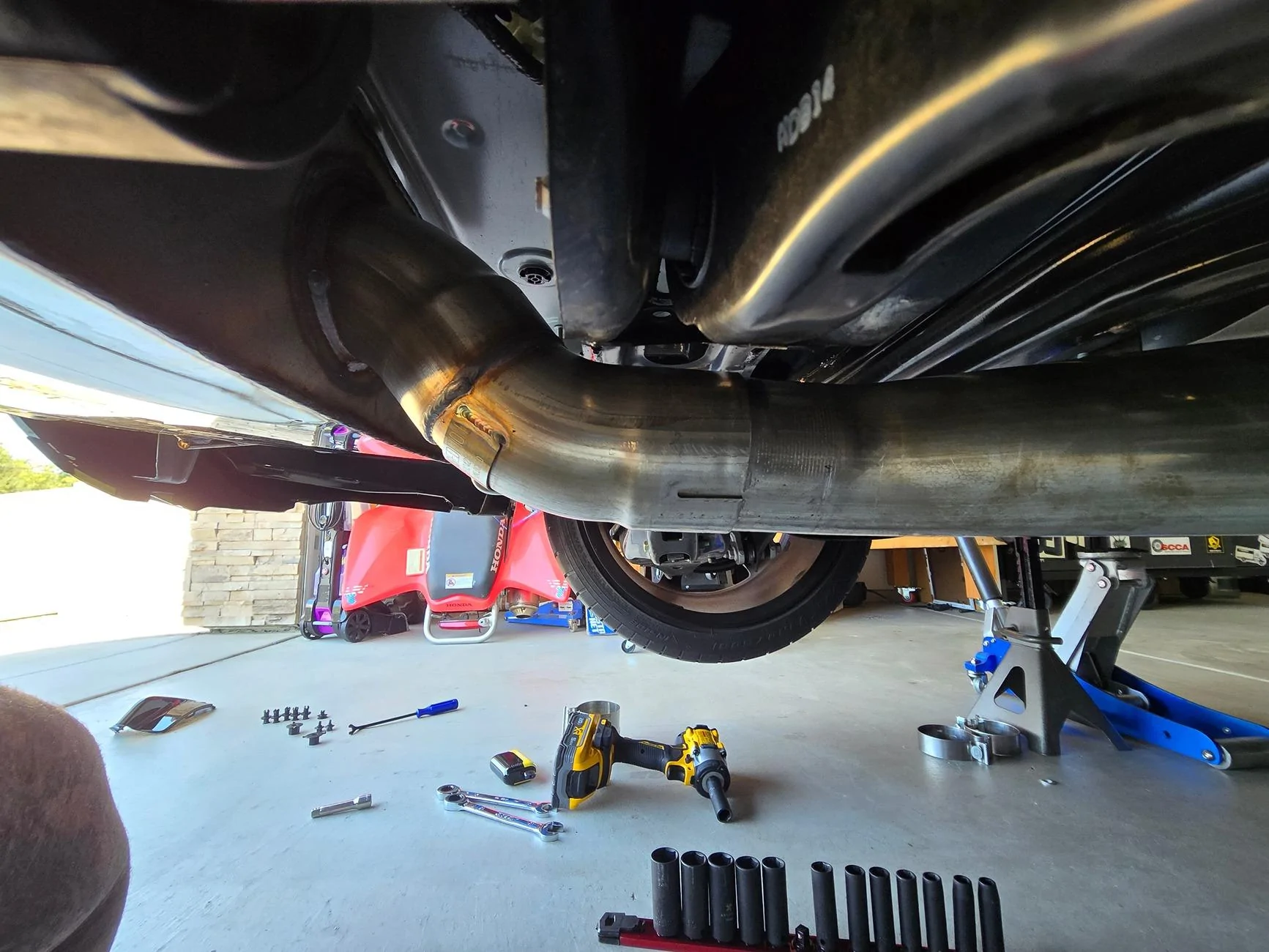

That's the rear section I'm referring to. Where the mid pipe meets the muffler or resonator section of the rear. If you see that cross member section. They say every pipe has to be bottomed out, and I'm 90% sure that pipe is not bottomed out but to push it back any further would be metal on metal against that cross section.

This is the explanation I sent in with my ticket Including pictures and video clips.
Some notes:
  • We have lifted the car now 4 times to adjust every way possible.
  • We adjusted the clamps in multiple directions and I even bought different clamps that we tried after the second attempt to make the sound go away and that made no difference.
  • We tried to adjust the tips in multiple locations and then took them off completely and the sound was still there in all scenarios.
  • We adjusted the pipes in multiple directions.
  • All rubber hangers are hooked up.
  • The sound is significantly louder than what the back 360 camera represents. Standing outside of the car as it drives by and inside the car it is extremely loud.
  • Starts around 2400 through 2800 rpms and sometimes around 1800 rpms. Would be surprised how much time you spend driving at that rpm range. I have been trying to avoid that range by shifting up and down and staying outside of that range.
  • I can assure you no part of the exhaust is hitting metal under the car as we have gone through it thoroughly now four times.
  • The car is new. Only 3000 miles and the stock exhaust does not have any vibrations or resonance sounds and we inspected all heat shields, no rubbing or loose car parts. Again, the car is new. .
  • We have tried to bottom out each section as the instructions state but cannot seem to bottom out the last section to the midpipe section. (please see the video). If I had to estimate, I would say there is an additional 3/8" to 1/2" in order to bottom out but cannot due to the control arm mid section of the car. (please see video for visual)

Personally, I'd go back through and steal a tiny bit from each section and give it to the last section.

Yeah that looks too close something is off could be the pipes they sent or maybe they way you set the exhaust hangers but something is definitely off.
The crazy part is, they say every connection needs to be bottomed out. If so, there should be more room at the end.
