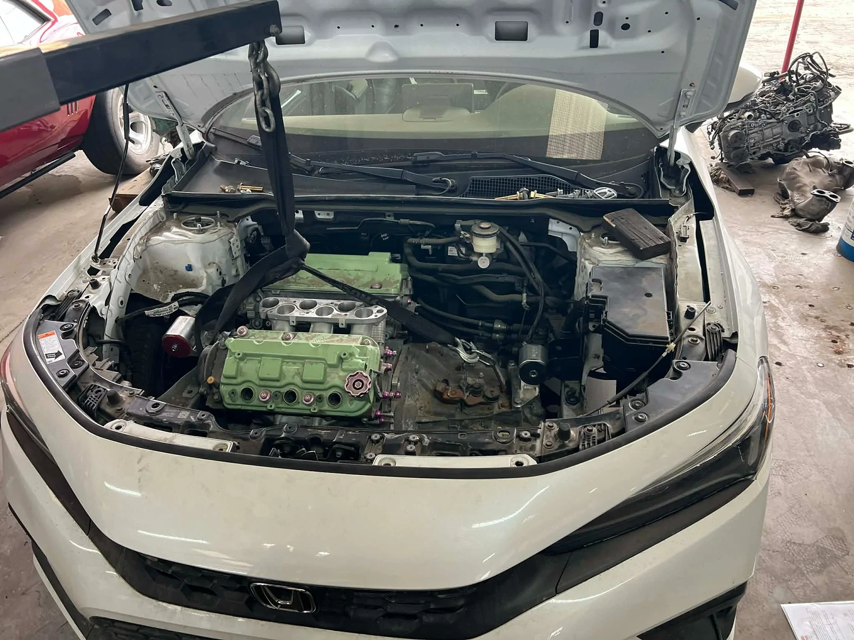

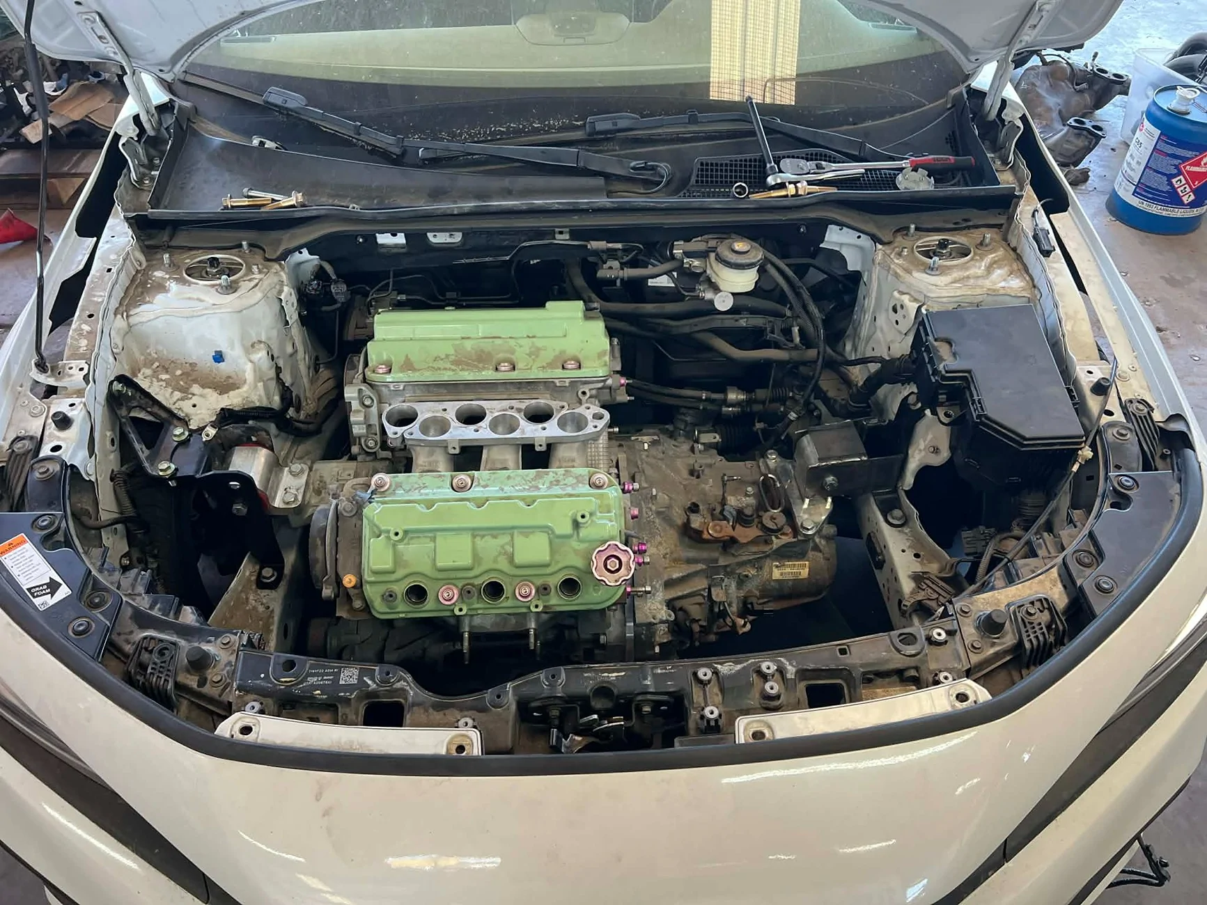

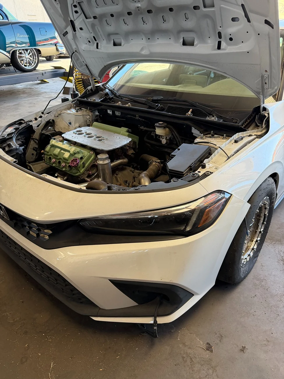

We are starting on the mounts, engine is in and fits great
11th Gen Honda Civic Axion Industries J swap build att.uptxOSYW5--tUM2_I-Jh2wfMh-mYQHqSOLv5GcFd68

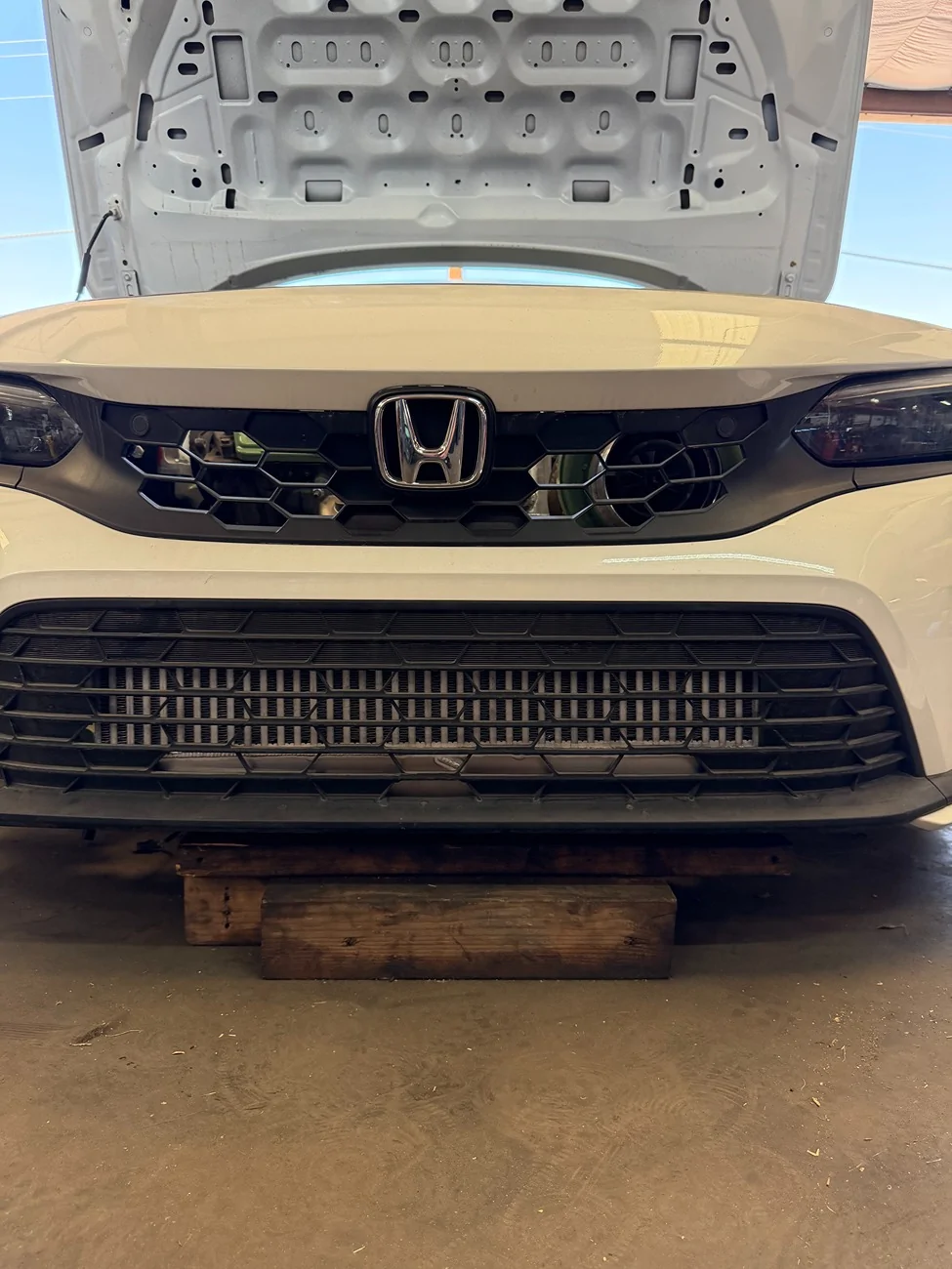

New updates 72mm turbo up front and the massive air/air intercooler
11th Gen Honda Civic Axion Industries J swap build IMG_0346

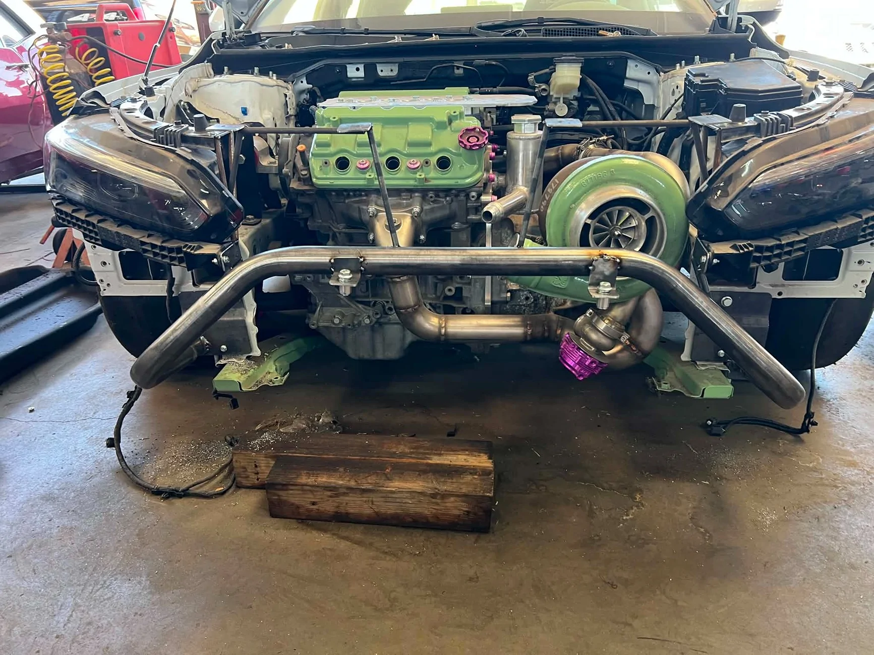

Fabrication now on the front tubular support bars for intercooler. Belak wheels are back on the car, one step closer to some 1/4 mile times
