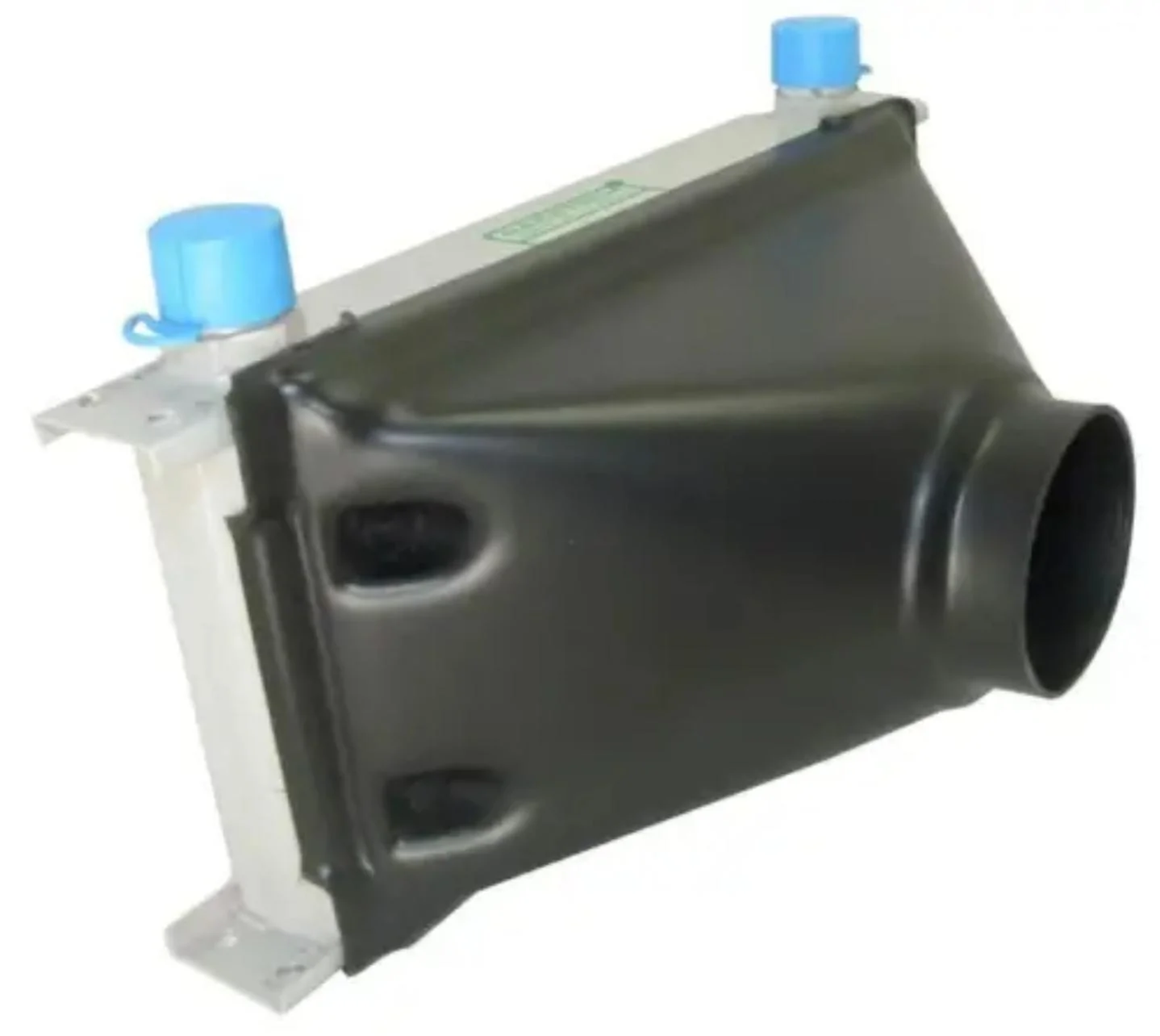

Im going to relocate the HEL oil cooler to the side so get more radiator air flow. I will assume that might not work enough so the next plan is to customize a 2nd oil cooler like these guys.

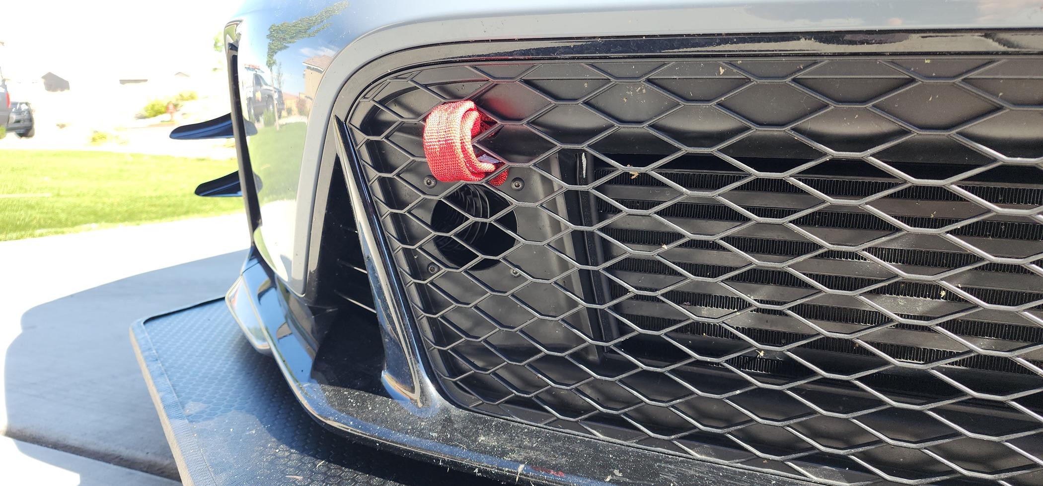

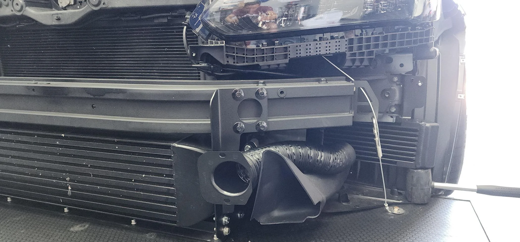

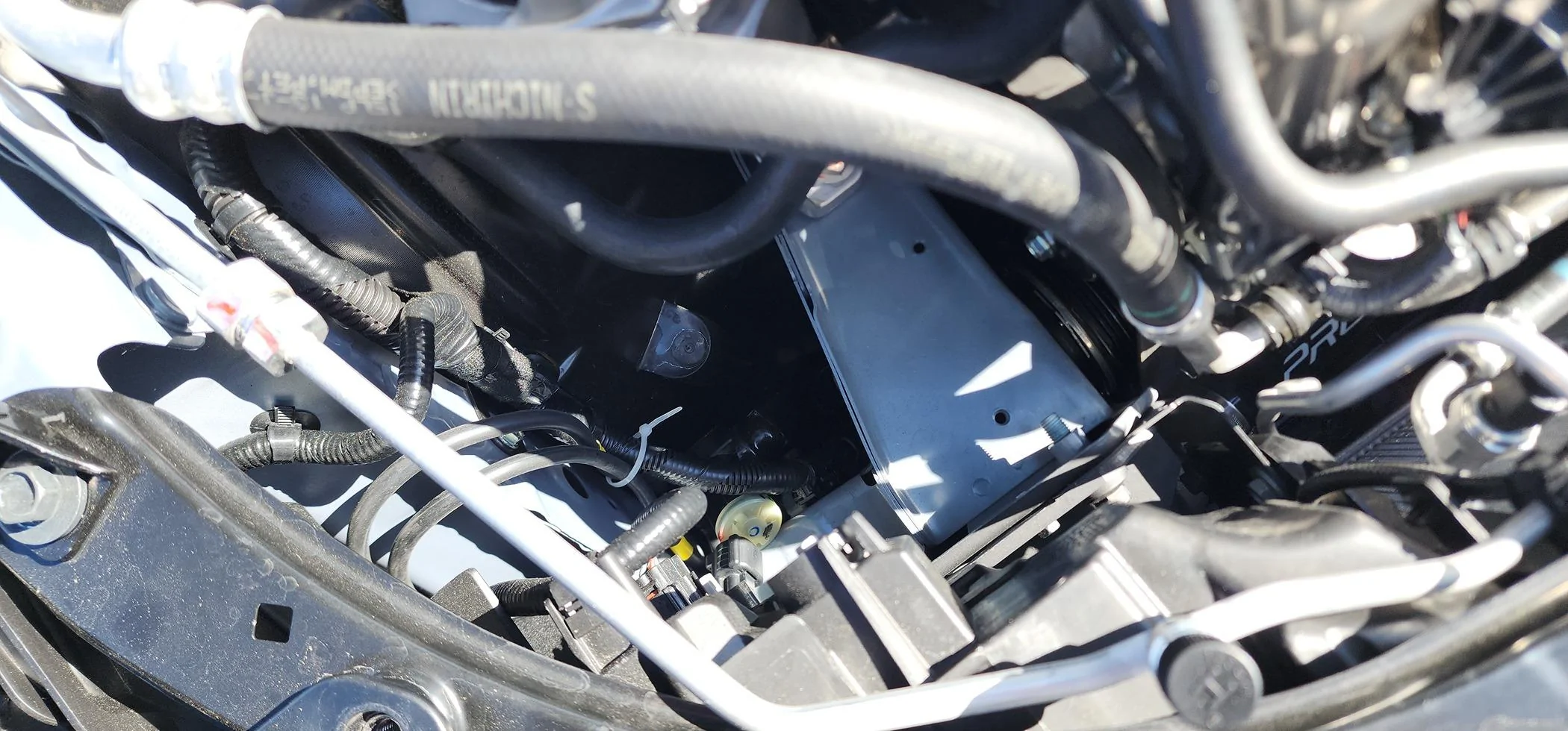

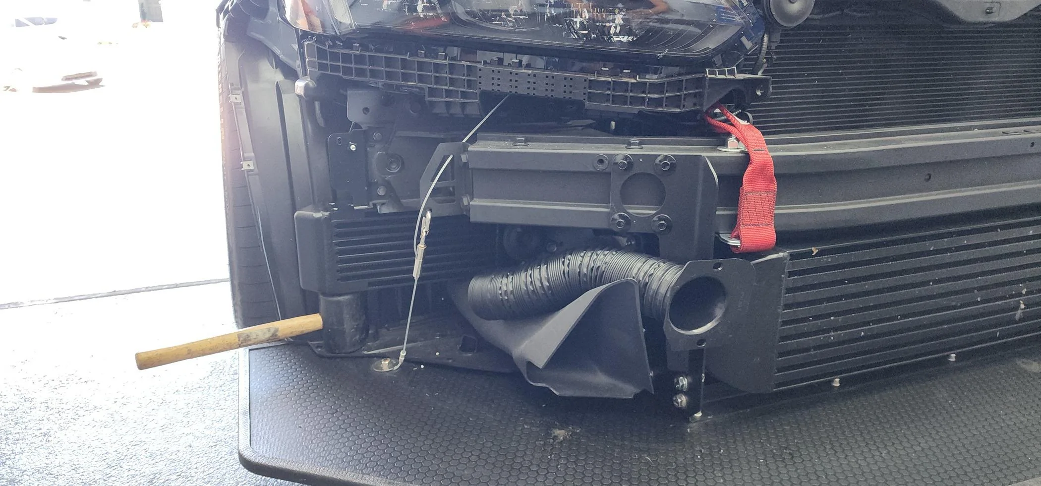

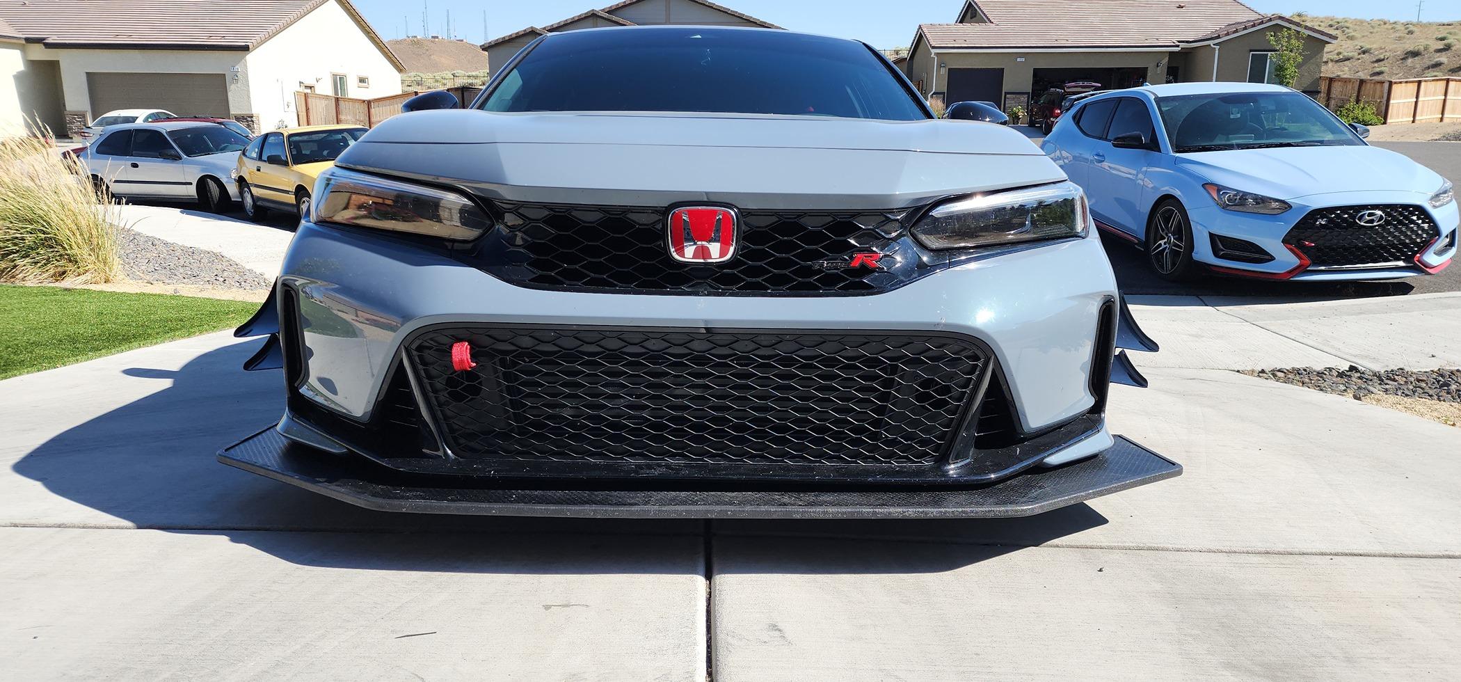

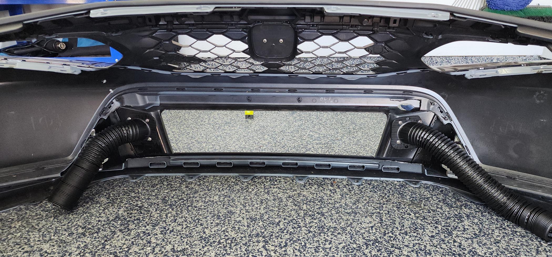

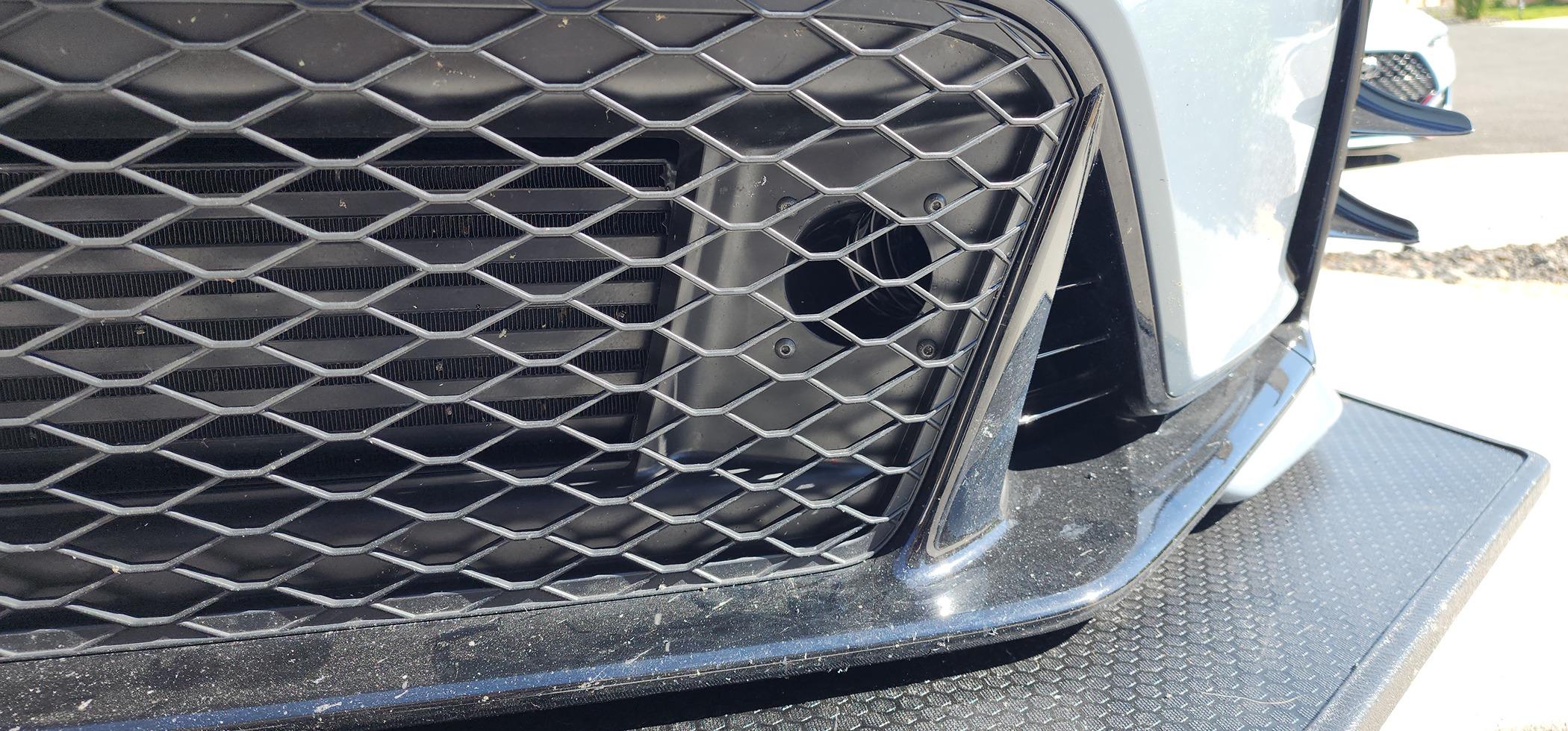

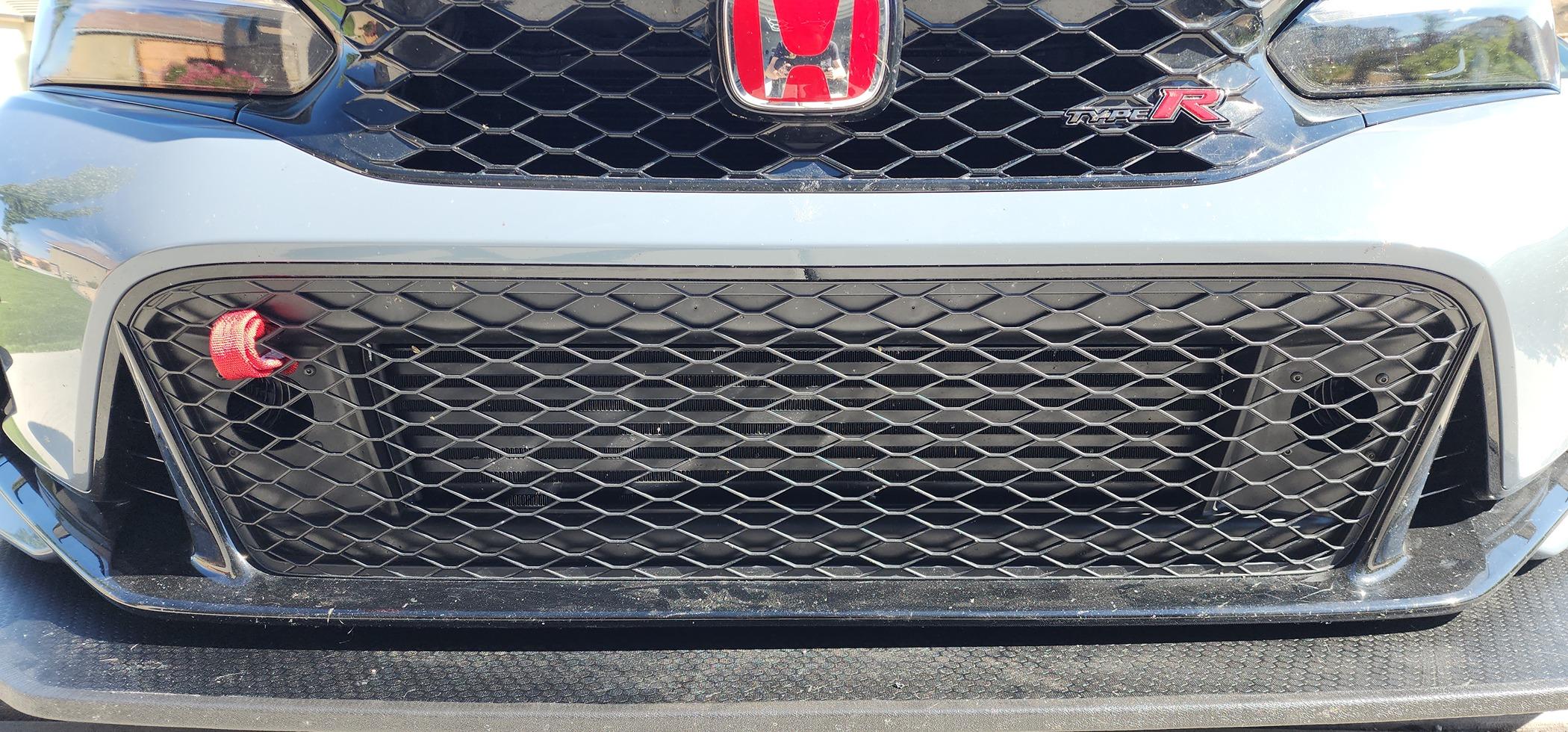

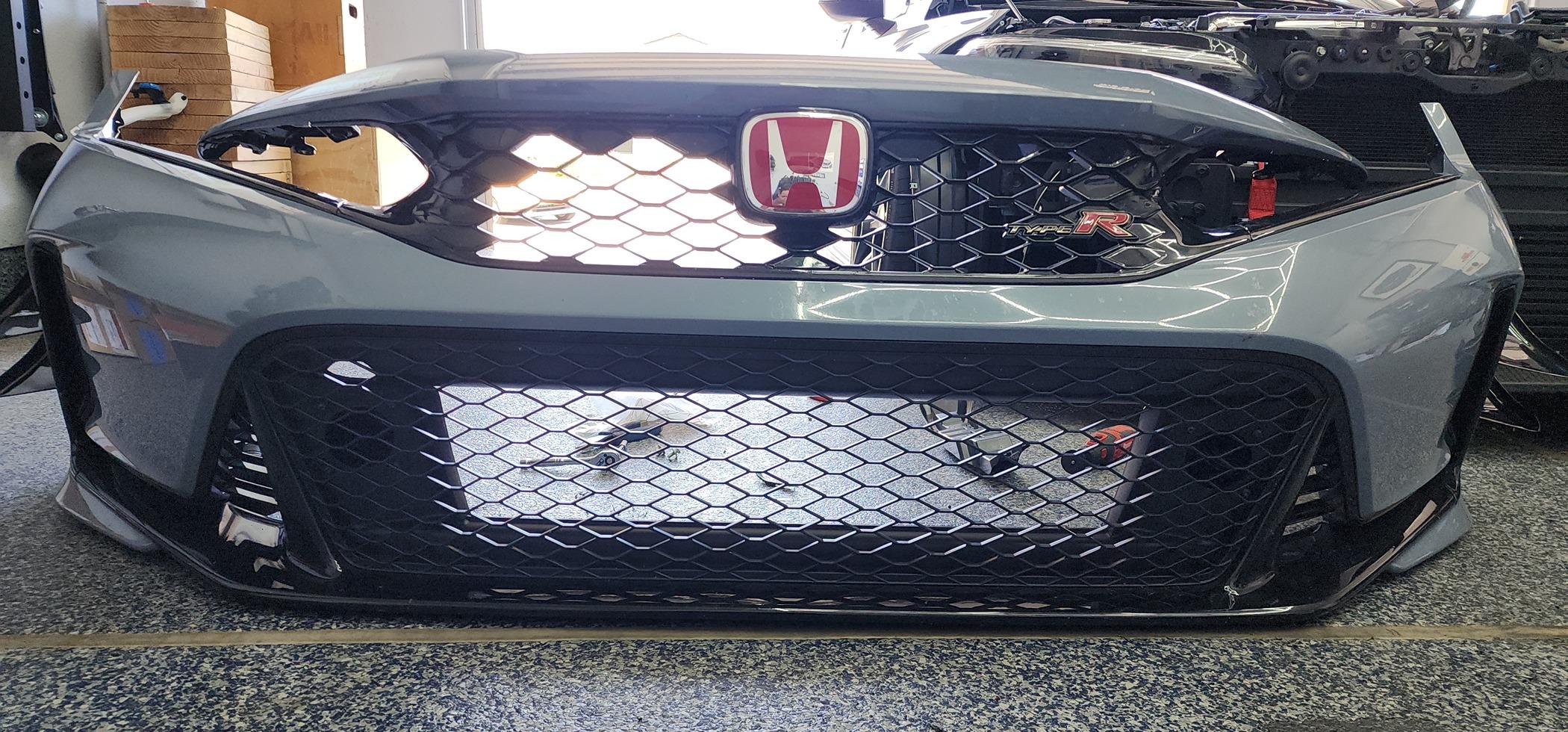

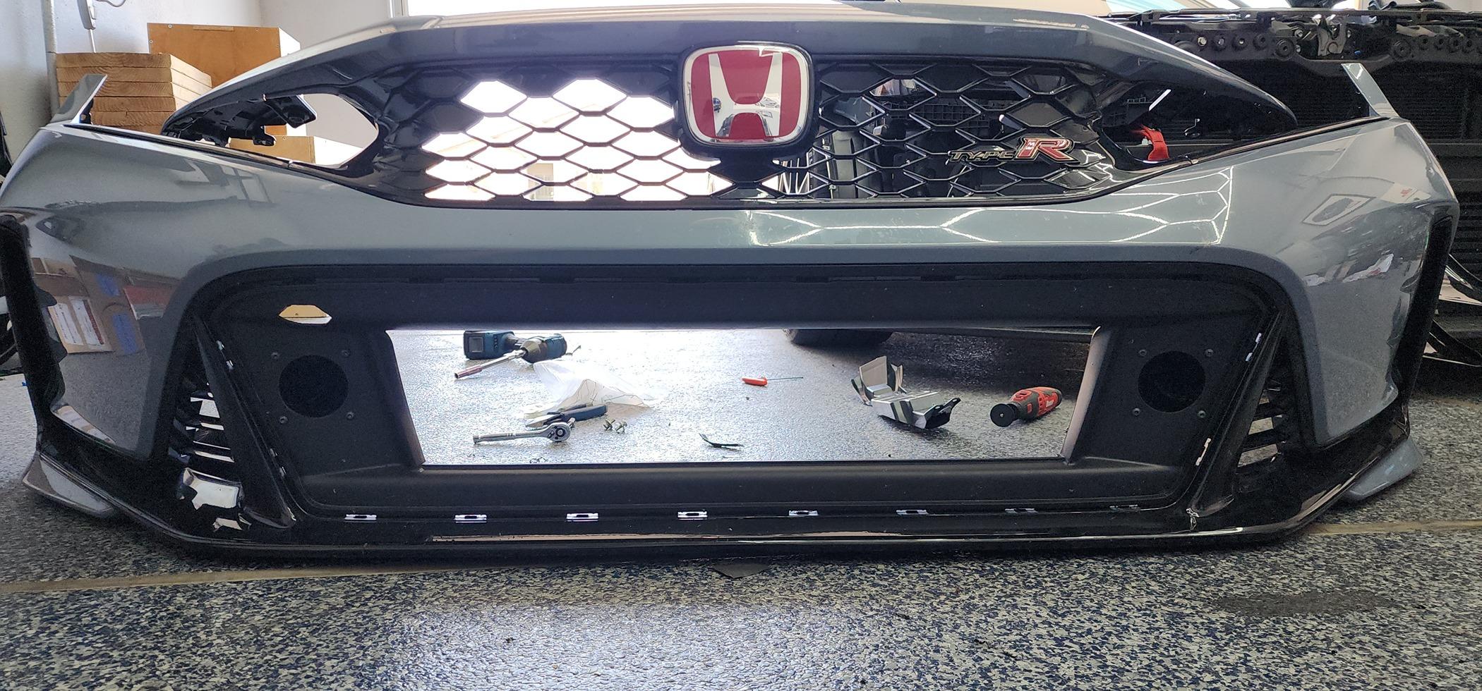

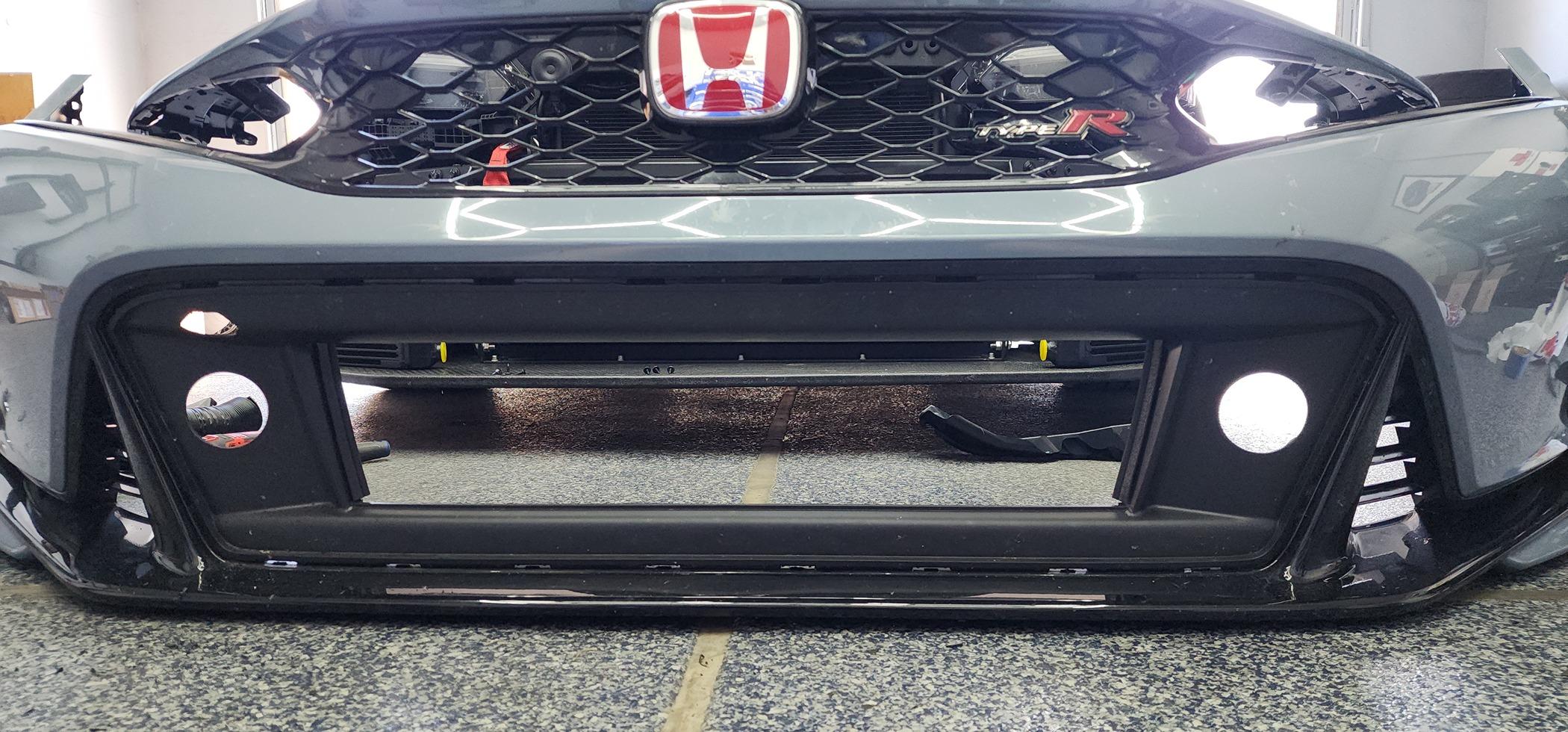

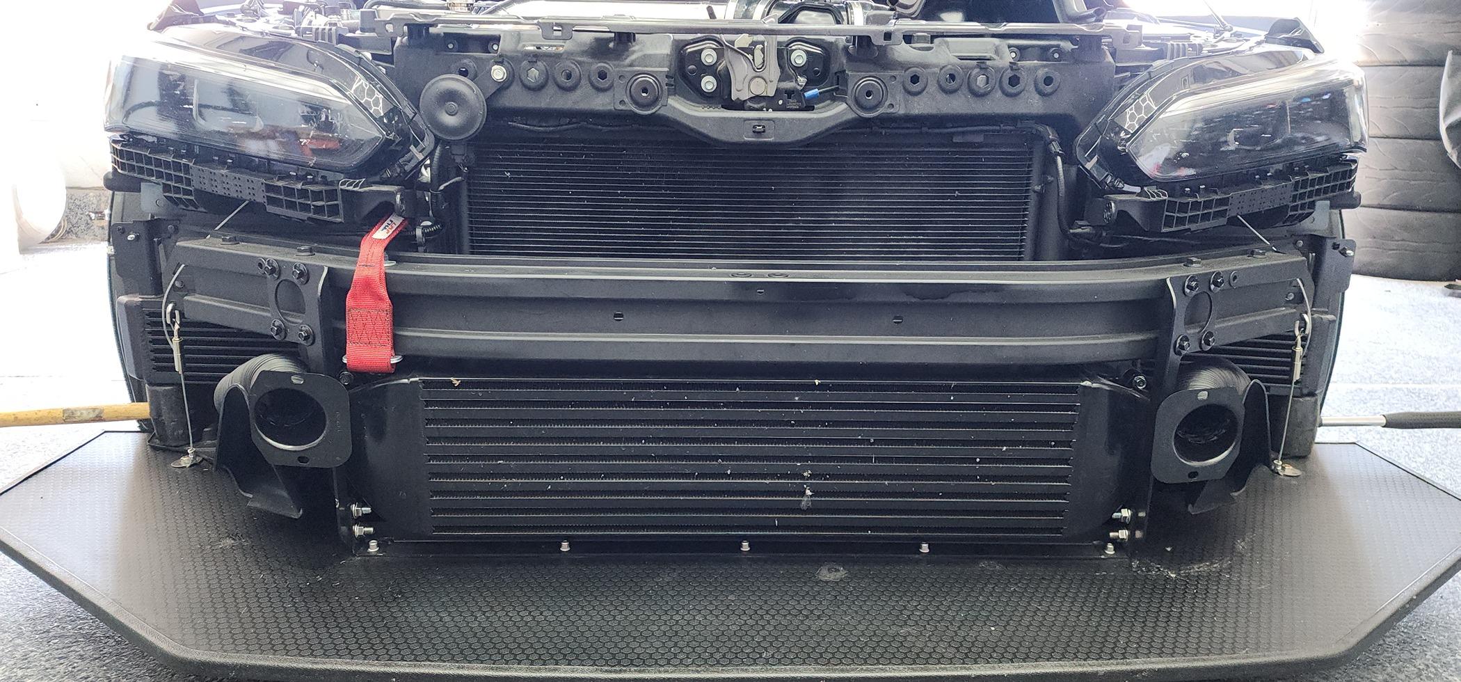

Here's my progress thus far. Still waiting on a few pieces in the mail, but I should have it all in working order in a couple weeks. Need the oil cooler covers which ship out late next week and also the custom lines, then I can test. My first track event might not be until late September so it'll just be street testing until then ?.
I went ahead and just went for it yesterday after talking with Joel from driven crazy, and he said he might not pursue the oil cooler kit. This is the idea I've been working on conceptually for several weeks and I thought well hell, let's put it into action. Luckily I have a summit racing in town so I was able to pick up everything and get to work.
The set up is a simple concept really, and my goal was to maintain an OEM look without having to cut the painted bumper. Even simple concepts can be tricky though, and this one took some figuring out with a lot of measuring and such. I'm really happy with how it turned out so far. You can barely see the inlets and if you didn't know you would think the car came that way.
Additionally, I'm also going to be test fitting the fk8 secondary radiator kit I helped develop with driven crazy to see if I can get it to fit/bolt up on the crash bar nicely ?.
I'm hopeful that with oil and coolant both being addressed in a similar fashion to what I had on my fk8, that I might have similar if not better results. I'll definitely keep you guys posted with all of it.
