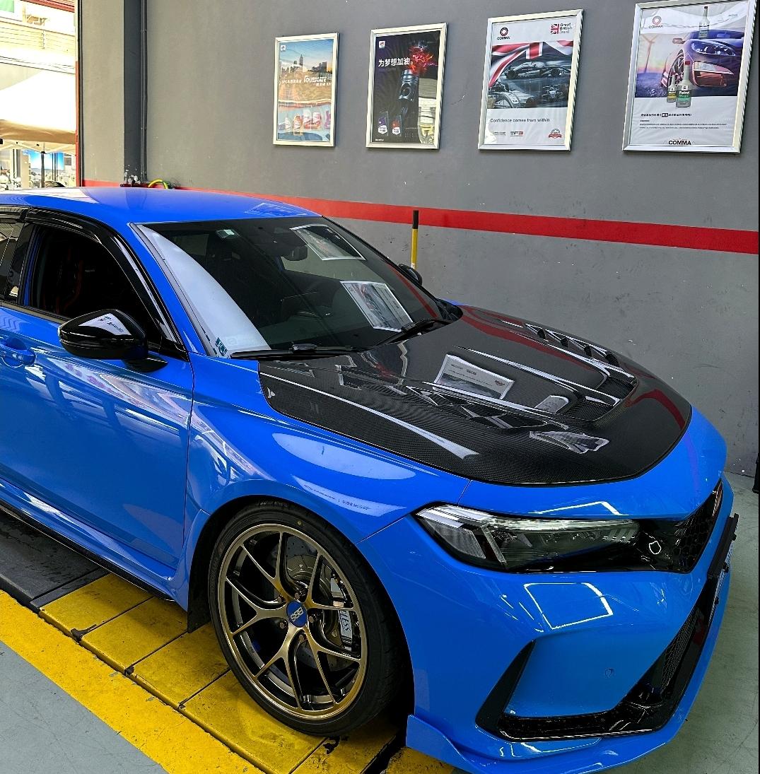

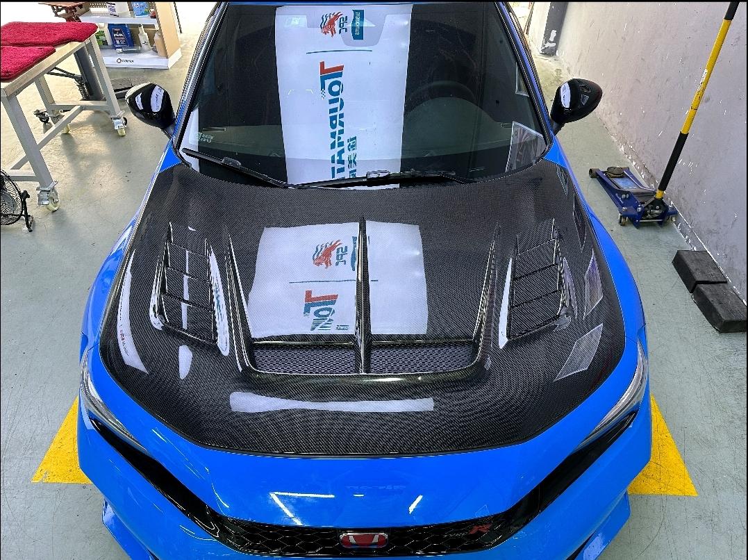

It is at alibaba. It looks like a mugen CF hood.
I dont know about the lip.
I can forward you their contact if you are interested.
Your lip is also from Alibaba? It looks nice. Just trying to figure out what to put on mine to match the Voltex wing that will be arriving in another 12 months. ?
that's not my car but the sellers pictures. i didnt buy a lip but thats the same CF hood i ordered.
I probably will not buy a lip since i know, i will break it!
My apex wheels are coming next month. Apex wheels takes month to get when its back ordered :(

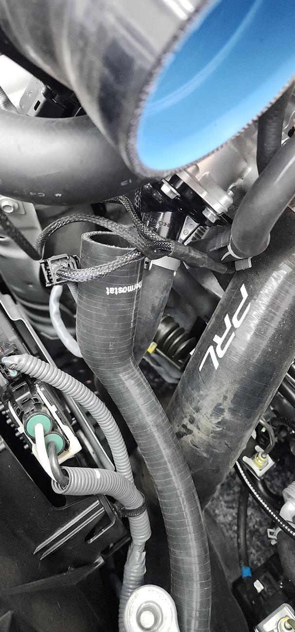

I installed a spoon thermostat in the 4piston engine, and I've noticed cooler temps driving around town. I've got a track day coming up on July 13th which should be insanely hot outside, so I'm kind of curious to see how it goes.

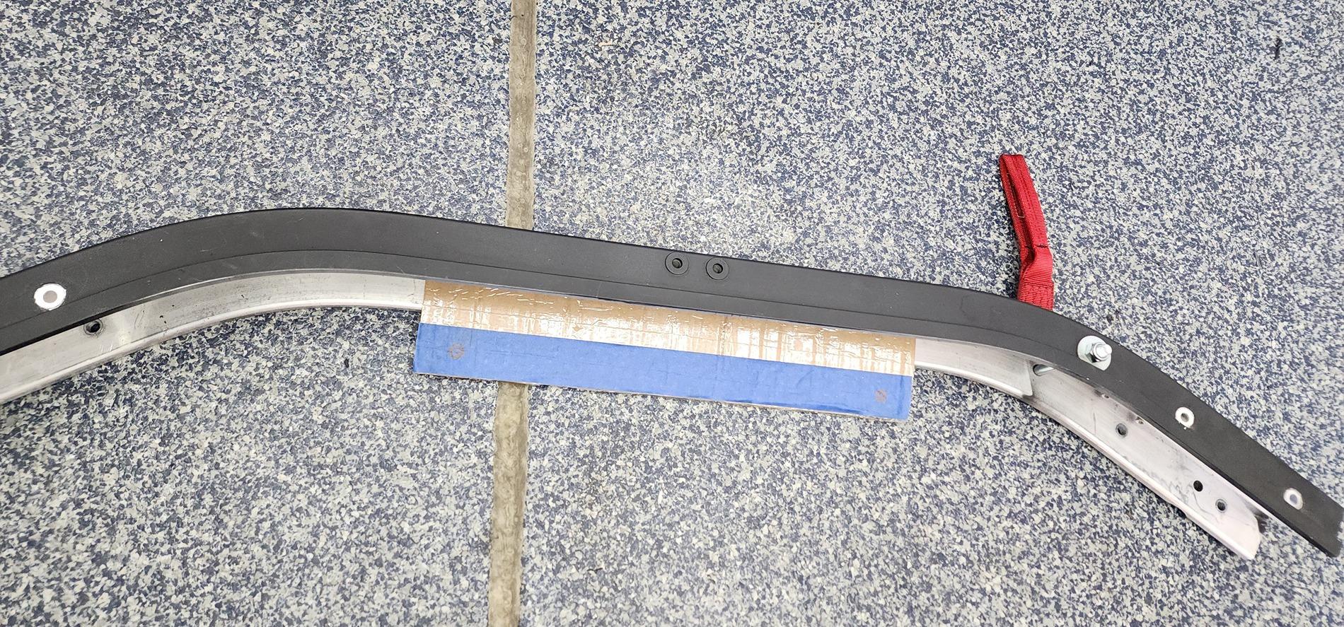

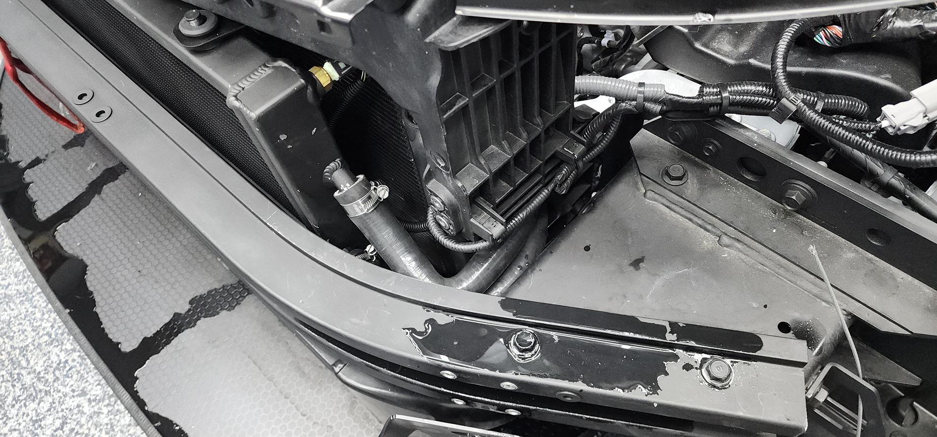

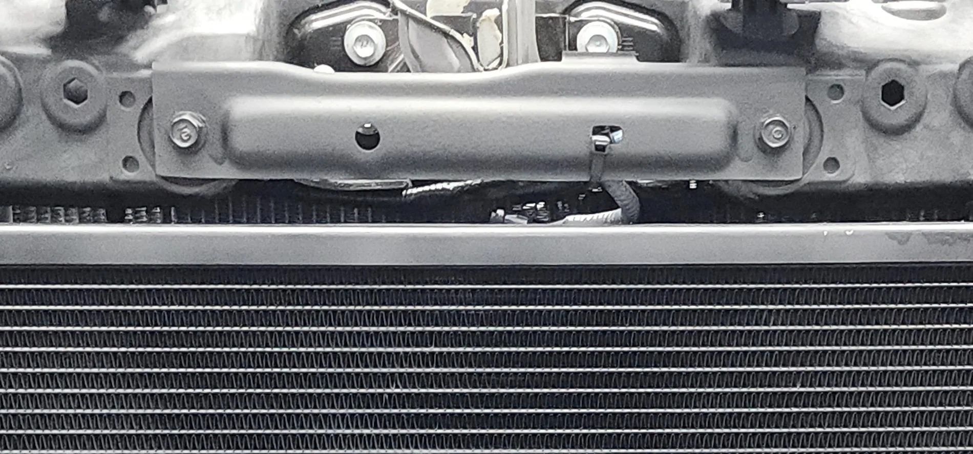

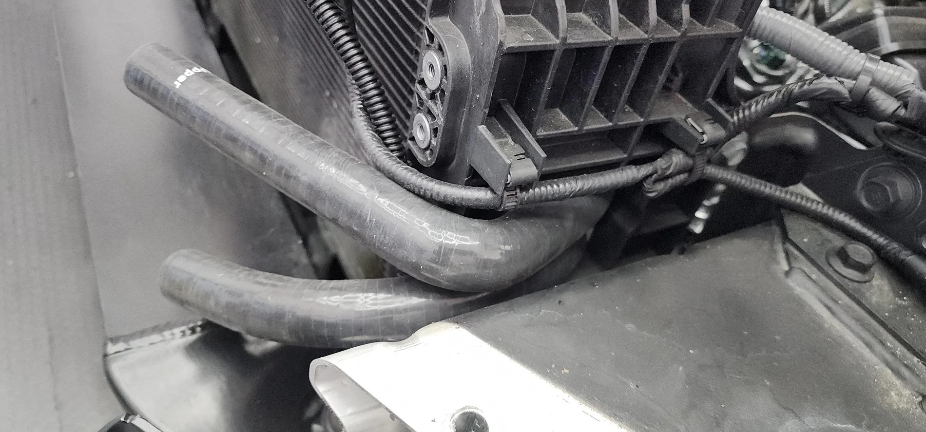

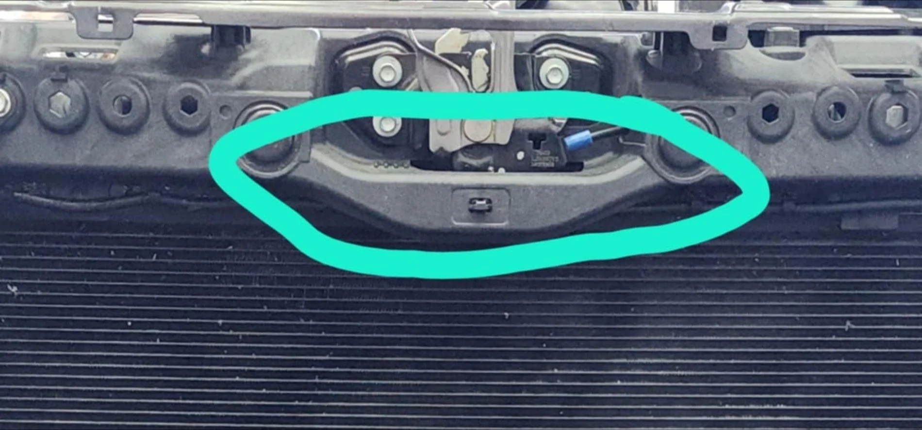

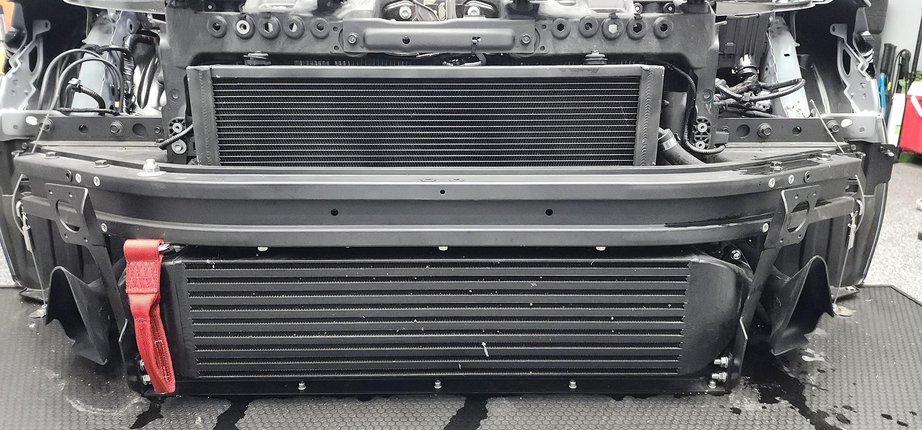

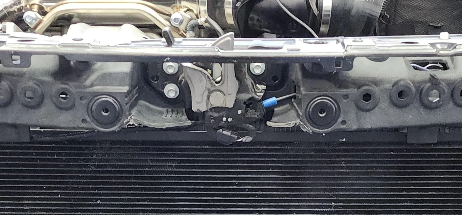

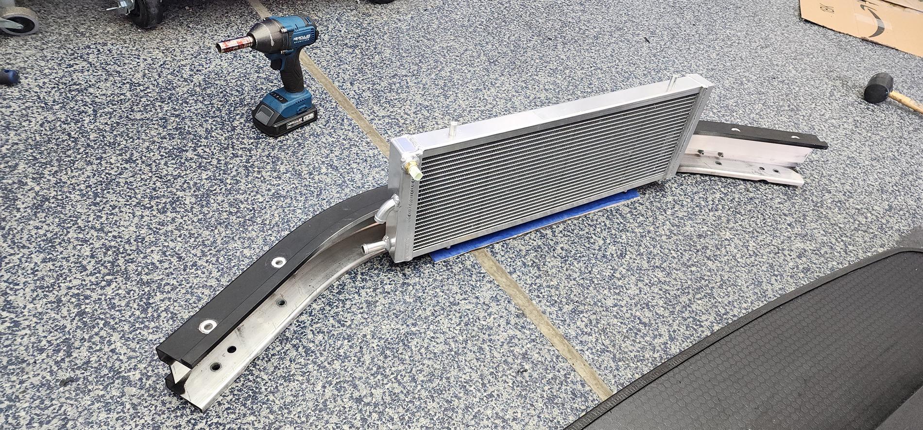

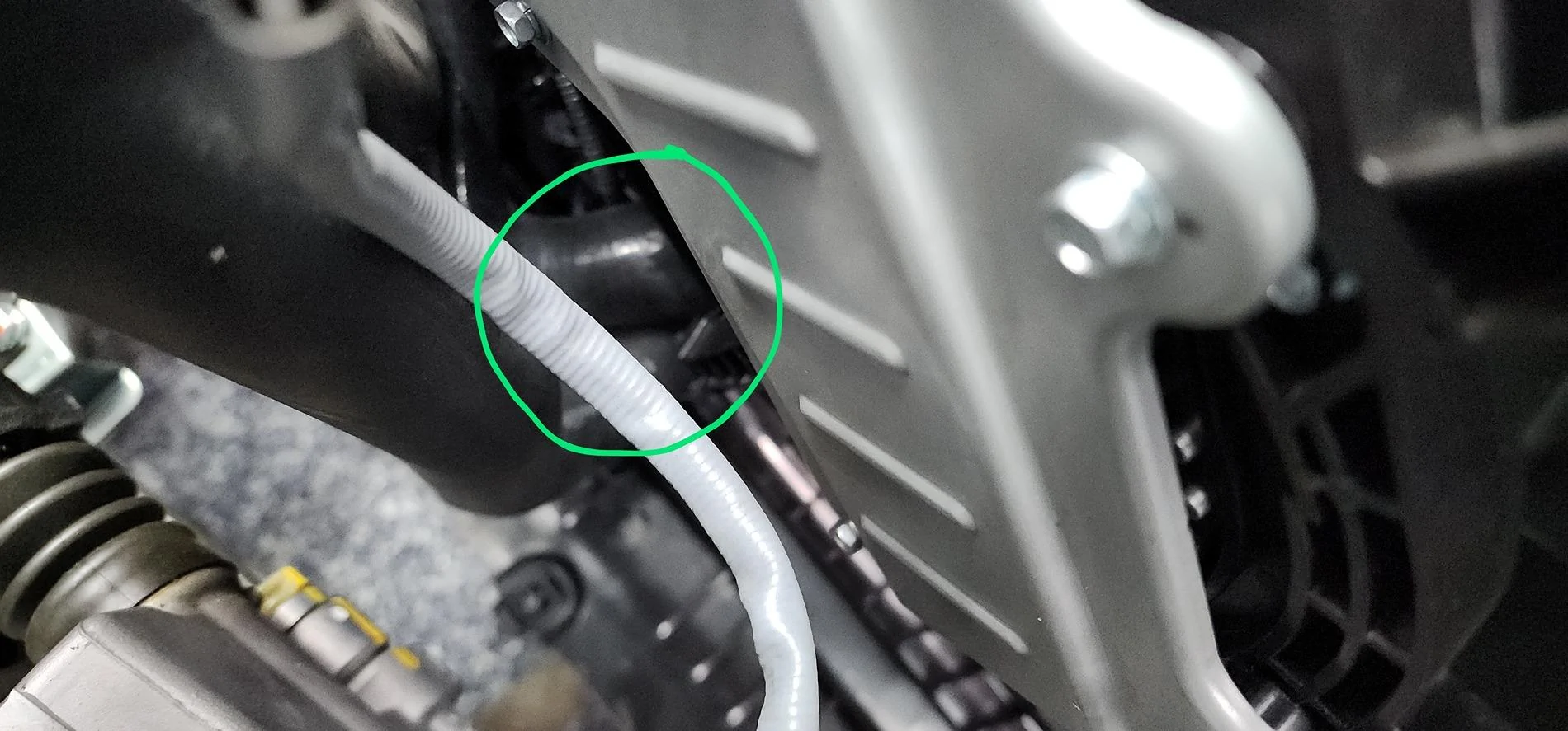

Was able to fit the @drivencrazy.sg fk8 hypothermia kit onto the fl5 oem crash bar successfully! Will be testing on the street until I'm able to take it to the track this fall.
Did require me to make a custom bracket which you can see the mock up with cardboard and painters tape. Basically the bracket is just a rectangular piece of steel sheet metal I got from the hardware store. It's bolted to the inside of the bottom of the crash bar, with holes made to just barely fit the posts/bushings of the radiator. The bottom bracket is rock solid.
Some of the core is hidden behind the crash bar, but the top portion of the core is exposed and will still take up the entire grill area. Even if the bottom was fully exposed it wouldn't get air due to the limitations of the size of the grill opening.
I also had to cut the middle of the bulkhead to create enough vertical clearance for the radiator, otherwise the posts/bushings were directly touching the PRL intercooler. Plus this allowed me to have a little more of the radiator available to catch air flow.
I used the support brackets from the kit to stabilize the top of the radiator by bolting them to some rigid tabs of the OEM radiator support that hang down.
The hoses from the kit route through a small gap in the OEM radiator support. They barely fit but they are not kinked or squeezed (I will monitor if the lines start to show any wear in the upcoming months). The lines tap in as designed into the bottom of the radiator and into the thermostat. The thermostat hose did have to get about 1.5" cut on the side that plugs into the hypothermia core as it was just a little long.
I do have some ideas to share with driven crazy to make install much easier and to where it would not require any modification/cutting. We will see if we are able to successfully implement these changes to make a kit that is more consumer friendly. For now though I myself will run this set up and monitor it for reliability (hoses mostly) and performance (I can't see why it shouldn't be equal to the fk8 set up).
Outstanding. Thanks for sharing!
i thought the spoon thermostat's throw CEL code?
please let me know the outcome. i might run around july which will be 110F :(
