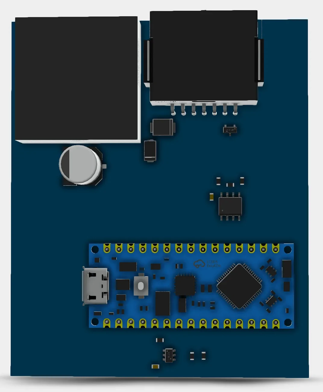

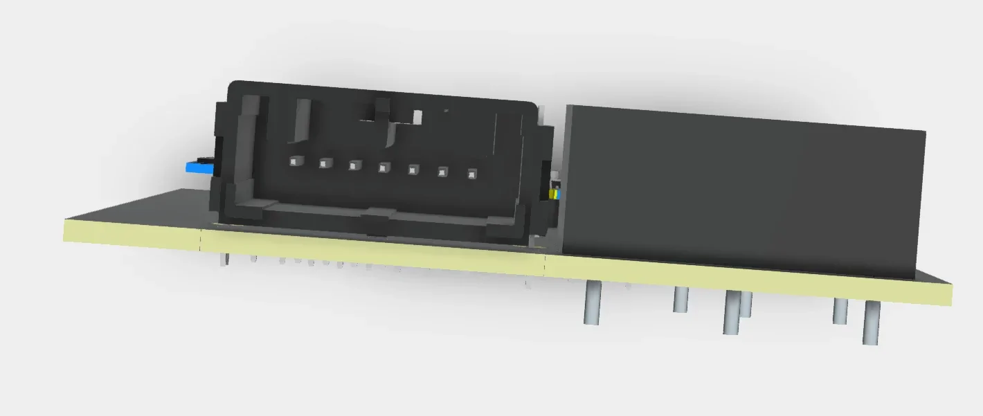

Update: I have further modified the board and it's ready for PCB prototype production. I have design the board fit inside the smallest version of Lansing's "D" style enclosure seen here. They do custom features like flange mounts for surface mounting, and can pre mill the end cap to accommodate the single connector seen in the picture above. The footprint is pretty small: about 3"x2.75" by 0.75".
Even better news, I am working with a member here to integrate to his Helix DSP and I have confirmed that Helix uses standard potentiometers in its remote control strategy, so we will be able to control Helix DSP/amplifier volume with this device (so factory integration is possible).
Here's the latest 3D model for fun while you wait..
Thank you so much for your hard work on this. I'm excited to upgrade my audio in my fl5.

Thanks for the appreciation- it means a lot! This is a lot of work indeed, but it's also very satisfying.
Do keep in mind that initially there will be work on the consumer's end to integrate this into your DSP solution. It won't be turnkey right away because I may not know how your DSP handles volume control. But with each successful implementation, we'll have more and more knowledge and can make the device more and more of a turnkey solution! Eventually, my vision is to have this thing as bundle with a factory integration harness, where you specify your car and DSP and I mix and match the right solution for you (or you can just order it that way on a website, for example).
The more interest there is here, the faster we can get to that destination state!
