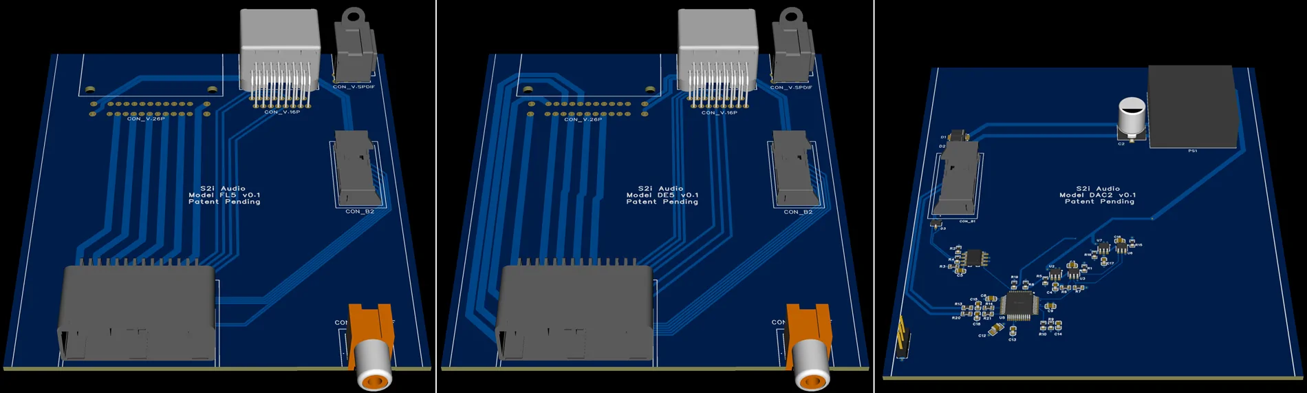

Exciting Update 3/31/26:
PCB orders have been placed for the motherboard and both vehicle model daughterboards (Honda Civic XI with Bose, and Acura Integra DE4/DE5 with ELS)!
There was a lot of fiddly stuff to address in the design in order to get a clean and reasonably-priced build. All SMD devices will be placed by the PCB manufacturer and I'll be soldering the through-hole components because that's pretty easy, so no need to pay for that. I'll be looking for two beta testers per model, but I won't be doing that until I've tested this in my own car first so I don't waste anyone's time if there's a surprise bug in the design. It also gives me time to measure the specs for the end cap cutouts (for the connectors), and I'll probably be fabricating an adapter mount that allows you to bolt this device to the factory mount that hold the OE amplifier (which you'd be removing from the car).
Including some glamour renders for giggles. On the daughterboards, there's one connector missing from the render because there's still no 3D model from the manufacturer, so you'll just have to imagine it's the factory 26-pin connector from the OE amplifier :ROFLMAO:
Logic Board (likely will be a standard part for all late model Honda/Acura cars):
11th Gen Honda Civic "PURE" Digital Factory Infotainment Integration Honda Civic Bose / Acura Integra ELS {filename}
Integra-specific daughterboard. Notice it only has connectors and no solid-state devices. This keeps the cost of adding new models down, and even allows the end user to side-grade to a different model if they change cars (to another supported vehicle). You'd just need a new daughterboard and a new harness if the pinouts differ.
And the Honda Civic model. Note how the traces are markedly different. This is because of the different pinouts on the OE 26 pin connector at the upper left (the missing one, lol)
Note "CON_B1" and "CON_B2" in the two boards - that is where there will be a bridge connector between the two boards. All connectors and devices are automotive grade for longevity and reliability.
