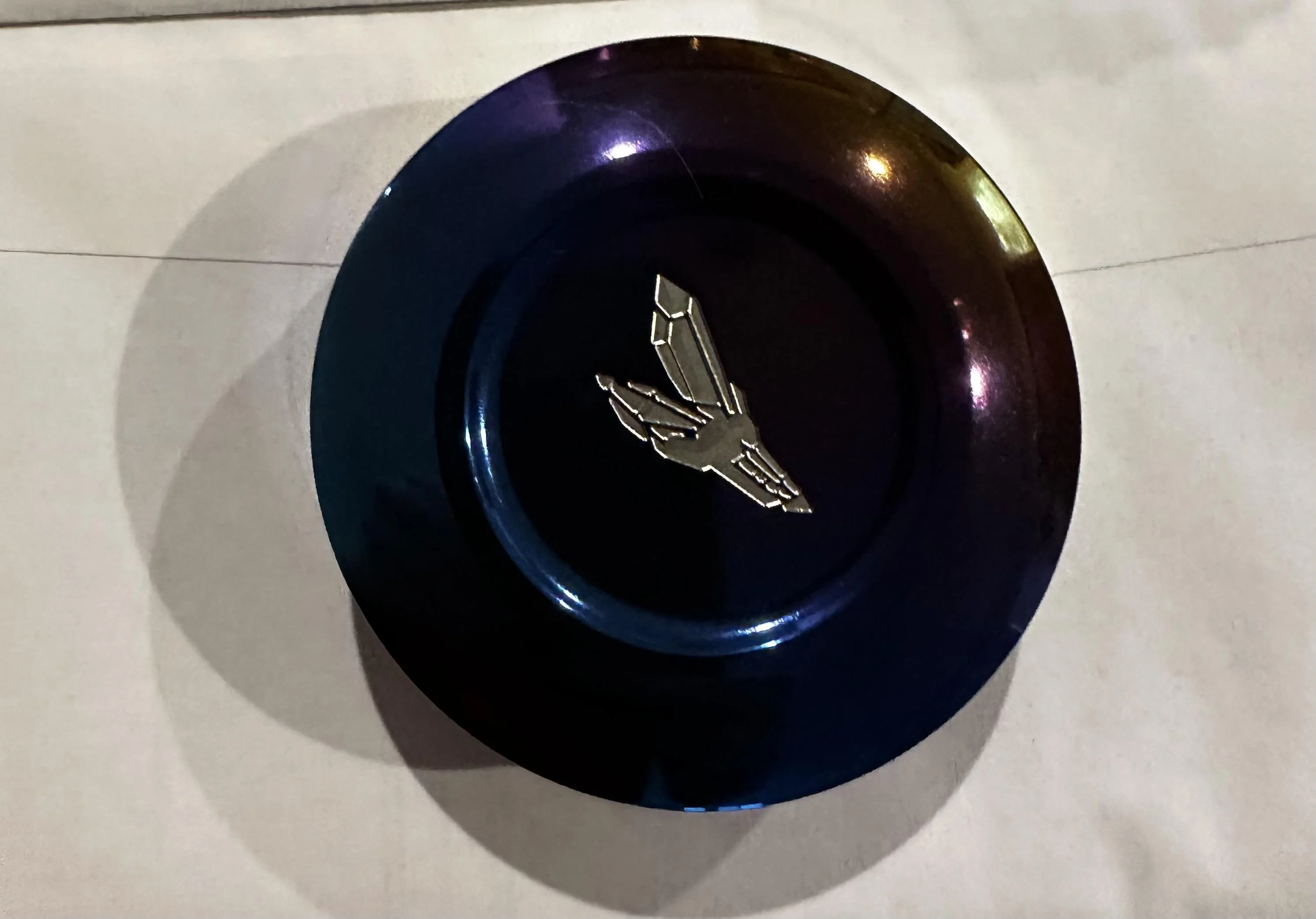

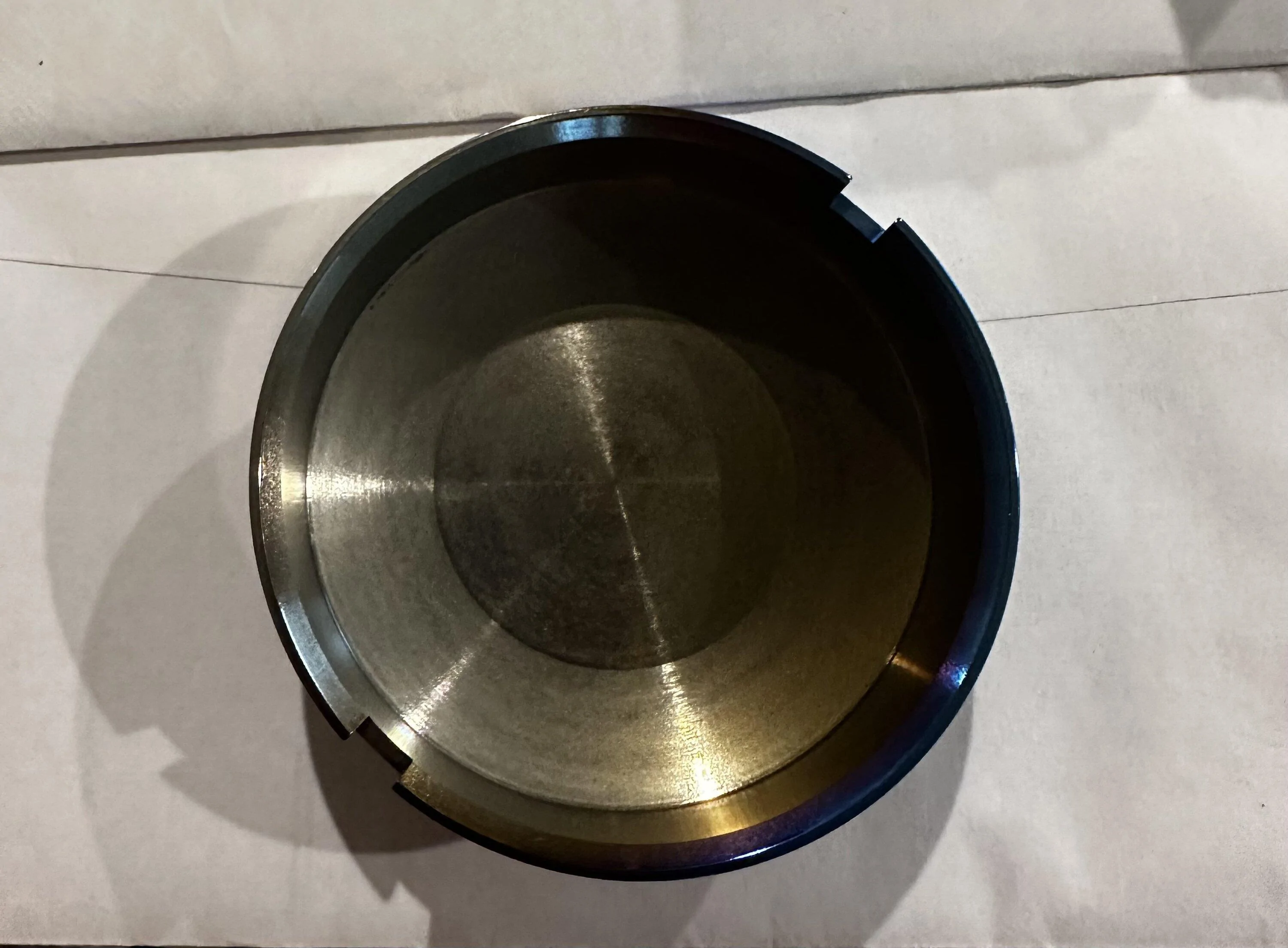

I had some custom one off made out of titanium for the s2k which act as hubcentric ring and caps at the same time lol.

Thanks dude! Took a while to figure it out but had them made to cover the hub with my aftermarket wheels on the s2k.
