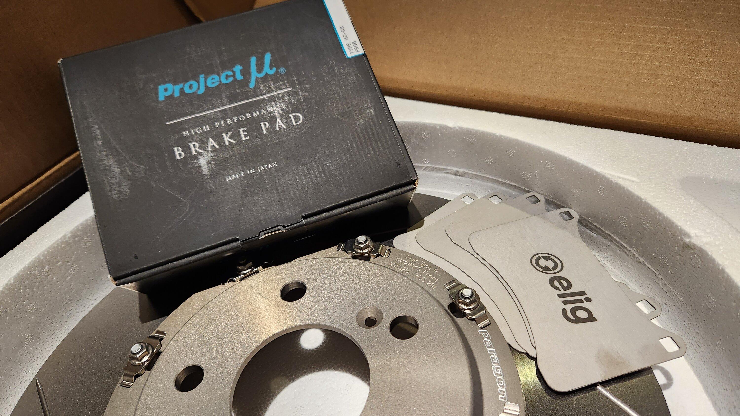

Swapping rings back and forth will get old very, very quickly...
You're better off having a spare set of 2pc rotors (complete with hat) mated to a track capable set of pads for track purposes.

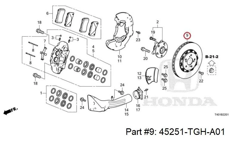

It appears to only be available as a complete unit as others here have mentioned.
Part No: 45251-TGH-A01 (Same part for L&R)

Thanks. When I went to online parts shops and entered my model (FL5) it had no diagrams for parts other than accessories.
