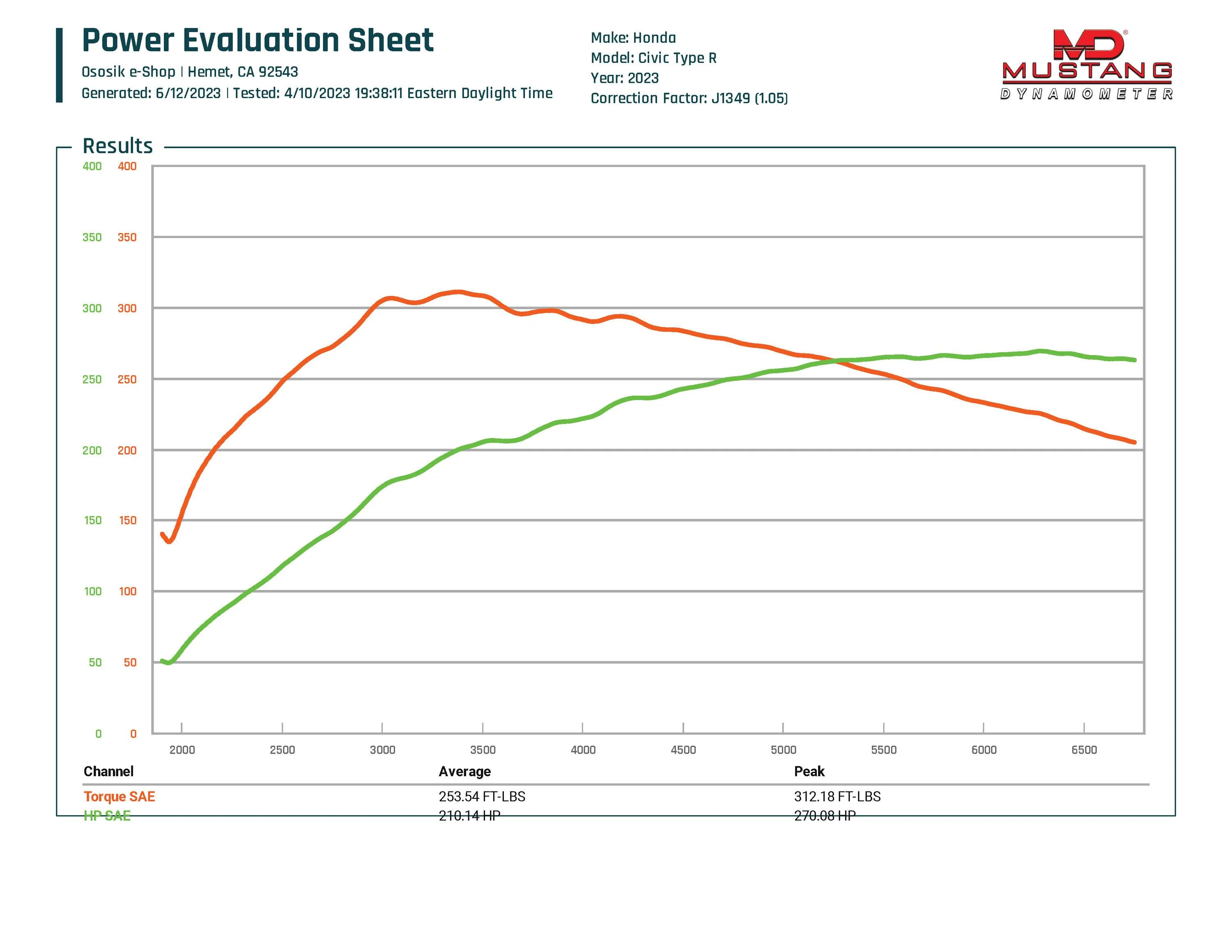

To eliminate variables and get accurate comparisons, we put the Type R back on 91 octane and the PowerMetric Stage 0.91 tune using Hondata FlashPro.
Stock the Type R makes 270 WHP and 312 TRQ
11th Gen Honda Civic Civic Type R "Free Flowing" DownPipe ososik-fl5-stock-baseline

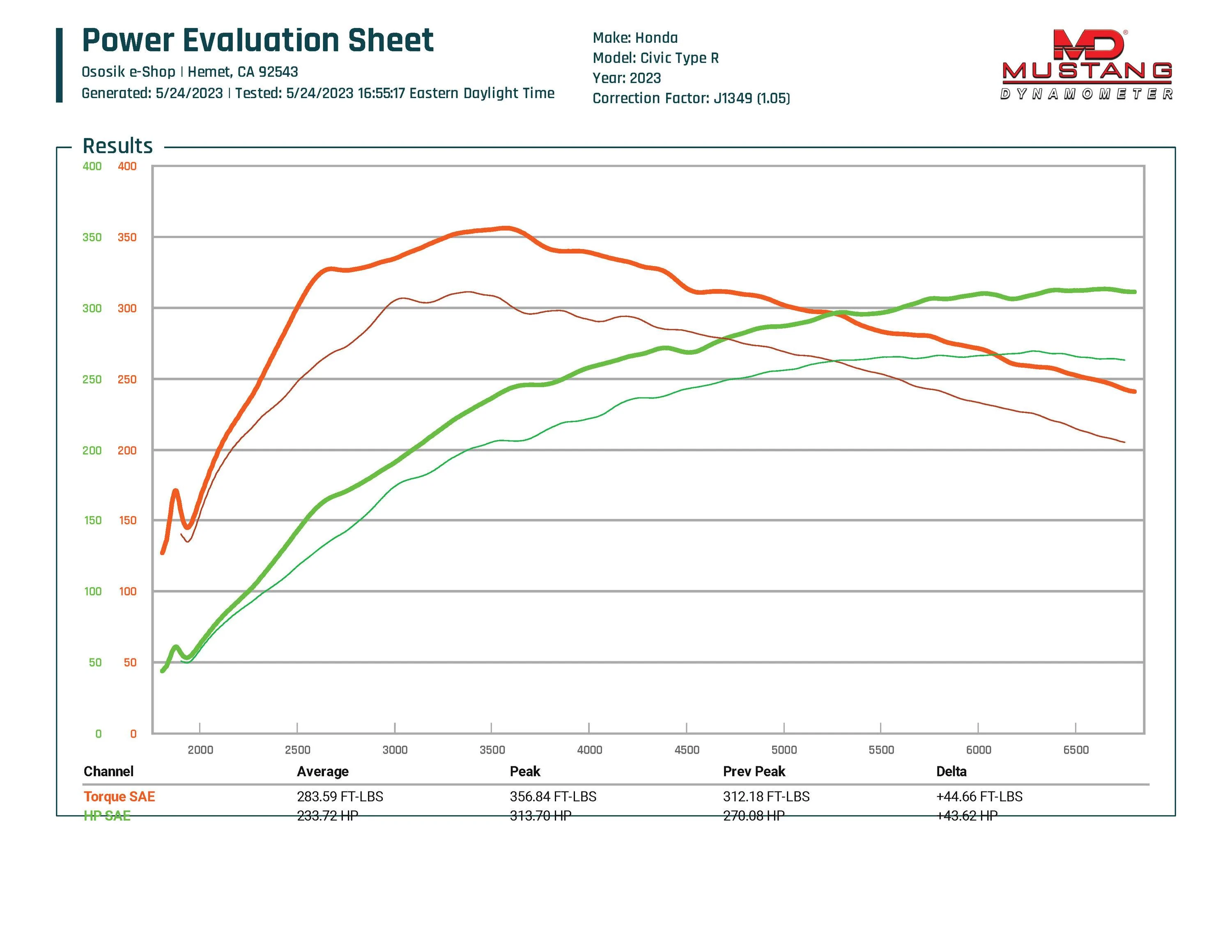

Downpipe with PowerMetric Stage 0.91 Tune compared to Stock:
11th Gen Honda Civic Civic Type R "Free Flowing" DownPipe ososik-fl5-stage091-dp-baseline-vs-stock

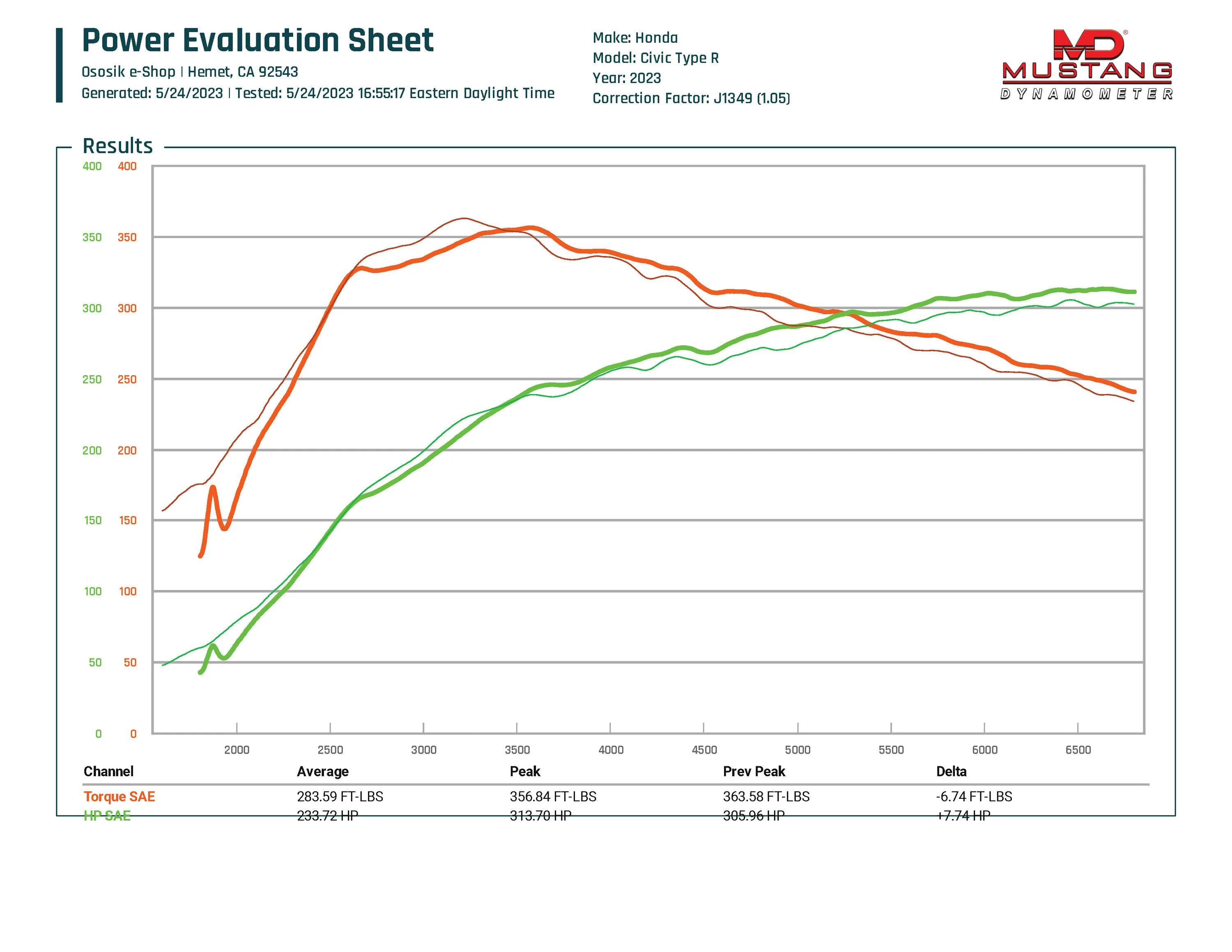

Last Dyno Plot compares the "free flowing" Downpipe with Powermetric Stage 0.91 Tune to the Stock Downpipe with Powermetric 91 Tune:
11th Gen Honda Civic Civic Type R "Free Flowing" DownPipe ososik-fl5-stage091-dp-baseline-vs-stage091
As you can see the plot the peak TRQ shows slightly less with the free flowing downpipe at around 2,500 RPM. If you look throughout the entire rev range, the new downpipe out performs the stock one. Again, this is with ZERO tuning changes. Tuning would definitely optimize this upgrade but if you're wondering what an install like this would do without tuning, here you go.
