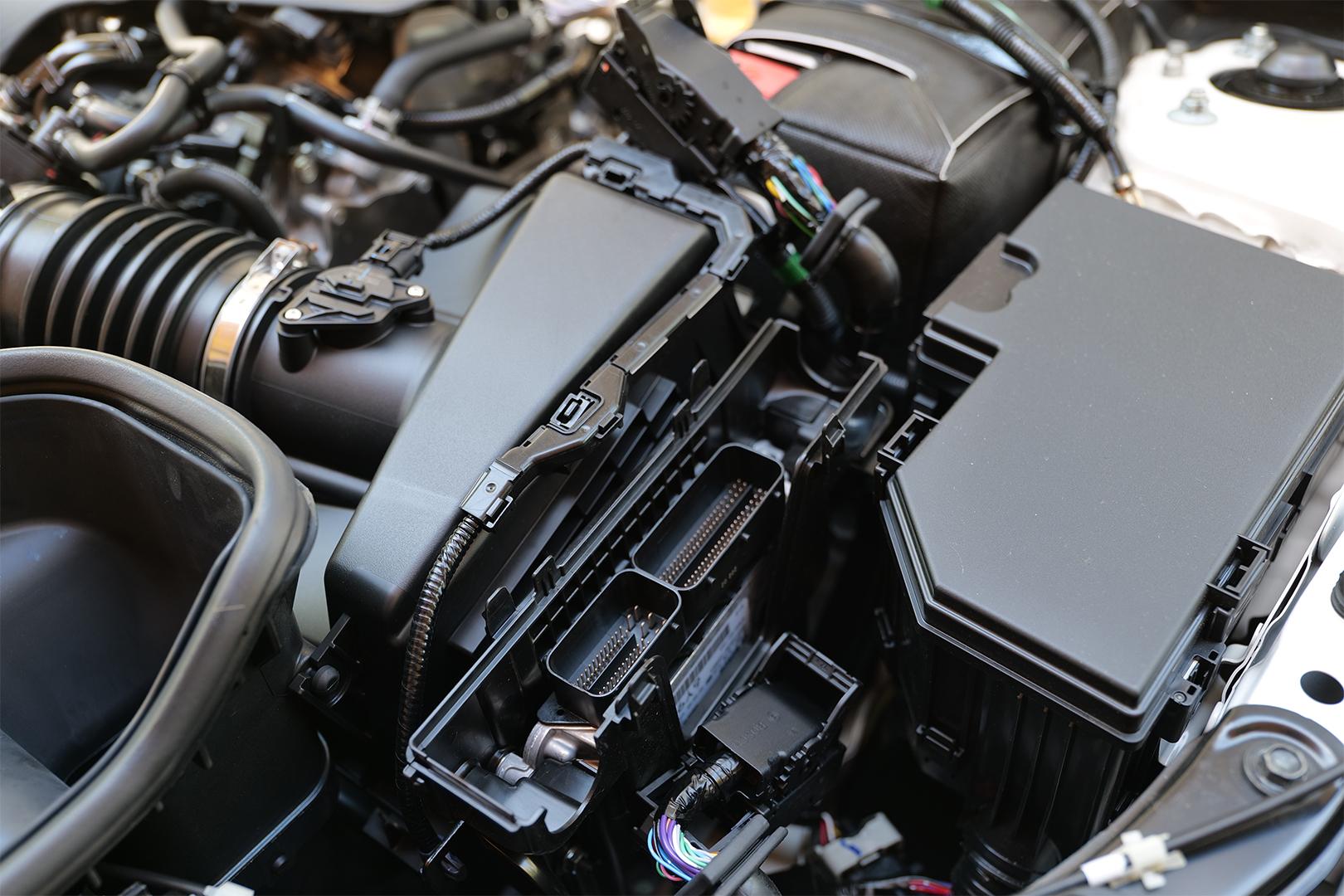

This part is very straight forward. You’ll have to take out your ECU.
11th Gen Honda Civic Civic Type R Jailbreak and Hondata FlashPro (Process) - Ososik civic-type-r-location
11th Gen Honda Civic Civic Type R Jailbreak and Hondata FlashPro (Process) - Ososik civic-type-r-ecu-cover

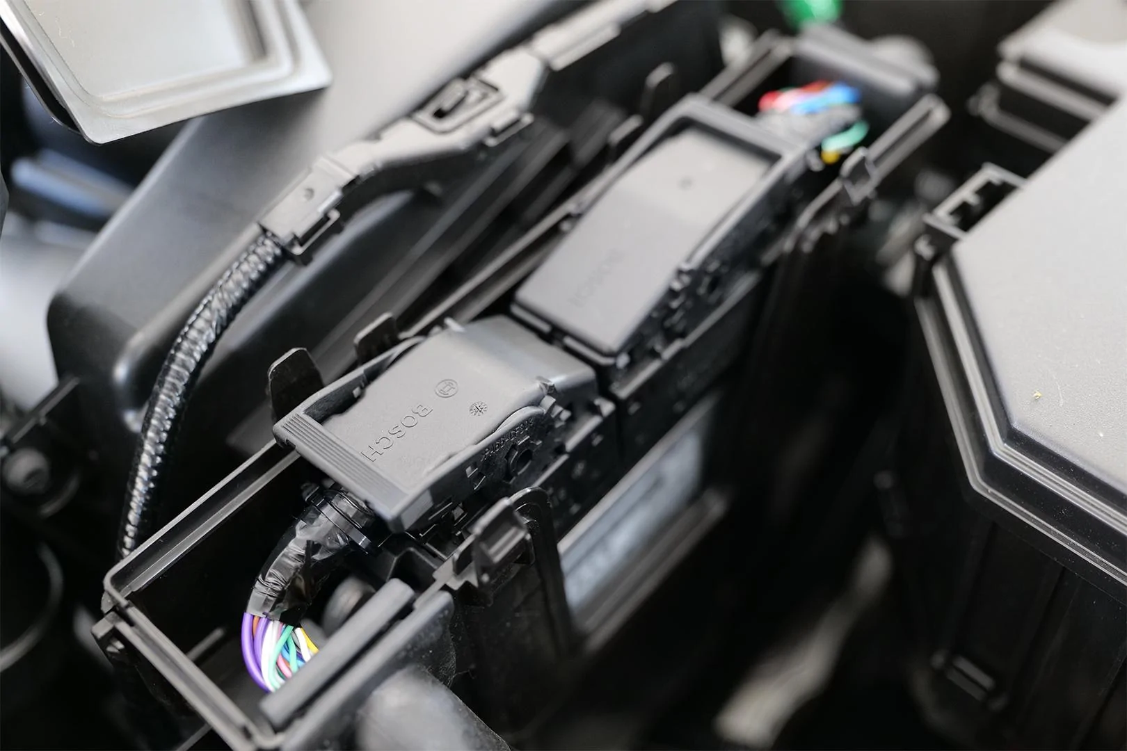

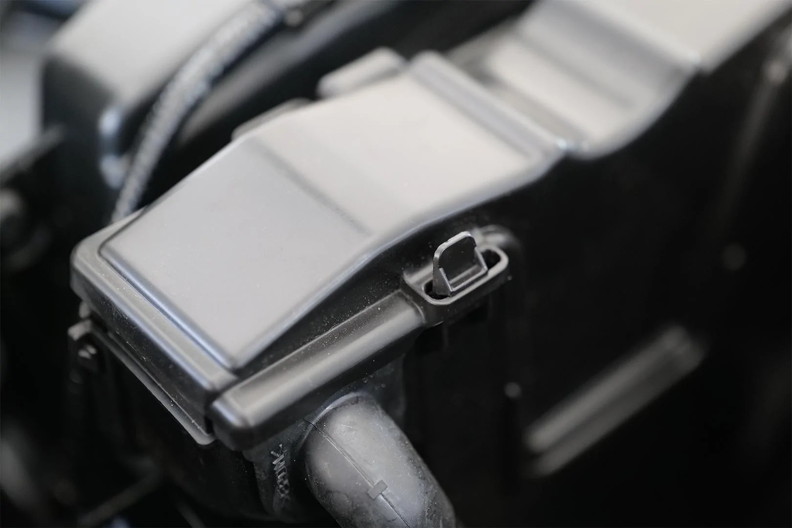

Disconnect the 2 harness plugs and bolts holding the ECU bracket. Take your time with disconnecting and plugging in the harness because you do NOT want to bend a pin.
11th Gen Honda Civic Civic Type R Jailbreak and Hondata FlashPro (Process) - Ososik civic-type-r-ecu-plu
11th Gen Honda Civic Civic Type R Jailbreak and Hondata FlashPro (Process) - Ososik civic-type-r-ecu-unplugged

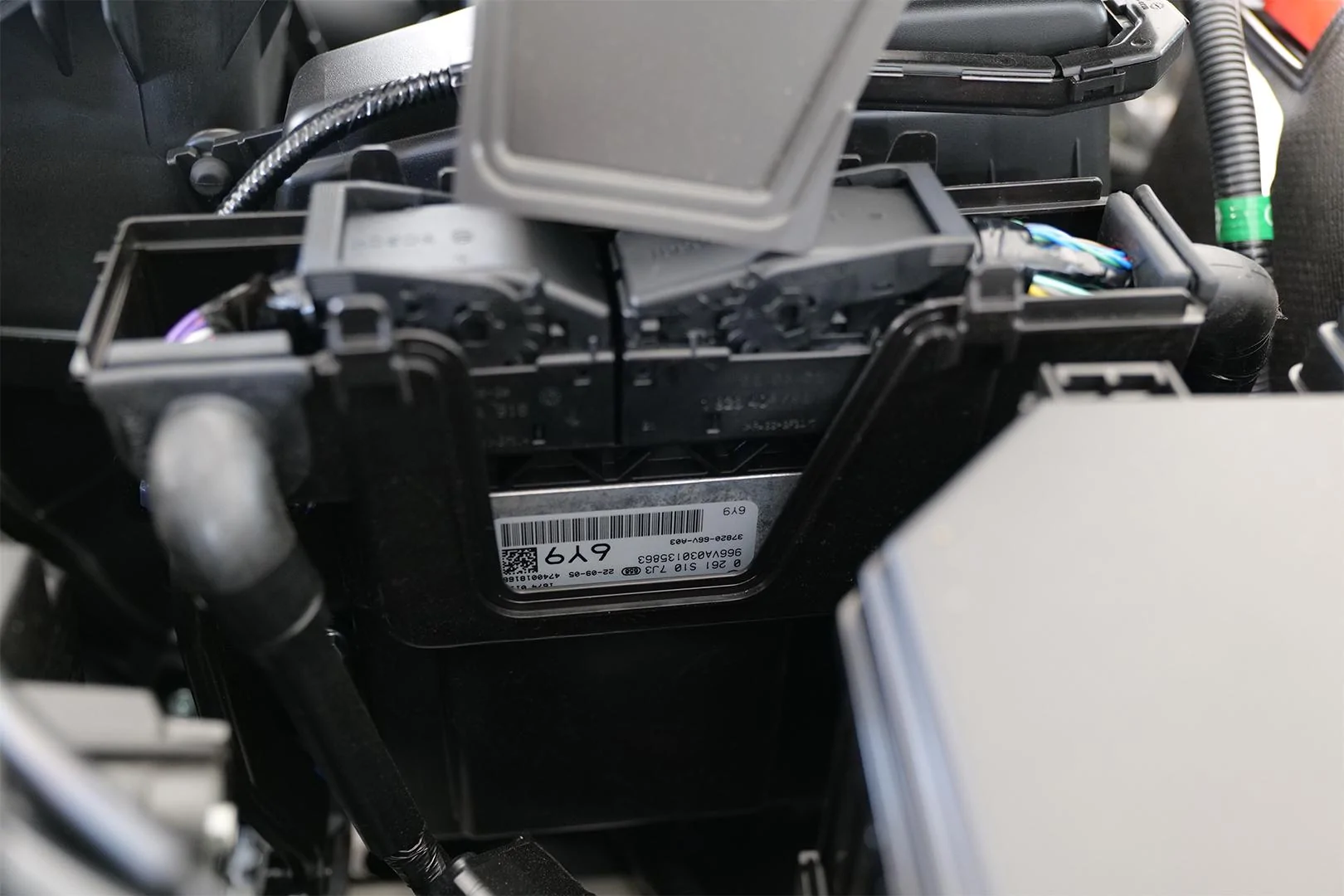

The ECU Serial Number can be found here.

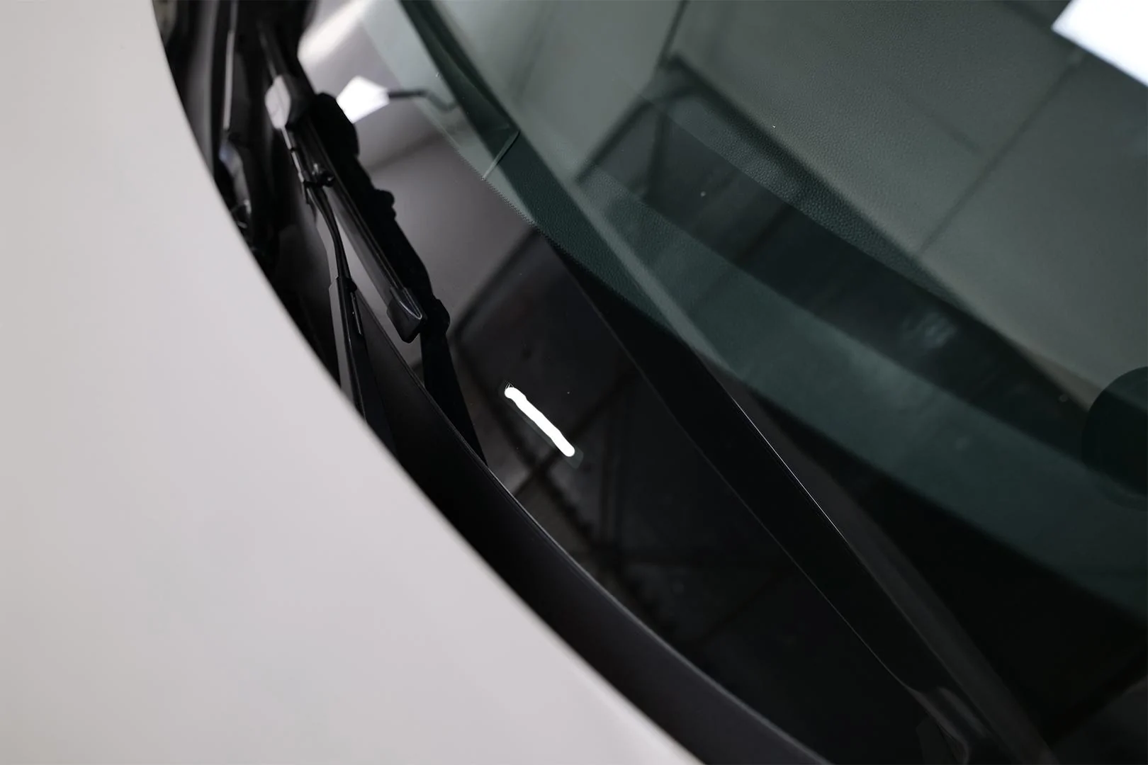

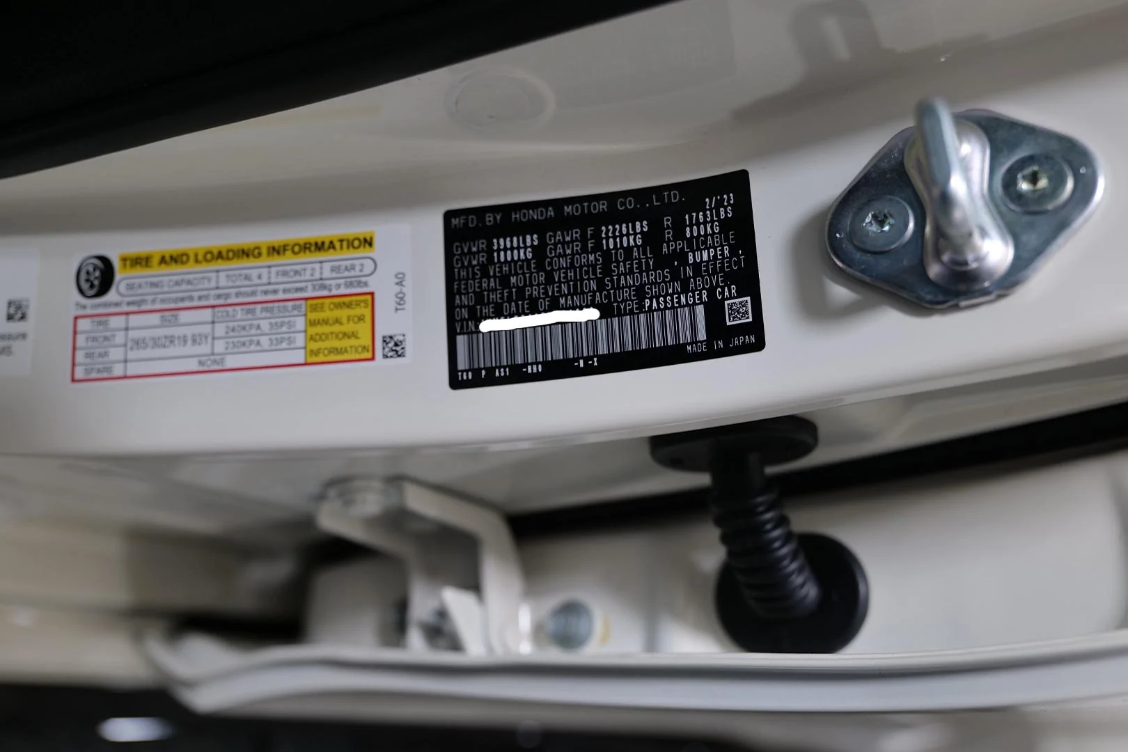

The Vin locations are on the windshield or door panel.
11th Gen Honda Civic Civic Type R Jailbreak and Hondata FlashPro (Process) - Ososik civic-type-r-vin-002

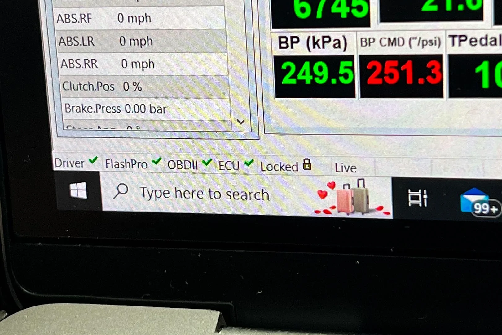

  • Confirm connection on lower left side of FlashPro Manager Screen

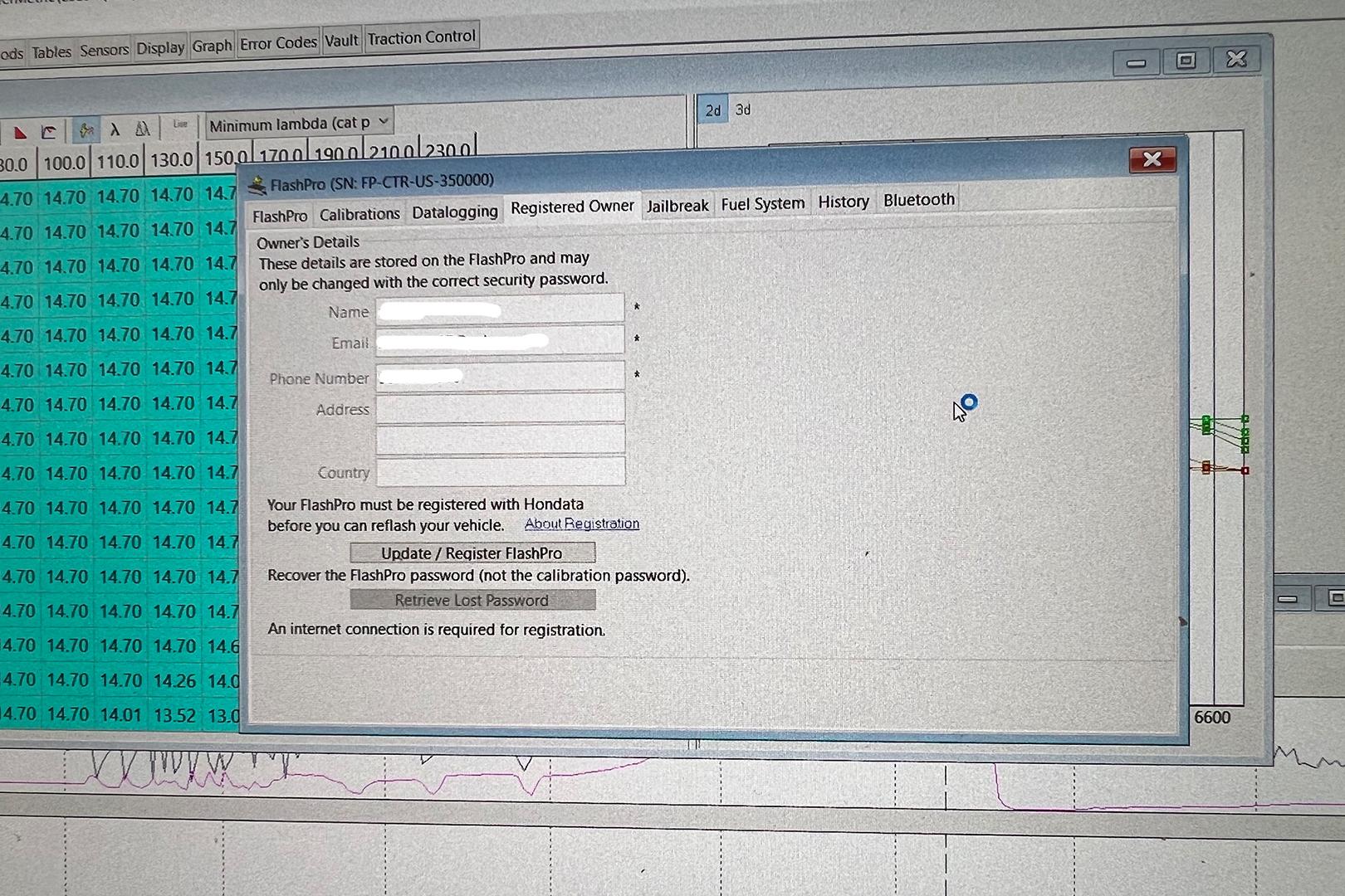

  • Register FlashPro
11th Gen Honda Civic Civic Type R Jailbreak and Hondata FlashPro (Process) - Ososik hondata-flashpro-type-r-002

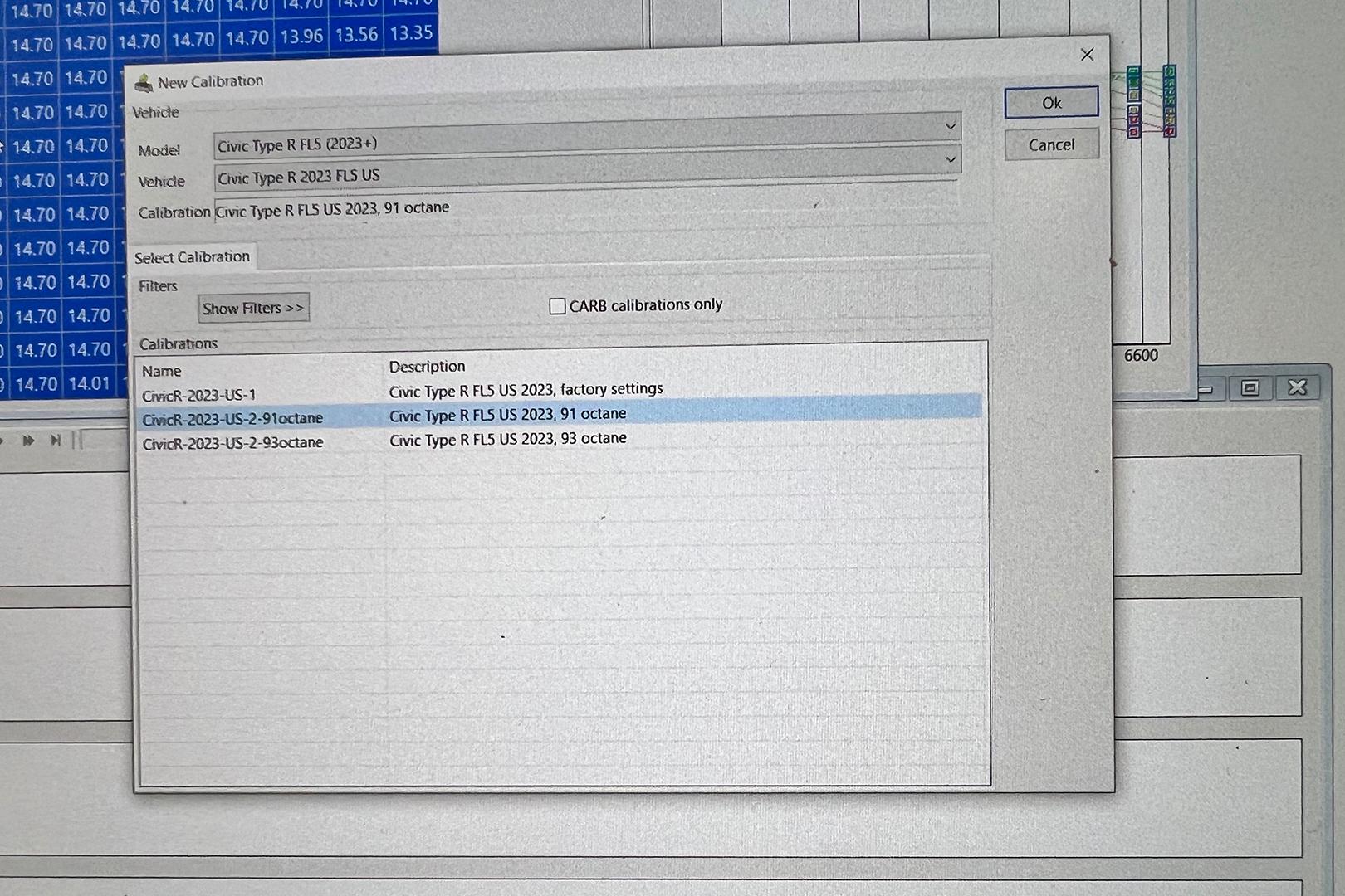

  • Create New Calibration
  • Select Desired Calibration, in California we have to pick 91 octane. 93 octane users automatically get to enjoy more power (lucky).

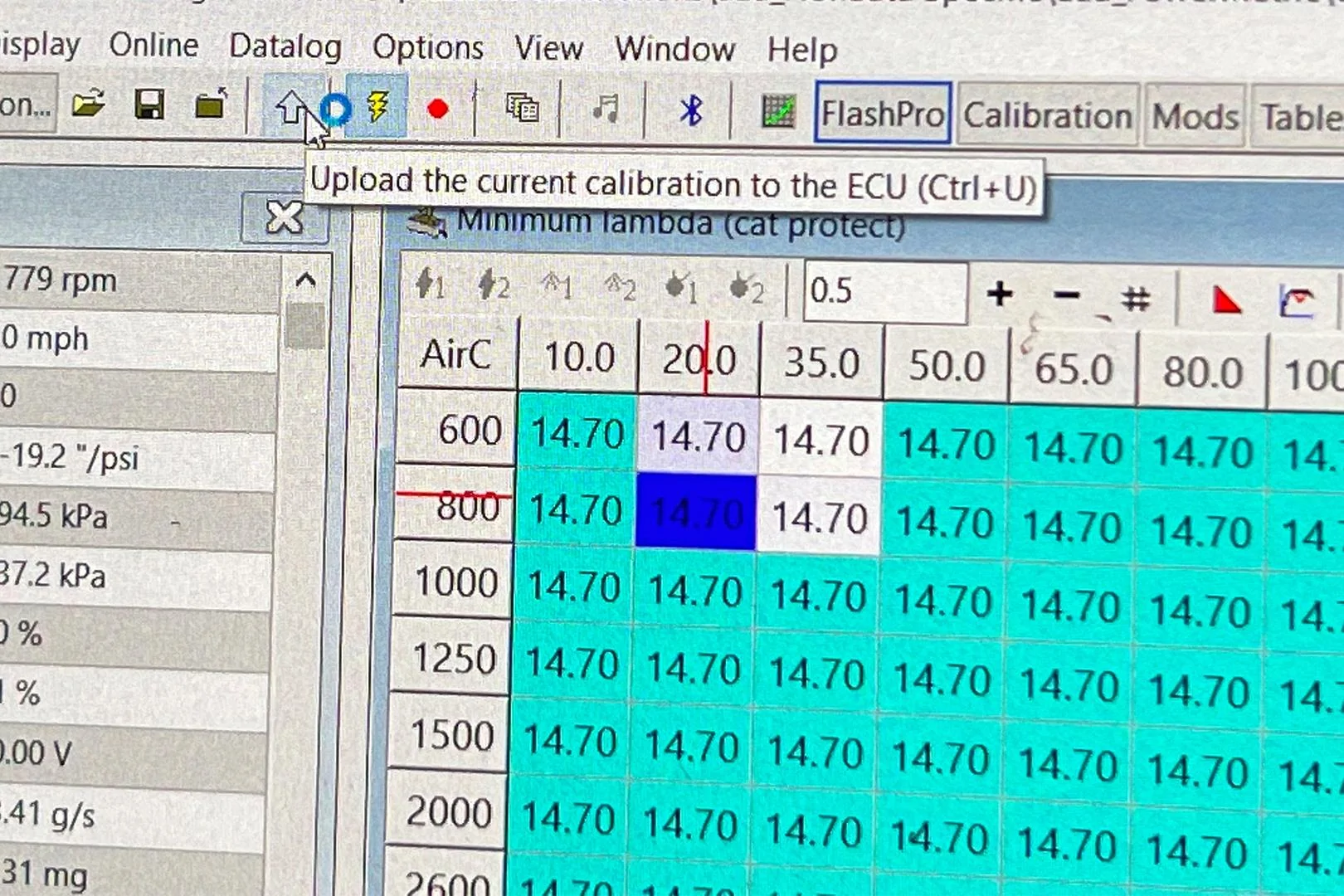

  • Turn ignition On (Auxiliary Mode)
  • Click Upload (Up Arrow)
11th Gen Honda Civic Civic Type R Jailbreak and Hondata FlashPro (Process) - Ososik hondata-flashpro-type-r-003
Hang out for about 6 mins (Upload time).
