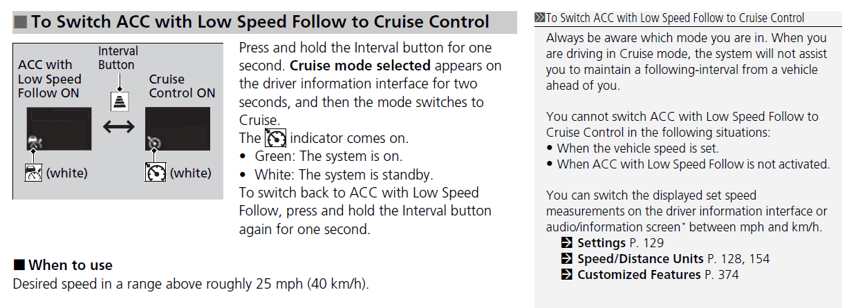

What? They took away the standard cruise control option? Are you sure?
I held the button for like 2 minutes hoping it would go away and it didn't. I'm going have to find my owners manual and see if it's a different way on these.
CeeBee
Jun 25, 2021
52
34
'19 Accord Sport 2.0T 6MT - '21 Civic Hatch EX
Looks like you need to hold the interval button.

Thank goodness. I was about to say you guys got screwed even more if they took away that function.

Got it to finally go on normal CC on my drive home last night and voila all the ghost braking gone and random shut offs gone. Screw acc!
