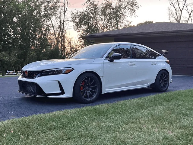

Look at the first post :p but I’ll answer anyways. It’s stock suspension and height. 265/40/18 with 18x9.5 wheels.

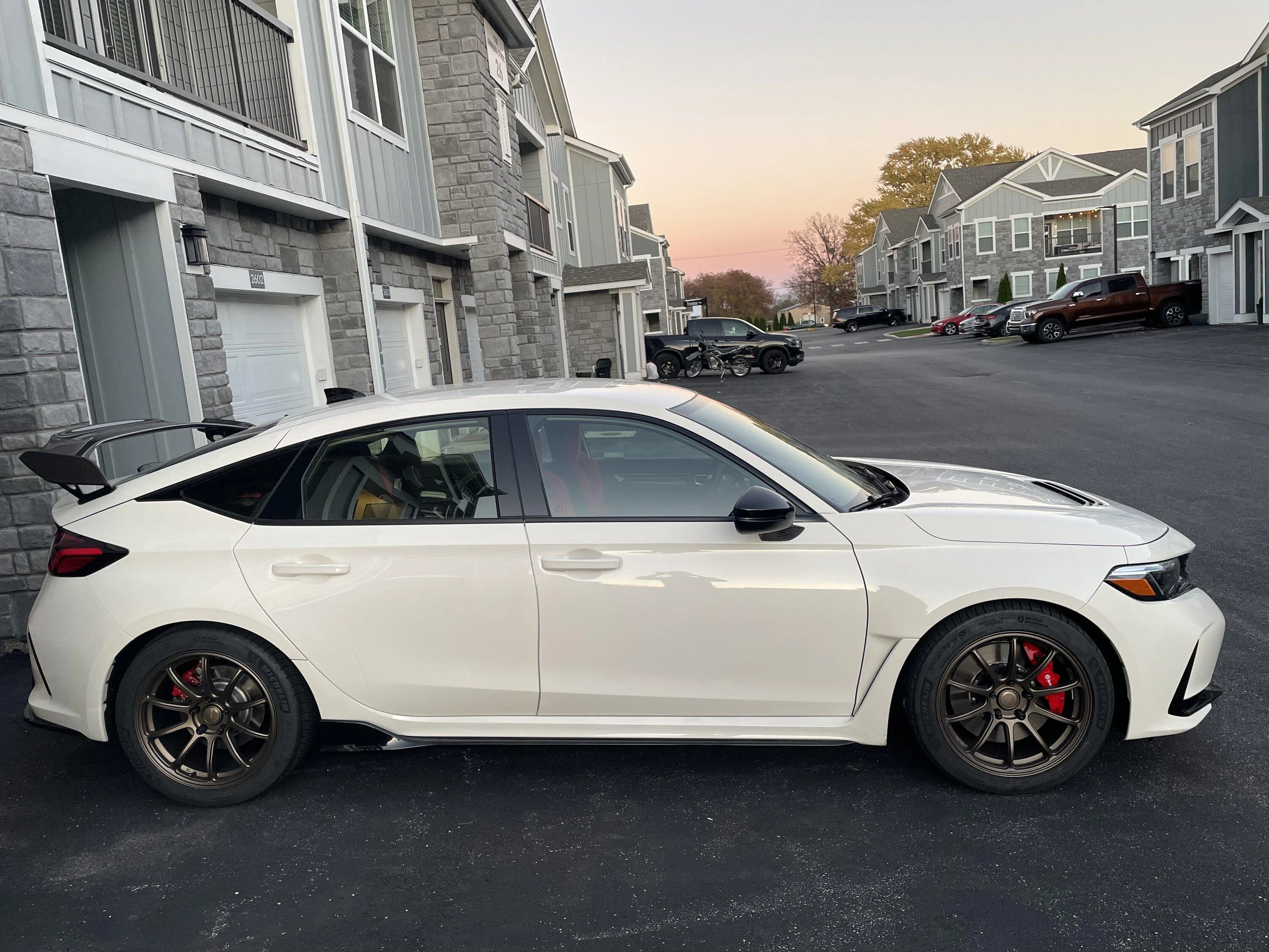

Any rubbing issue? +38 during hard corner, dip , speed bump ?
No rubbing at all. I do have 265's and the strut pins up front pulled for max camber without ball joints. Its really close though, a different set of 265s or 275's may rub in the front. The back has a good amount of space still.
