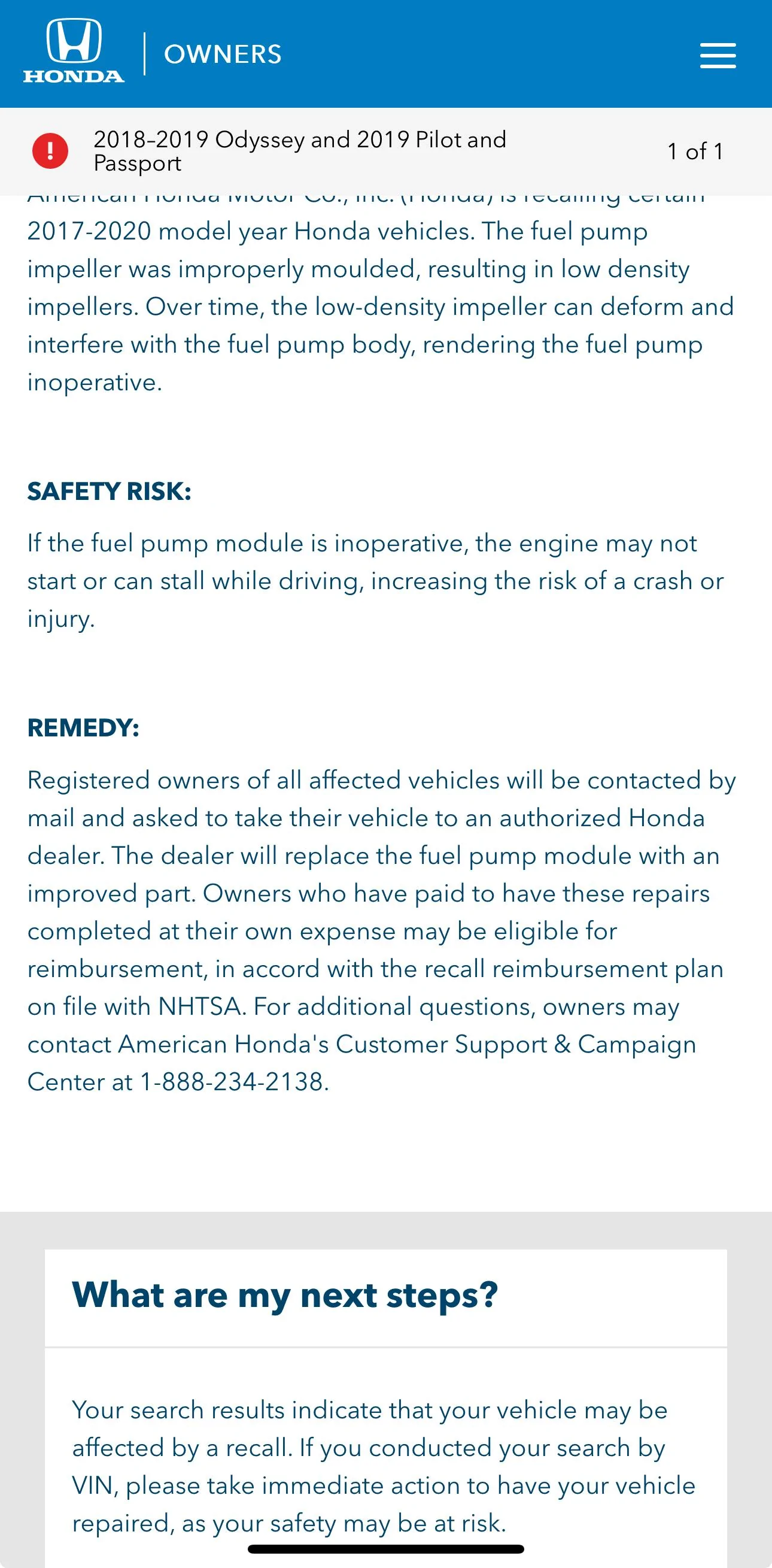

SUMMARY:
“American Honda Motor Co., Inc. (Honda) is recalling certain 2017-2020 model year Honda vehicles. The fuel pump impeller was improperly moulded, resulting in low density impellers. Over time, the low-density impeller can deform and interfere with the fuel pump body, rendering the fuel pump inoperative.
SAFETY RISK:
If the fuel pump module is inoperative, the engine may not start or can stall while driving, increasing the risk of a crash or injury.”
11th Gen Honda Civic December 2023 RECALL on various 2017-2020 Models - Honda Fuel Pump defect • Part 573 Safety Recall  23V-858 IMG_3585
[https://owners.honda.com/service-maintenance/recalls?id=19XFC1F9XKE009652]
