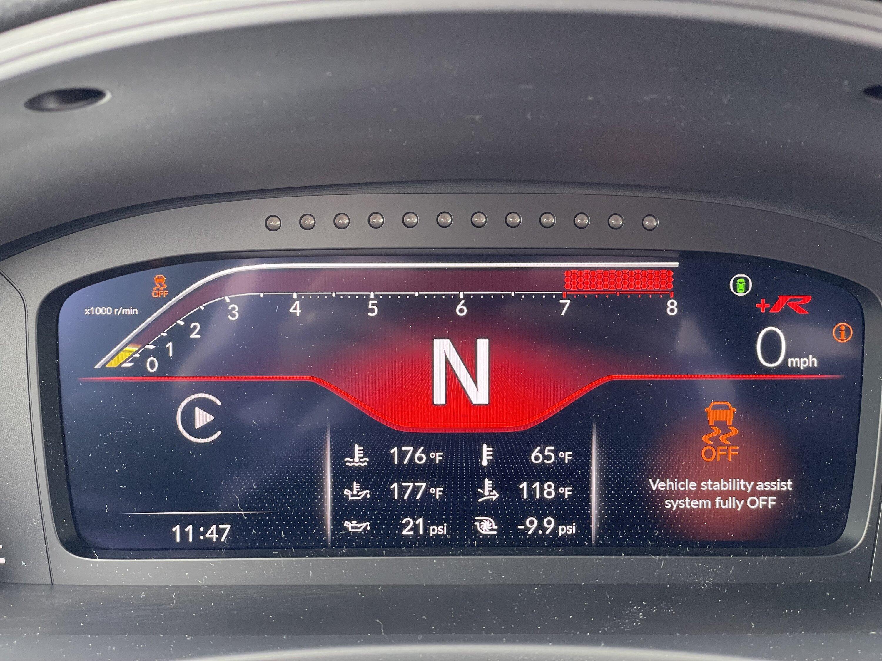

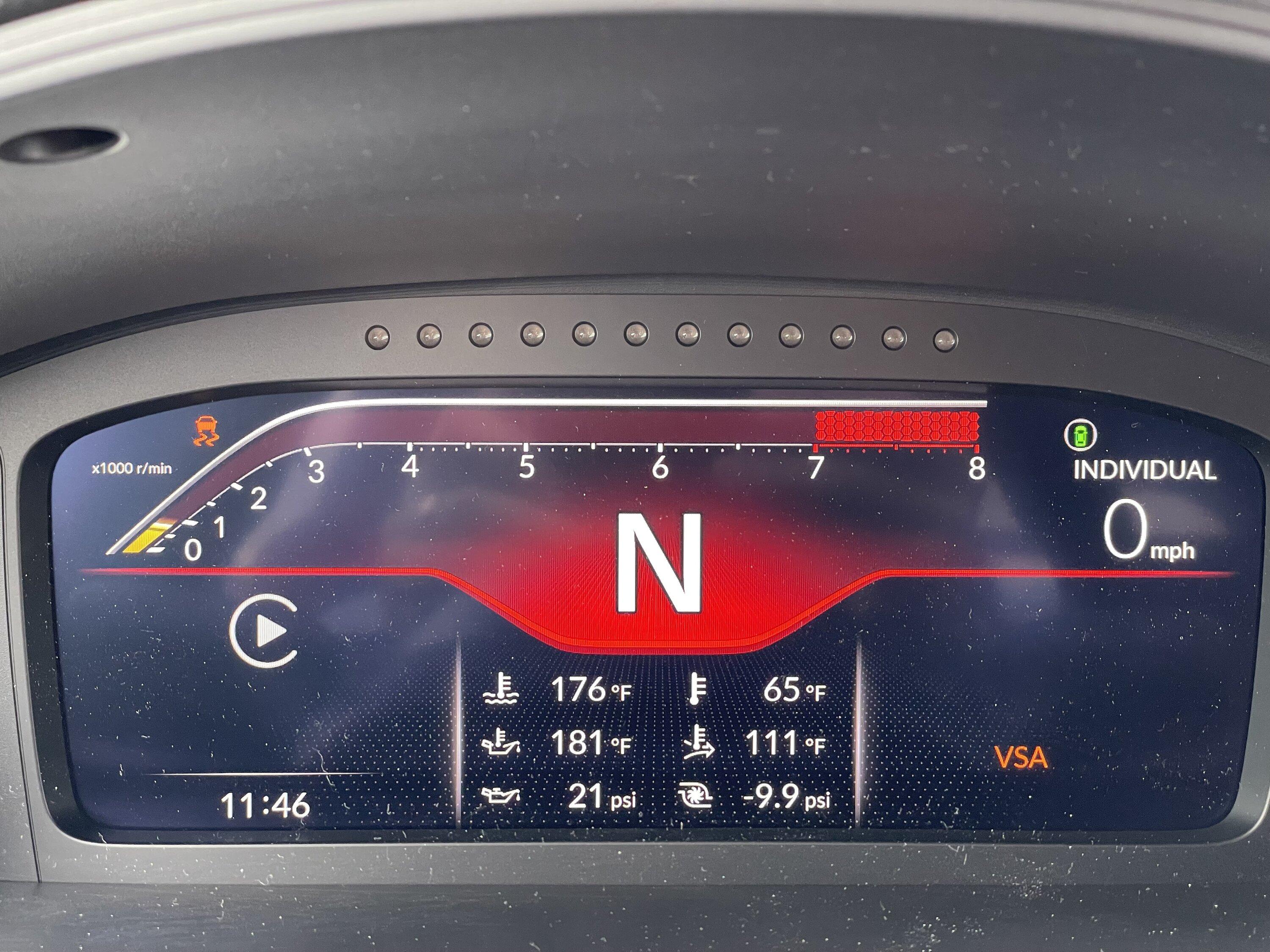

See the attached screenshots. First one is me disabling VSA in Individual mode via the “Pedal Dance”, and the second is me disabling VSA in +R mode with the button. The gauge cluster shows slightly different icons/things, so I’m curious if there is a difference between the two methods.

What felt different? I guess the "Pedal Dance" way puts it in some service mode, hence the different icons.

Interesting. There could be a difference, but it would take some methodical testing to find out. I do think the "Pedal Dance" puts the car into some sort of service mode, where it goes a bit further in disabling the "nannies". I have to experiment more myself.

Tested this out at the track a couple weeks ago - Pedal dance will completely disable traction and stability control. +R mode with traction and stability control “off” will still engage the rear brakes to help rotate the car around corners, resulting in accelerated rear pad wear. Basically, same as the FK8.
The car won’t rotate as much with the pedal dance, but your brakes will last longer with less heat in the system and much less wear to the rears.
My gut was telling me it was this way (see my last post), but I didn’t spend enough time to know. Thanks for confirming. Sounds like “Pedal Dance” is the way to go on track. Surprised more don’t use it.

The pedal dance indeed puts VSA in maintenance mode. It disables the agile handling assist but does not disable the ABS. The agile handling assist is not really heavy on pad wear, at least not with higher temp pads - a problem 17-19 fk8 had with OEM pads.
