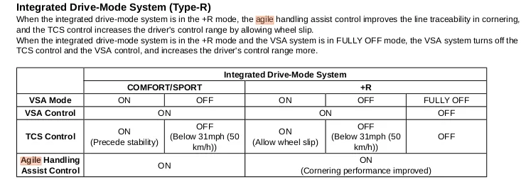

Here's a pic from the fk8 service manual that might be of interest:
11th Gen Honda Civic Disabling VSA via “Pedal Dance” vs. +R with button differences? Screenshot from 2023-03-27 20-22-07
VSA Control in this table refers to the understeer and oversteer assist.

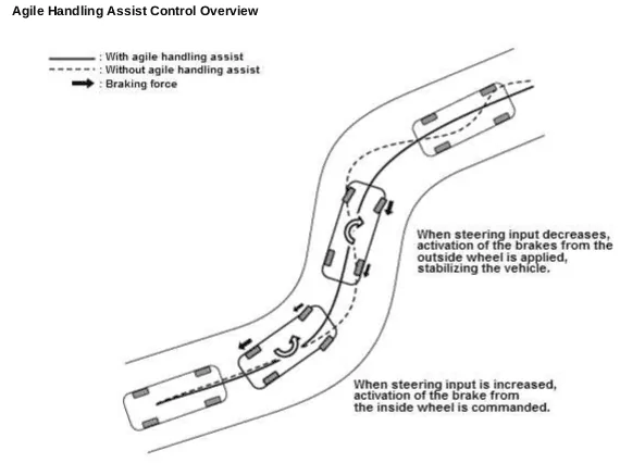

The fk8 service manual says it's a feedforward control on the steering wheel angular velocity. Since it's a feedforward, it will command the brakes and help rotate the car no matter what mods you made to the vehicle dynamics. I suspect the steering feel of the car wouldn't feel as direct as it is without the assist.
11th Gen Honda Civic Disabling VSA via “Pedal Dance” vs. +R with button differences? Screenshot from 2023-06-20 01-57-00
The other 2 assists (oversteer and understeer assists) also apply the brakes (outside and inside, respectively). But these assists are feedback control laws, they constantly monitor the vehicle yaw rate, lateral acceleration and steering wheel angle to decide what to do. These would be affected by a RSB or any other methods to increase rotation.
