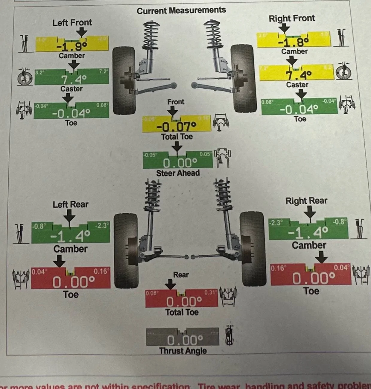

I had touched upon this topic briefly in my build thread. Overall, I feel more comfortable just doing the pedal dance. The car is more predictable and I can be more consistent. In addition It won’t melt my rear brake pads.
On the topic of alignment, I have driven the car with stock alignment which had the front set to 0 toe and the rear with some slight toe in. I got a custom alignment with 4 degree toe out in the front and 0 toe in the rear. The custom alignment made a huge difference for me on the initial turn-in response, the front end has a lot more bite, and the rear is more willing to come around which I like.
11th Gen Honda Civic Type R Track Times Pedal Dance vs. Type R+ Long Press and Experience 75270248854__B36F33C4-44BB-49D4-94CA-BC8580BE35A5
Going forward I would like to add a lower ball joint to see how adding a significant amount more front camber would feel like. I’m guessing it would fix the mild understeer I get on mid-corner.

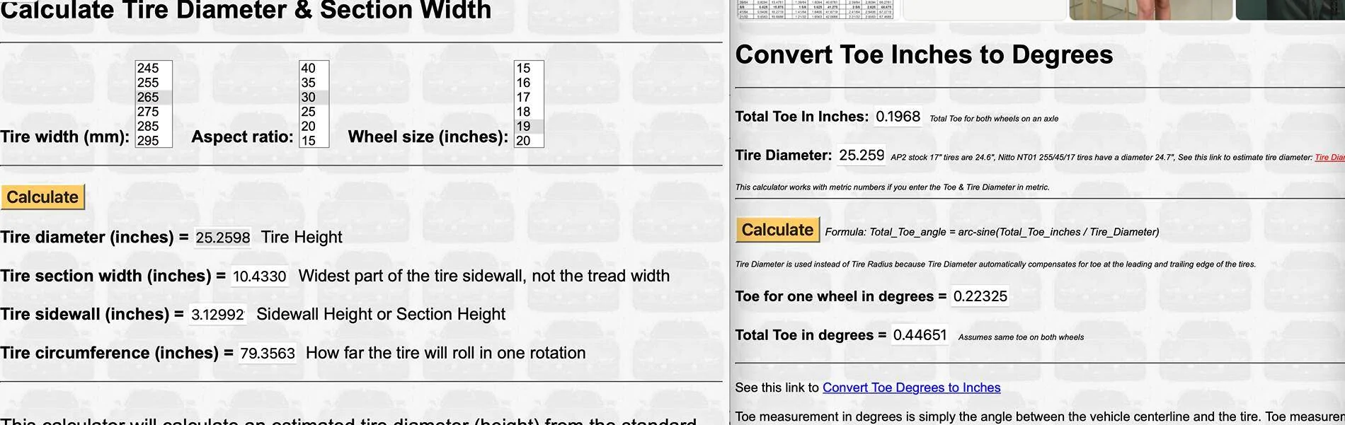

Does anyone know how much 5mm total toe out equates to degrees toe out on the stock FL5?
Is this correct 5mm total toe out == Total Toe in degrees .44651?

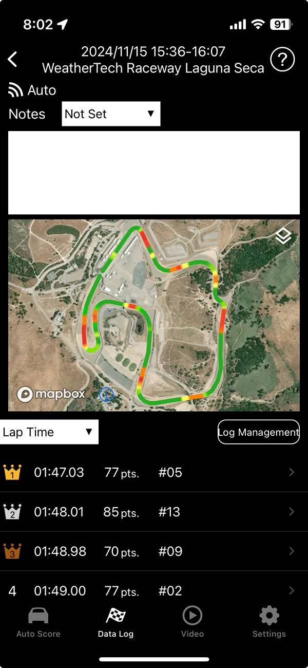

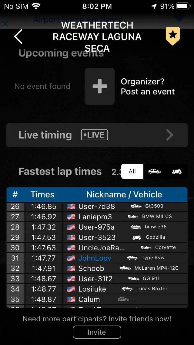

Thanks. Let me look into that external GPS system. There does seem to be under a second discrepency between the iOS and Log R .
One says I ran a 1.47.03 and the other 1.47.77
11th Gen Honda Civic Type R Track Times Pedal Dance vs. Type R+ Long Press and Experience IMG_8577
11th Gen Honda Civic Type R Track Times Pedal Dance vs. Type R+ Long Press and Experience Screenshot 2024-11-18 at 8.02.27 PM
Does anyone know why the timer stops working after 6+ laps
Had a friend that has a modified type, stock engine, and he runs 1.41s - gave me some pointers -
I was on track to run 1.45's ran into traffic, then spun out.
Anyone know why Log R stops recording times? Is there a setting?

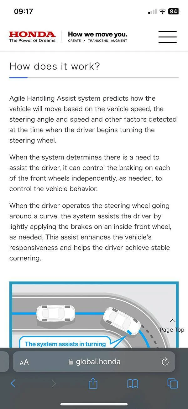

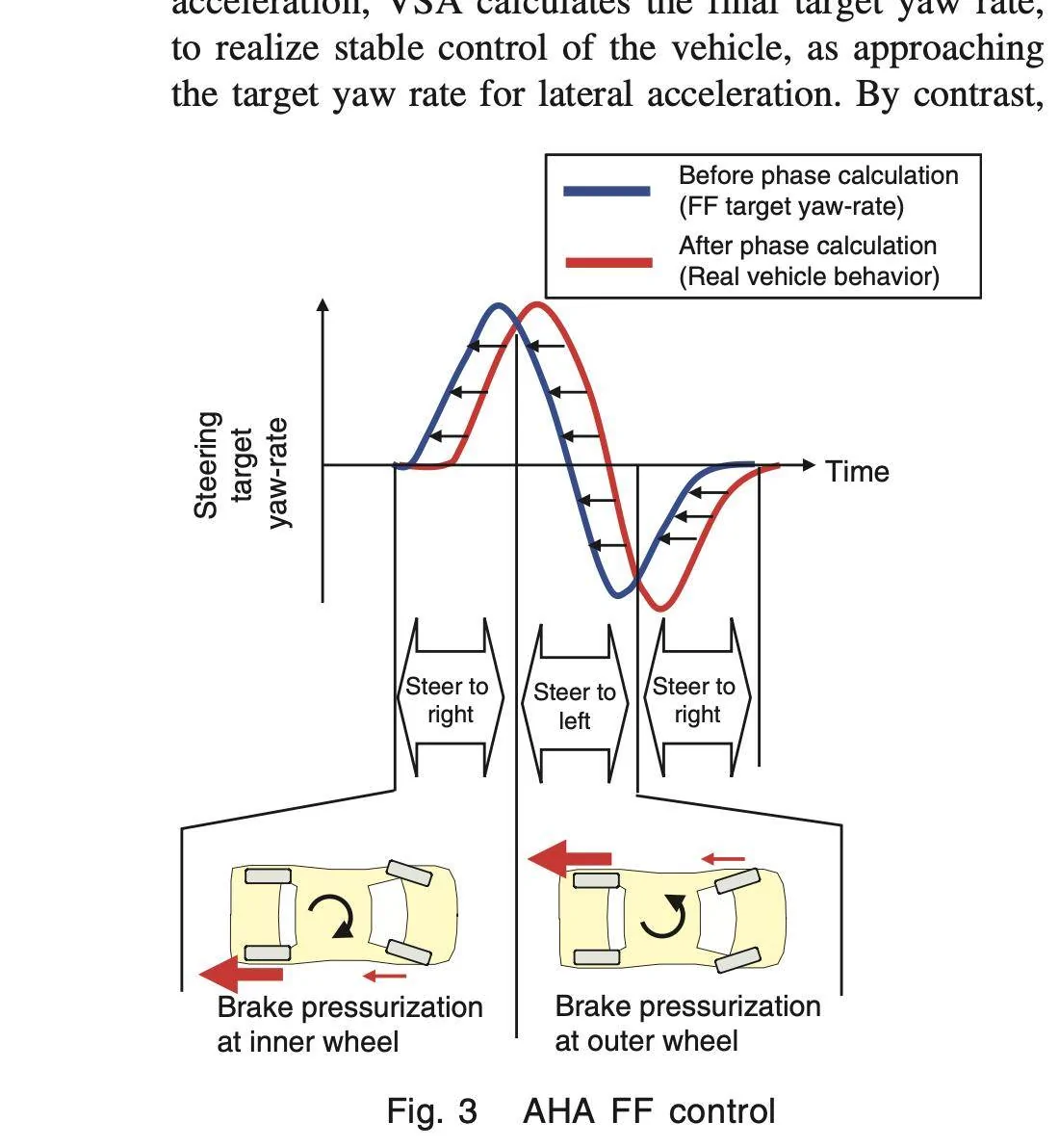

I agree on the rear pads myth! -- because when I went to the BMW Track Days, they explained that the brake vectoring works with enabling the front brakes, - acting like an oar in the water to help change direction - not the rears, and that's exactly what's in the Type R explanation diagram of how brake vectoring works.
The reason people have the impression Agile Handling Assist works with the rear brakes is that Honda Research published a paper about it and it detailed in diagrams the rear brakes being applied. It's likely they've tweaked the proportions of front to rear balance pressures over the years, but I would think they're going to use whatever combination gets the results they want. One reason they may have originally used the rear brakes is that the front tires' traction budget is more limited in an FF car. The chassis needs to use front traction for turning, and by using proportionally more rear brakes, you aren't taking away from that.

Personally - I can for 100% sure say - that going 5mm toe out in front, lets me now turn in the car way sharper, and I don't need to use torque brakes to turn the car in anymore. You can see in my spin out, how easily the car rotates, and I overcooked it.

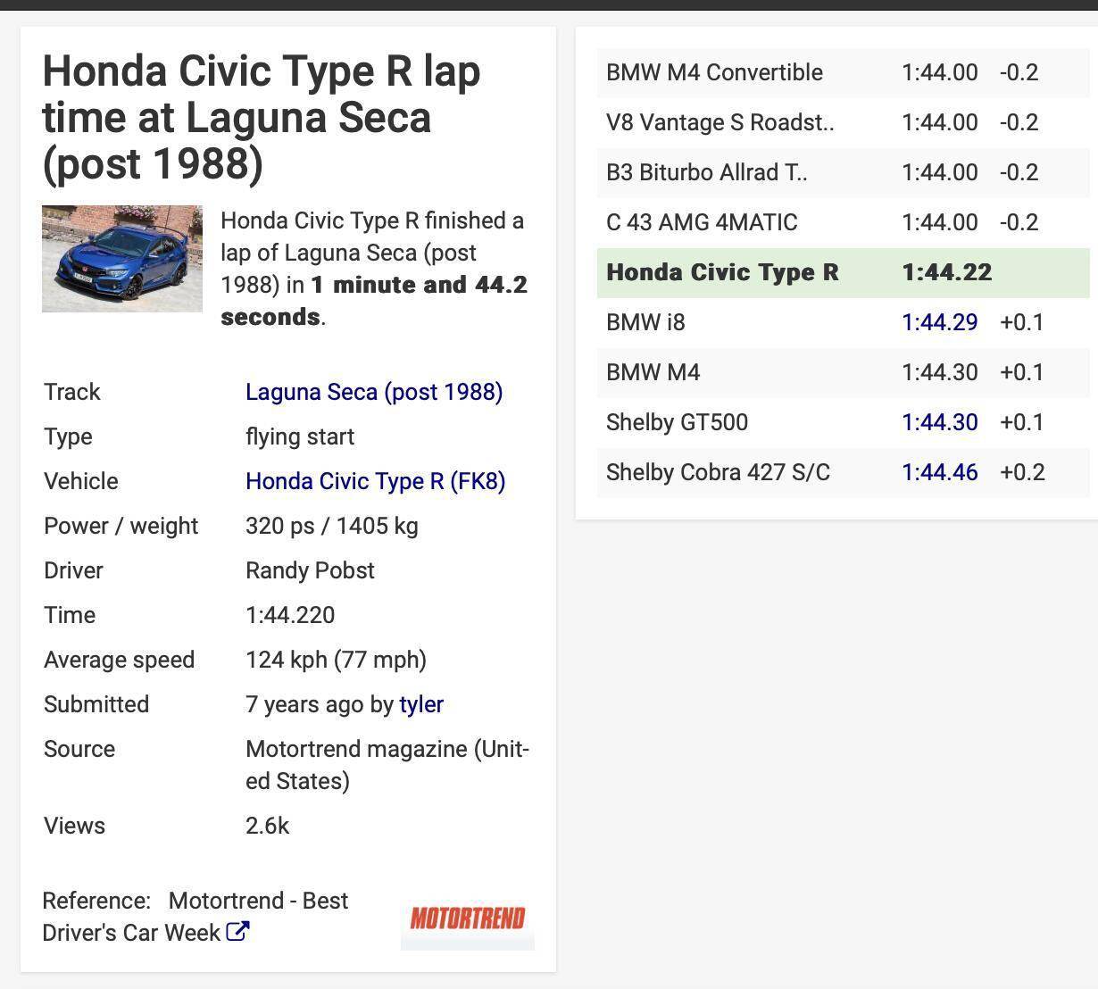

I think I can get the car to achieve a 1.45 - and get close to Randy 1.44.22 - I actually was on track 2 times on Dec 15th.
11th Gen Honda Civic Type R Track Times Pedal Dance vs. Type R+ Long Press and Experience 1732049799357-jn
My goal is to find what is the exact perfect setup to run the fastest Laguna Seca lap times on a stock FL5, stock rims, stock tires. I'm getting closer. I think she will break a 1.45 soon with these adjustments.

I would suggest you start monitoring the results of your alignment with a tire pyrometer and log your temps to pair with some basic race telemetry. Racebox Mini (GPS logger) is an easy one to use to see which turns you are seeing benefits and I think it is iPhone and Android compatible.
From my own experience (not an expert), front tire toe out gives your front tires a "head start" on on corner entry grip. You will feel it turn in earlier, but the fronts will also be loaded up earlier in the turn and could "run out" of grip later in the turn (ie, basic grip circle principles) or the turn after. Depending on the shape/length of the turn that can be perfect, better, okay-ish, or bad. Front toe out can be kinda a double edged sword at times, so it just really depends on track and tire.
