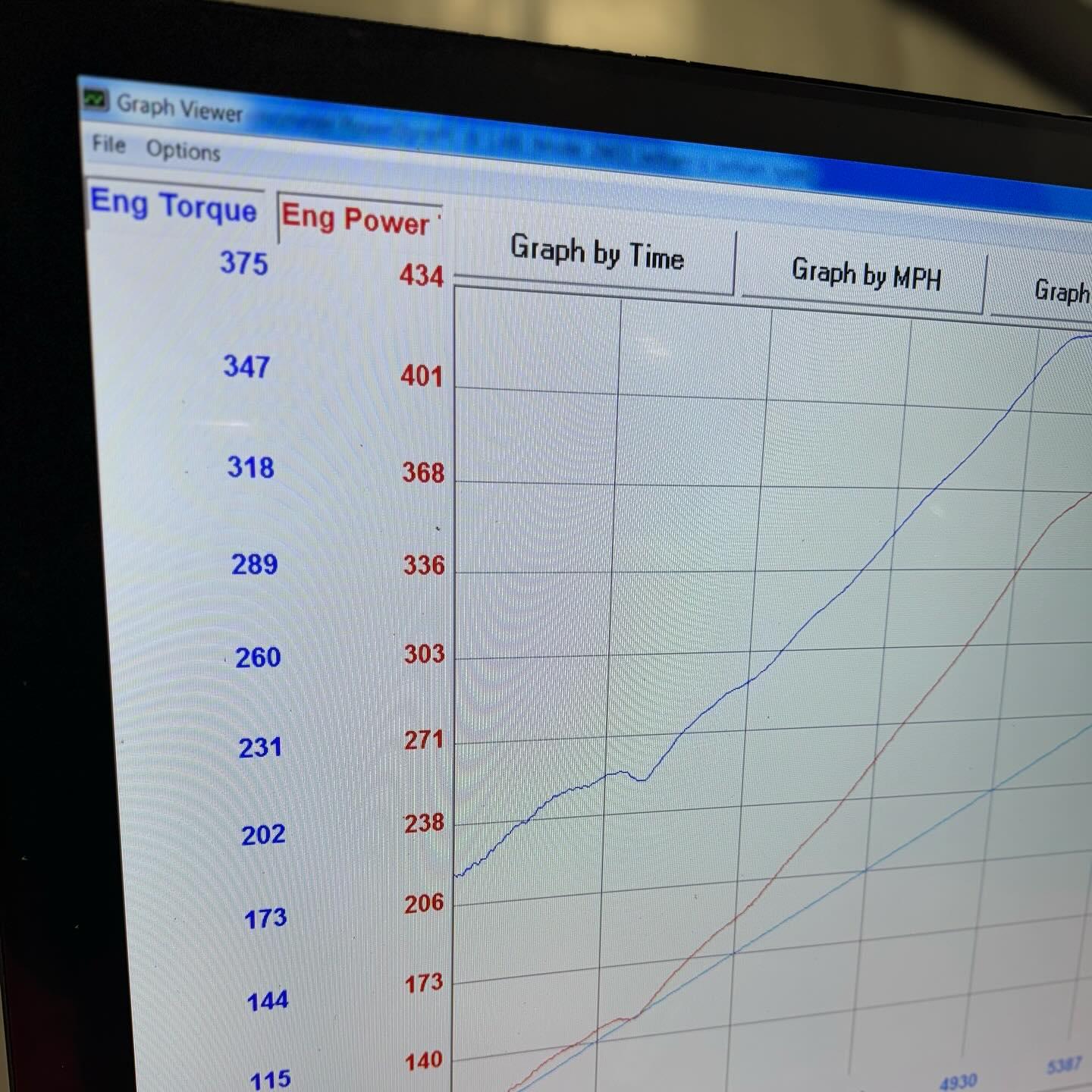

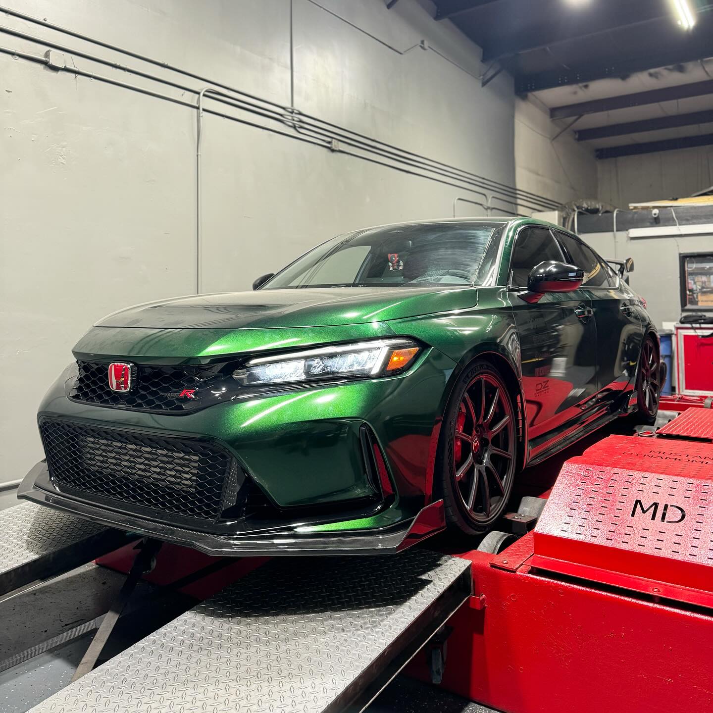

Hey guys, just got dyno done and I have seen other people's ctrs with less mods making more power. Its not a huge deal to me I am still happy with the gains, just wondering if by your guys experience if I should be getting more power. Should I try another tuner? Btw dyno was done on 93 not e85.
Tuned on 93 - 434whp/375tq

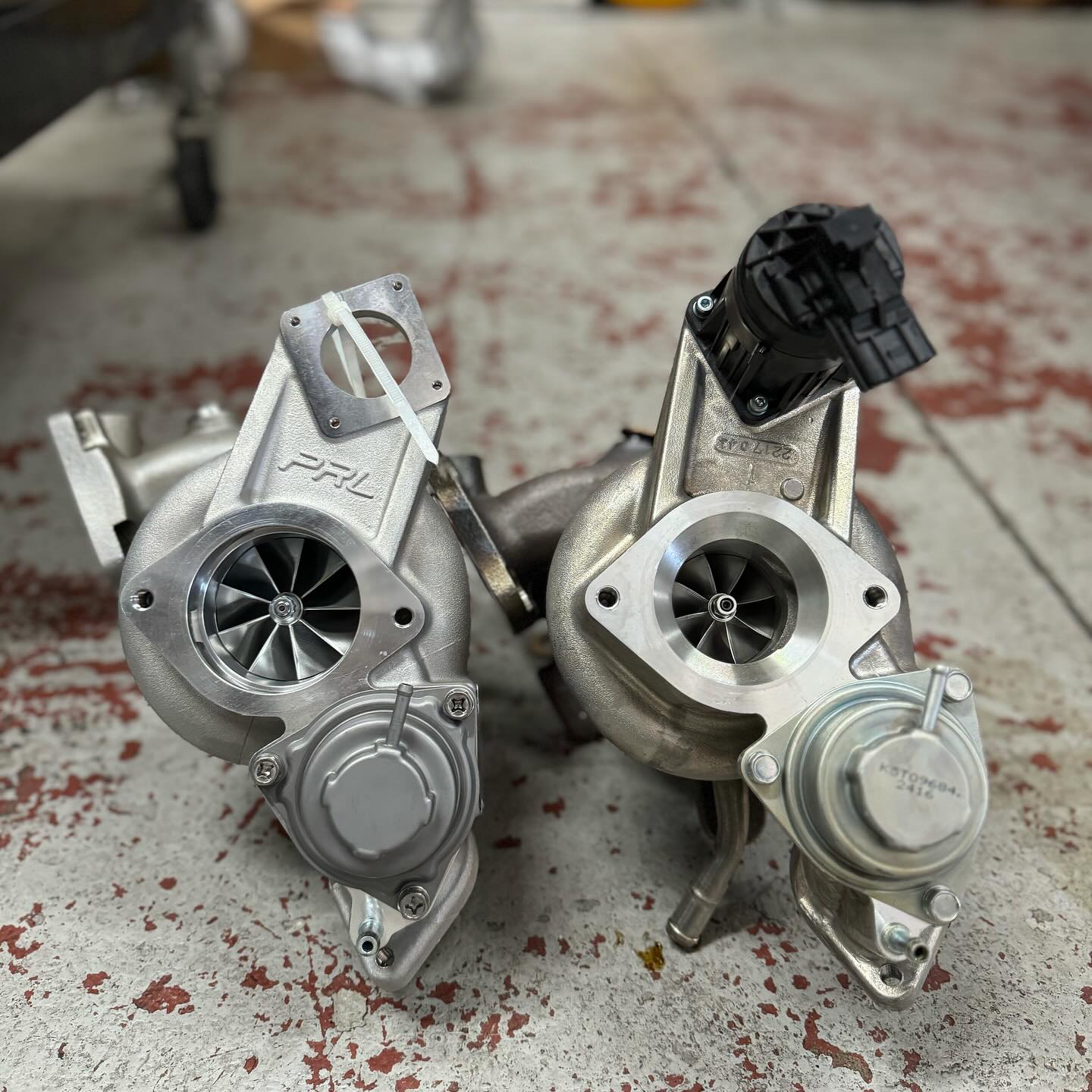

Prl P700

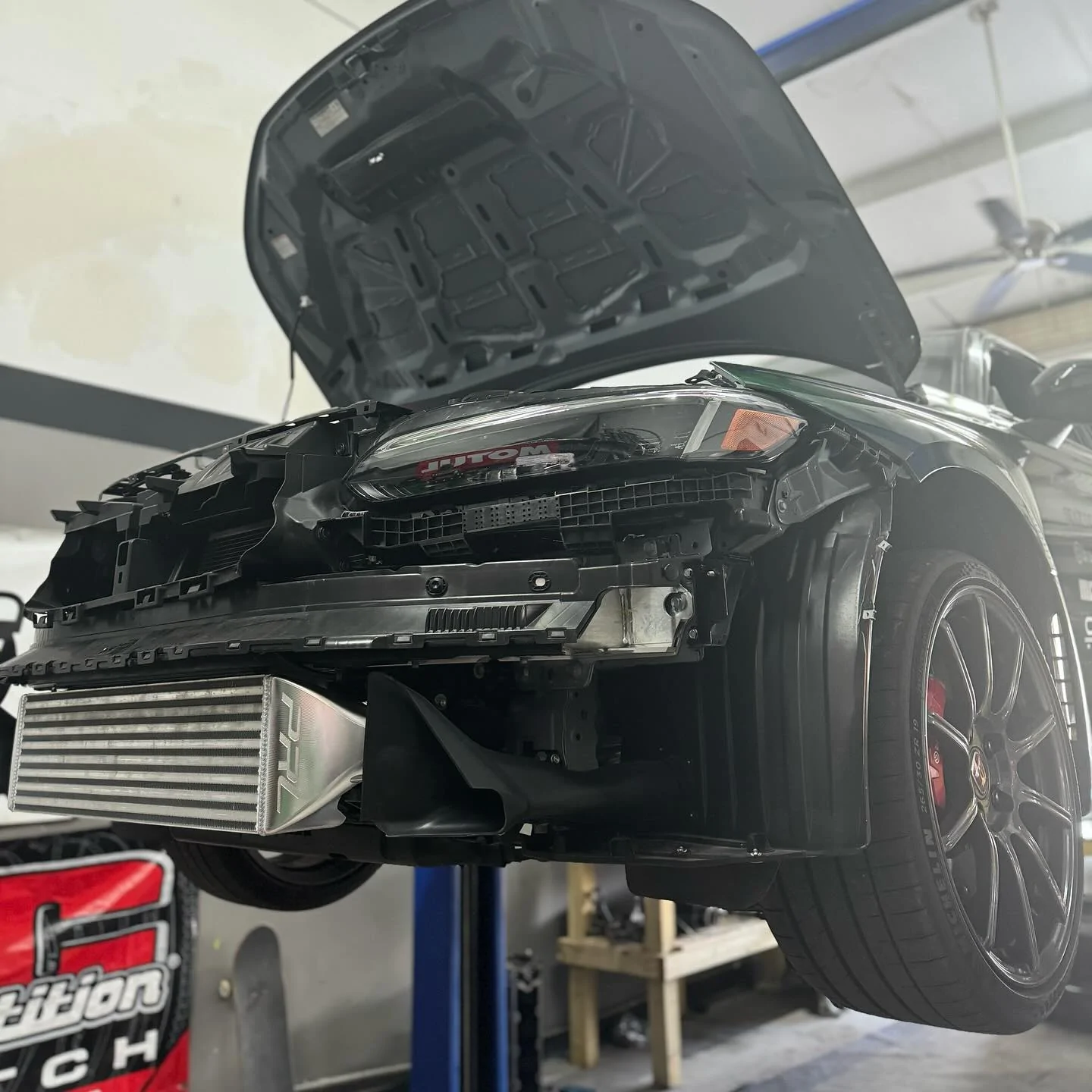

Prl Intercooler

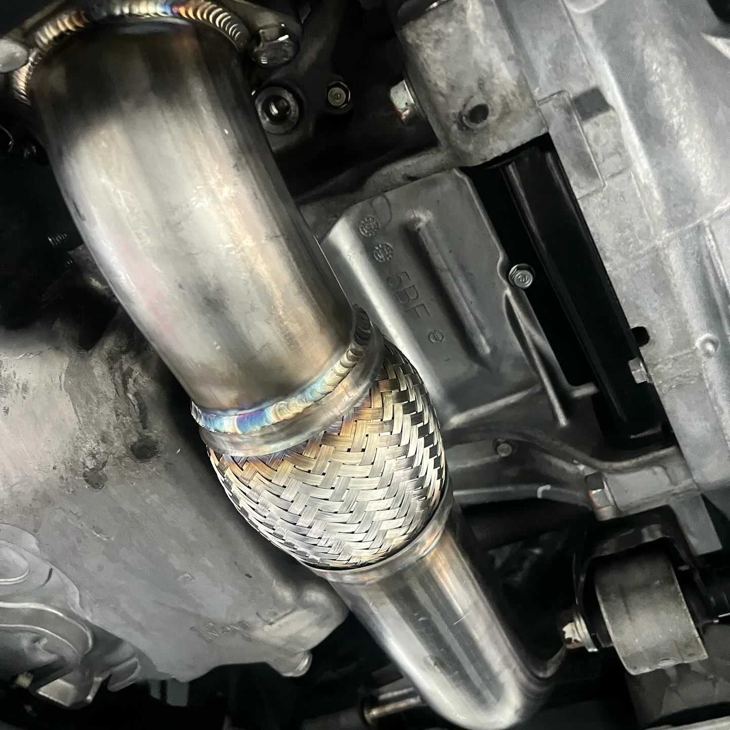

Prl Front Pipe

A dynomometer is a tuning tool that measures mechanical power (torque), nothing more. Don't chase numbers. Different dynos output different results. MAHA, Dyno Dynamics, DynoJet, Dynapack, Mustang, will all output different baseline figures even on the same car. The focus should be on the gains. Please tell me you got a stock baseline.:) What is the delta between your stock FL5 and your current power figures? That will tell the story. If you picked up only 50whp from those mods, then yes, you have a problem. You can also use trap speeds as a proxy for power if you drag race.

I dont have the numbers for stock but the previous dyno with just the tune, exahust, intake I was at 368whp.

There are lots of variables here but in short I would say these results are in line with what I would expect based on the information provided. I'm not sure what you are comparing your build to but keep in mind that not all posted results on the internet are completely honest and forthcoming.
You should post a copy of the dyno chart so that we can see the full power curve.

What everyone else is saying. Dynos are a tool but there are a ton of environmental variables including the machine, the operator, ambient temps, humidity... on and on.
The bottom line here is that you're basically getting another 70 WHP compared to your previous setup with just a tune and intake. To me, that's some pretty impressive gains.

That is a mustang dyno. They typically read lower. ?‍♂
