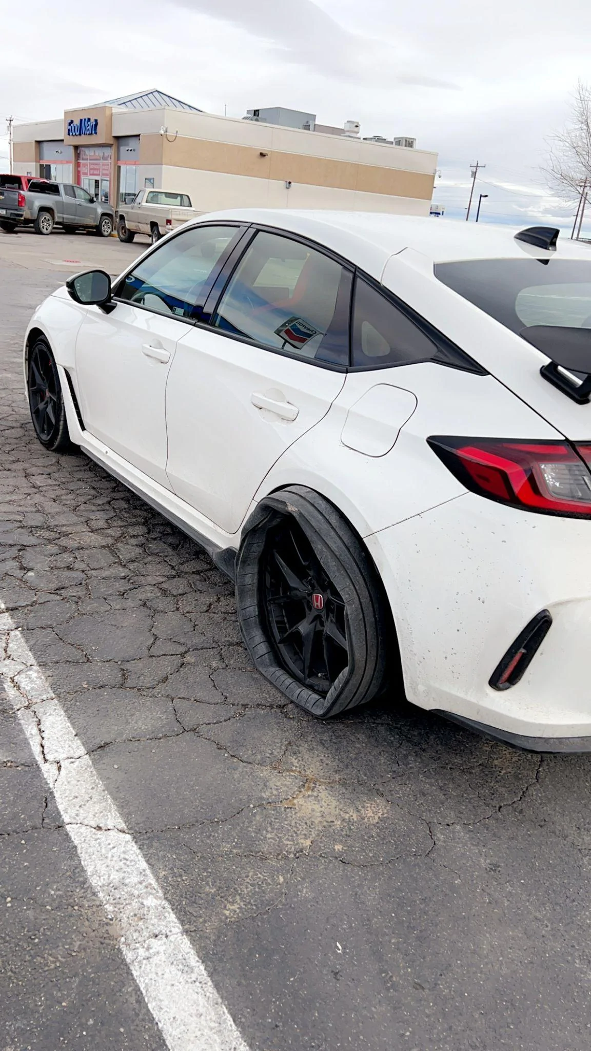

Hey guys, last night my left rear tire got ripped and now I'm stranded in Kayenta, Arizona. Does anyone have any recommendations for any emergency spare tire replacement? I don't have a spare tire but I'm looking to see if any common car's rims fit the Type R so that I can find it faster. As expected a Type R wheel is difficult to find especially in a small town. With today being a Sunday and tomorrow being MLK day, I just want to get home and any spare tire would do as a temporary solution as long as it fits. Please suggest. Thanks.

You're in a bad way as there isn't much in northeast AZ. I suggest finding a tire shop in the closest city (maybe Durango or Flagstaff) that has the same or similar tire size in stock (don't worry about brand), have the vehicle towed to the location, and have the new tire fitted to the car. Before departing, I would make certain the shop has the tire in stock. Ask for them to send you a photo, pay for it in advance if possible, and have them pull it as sold with your name on it. Good luck and let us know how you make out.

Thanks for the advice guys. As of yet I'm still stuck but I believe a Honda Pilot or Acura RL/TLX donut spare should fit it considering that the bolt pattern matches. Just worried about the offset. The local tire shop guy is still looking for any spares he can find which might fit. If not today, I hope MLK day doesn't leave me stranded tomorrow. Also does Honda roadside assistance provide a rental? If push comes to shove I can have it towed to Flagstaff which is the nearest Honda dealership, get a rental until they order the tire/get it fixed. Got work on Tuesday.

You can run an alternative sized tire if it helps you locate one near there... I run 255/35/R19 which is a more common size and gives me a bit more sidewall. This is on my DE5 which shares the same wheel size. Note that the speedometer will be slightly off when you change it but mine is minimal at 2%.
255-275 width fits the wheels
30-35 profile
R19 is fixed.
good luck.

One more thing to add if you want to go the wheel replacement route... most bmw wheels have the same bolt pattern 5x120. Not sure if you will need lug centric rings or not.
If your exiting wheels are in good shape, I'd just get some new rubber on it. Switch both rears or ideally all 4.

Look for 5 x 114.3 bolt pattern and you are home free. 18 inch works fine!

I stand corrected 5x120! Sorry
