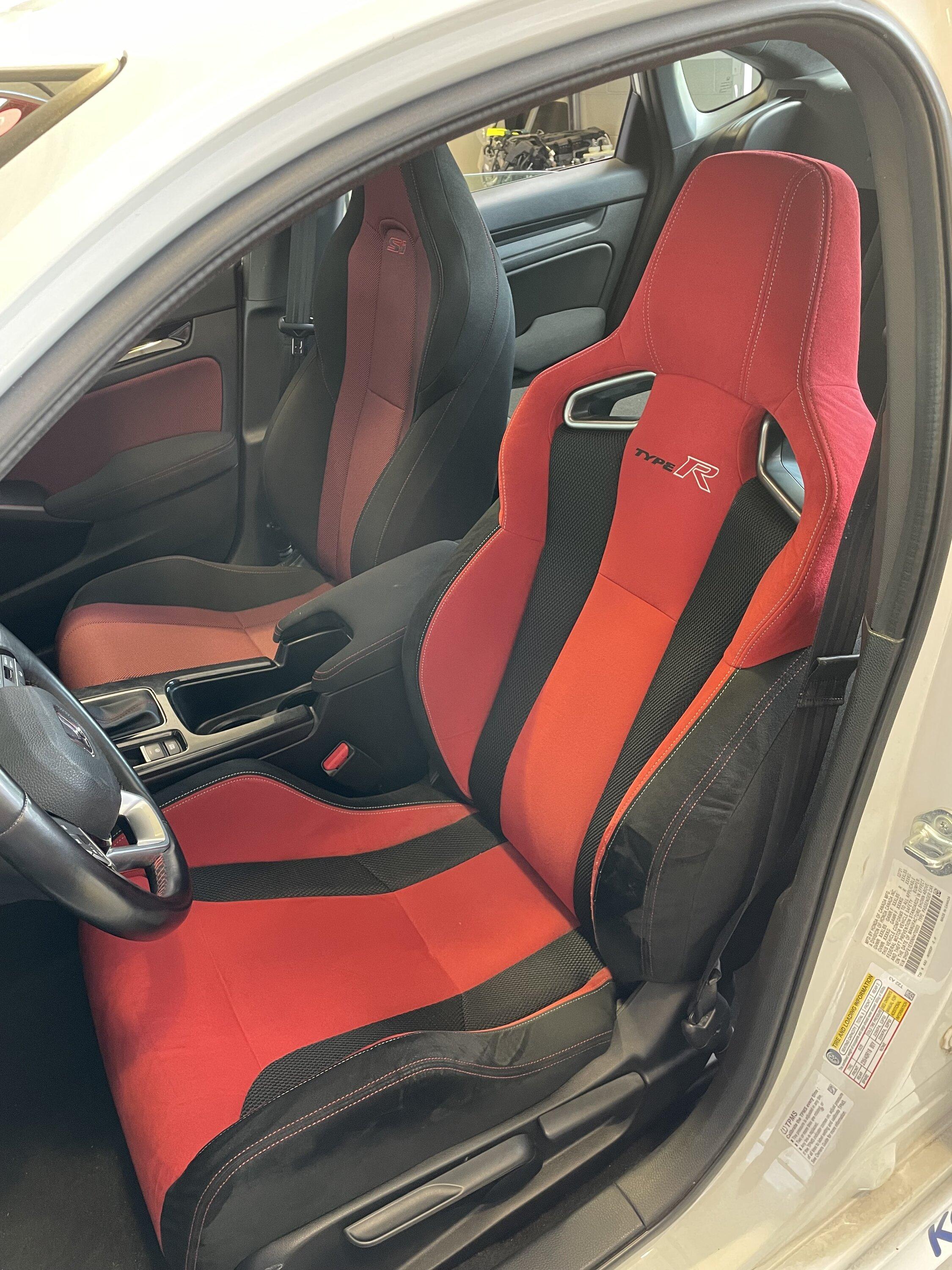

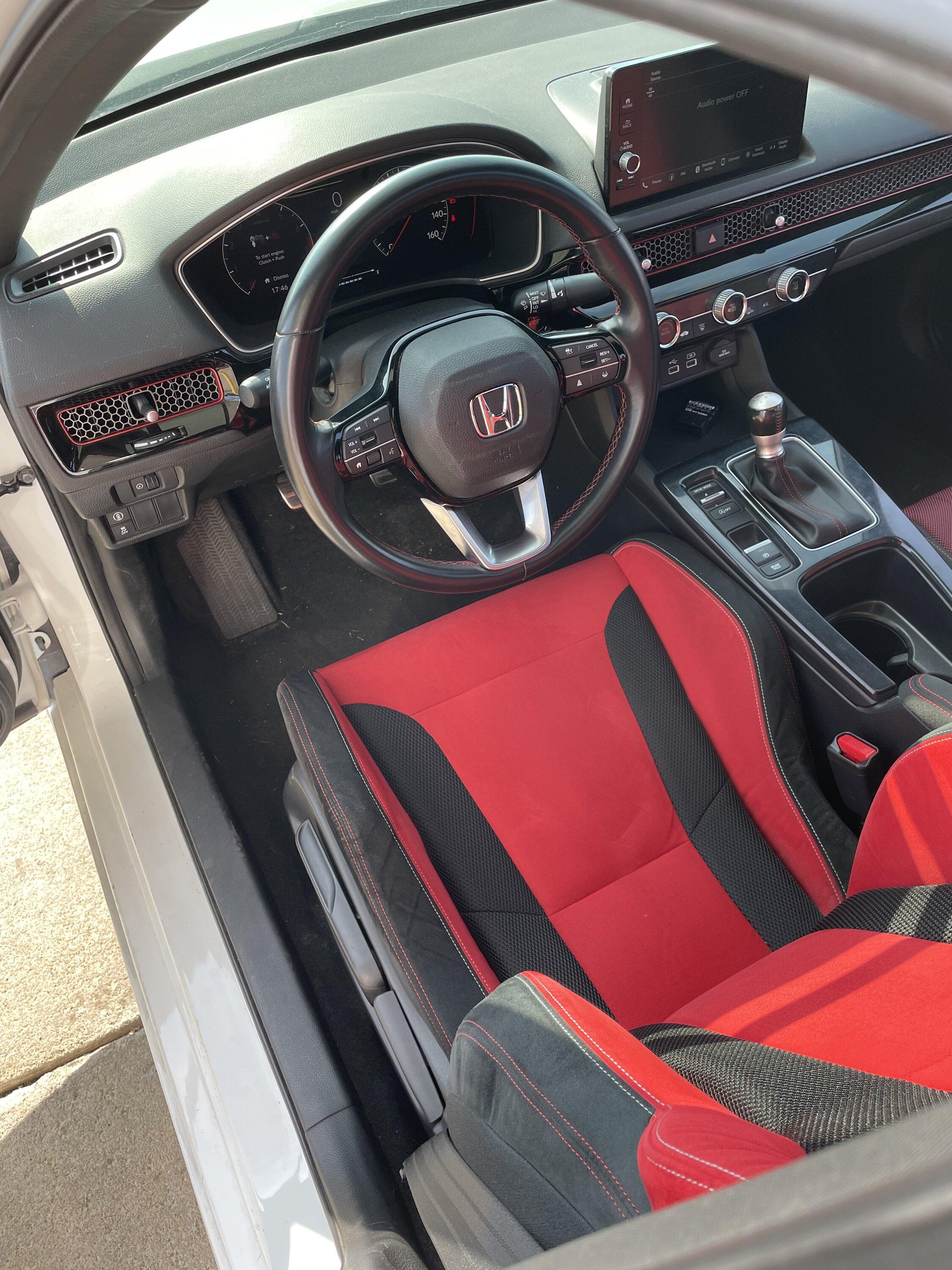

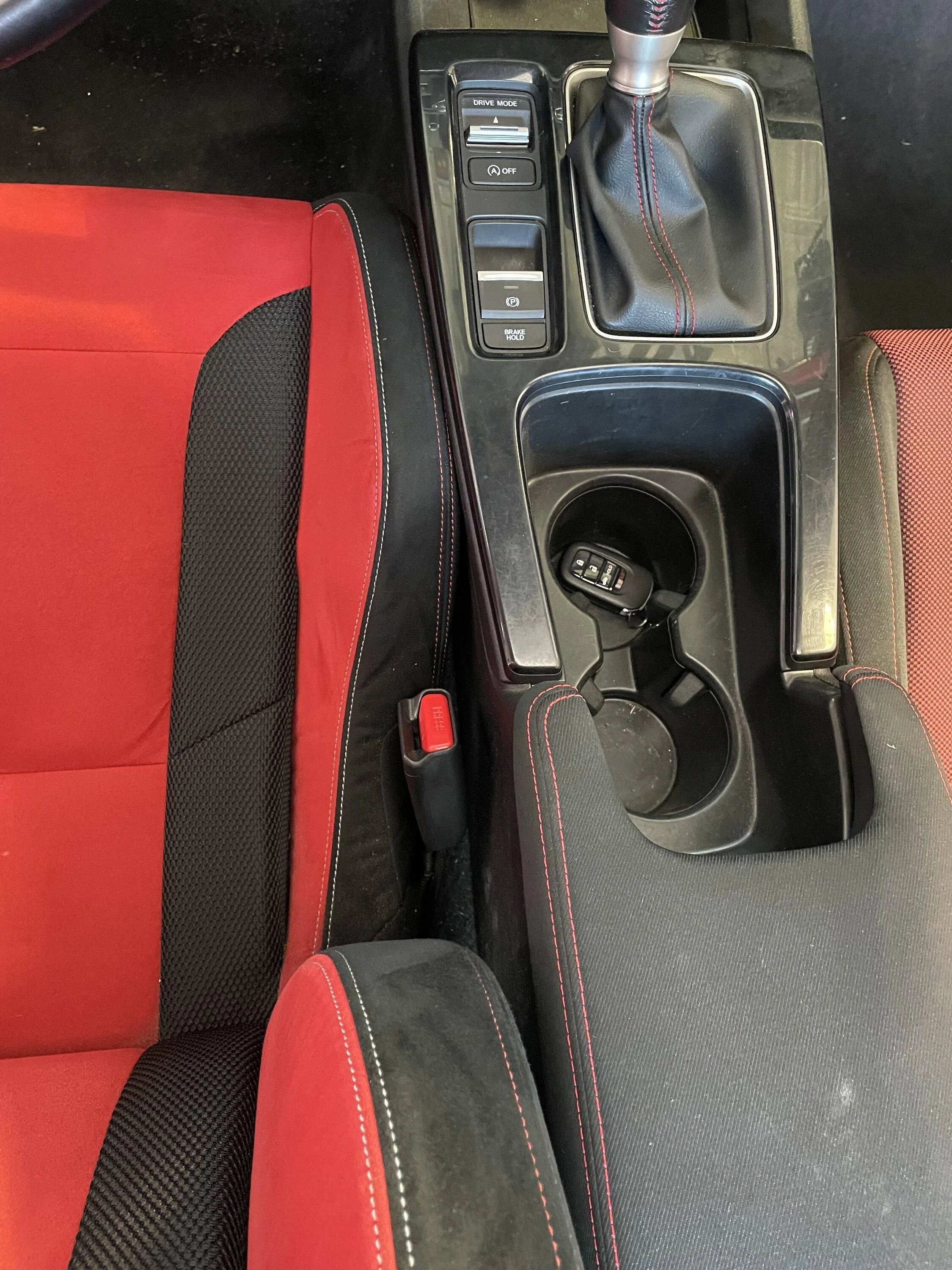

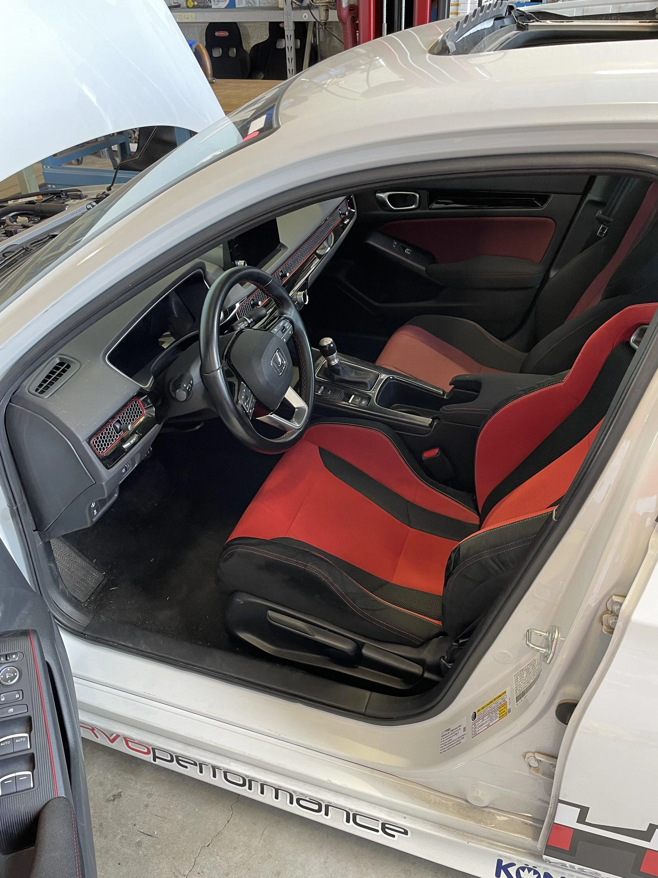

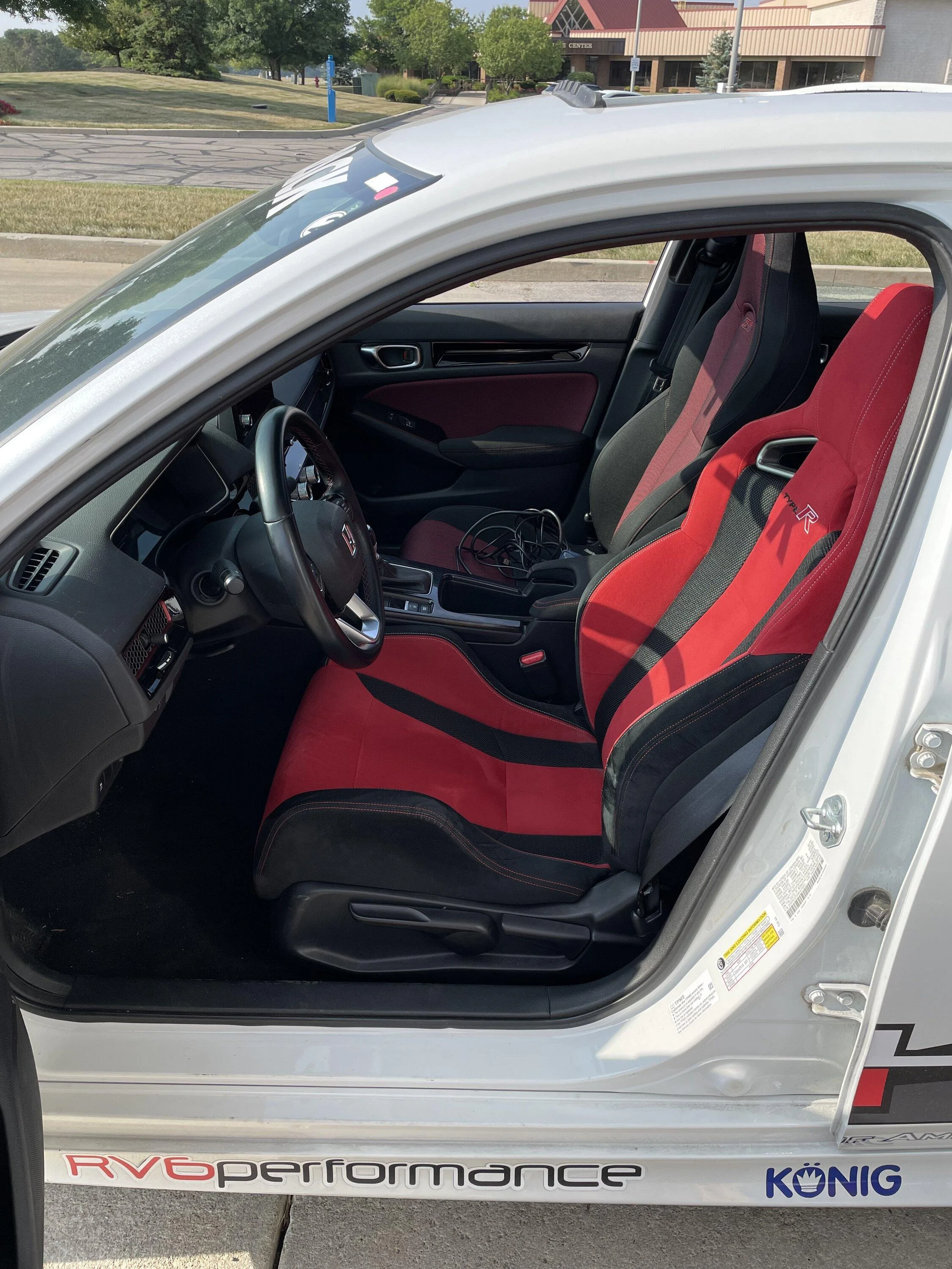

Hey all! Just wanted to confirm fitment of the FK8 seat in the 11th gen Si.
The OE Si seats are bit lacking in the bolster area, so we borrowed a seat from our FK8 as a temporary "fix" until we get some proper race seats.

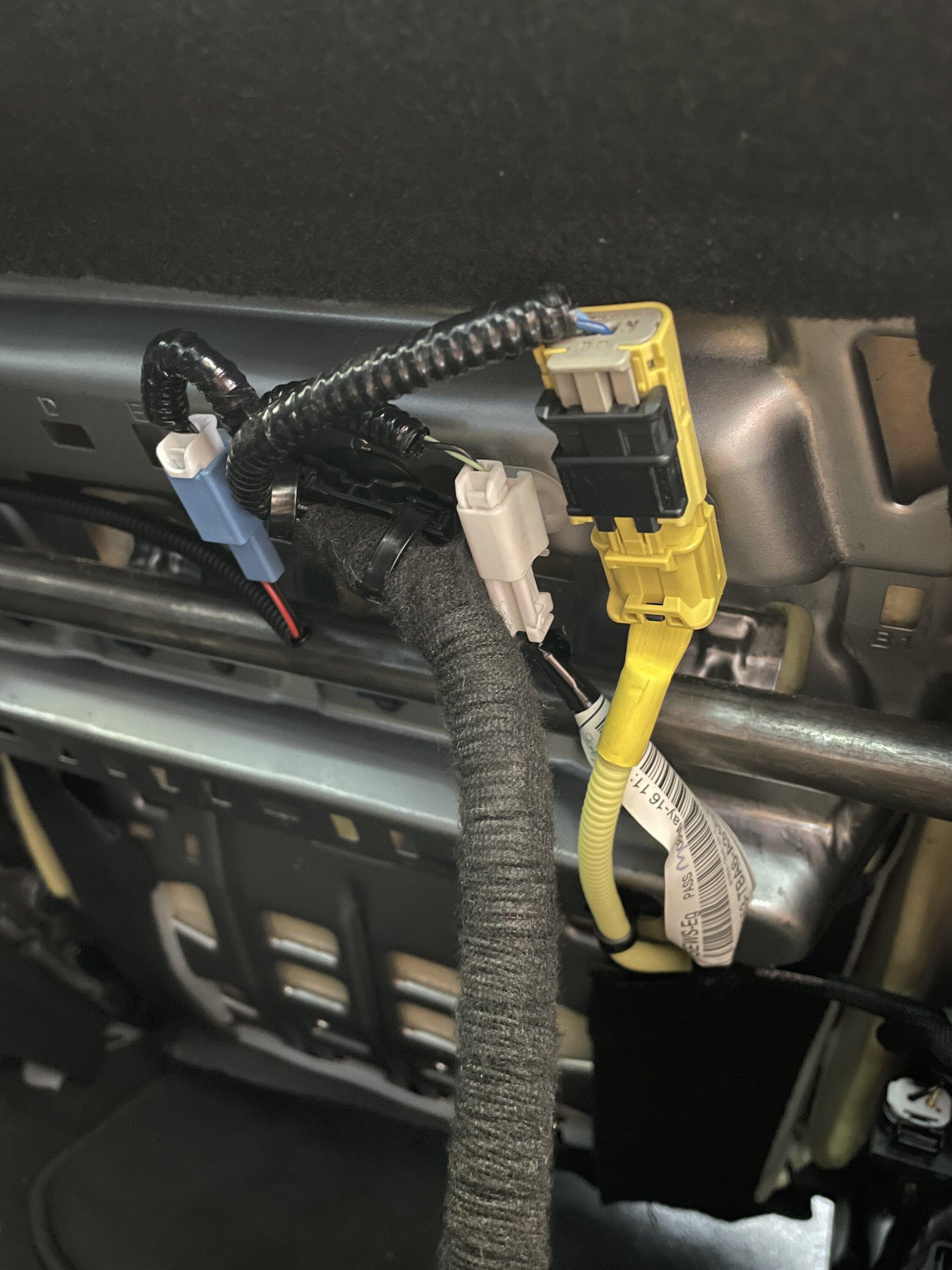

FK8 Driver seat bolts right in and no SRS light on the dash. Fit seems to be perfect.
FE1 Seat: 39lbs
FK8 Seat: 47lbs
Much more lateral support now while at speed!
Kirkey Seats up next!
11th Gen Honda Civic FK8 CTR Seat in FE1 Si - IT FITS! IMG_0915
11th Gen Honda Civic FK8 CTR Seat in FE1 Si - IT FITS! IMG_0916
11th Gen Honda Civic FK8 CTR Seat in FE1 Si - IT FITS! IMG_0917
11th Gen Honda Civic FK8 CTR Seat in FE1 Si - IT FITS! IMG_0918
11th Gen Honda Civic FK8 CTR Seat in FE1 Si - IT FITS! IMG_0919
11th Gen Honda Civic FK8 CTR Seat in FE1 Si - IT FITS! IMG_0914

Is it a straight bolt on or did you have to do any modifications to make them fit?

It’s a straight bolt on but the SRS system gets angry with the passenger seat due to weight sensors not communicating.
Was there a solution for this? Have considered FK8 seats for my ITS
