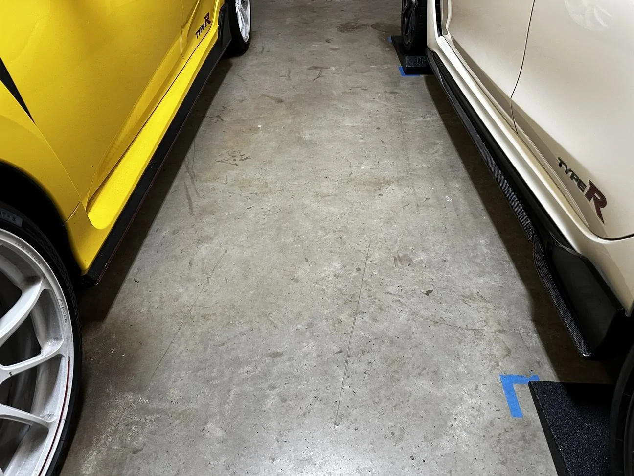

You are right, I failed to explain the context of my query ... No worries, allow me to explain.
I started with 2018 FK8 CW then 2019 FK8 CW then 2020 FK8 CW and recently decided to get 2021 FK8 LE in Phoenix Yellow (which is I currently own).
No, I'm afraid I'm not AI and Yes, I'm weird to own both FK8 & FL5. But like you said, people spend money in mysterious way ... LOL ... Better than spending them on drug, gambling, etc :thumbsup:.
11th Gen Honda Civic FK8 Struts/Shocks on FL5 Image (2)
I did purchase 2023 FL5 CW last year and like most of everyone here, progressively we installed parts that we like. As you all know, FL5 OEM suspension is stiff and as 'older person', I would like to get a bit more comfortable ride, hence I get ITS ADS which helped significantly on the ride quality.
But after a few months, I wanted to try Ohlins DFV Road & Track which I did install. I did not bother to uninstall ITS ADS since I know that the ADS will not affect anything once I install Ohlins. I'm not that stupid ... Hahhahahhaaa ... Spent a lot of different click set ups, got a good combination at 10 clicks from full stiff (for both front & rear). I'm content and happy with the ride with my Ohlins set up.
However, as I age further, I realize that having both cars and drive them back to back, I found that : FOR STREET and DAILY, LE OEM suspension set up offers different proposition (maintaining sharp handling with 'comfortable' ride) which I know I will prefer when my back cannot take the stiffness ride anymore (in the future). Hence, my question in this thread.
I apologize that my query has no context in the beginning.

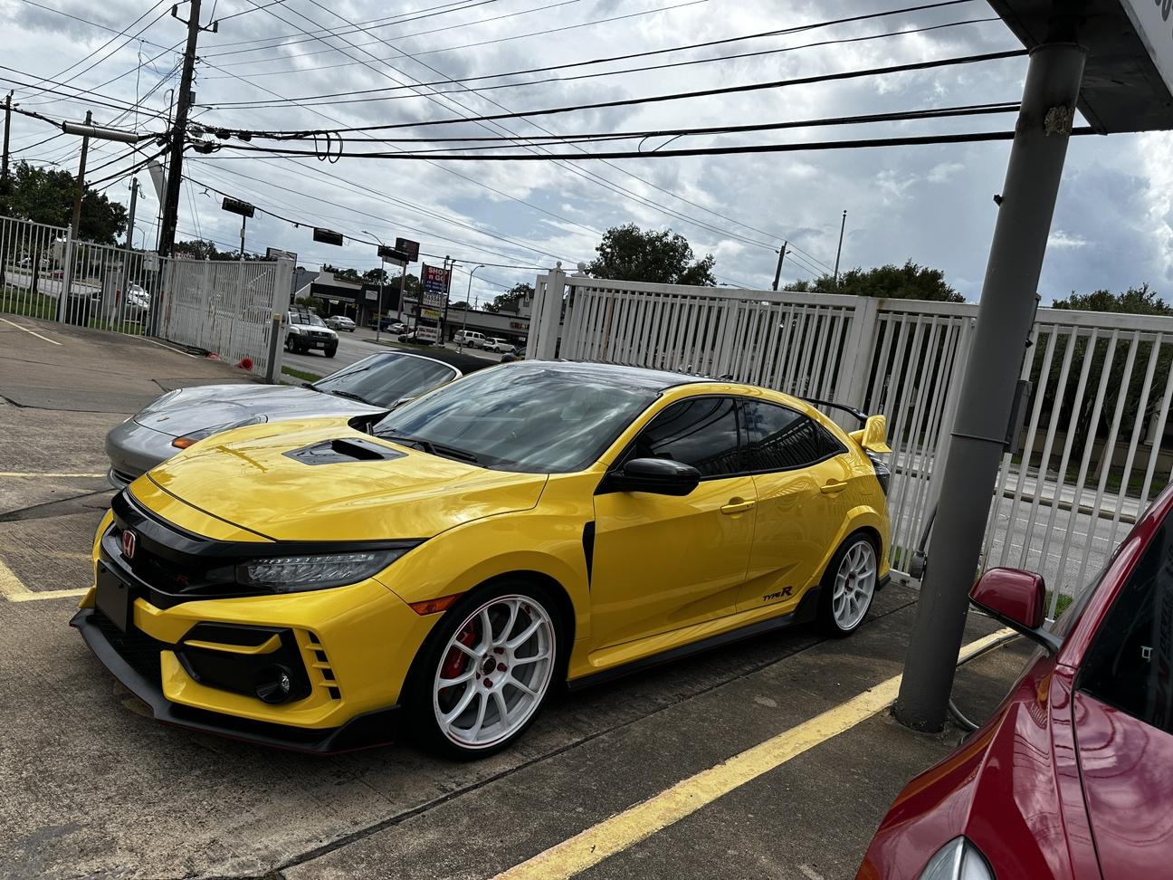

I test drove Integra Type S and I prefer FK8/FL5 hands down.
I prefer to have these two :
11th Gen Honda Civic FK8 Struts/Shocks on FL5 Image (3)
Excuse my garage floor, it will be upgraded soon. I hope this will proof that I am not an AI ;)
