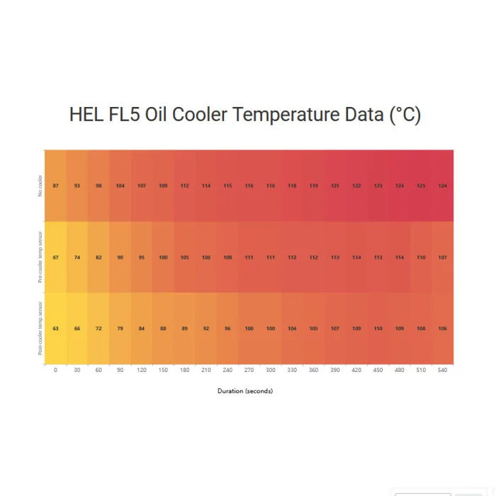

Thanks for both of your writeups on RA. Just recently picked up a CW FL5 and am excited to go there in the spring. :wave: I'll probably just go with upgraded pads, fluid, and shims to start.
Sad to hear that overheating is still a potential issue. It would be nice to get some actual oil temperature measurements with and without cooling upgrades. I'd really rather not replace the intercooler, radiator, and add an oil cooler without more solid data (though also thank you to @PointByPatrol for documenting your journey). Also is there an actual source of truth for what the algorithm is for the calculated oil temperature?

No problem! Happy to be the guinea pig! Not sure what the actual equation is for the algorithm, but I would imagine it's a combination of water temp, intake temp, and oil pressure. I've attached below the oil cooler data sheet that shows the results of HEL Performance's testing. Based on the chart, with the oil cooler they didn't seem temps above 224 Fahrenheit, though without the cooler that number was 255 degrees. I'd say it's a very strong representation of how effective an oil cooler can be on curbing unwanted temperatures.
