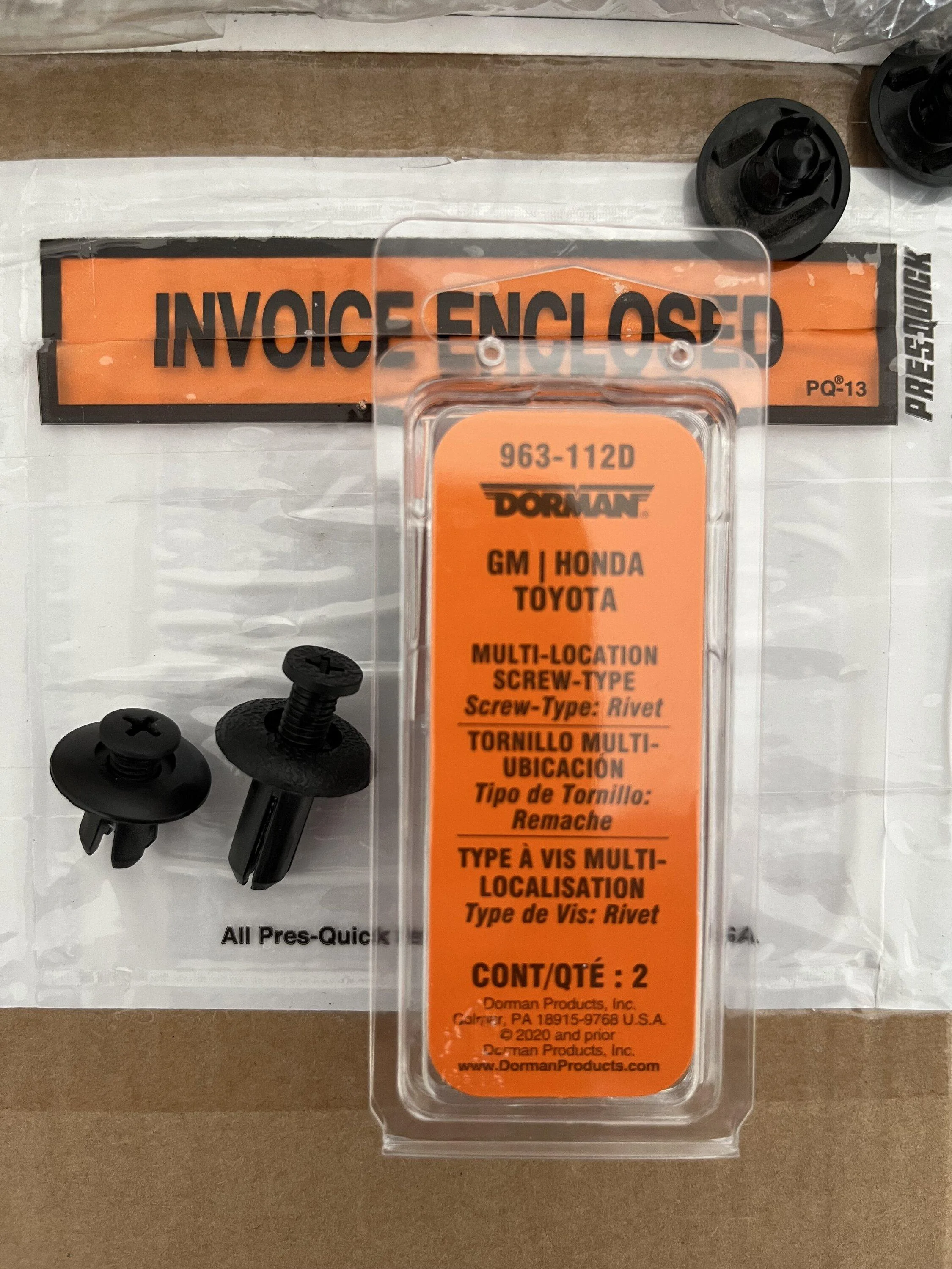

So the head of the terrible clips broke off, how did you guys take it out when the clip broke? TIA!
Edit: Ended up drilling it out

I just grabbed a Phillips and punched it through. Easy day. The clips break more often than they don’t. 3DFX sends new clips with the flaps

Don't use the "proper "tool - I went and bought one and it broke 2 of those clips. A flathead is more effective and won't break them. Go figure.
