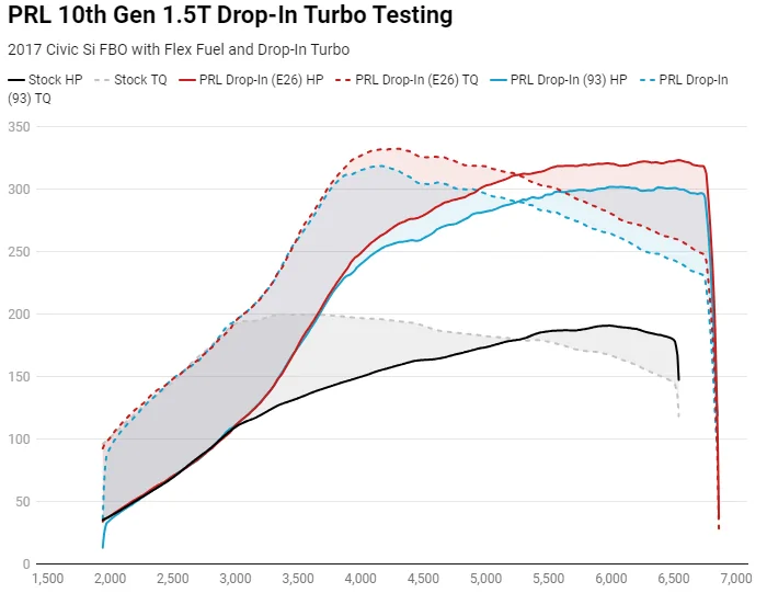

In stock configuration, the 10th gen Civic Si produced 208 wheel horsepower at 6200 rpm and 203 wheel torque at 3200 rpm on our dyno. These figures give us a clear reference point for evaluating gains once the drop in turbo and supporting modifications are introduced.
On 93 octane fuel, the car produced 302 wheel horsepower at 6000 rpm and 319 wheel torque at 4100 rpm.
We then blended in ethanol using the PRL WiFi Flex Fuel Kit. The stock fuel system on the 10th gen can realistically support up to about a 30 percent ethanol blend before reaching injector duty cycle limits. Once ethanol content reached 26%, we performed another max power run. On E26, the car produced 324 wheel horsepower at 6500 rpm and 333 wheel torque at 4300 rpm, representing a 6.7% increase in horsepower and a 4.3% increase in torque over the 93 octane run.
Let’s take a look at a graph of the testing data for the 10th Gen:
11th Gen Honda Civic From Stock to Serious: PRL 1.5T Drop In Turbo Dyno Testing 1770818768463-e7
The difference is immediately apparent. The rev limit was safely increased to 6800 rpm from the stock 6500 rpm. To preserve drivability and reliability, torque and horsepower closely mirror stock output between 2000 and 3000 rpm. Beyond that point, the curve opens up significantly.
By 3500 rpm, the car running E26 is already producing 262 wheel torque, compared to just 200 wheel torque in stock form. That represents roughly a 27% increase in usable torque within only 500 rpm. Looking at peak numbers, the Drop In turbo delivers a 45% increase in horsepower and torque over stock on 93 octane, and approximately a 50% increase on E26.

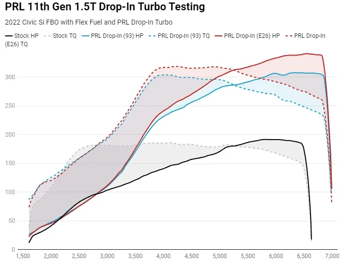

Before testing the modified setup, we established a stock baseline. In stock form, the 11th gen produced 191 wheel horsepower at 5800 rpm and 186 wheel torque at 4100 rpm. It is worth noting that the 10th and 11th generation cars use different gear ratios, which affects how power is delivered and where it appears on the dyno.
Tuning was once again performed by Derek Robinson at Innovative Motorworks using KTuner. Testing on 93 octane was completed with ambient temperatures around 65°F, and intake air temperatures during the pull averaging approximately 73°F.
On 93 octane, the car produced 308 wheel horsepower at 6300 rpm and 304 wheel torque at 4000 rpm.
We then repeated the test using a 26% ethanol blend. On E26, the 11th gen produced 341 wheel horsepower at 6500 rpm and 318 wheel torque at 4200 rpm, representing roughly a 10% increase in horsepower and a 4.5% increase in torque over the 93 octane run.
Now let’s look at testing data from the 11th Gen on the Drop In turbo:
11th Gen Honda Civic From Stock to Serious: PRL 1.5T Drop In Turbo Dyno Testing 1770818554747-2y
Below 3000 rpm, the power delivery remains very close to stock. Past that point, the benefits of the turbo become clear. At 3500 rpm, the stock car produces 182 wheel torque. With our parts installed, the car makes 256 wheel torque on 93 octane, a 34% increase, and 263 wheel torque on E26, a 36% increase.
That means in just a 500 rpm window, the car sees up to a 36% increase in usable torque. At peak, horsepower and torque increase by 47% on 93 octane and by 56% on E26.
