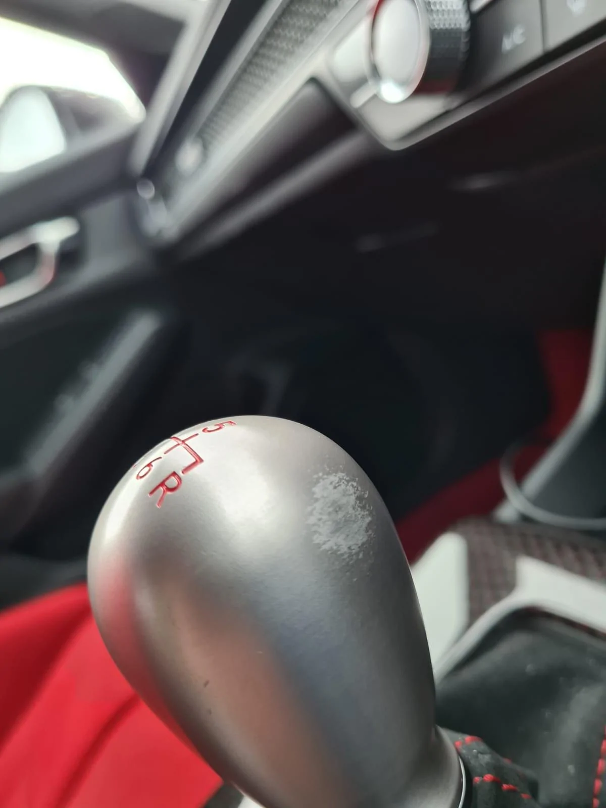

Has anyone had any problens with their gear lever? Mine has started to wear and looks like the stainless steel is peeling off. I went to my dealer and he said he had never seen this before and that it wouldnt be under warranty. I am thinking that there must be a defect in the grade of material and that is causing the gear lever to wear so quickly. My car has only done 2400 miles and is a right hand drive model for the UK.
Neither myself or my wife wear any rings that could damage the gear lever so we dont have any idea how it got there.
Has anyone any idea how we can either get it repaired or buy a replacement?

No clue here. Do you think it was like that possibly when you got the vehicle or is it becoming that way?

When i bought the vehicle in March this year there were no miles on the clock. It has just appeared after 2000 miles.

I’m pretty positive the knob is brushed & polished aluminum, not steel. Typically, things of this nature are coated (anodized) to prevent oxidation…which appears to be the issue with yours. It’s 100% entirely possible there was a problem with the anodization (from the factory) and it’s starting to oxidize. The car is warranted for material and workmanship defects for 3 years iirc. Your dealership should definitely replace it under warranty. As the problem is only in one spot and not in other areas that you grab, makes me suspect that the problem is from the factory and not from your use ESPECIALLY since you’ve only owned the vehicle a short time.

Yeah, I'll be honest with ya buddy. There is absolutely no reason a dealer shouldn't cover that under warranty. Go back and make them do it, especially if it bothers you.
I've worked in a market quality position for quite some time with Honda and I've seen crazy things covered under warranty that probably shouldn't have been, id say this is something that absolutely should be.

If this is pure polished aluminum, then these sorts of spots are inevitable because aluminum oxidizes. If it bothers you, you can have it swapped under warranty. Alternatively, you may choose to sand it down or simply live with it. Personally, I think some things look better as they age, like quality leather. An aluminum shift knob with some oxidation on it looks cool to me.

@007 Virtually all consumer products made of aluminum, especially where esthetics are concerned, are indeed annodized. If the knob was pure aluminum, all of us would have received our cars with the entire knobs badly oxidized upon delivery.
Even if the op put major scratches in the shift knob, it shouldn’t result in such a large spot of oxidation over such a short time. I would also expect to see other areas of oxidation, if the op is at fault. Maybe the op has sandpaper hands????

Both raw and anodized aluminum parts can develop stains when exposed to water and allowed to dry slowly. Since sweaty palms are primarily composed of about 99% water, any remaining 1% sweat contains traces of urea, uric acid, ammonia, lactic acid, vitamin C, and other organic compounds. These substances can accelerate mineral buildup and oxidation on the shift knob, whether it's raw or anodized aluminum.
Right. Anodization is a protective coating, but not invincible. It is FAR more resistant to corrosion than raw metal, however. That was my main point. Again, I think we’d be seeing this problem more widespread, not only on the op’s shift knob, but on others’ shift knobs if it is simply a problem with hand sweat and normal use. The problem has to be faulty anodization…or acid sandpaper hands. LOL!

I don't have sandpaper hands or callouses on them. I wear my wedding ring on my left hand but that mark is on the right hand side of the gear knob. My hands certainly don't sweat, not in Scotland anyway, average temperature where i live is about 15 degrees centigrade.
I work in Saudi Arabia so when i get home at the end of September, i will take it back to the dealer and get him to replace it under warranty.
