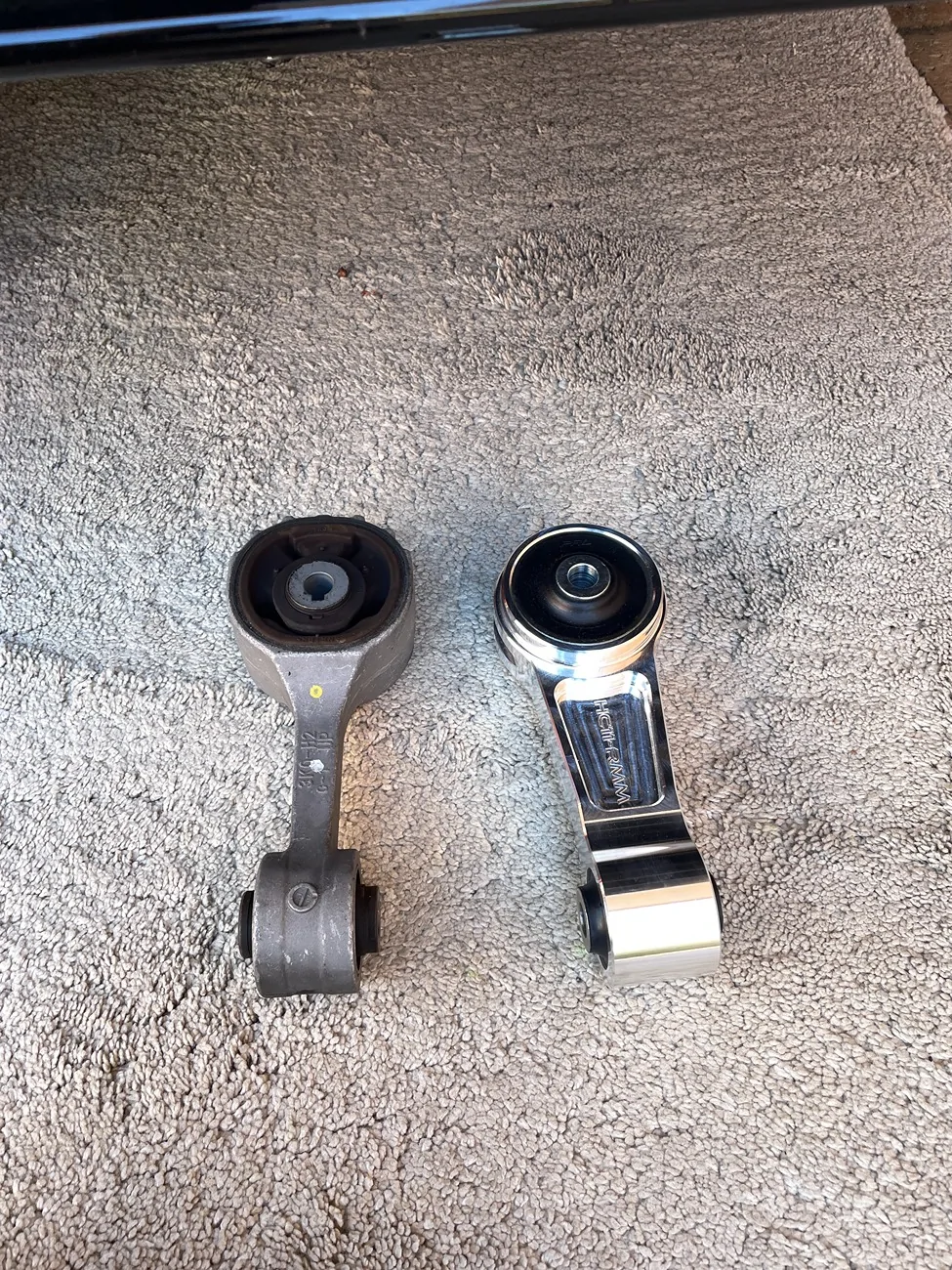

Oh man, glad to see im not the only one who has had this issue!
Recently installed a motor mount as pictured and i havnt ground 2nd gear since. Feels as if the motor is now attached to the car and not connected via a rubber band like it did with the OEM mount. Possibly the torque under load then shifting when pushing the clutch is responsible for missed syncro due to the weight/momentum transfer in the drivetrain? Anyway, for me it seems to be fixed without changing anything else. Very happy!!
